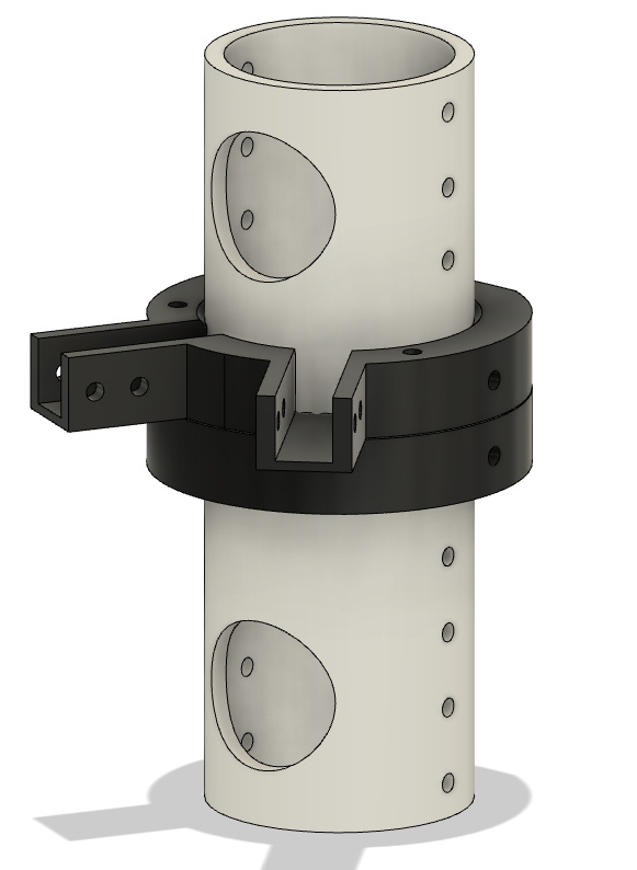

So while the parts continue to print, I need to figure out a jig to allow me to drill really accurately placed holes in a 3-inch PVC pipe. The plan is create a ring that will be used to support the various plates and bolt the rings in place through the PVC pipe. This is what the F360 mockup looks like.
The lower piece will be fixed with a bolt all the way through to the other side. The top piece wont use those two bolt holes (need to get rid of them) but will be “pinned” to the bottom through those holes you can see at the top of it. The two channels is where I’ll bolt in some pieces of wood to extend out like arms to hold the plate. If the top part is unpinned from the bottom, it should be able to rotate to give me access to other plates below it. The big holes are where I’ll run wires through (leaving enough slack to allow me to rotate the plate).
The big holes aren’t really critical, but the small holes are as if its rotated at all, then the plate will be rotated and it won’t line up well. So I’ll need to build a jig for my drill press.
It looks like you’re trying to make holes for shelf pins. You can make a story stick with the same holes in it. Use a straight edge to make a line straight down (it will only rest on the edge if it’s parallel to the cylinder). Drill the two end holes first, and hold the story stick in place with pins in the two ends.

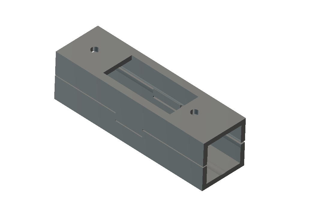

It would be easier to make a square/rectangular box that will fit the pipe in with all the holes and drill on a drill press or even by hand, something like this.

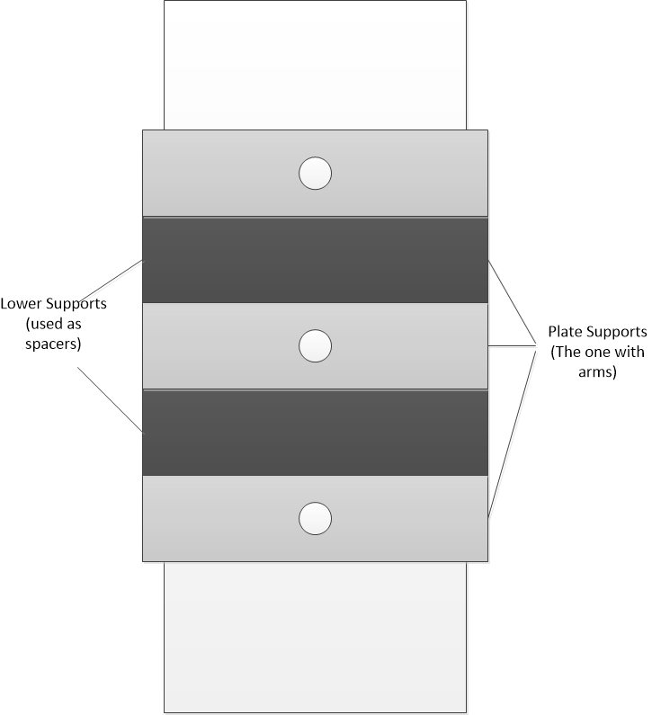

After sleeping on it, I think there’s a very easy way to do it. The design for the plate support pieces (the ones that have the channels with arms) have holes in them that I was going to get rid of since they aren’t needed. However, as I’m planning on building three plates initially, I can take the three plate supports and two of the lower supports, stack and bolt them together, and use the holes in the plate support pieces as drill guides. It doesn’t matter if they get boogered up a little from repeated drilling since they won’t be used in the final product. But this would allow me to precisely place holes and even use a hand drill to do it. And I don’t have to drill all the way through one side to the other. After drilling the first set of holes, I would slide a bolt through it to lock the assembly in place and then drill holes through the next two sets. When those are done, I shift the whole stacked assembly up, bolt the bottom one through the top holes, and repeat. This should guarantee that all the holes are perfectly aligned and center on the pipe.
