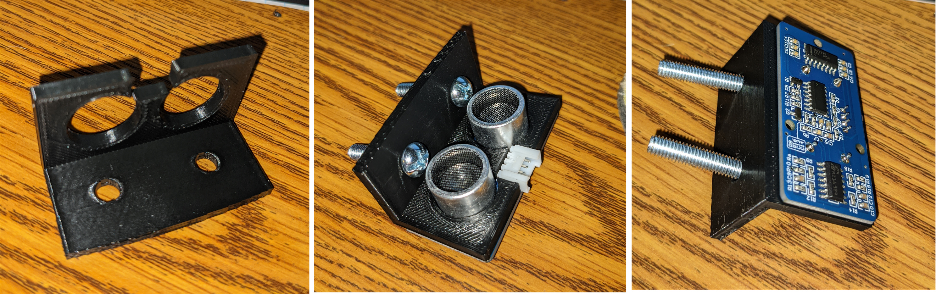

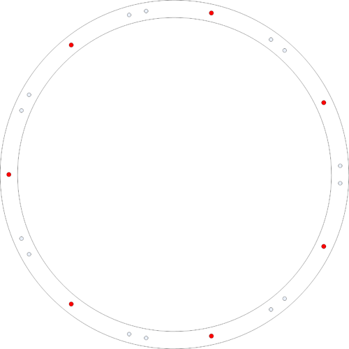

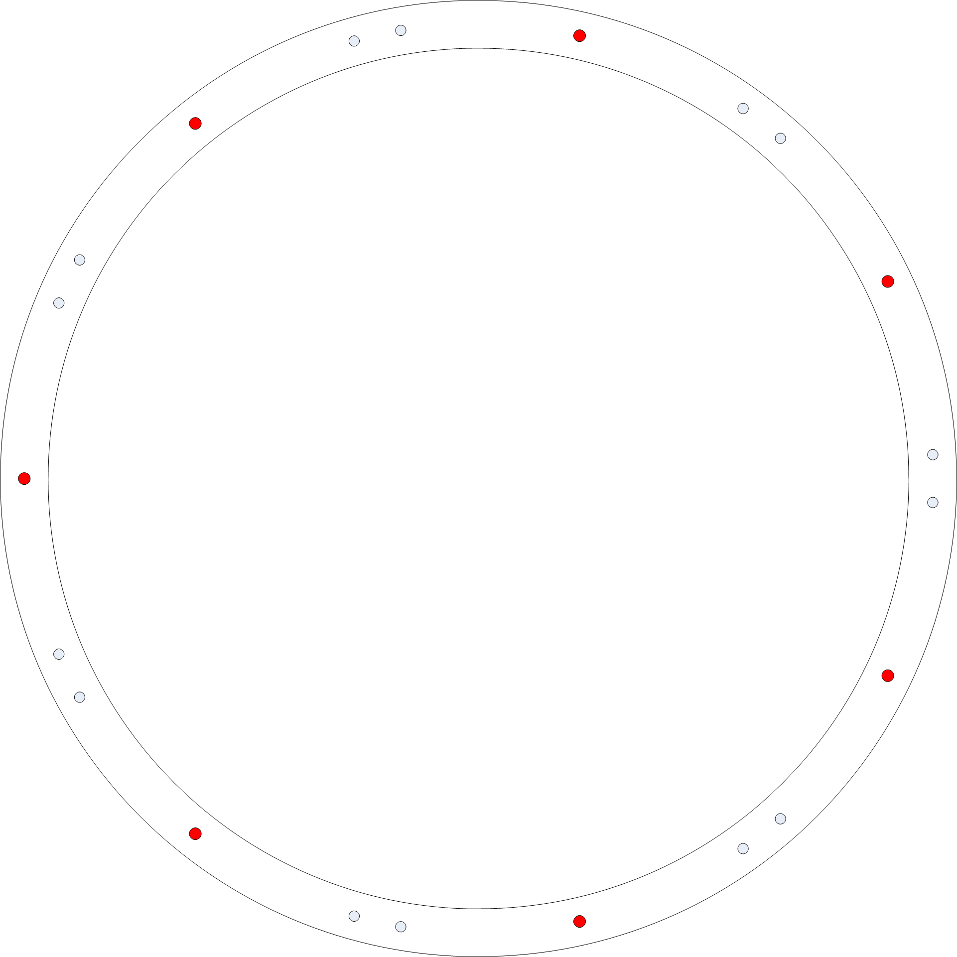

Here’s my first successful solo-designed 3D-printed apparatus. I bought a bunch of sonar rangefinders to place around the base (seven of them) and needed something to mount them to. Thingiverse had two different mounts for this particular rangefinder (seeedstudio) but I didn’t really care for them so I made my own. Its a decent fit but I’ll probably put a dab of silcon around the transducers to make sure they don’t come loose. I’ll mount these to a wooden ring that I’ll cut on the lowrider. The plan is to have the ring below the mounts (secured to the robot base through a series of 1/4-inch bolt-standoffs) so that if there is an obstacle the robot misses detecting, it’ll hit the ring and not the ultrasonic sensor. Now I’ve got to print 6 more of these… tomorrow :slight_smile:
The plan for the mount… red fill indicate where the 1/4-inch bolt standoffs will go.

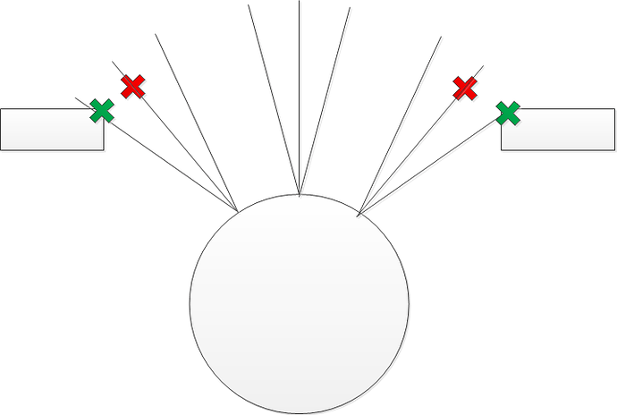

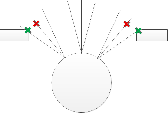

I managed to mount three ultrasonic sensors to the front of the robot (one facing straight ahead and two about +/- 45 degrees looking out radially). It seems to work ‘ok’ for detecting obstacles in the pathway (assuming it gets a good reflection), but I don’t know if it will be effective, particularly navigating through constrained spaces, like a doorway. The problem I think I’m running into is that my robot is rather large and there’s not a huge margin on either side of the robot as it passes through the doorway. The sensors detect the door jamb, but because the beamwidth is 15 degrees it doesn’t know the exact location of the jamb. I think the obstacle is localized on the cost map at the center of the beam and then it gets inflated from there. But if the obstacle is actually on the outer skirt of the beam, but is localized closer in (closer to the robot’s path) then it can create an inflated obstacle that in the costmap that blocks all paths to the destination. See my rough sketch below. On top of that, the minimum range of the sensor is really close to the margin of the doorway so that also creates error. The robot has a narrow path through the doorway so there’s not much room for error. This is what I think might be happening… just don’t know for sure.
The inflation happens for 2 reasons. 1, to add margin of error around the robot. If you are 6" wrong while driving at 10mph through trees, you don’t want to hit anything. So you can add inflation to make obstacles wider on purpose to just give you a buffer. 2. Some planners aren’t capable of planning with the whole vehicle footprint, because it just takes too much CPU. So instead. They pretend the robot is a single point and inflate the obstacles by the radius of a robot.
If your inflation includes the size of the robot, and the planner is using the whole footprint, you are doubling up the size of the robot.
If you are in a relatively safe environment, moving slow, and in a tight fit, you can reduce the inflation due to safety. So roving that inflation would be good for you.
Another thing to pay attention to in tight environments is the cell size of the map. If you have 0.2m cell size and 0.2m to spare around your robot, you need the map to be perfectly aligned with the doorway to find a path through. You can reduce the cell size, which will make the maps a lot more bytes, so you may need to also reduce the total size so your computers can still use them.
Ultimately though, those sensors are going to be hard to use raw. I imagine you could filter them using some bayesian filtering to refine the estimate the actual obstacles, but it will be an uphill battle. Sensor fusion (combining the strengths of one sensor with the strengths of another, while reducing the weaknesses) is its own speciality. Certainly, treating the obstacle as a sphere 15 degrees wide is not correct, but the robot doesn’t know any better from just the sensor output.
I’m confident that the inflation model is operating correctly. However, I need to check the resolution of the cost map, but I think it might be 5 cm and could actually be a big part of the problem since the robot has about 20 cm total margin to pass through the doorway. Thanks for mentioning that. I’ll try to increase the resolution and cut down the size of the local costmap and see if that helps.
I’m starting to agree. I don’t think filtering will help, but can always add it to the arduino code if I suspect its producing erroneous measurements. I believe the issue really is localization of where the obstacle is and I would need to do something like a motorized horizontal scan across an obstacle to try to determine its location from the data, something like assume the angle reporting the lowest distance is the true location of the obstacle. However, I don’t think that’s feasible with an ultrasonic sensor and a robot in motion considering the sample rate. And I’m not buying a bunch of lidars to string around the robot… so if changing the costmap resolution doesn’t help, I’m basically relegated to the kinect depth image to laserscan method… which isn’t the end of the world.

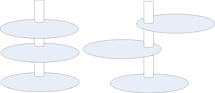

I just saw it happen to only one wheel (other wheel kept going). I think I’m going to rebuild my motor base/mounts and all… and at same time try to figure out a method to make everything more accessible. I was thinking of a single large diameter pipe that runs along the backside that everything attaches and all cables run through to and allow me to swivel the various build plates so I can work on them. Roughly and very crudely like this:

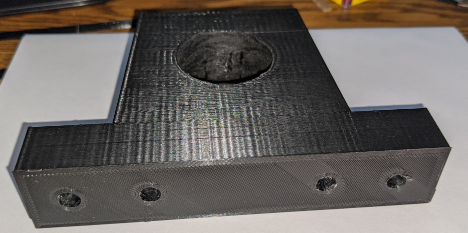

I started to print my mounts out. Here’s the first one… takes about 10 hours.
The mounts are rock-solid. I’d be really surprised if there are any issues with them. However, I’m not really experienced with 3D print designs and I wonder if the 50% infill I used was overkill? There’s four of these (two per wheel) and a caster that will be supporting all the robot’s weight. Maybe 40 lbs?
I’m also making a support mount to take a 3-inch pvc pipe… at 50% infill it’s going to take 17 hours to print. I don’t mind taking the time because I certainly don’t want to have to reprint them. This particular mount (located on the bottom plate) will take a lot of stress. Also, does anyone know if its feasible to glue PLA to PVC? I’d like to make sure the connection between the support pipe and the mount is as inflexible as possible.
I’d be real tempted to print one with 25% infill or less then do some destruct testing. I’d guess 25-35% would be more than enough.

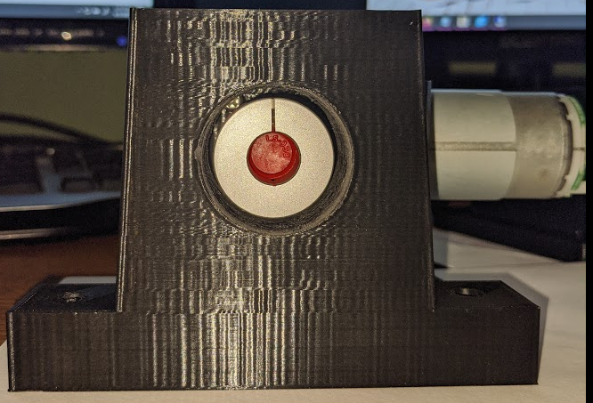

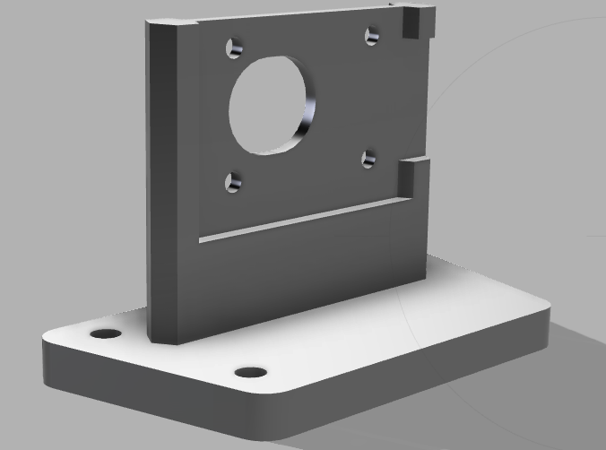

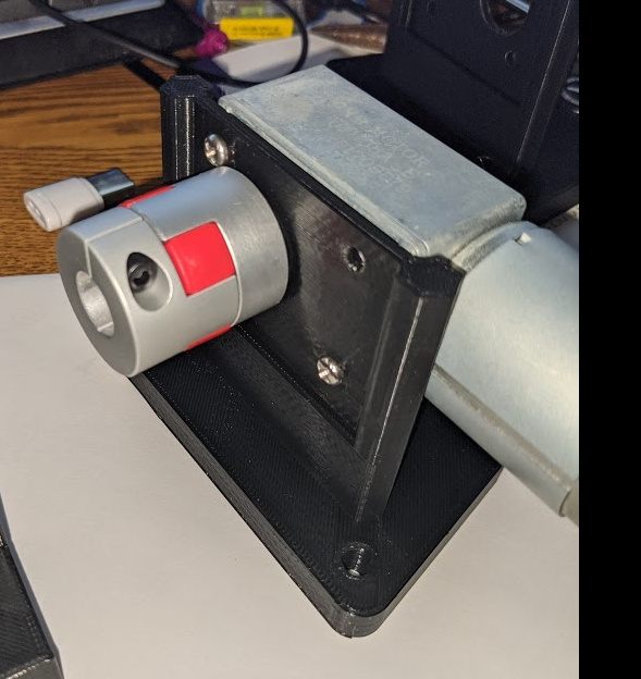

I used 25% on my motor mounts and it seems pretty solid also. This is the design for the mount. The goal was to make sure the motor height is aligned with the axle so there’s no adjustment needed.
This is one printed with the motor attached and the 1/2-inch to 8-mm spider coupler attached.
And to make sure it lined up with the axle mount…
