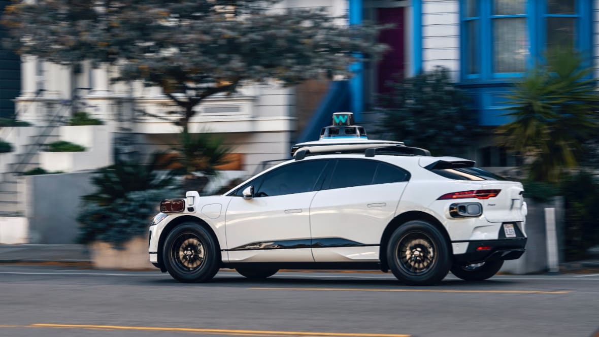

Keep in mind, even with google’s billions, the waymo autonomous jaguar is still the worlds ugliest jaguar:
Maybe you should spend some energy managing expectations?
