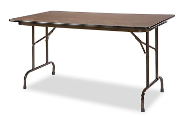

That makes sense. I have folding tables in my lab and the mapper sees the vertical inner posts but not the feet. The kinect notices those, but when its close, its out of the field of view.
But it seems that the feet don’t clear from the local costmap now that I stopped the mapper from clearing the local costmap as long as the kinect picks them up.
