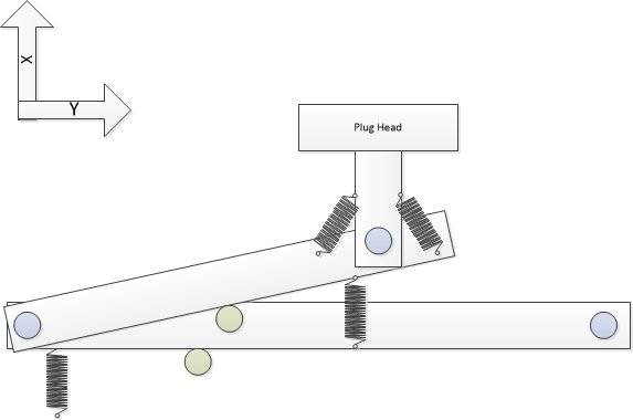

I’ve started to work on a design for a docking mechanism and since I know it will be hard to achieve a perfect alignment by moving the robot, I came up with a design to allow for the power head and power receptacle to ‘snap’ together using magnets. To work, I am thinking that placing the docking station power head on some kind of spring-loaded articulated arm would be relatively simple and give some flexibility in alignment. I’m confident I can ignore trying to align in the z axis (height) as that’s fixed. The idea is below:
The theory is that if the robot can get close enough such that the magnets start to interact and pull together, the arm can articulate and accommodate a move in the x-axis and y-axis as well as rotation of the head. When the robot pulls away to undock, the tension on the springs (hopefully) will be enough to disengage the head from the receptacle and the arm snaps back to resting position.
Any thoughts or better ideas? Open to suggestions.
Robot vacuums have the pads on the bottom and big push pins to touch them. I suspect it is because the distance to the ground is very constant, and that saves at least one degree of freedom. Magnets are going to need to be very close to snap at all. Like within 1/2".
Are you just feeding the pins with low voltage DC (12V)?
I think you’ll want to have some knowledge to give the planner or higher level control that you’re there, so it can back up and try again if/when it fails.
If it fails a lot, you might want it to slack or text you to ask for some help.
My hope was that I could get real close on x,y and then turn the robot to get close enough to align. I haven’t tried to see how much pull the magnets would exert, but 1/2-inch accuracy seems a bit daunting with move_base. I was thinking of using move_base to get about a foot away, and then using my own routine (like what I did above) to move in close and connect.
My coworker suggested looking into wireless chargers. Maybe I could get the robot to drive over a docking station well enough and then use multiple chargers or something to get the current level I need. Obviously do so would eliminating the onboard charger I have right now.
I’m not entirely sure what voltage to try if I stick with my current plan. It’s clearly safer to use 12V but if I do that, then it would prohibit me from just plugging straight into it from an AC extension cord like I can do today since the onboard charger would have to be relocated to the docking station. Regardless, before I did anything with power I wanted to see if I could just get the thing to reliably connect.
Either voltage that I end up with, my thought was to have an arduino controlled relay in the docking station that will only activate when a serial connection is made between the robot and docking station and the proper command sequence is sent and maintained. If the sequence fails, then the docking station would disengage the power. I was also going to use two pins on the robot’s arduino to look for continuity that would happen when the power connectors mated. That would stop the robot from moving and initiate the serial connection. If the serial connection failed then it would know it made imperfect contact and back away and try all over again.

I think the wireless inductive charging is well worth looking into.
If using physical contacts, I HIGHLY recommend sliding contacts of some sort.
Spring loaded arrangements are prone to getting dirty / oxidized / whatever, and this result in a high resistance electrical connection that is likely to overheat and melt and start a fire.
Contacts that slide relative to each other while making connection are self cleaning and much more reliable electrically. Think about the way AC plugs, Powerpole and JST connectors, etc. work.
The robot vacuums are probably a good example to follow, as I’m sure they’ve put a lot of work into reliable, safe connections.
Granted the 12v DC is safer, but a relay that only energizes the contacts after Floyd is the correct position might be a good idea regardless of the AC/DC and supply voltage chosen.
