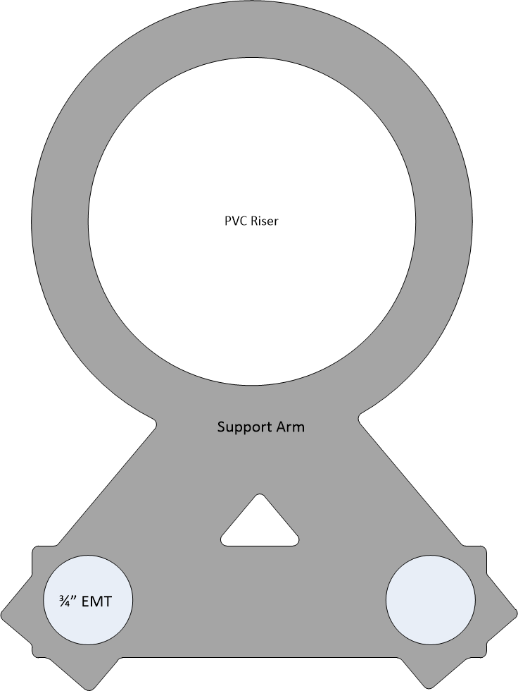

I was inspired by this design where the arm assembly moves up and down…

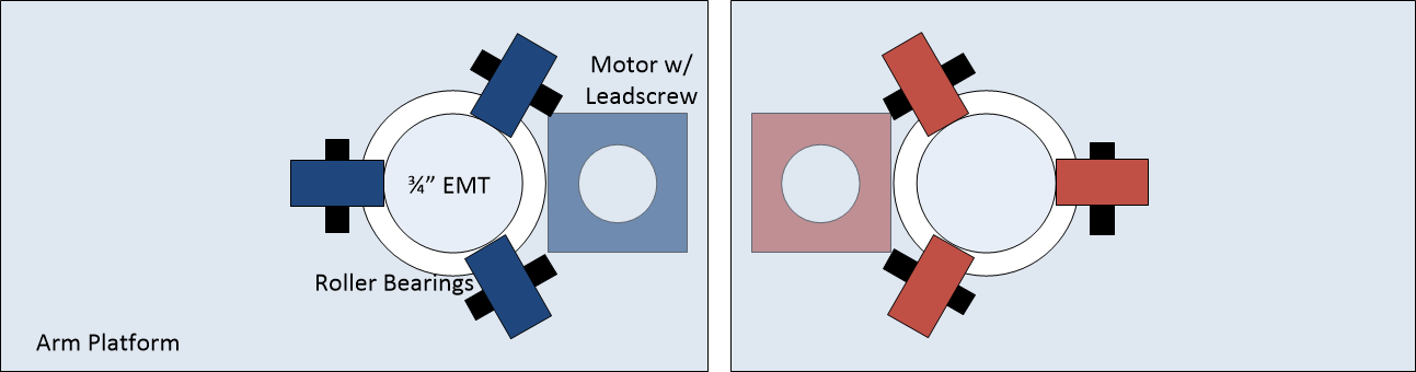

My design would be a bit different and maybe built to handle more weight, but I was thinking of stealing from ryan the idea of using bearings on two different 3/4-inch EMT with two motors and leadscrews to have two independent platforms that can raise up and down (crudely shown below)
The motor w/ leadscrew would be mounted to the base and a coupler would be attached to the arm platform so it would raise up and down as the leadscrew turns. The two EMT tubes would be fixed together at the bottom and the top for stability and they would also connect to the PVC riser so it doesn’t sway (crudely shown below)
See any issues… thoughts… suggestions?

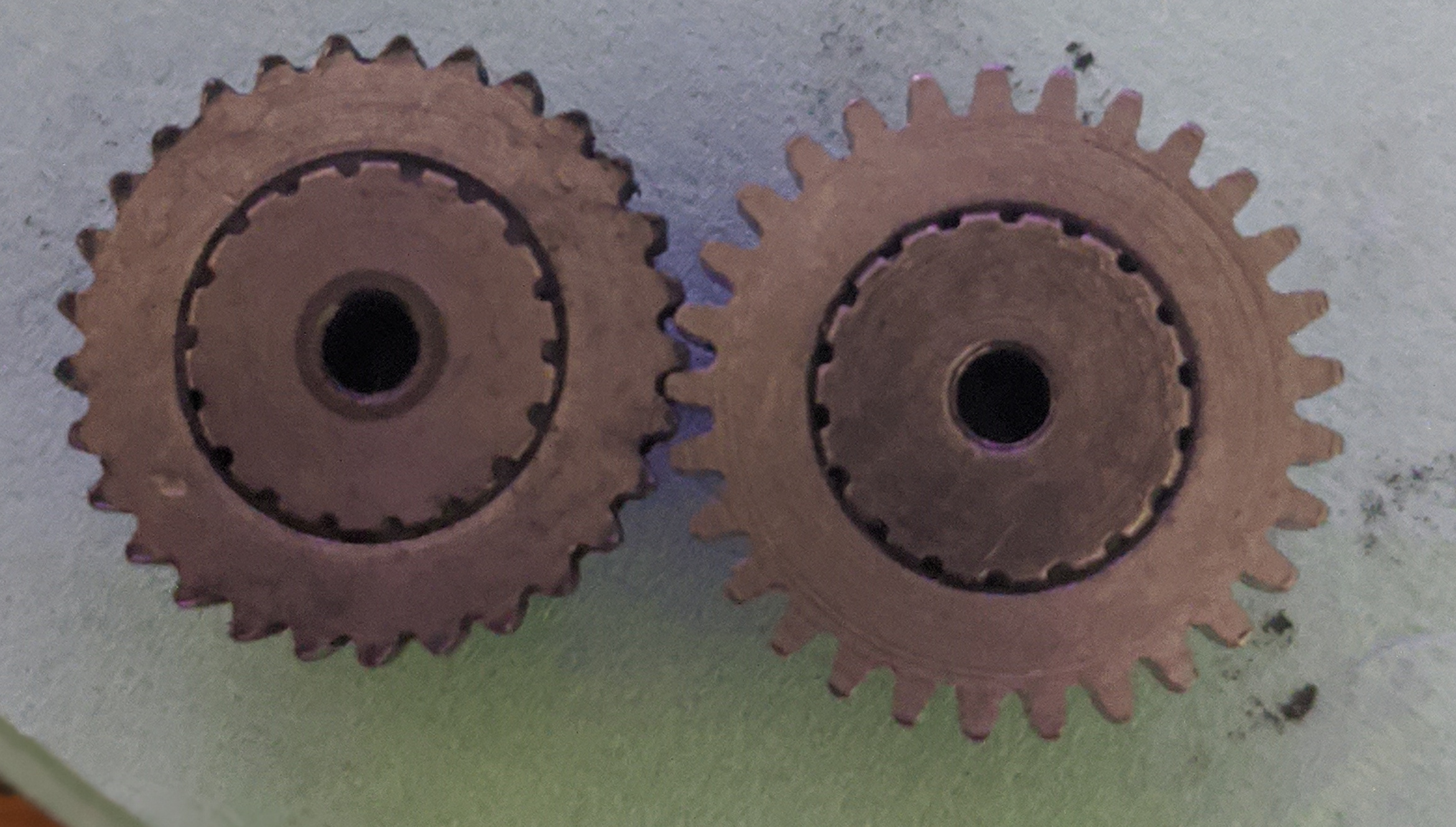

…the robot started to make popping noises. It had gotten stuck a few times and I assumed that, once again, the couplers had broken free from the shaft. I disassembled the bottom section to check the motors and sure enough, I could turn the right wheel backwards and it would ‘pop’. But I couldn’t turn it forward… and that concerned me. So I shown a flashlight at the motor’s shaft and turned the wheel backwards and the motor shaft moved with the coupler… so no slippage. However, this is a wormgear motor and it’s not supposed to be able to be moved (that’s why they are used in the Maslow… to support the sled when power goes off). The original maslow motors came with a particular gear made of plastic and its been known to wear out. I had bought some metal replacement gears when the motor manufacturer supplied some to Bar (the creator Maslow). I had only used one of the four gears to date so I opened up the motor and, to my surprise, the motor with the problem had the metal gear. I looked closely and saw that the gear was worn… so even the metal gear can wear out.
Hopefully it was mostly worn from use in the Maslow and not the robot. My design has the axle supported by two bearing blocks and the motor shouldn’t be carrying any weight…
But back to the voice control… It’s pretty awesome. I’ll demo it when the robot is put back together. I need to buy some degreaser and some grease because there’s metal shavings in the grease that’s in it right now. And I need to print out a new motor mount since I had to break the one off so I could get my angle grinder on the coupler and cut it away from the motor shaft (yes, the threadlocker worked REALLY well).
Motor fixed… runs much better now.

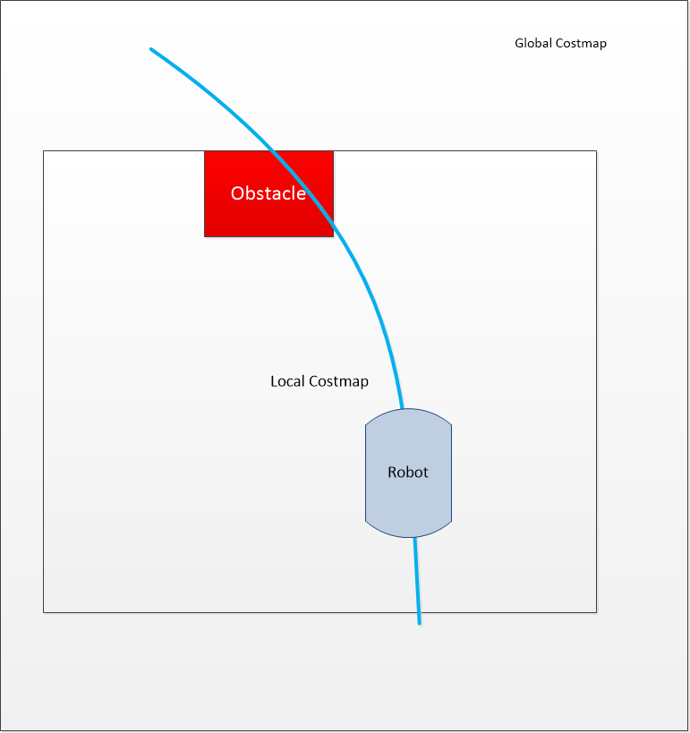

Ran into a couple of glitches. First is that I discovered that if an obstacle appears on the local costmap that’s at the edge of the costmap and the global path passes through it, the robot will stop. Picture below:
I would have thought the local planner could figure out to just go to the right of the obstacle, but apparently not. I tried a bunch of different settings and nothing would work. So I decided to add the kinect obstacle layer to the global planner so it would recreate the global path if an obstacle is detected. The robot then drove into a wall. Seems that recreating the global path too often can lead the local planner and the global planner to kind of start chasing/leading each other and then bad things happen. I discovered via googling that if I set the planner_frequency to 0 in move_base, the global path will be recalculated only if the robot finds itself stuck. That worked and in the above scenario, the global path would be created to go around the obstacle and the local planner then be able to avoid it… kinda…
When the obstacle is out of view of the kinect (because the kinect is high and looking forward), it disappears from the local cost map when the robot gets close to it and the local planner doesn’t really stick well enough to the global path, particularly during a curve portion of the global path, and the robot can bump into the obstacle. I plan to try to tweak the local planner settings to make it follow the global path as much as possible without losing the ability to get around obstacles in the global path on its own. I hope that works but if not, I’ll need to find other sensors to include to track very close-by obstacles that are out of the path of the robot (maybe go back to the sonar sensors, but limit their range).
