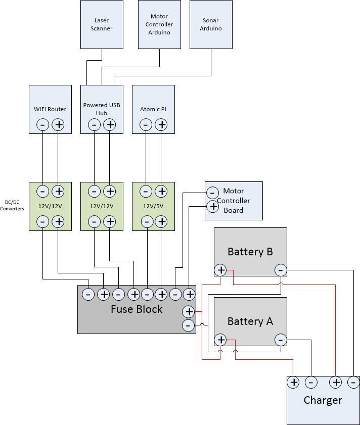

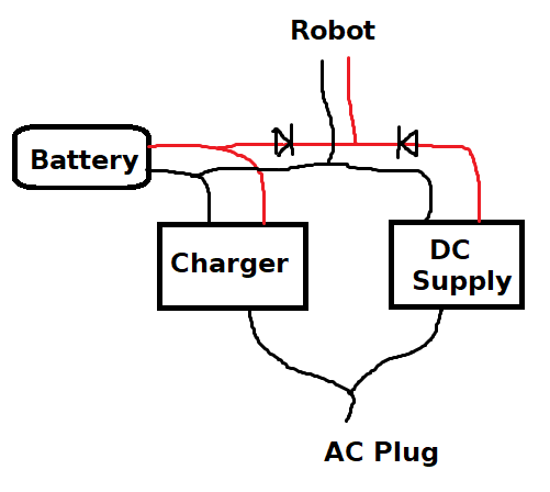

A dumb charger thats just constant current/constant voltage would be fine but a fancy one is going to sense the current to infer more about the battery and an extra load is going to hose that up for sure.
I’d say you would need a dumb charger or a separate supply, maybe slightly higher voltage and diodes so when the dc supply is unplugged (and presumably the battery charger) it will draw from the battery.
I’m not sure what you are suggesting. This is a rough sketch of how the power is currently hooked up. The charger is an on-board unit and stays connected to the batteries.

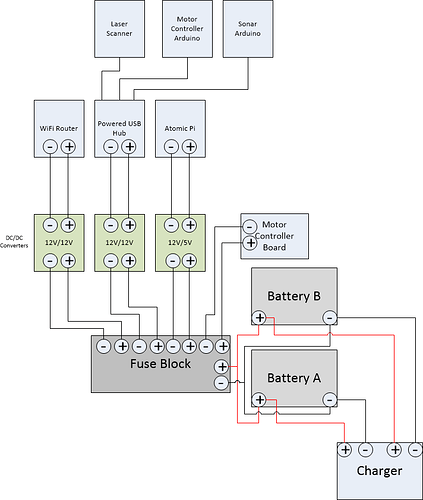

My idea is to add a relay on the input to the fuse block that will switch between battery and a AC/DC power supply. I could put in a manual switch, but I would need to make the switch happen quickly after plugging in the power cord so it switched over before the charger starts its analyze phase, therefore I thought a relay might make the most sense.
This is what I was thinking
If the DC supply is slightly higher voltage than the battery then no current will flow out of the charger/battery while the DC supply is on, so the charger and battery should be essentially isolated and shouldn’t get confused by the presence of the load or the DC supply. Then when power is cut it would automatically switch over to consuming from the battery. Not saying this is a great plan necessarily but clarifying what I was trying to describe.
A relay is also possible but I’m not sure how fast it would need to be and whether it would produce transients. If you have buck/boost converters in line anyway then they can probably absorb short transients so probably not a big issue.
Thanks, makes sense now. Simple is best so I’ll give it a shot. Something like a 15V or higher DC supply might work or is that cutting it too close? Charger hits around 13.2V iirc. I might have a have 15V or higher in my hoard. The motor controller is TLE5206 based so it can take up to 40V. The rest of the connections are isolated with buck/boost converters and seem fairly tolerable to input range. But I’d need some fairly big diodes… I had gotten some 3 amp 1N5404 diodes at one time if I can find them… in my hoard.
The diodes appeared to have worked. I connected up an old Dell 19v power supply with those diodes and the batteries fully charged (green light on the charger this morning). My current sensors arrive tomorrow and I’ll hook them up and print out a housing for everything… I’ve created sparks a few times with errant wrenches. Thanks again for the good idea.

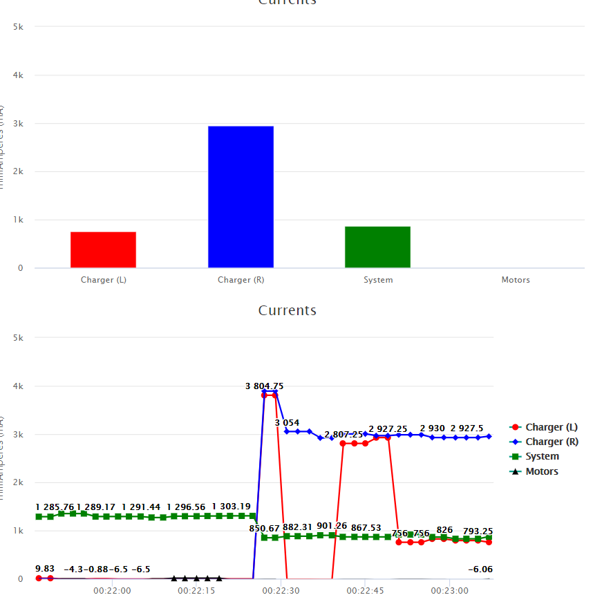

I got my voltage dividers and current sensors installed and connected them to an esp32 that I programmed to output webpages of the values. Here’s a screenshot of the current being monitored right after plugging in the power cord to charge the batteries.
What I found interesting was that the right battery is taking on 3A while the left battery is only taking on 1A. Both are paralleled (so would think they would tend to draw down evenly if everything is good) and get put on the charger at the exact same amount of time. So, I’m kinda thinking one battery is sick… lol… but don’t know which! It would explain why I don’t get as much battery life as I calculate. The system at steady-state draws about 1.3 - 1.5 A and with two 22AH battery, I get only about 10 hours… doesn’t add up. I might have harmed them by letting them get too low and then just sitting around. But now with remote monitoring ability, I should be able to prevent it… I need to add some email/push notifications to the esp32 program.
Batteries running parallel need to be pretty well matched. I am guessing the right is doing all the work and so it’s taking more current to charge. The left is dropping voltage quicker, while providing less current, leaving the right to do all the work. It’s like every school team project ever.
Truer words were never spoken.
When I checked about 30 minutes later, the right current had dropped to 1 A to match the left current. I don’t log that far back in time, so I don’t know when it did drop down, just somewhere between 5 and 30 minutes. It’s something I’ll keep an eye on now that I can see what’s going on. I’ll probably modify the software to track the various charging stages.
I wish I understood the battery charging technology better. The batteries are wired in parallel and so there’s electrical continuity between them. It just seems to violate ohms law to be able to send specific amounts of current to particular batteries.

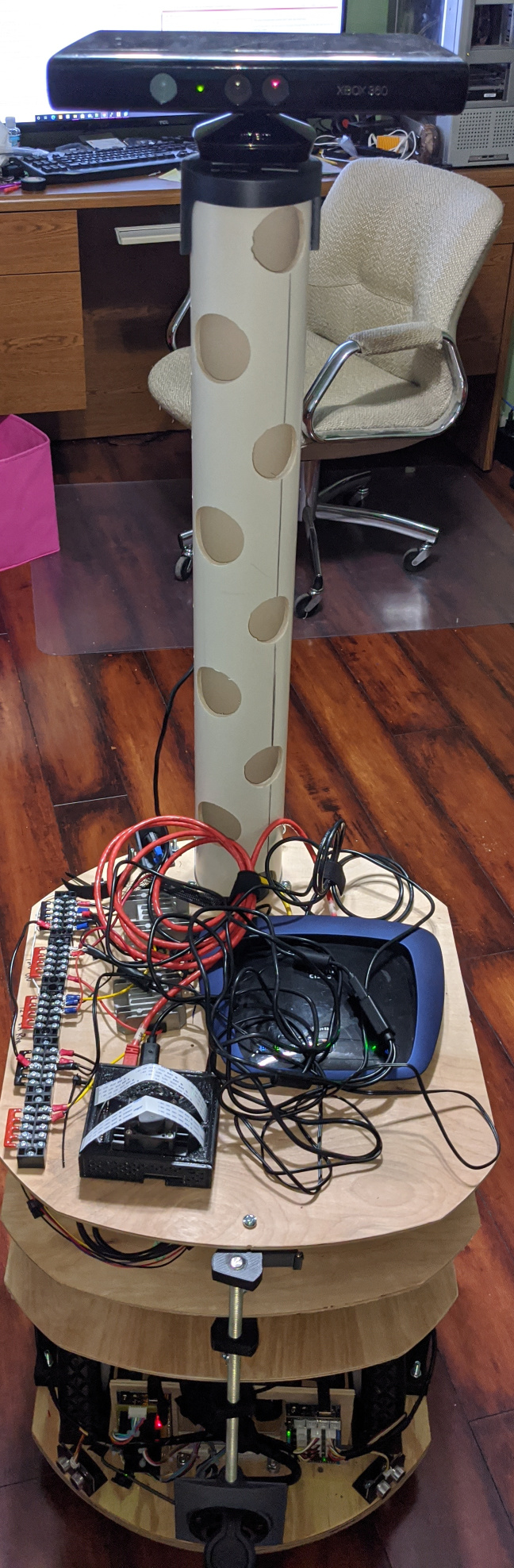

Two big steps forward… one big step back. After a lot of work getting ROS melodic up and running and everything talking to it properly, it’s moving around the room very well with the sonar sensors and the laserscanner. However, my wife is reorganizing rooms upstairs and has packed the hallway with ‘crapple’ (what I call stuff that really should be taken to the garbage, but for some reason she wants to keep) and its too narrow for the robot to even attempt to go down.
After deciding to wait for the hallway to get cleared-up so I can try to navigate through the doorway, I went ahead and connected the Kinect back up to see how it performed. To keep a long story relatively short, after 16 grueling hours of troubleshooting and deep diving into source code, I discovered that the Atomic Pi, with a single USB 3.0 port (no 2.0 ports), somehow doesn’t have enough ‘bandwidth’ to support the Kinect and ANYTHING else… I can have a Kinect and nothing else, or everything else (two arduinos, esp32) and no Kinect. I’m not sure why the Kinect 360 takes all the bandwidth of a USB 3.0 port as I thought it was a 2.0 device.

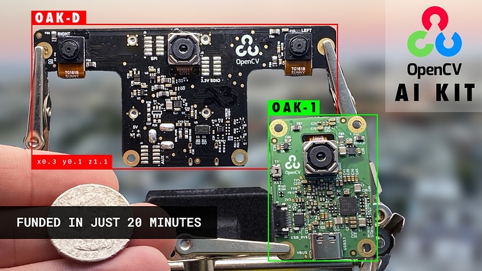

Since the kinect doesn’t require an x86, I could put it on an RPI or the Jetson Nano I have, but I’m always thinking about power consumption and if I can get it done in one box, I’d rather keep it that way. I don’t have an explicit use form my Jetson Nano now that I backed this kickstarter:
I’m hoping that will replace what I was going to try to build with the nano so maybe I can use that if the Rock Pi X isn’t up to doing everything. I might be asking too much of a single atom processor to do (navigation + camera-based mapping). I’m looking at using STVL with the Kinect to create costmap.

I now have the kinect mounted to the top of the PVC support pipe. It’s tilted down ~25 degrees and has good vision of obstacles. I used depth_nav_tools to convert the kinect’s depthimage to a laserscan. Once I aligned that laserscan with the mapper’s laserscan, I was finally able to get the robot to navigate through the door of my ‘lab’ and out into the hallway. But, I had to disable the sonar sensors to do so. Maybe they aren’t accurate enough our something. I might move them all to the back and just use them as backup sensors so they have little effect on forward navigation. The whole thing moves a lot better than my previous model… so I think the 3d printed parts for the motor and bearing mounts were definitely the way to go. The narrower design (2-inches cut off each side) seems to help as well.
I’m still waiting on the Radxa Rock Pi X to arrive, so I’m still using the atomic pi and added my jetson nano to do the kinect processing. Please excuse the mess of cables… it’s temporary.
