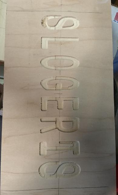

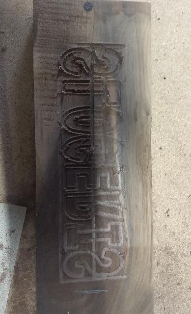

Hello I am having issues with my machine adding cuts where none should be, Made the program using F-Engrave checked with Estl-cam and Camotics and both show that everything looked good but when I run it things good amuck. Using Repetier-host to run from a laptop and just upgraded Repetier-host with no improvement.
The machine just does what it is told. Most problems that cause extra cuts are not recoverable (so it would get deeper and deeper). So I am suspect of your gcode and CAM. Have you ran the test crown successfully?
Post your gcode and it might be apparent. I am going to guess a few very fast Z up and down movements that are just vibrating in place instead of raising/lowering, which drags the tool through your work.
Yes I ran the crown program and everything came out good.
