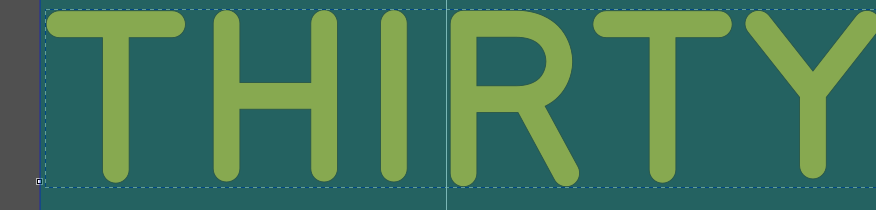

I’m getting stuck though finding a software package that will read the font file and convert it to the proper path for cutting.

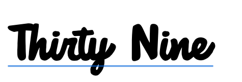

This is the text in question, rendered in MS Word on my Mac
Yet when I try to any number of things in Rhino or Inkscape I always end up with this

It looks you are writing the whole thing with Caps!lock on
. Capital leters will not be attached one and the other. Try lightburn it will make your live easier to work with the text then you can expor the dxf files
In the example photos, look at #9 it shows all caps are individual, the only linked ones are tle lower ones

Thanks Cesar - There was no re-typing. That was a ctrl-c ctrl-v from Word to Inkscape that changed from cursive to all caps.
I think it is a weird Mac font thing, because the image that pastes in inkscape is from the font family, but wasn’t the one I had in word.

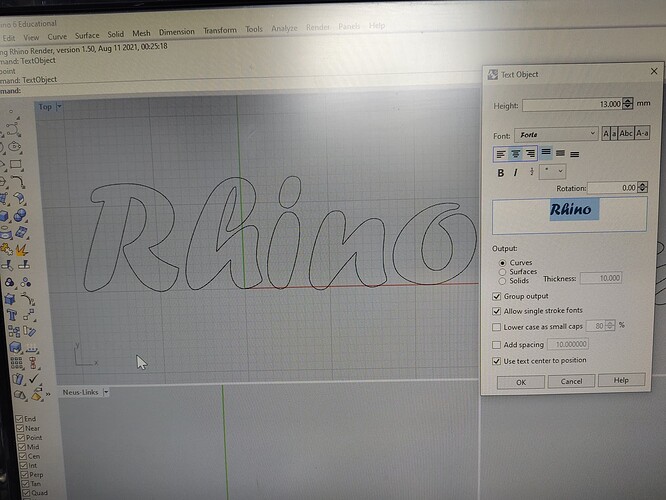

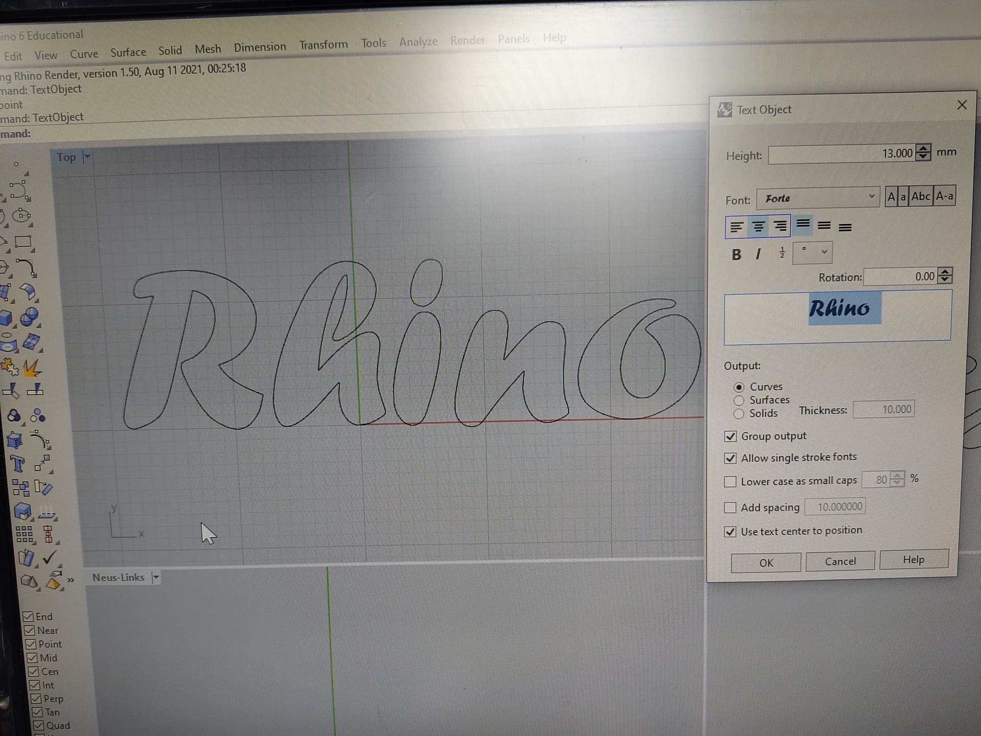

in Rhino, do you type the letters with Text or with TextObject. if you type it with TextObject, do you select curves or solids or surfaces. I often use Forte
it is important to adjust the curves to ClosedCrv. SelClosedCrv let you see wich one to adjust
