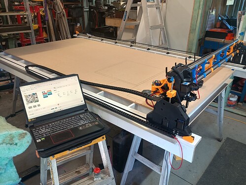

Hi All,
Ive just finished assembling my 2400x1200 LR V4 (upgrade from Primo). Had a few teething issues with motors dropping out but that is all sorted and the machine is functioning mostly as expected.
The problem is loosing size along both X and Y. Z also might be loosing a little but harder to check over the shorter travel.
What I’m doing -
  • Home X,Y,Z. and set to 0,0,0.
  • Move Y 2300 (from webUI command)
  • Measure actual travel = 2294 (6mm lost)
  • Move Y 0
  • Measure actual travel =2294 (exactly where it started)
Same process with X and Z and at other distances. From what I can tell I seem to be loosing roughly 0.25mm per 100mm both X and Y. Z I’m not sold if I’m losing anything or not.
Otherwise everything seems to function as expected. Running Gcode from estlcam works fine other than loosing mm in the same fashion.
I’m running -
Jackpot CNC (elecrow)
ESP32 (amazon) FluidNC V3.9.1
TMC2209 (lerdge, waiting on some BTT ones)
Configs from V1 Github.
Side note - when does one tighten the “cross tensioner screws”. The docs say to leave them out for now. But i cant find when to put them in/tighten them.
Thanks.
