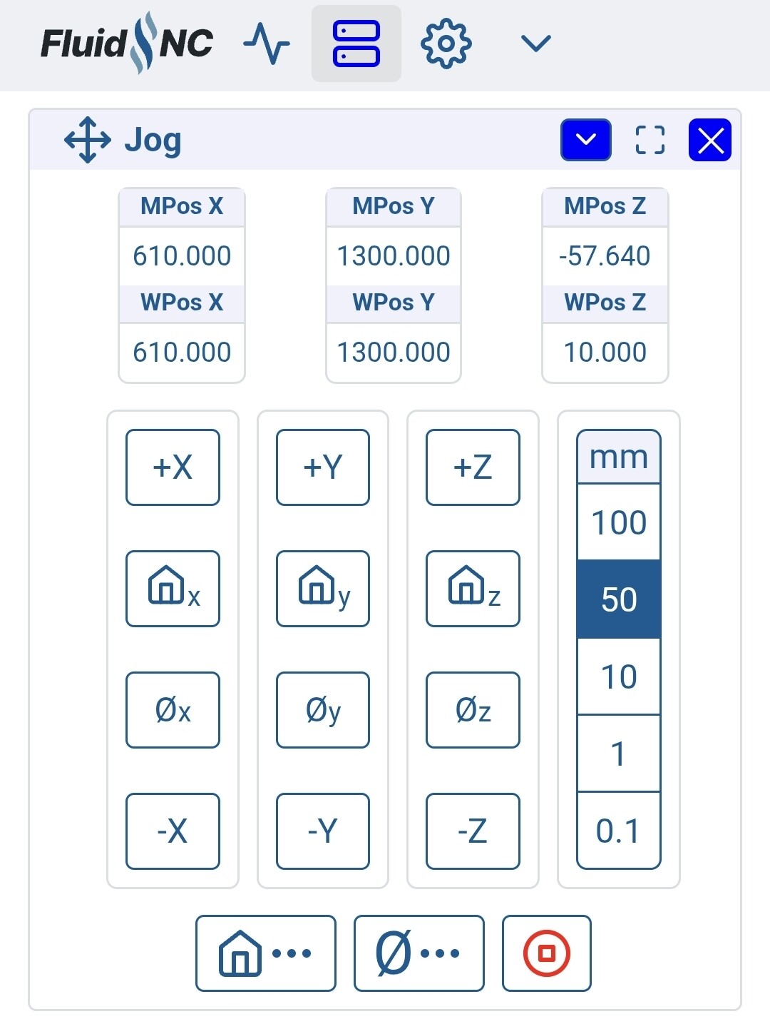

Could someone post a screen shot showing which values to read at this step? Do I read the PRB values or the MPos values? Does it matter?

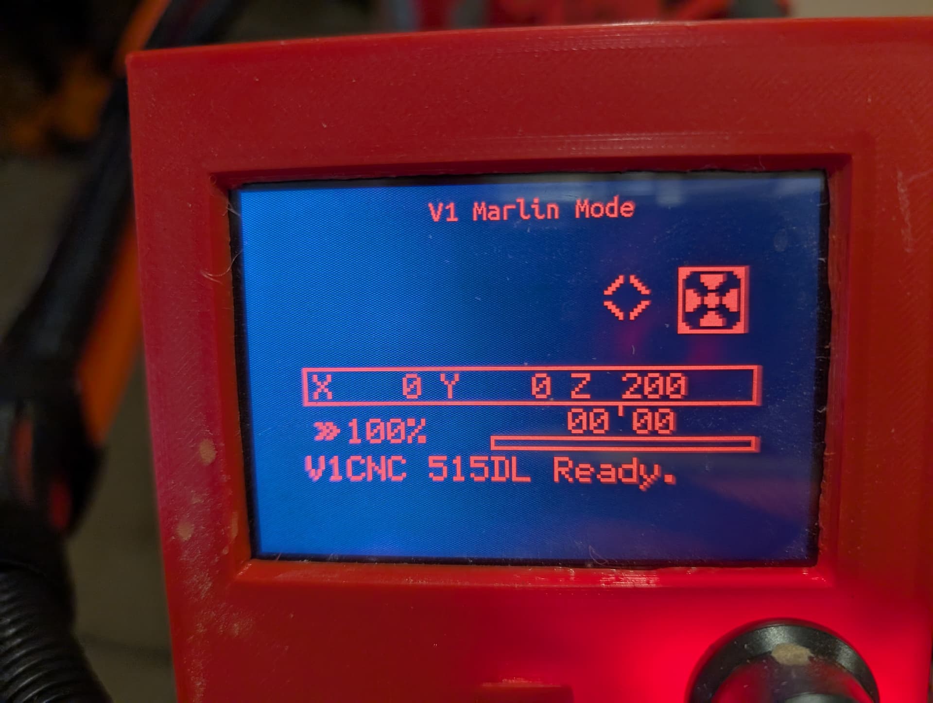

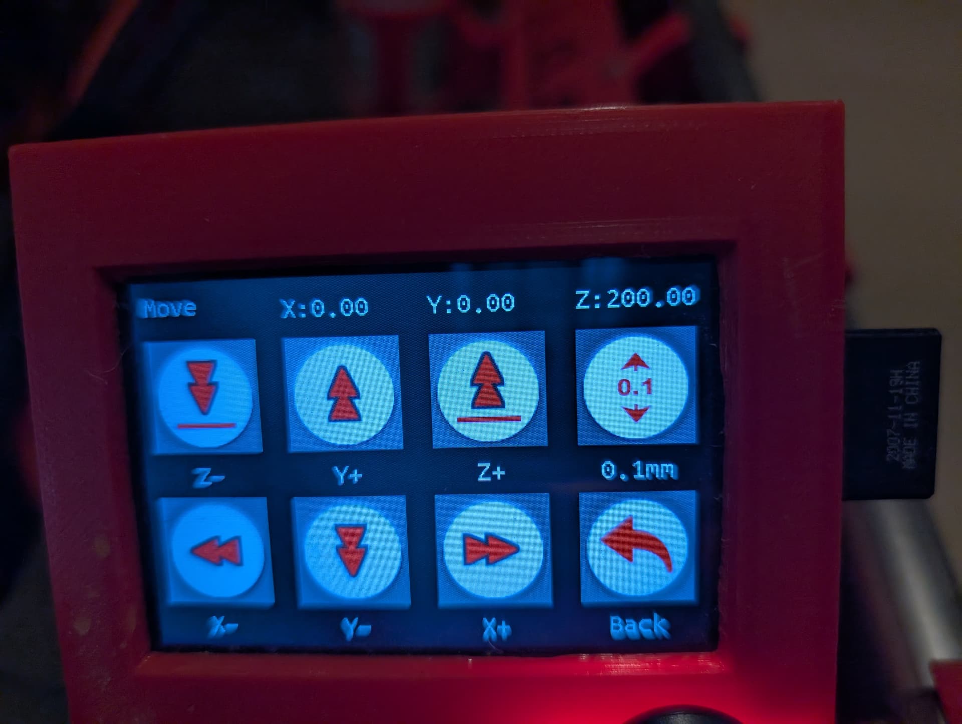

On the SKR, the display will show the X, Y & Z positions. After setting Z=0 at XMin, and then probing again at ZMax (without re-setting Z=(n)), the display should read a value close to (but seldom equal to) 0
These pictures show the position after Homing all three axis, but before probing (Z=200)
In Marlin Mode:
In Touch Mode:

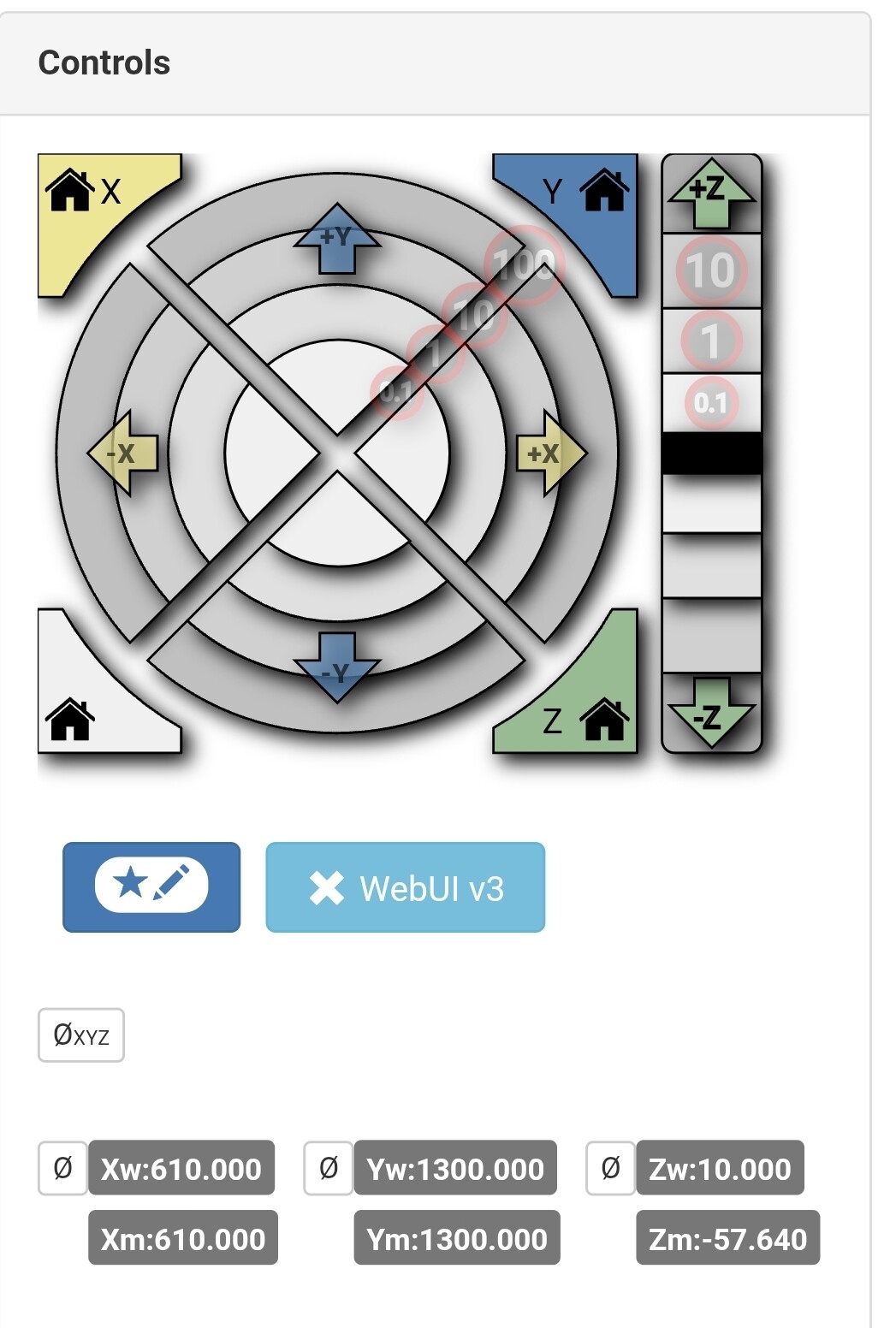

Thanks @Bartman. I should have been more specific because I do have a Jackpot.
I’ve done this a bunch of times with the Jackpot but I’m blanking a bit. I think you just want to look at the Z position in the working coordinates. I can check later.
Well, for Z leveling with FluidNC (and really anything), you could use either working or machine coordinates. I typically use machine coordinates. If you used working coordinates, depending on how you probed, it could zero those.
In WebUI v2, that’s Zm.
In WebUI v3, that Mpos Z.
The instructions above use working coordinates. So, you probe and zero Z at X min, and then measure at X max to get the difference without re-zeroing. I typically probe in each spot 3 times to take an average so that process doesn’t quite work.
I’m hesitant to say this but I have some automated ways of doing this for FluidNC but they’re half baked. I had a gcode script to do the whole thing and also an extension. I should revisit. It’s one of those things you do so infrequently and it’s not that difficult to do manually that I’m not sure how much value they have.

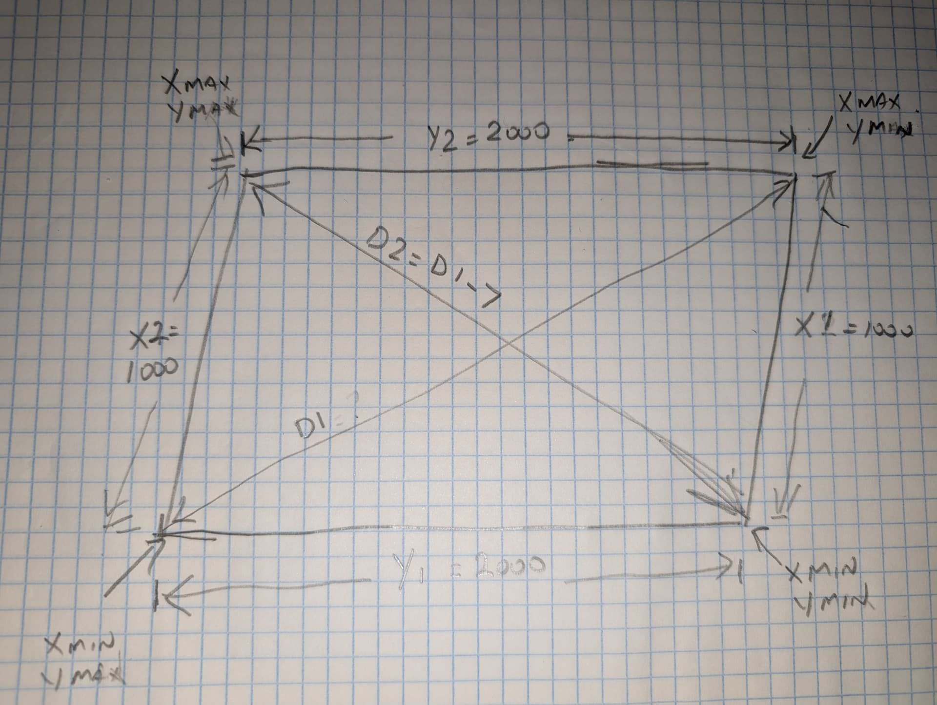

Is this about adjusting belt tension? Or moving whole belt-holding block? My difference in diagonals is 7mm and documentation says to minimise it before changing M666 value.
Can anyone explain, please?
The purpose of adjusting the Y stops is to.square the machine, such thst the X axis is as close to 90° from the Y axis as possible. By changing the start points on either end of the X axis we can ensure that cuts made on the X axis are perpendicular to cuts along the Y axis.
The Y axis follows the Y rail, but the X axis follows the Y endstops on either side. If these are not square to the Y rail, then they need adjustment.
@SupraGuy nailed the answer. By moving the endstop, you are in effect moving one end of the X axis (gantry) in order to make it perpendicular to the Y axis.
In this case it makes sense to reposition one of the Y endstops, rather than try to compensate for such a large difference using the offset.
In the drawing, the endstop at XMax YMin is too far to the right (or the endstop at XMin YMin is too far to the left) and the result is that D1 is 7mm longer than D2.
By repositioning one of the endstops (XMax to the left or XMin to the right), you are bringing the angle closer to 90 degrees, which will result in D1 being closer in length to D2.
If the difference between D1 and D2 is only a couple of mm, then the M666 method is appropriate, as it is fairly difficult to make such fine adjustments by repositioning the endstop hold down screws (which is why I used an adjustment screw on the edges of my endstops).
