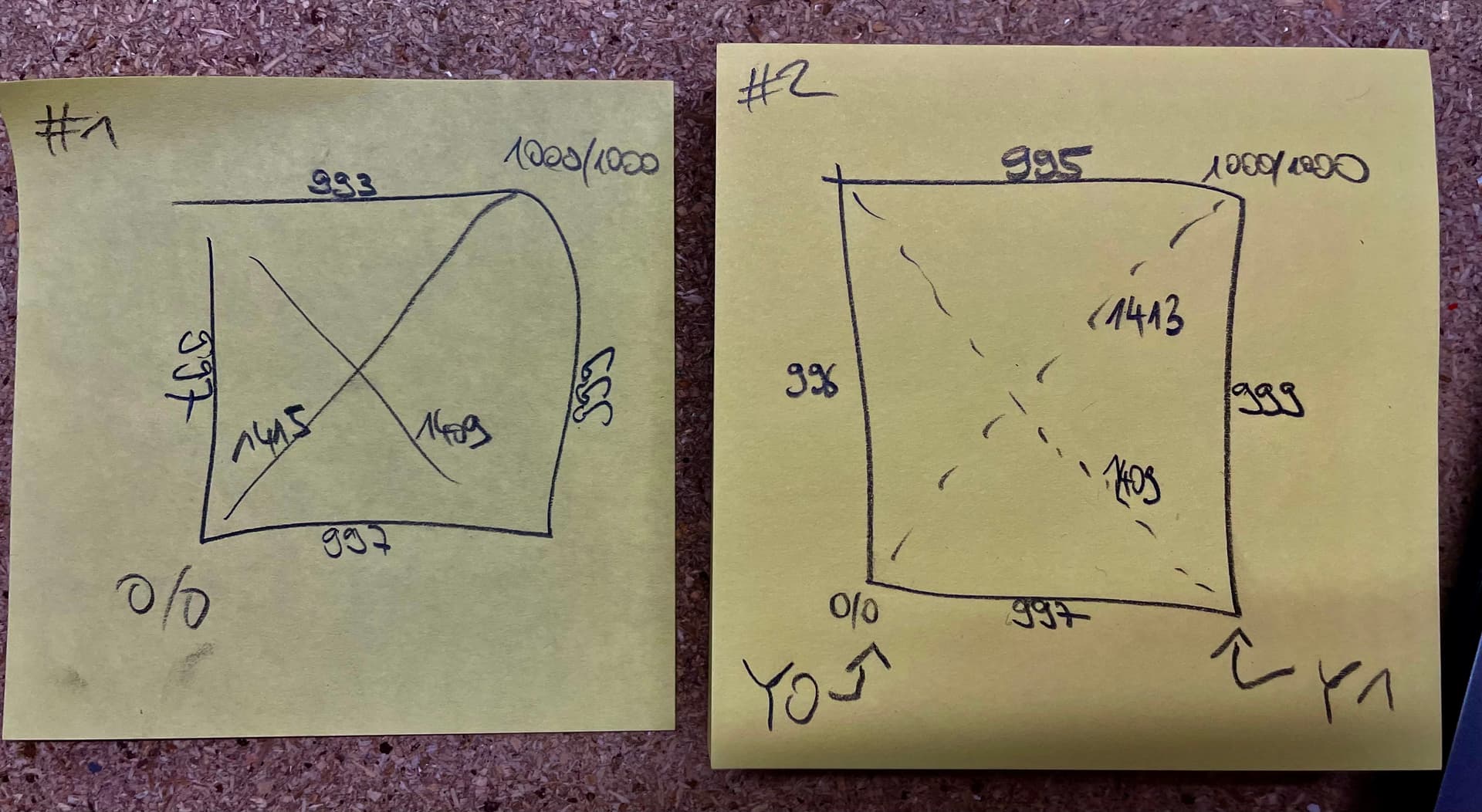

In my 1x1m LRv4 build I am trying to calibrate squareness for over two days without luck, meaining a diagonal difference of less than 5mm over 1m.
However, after revisiting the belt steps calibration step, I just noticed that when asking the machine to move 1000mm, the left side (“Y0” on my machine) actually travels 994mm, while the right side travels only 981mm. This is with the pulloff values back to stock, i.e. 4mm for each Y motor.
What I checked:
  • Belt tension on Y0 and Y1 seems even (and not too tight).
  • Measurements have been identical via laser and tape measure.

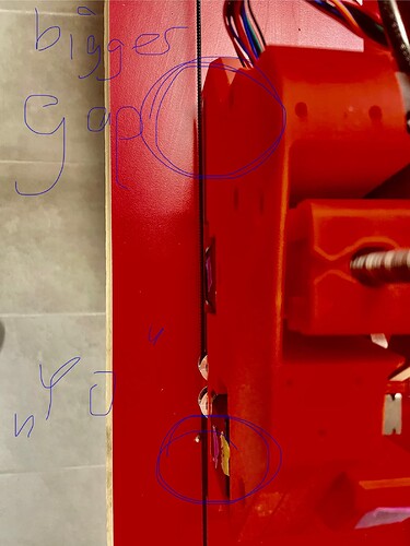

What I also noticed and might be related: The X beam is not 100% parallel to the belts, see picture below.
What could be the cause of this unevenness and what a potential fix?

I agree with @azab2c . The gap you’re seeing in the belts is likely caused by the inconsistent moving, not the cause of it. Since one side is moving less than the other, the gantry becomes angled, so the front and back will be different distances away.
I would check grub screws first and then belt pitch. To check belt pick you’ll want to line the belts up next to each other and see that all the teeth align.
Miscalibrated tension for me leads to errors in the 3mm range, not 13mm for sure.

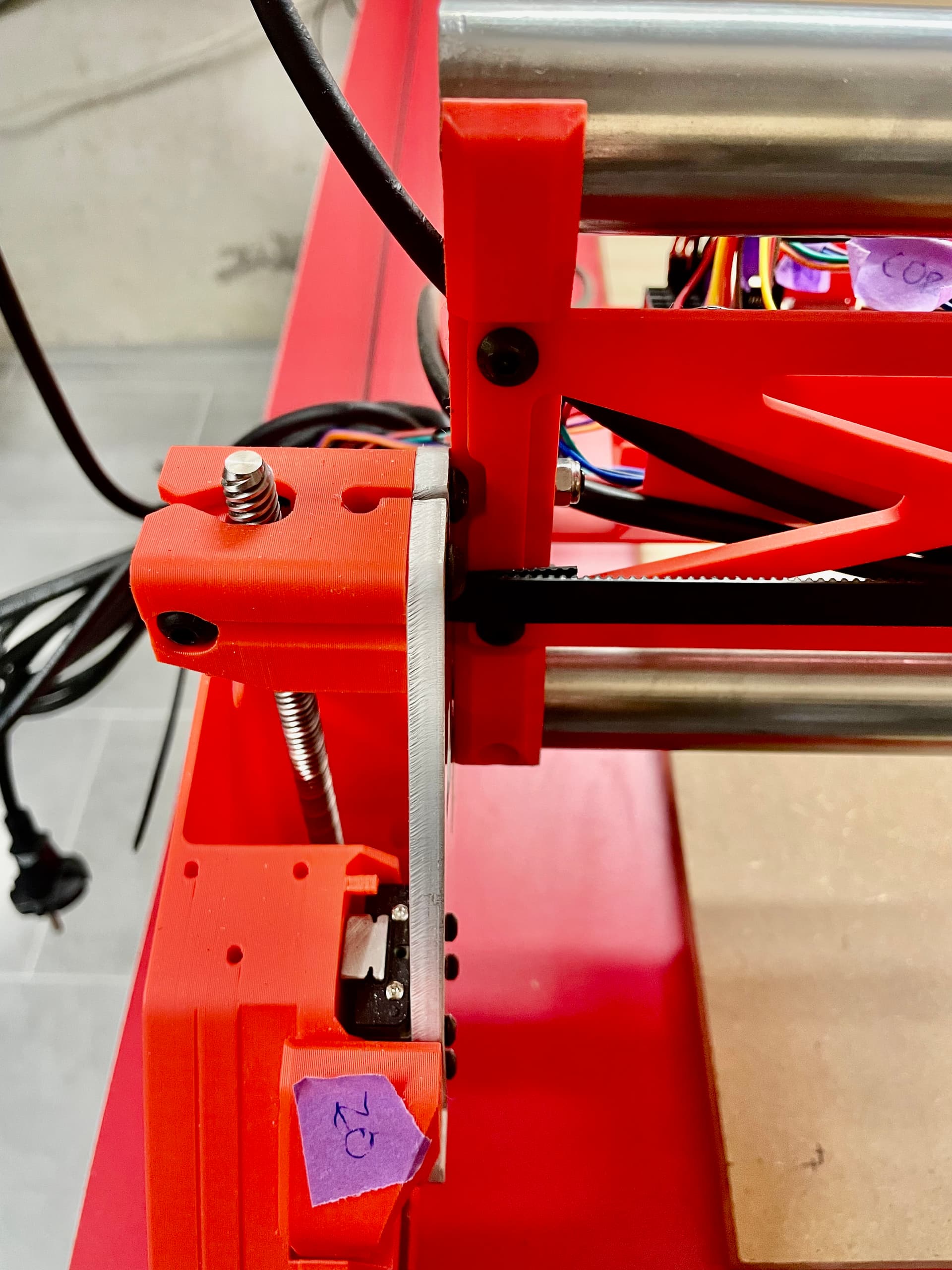

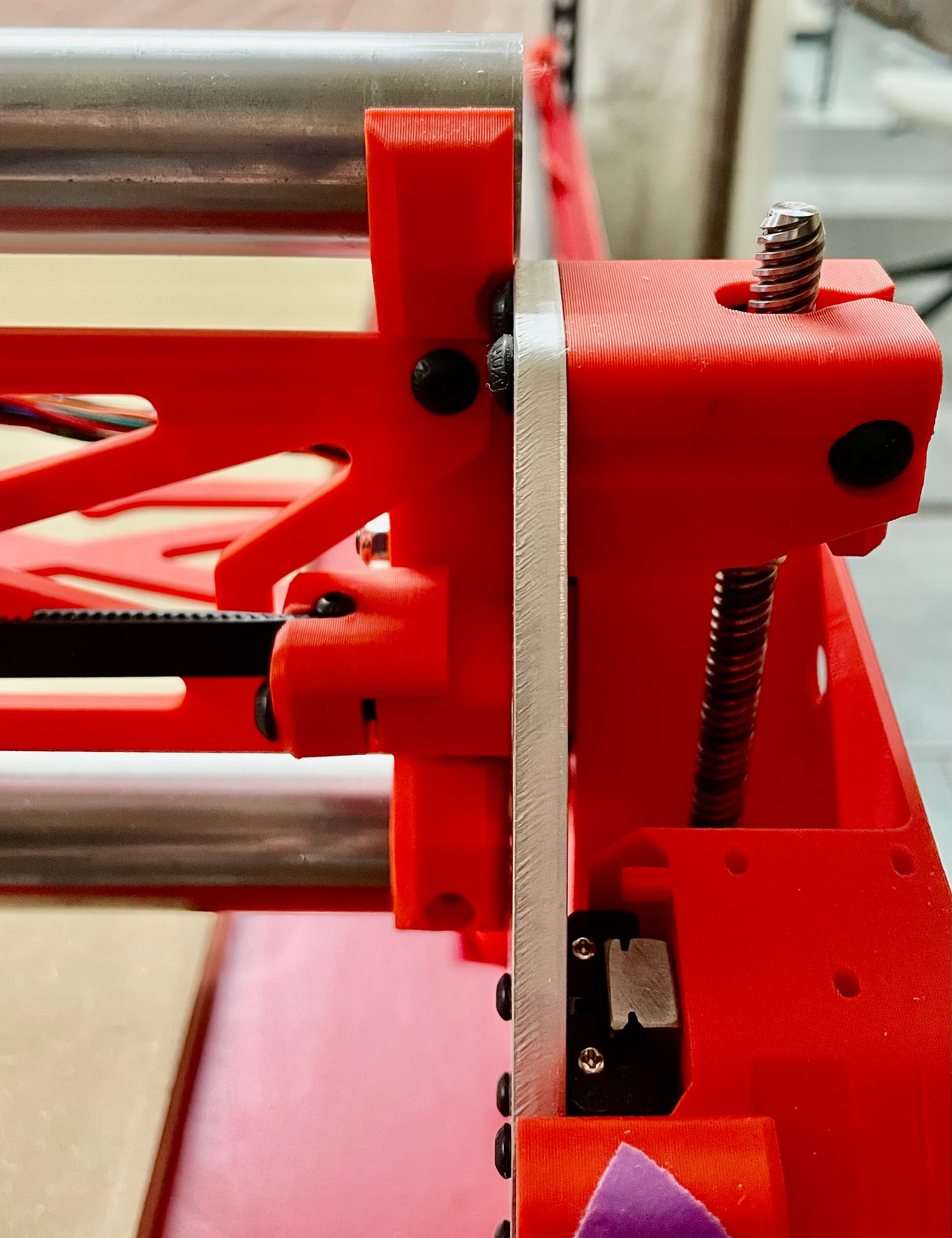

Re. the mechanical aspects, I measured the total span of the X beam on both “feet” sides today with 1mm difference and just now only between the XZ plates of also 1mm, which I considered ok (let me know if not). On the left side, I can fully insert a piece of paper between the lower rail and the XZ plate, on the right side the paper goes in about 50% of the way compared to this, pictures:

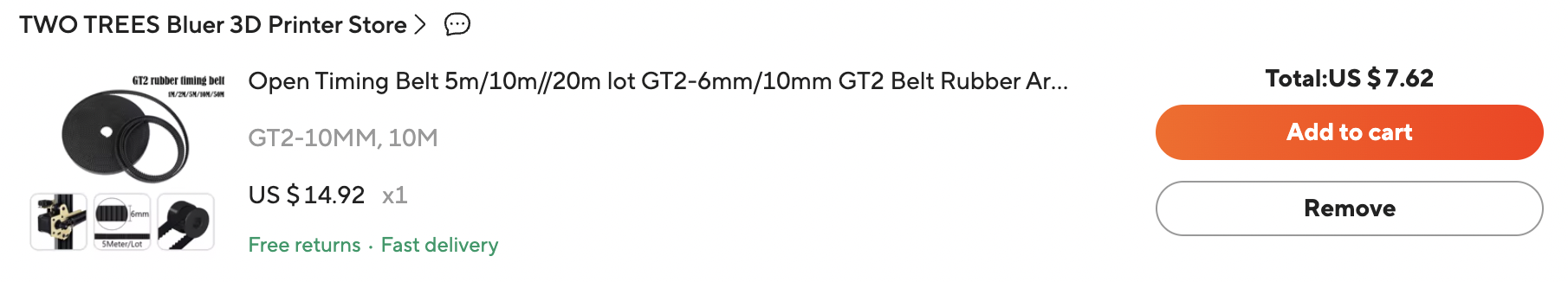

The belts I sourced from AliExpress are linked here.

Turns out, you are right about the grub screw, @azab2c! The second one on the Y1 axis motor was very loose. After tightening this and all others just to be safe, I can no longer move the Y1 axis by hand while the steppers have power. Thanks much!
Measuring everything again twice with a laser still leaves me with a 2-4mm difference on the Y travel over 1000mm (as well as for X).
3mm difference between Y0 and Y1 is is not entirely unexpected. Many people would just live with that (0.3% error over 1000 mm). If you want to increase the accuracy of your build (“chase zeros”), the best way (IMO) to compensate for that is NOT to adjust the steps.mm, but to adjust the belt tension.
Compare the distances of both Y motors to the distance expected. If both motors are somewhat shorter than expected, you can tighten the belts to increase the distance/tooth on both. Similarly if one motor travels less than the other, you can tighten the belt on the shorter travelling side to bring them closer to equal.
The pitch of the M3 screws is 0.5mm/thread, so two full turns of the screw should adjust your total travel over the entire belt length by 1mm (better to measure distance over the entire belt length, rather than just 1m IMO).
Obviously you don’t want the belts “guitar string tight”, but increasing the tension by a few mm over a long distance should be okay (IMO).
But I would also start to suspect measurement errors, based on the difference in X travel in different gantry positions. X distance is a function of only one motor travelling, so any differences show an inconsistency that is either a build issue (loose grub screw, looseness in the core, etc.), or a measurement error.
Thanks much, @Bartman! I have tightened the belts a little. Now my diagonals are only 1-2mm from the mathematical ideal value (1414mm for 1x1m working area). I will leave it at this for now.
Thank you all for your help - much appreciated!

Modifying the steps/mm helped for the last millimeters. I suspect the remaining minor differences to the ideal values (1000mm for the axes and 1414mm for the diagonals) to be measurement errors - same for the previous and remaining 1mm differences between sides.
