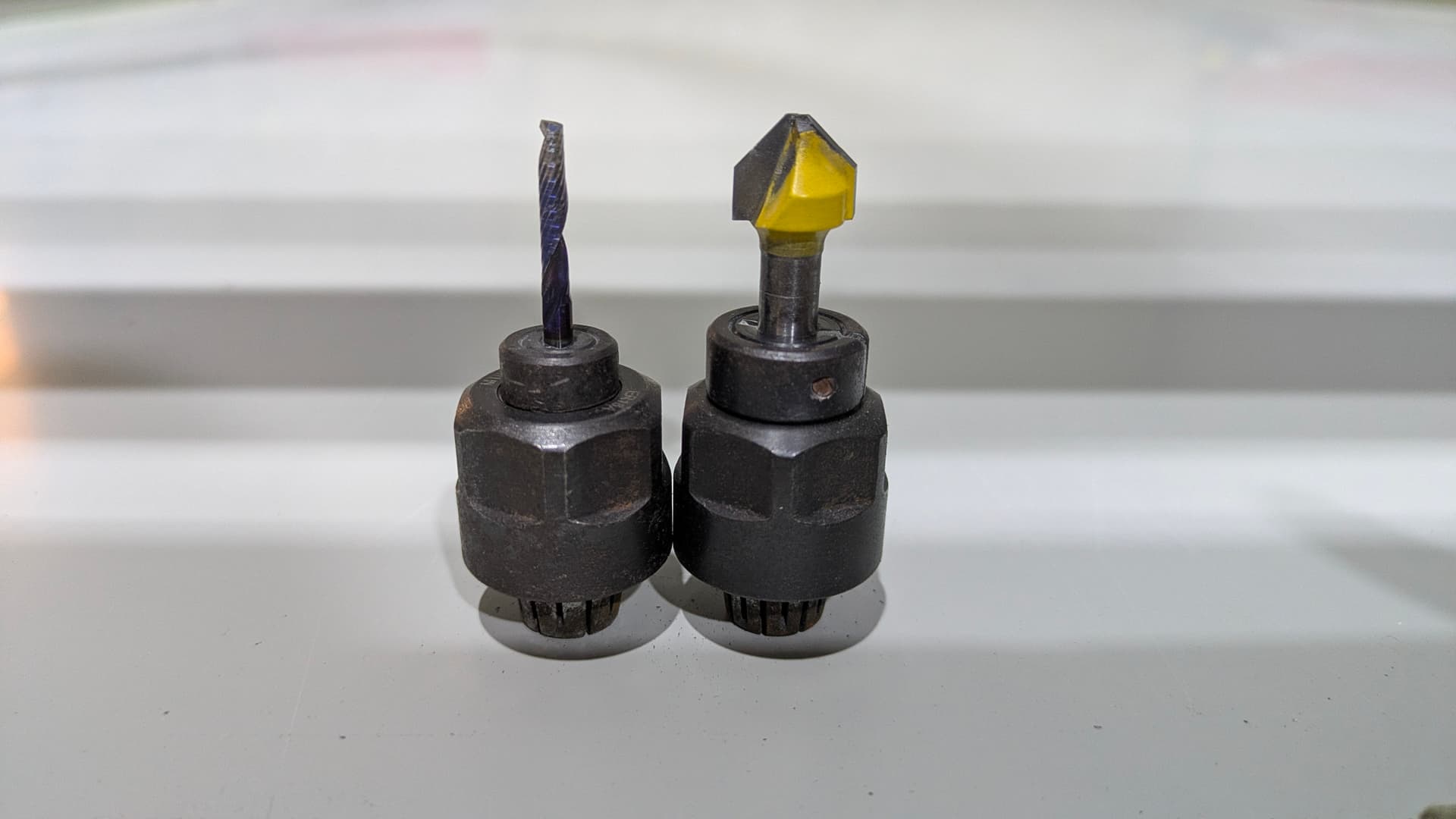

Man. Its really wasy to do fast bit changes: you can use a muscle chuck, or as i do: a bit speed setter with some stop collars. Less than 1 mins bit change

Bit changes (speed edition)

They also have a quick release version (that should make bit changes less than 15 secs)

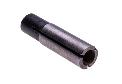

I understand it does make sense to use 1/8” tools, as they are way cheaper. However, in the German market, most routers come with 6mm or 8mm collars.
Are there any noticeable disadvantages in using an adapter like this?
