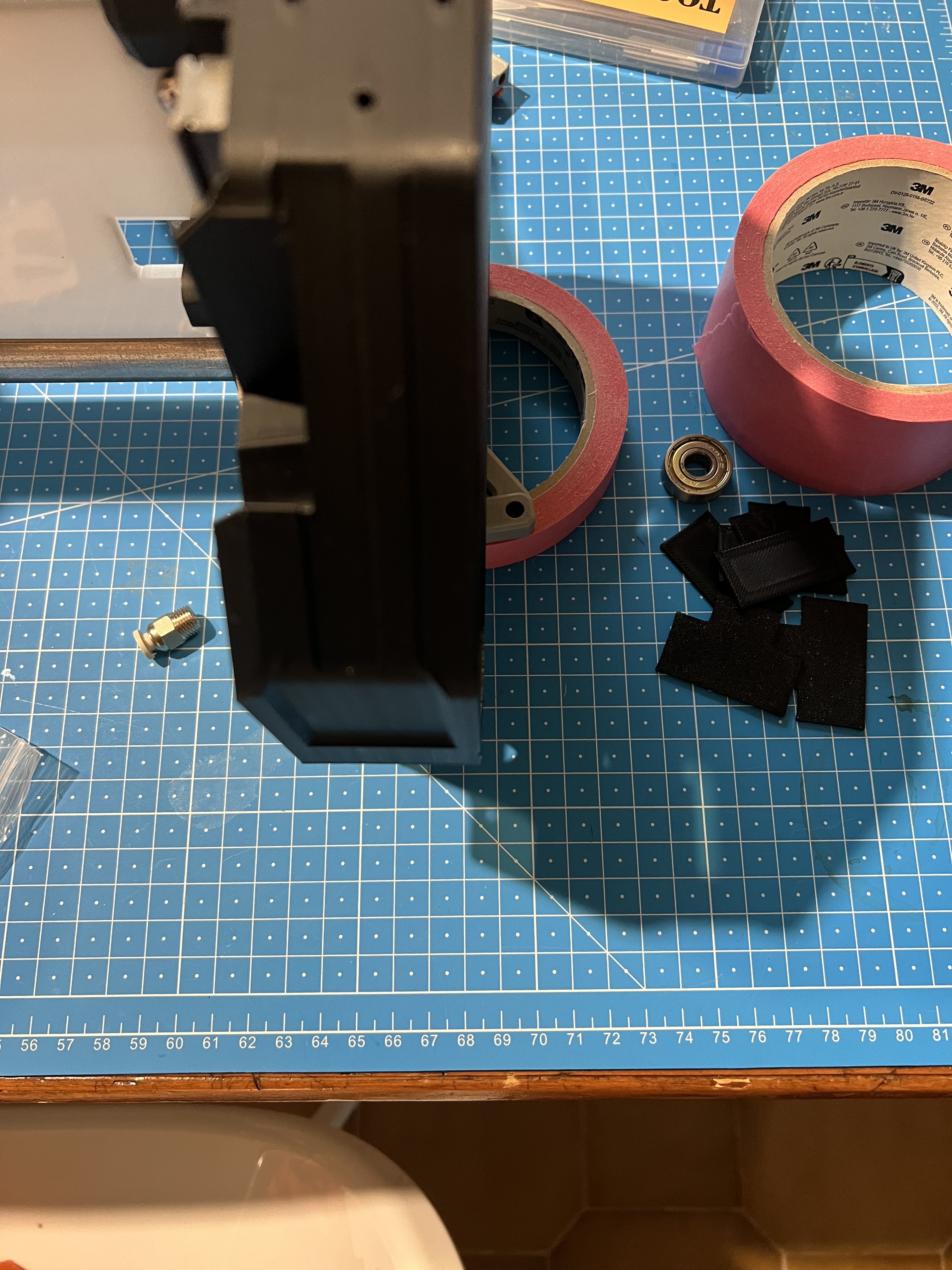

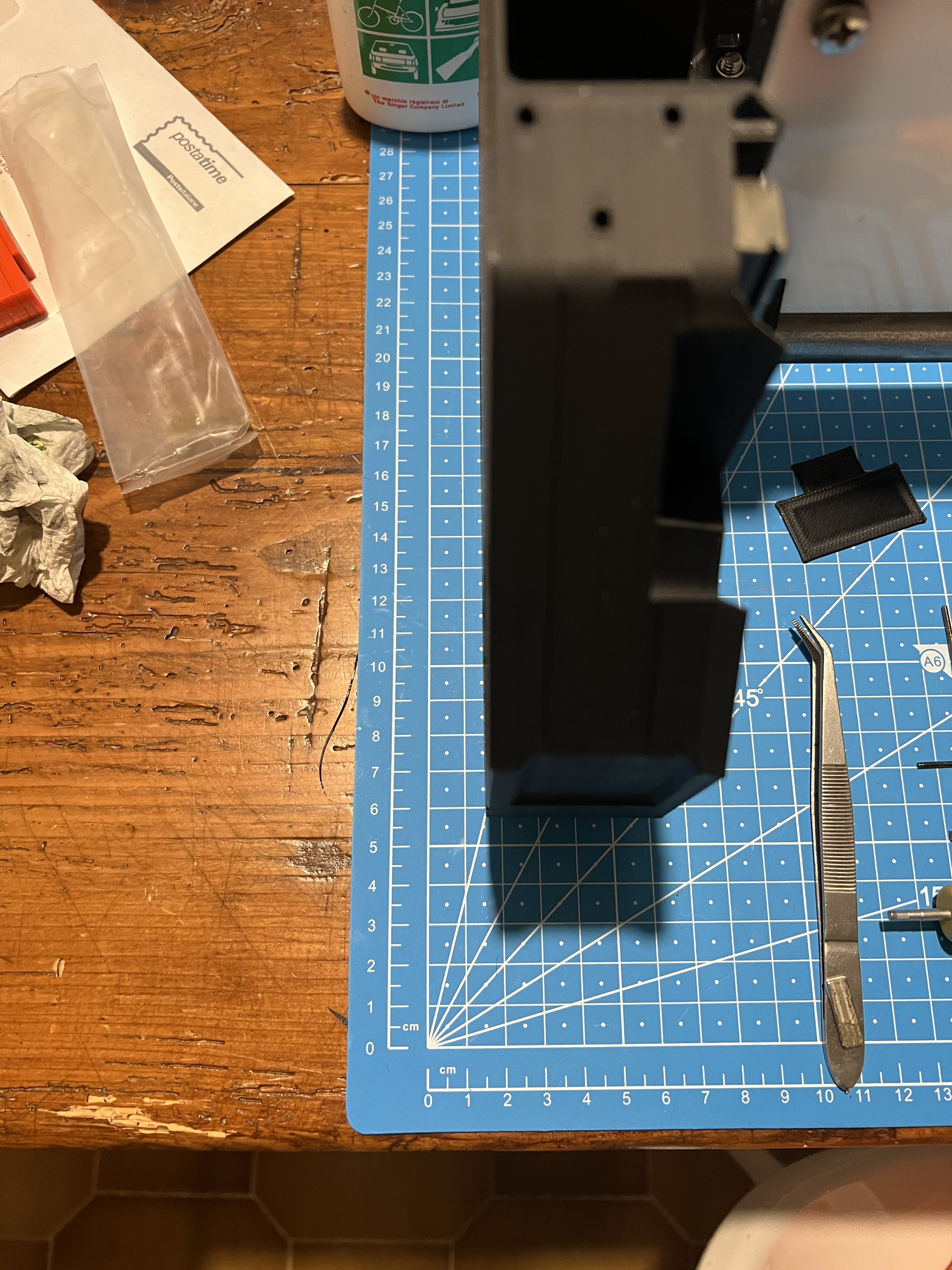

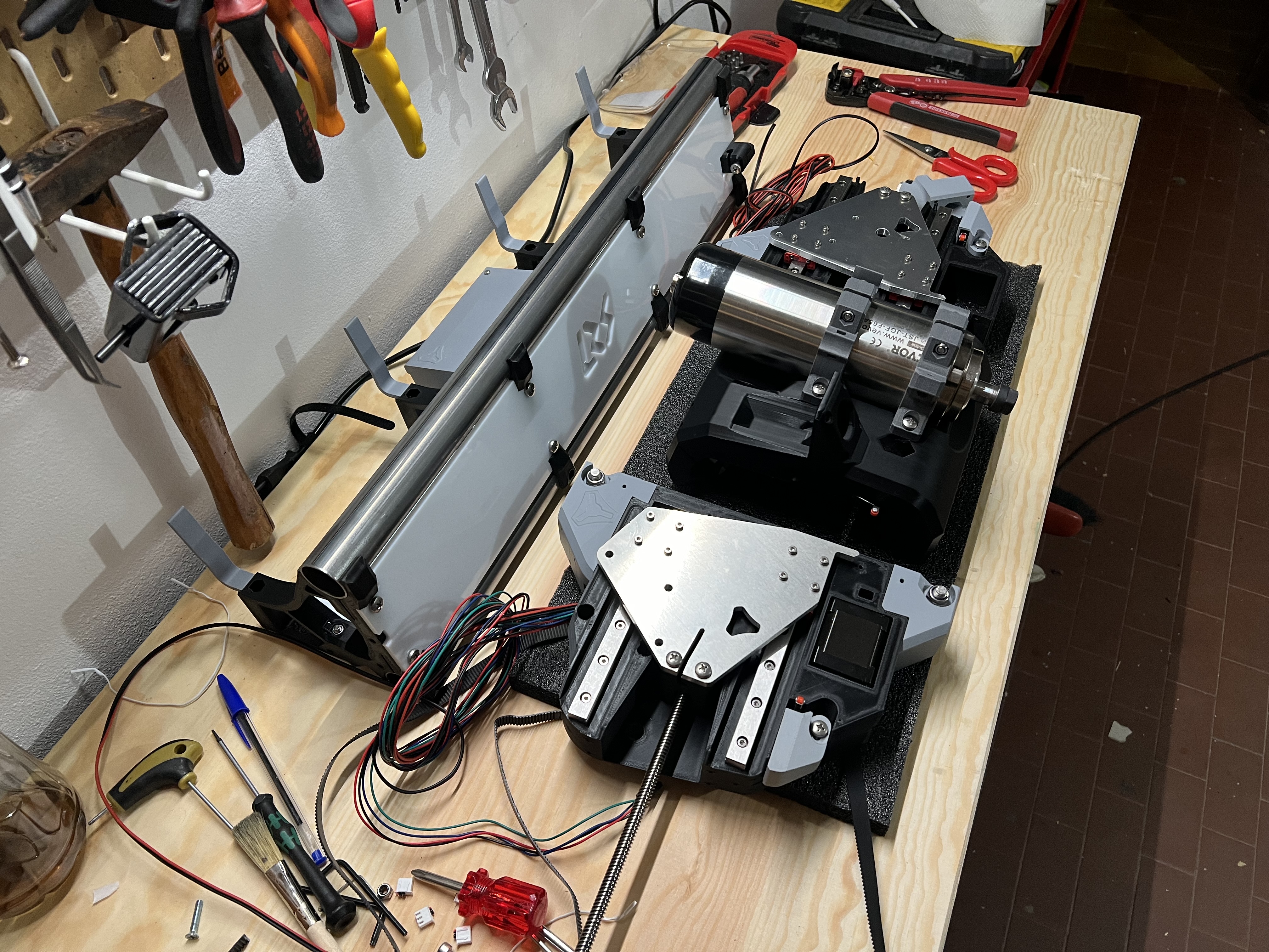

After replaced the LR3 with a fresh LR4, the time to bury my MPCNC has come.
I really liked the Primo design on paper, but after builded I realized that was not a machine for me, probably cause I was already used to the LR3, way stiffer.
So now I’m building a 400x400mm LR4, mostly for metal and really hard material.
This will be an enclosed machine, with VFD Spindle, compressed air and maybe vaacum, all controlled by Gcode.
This is the actual state:

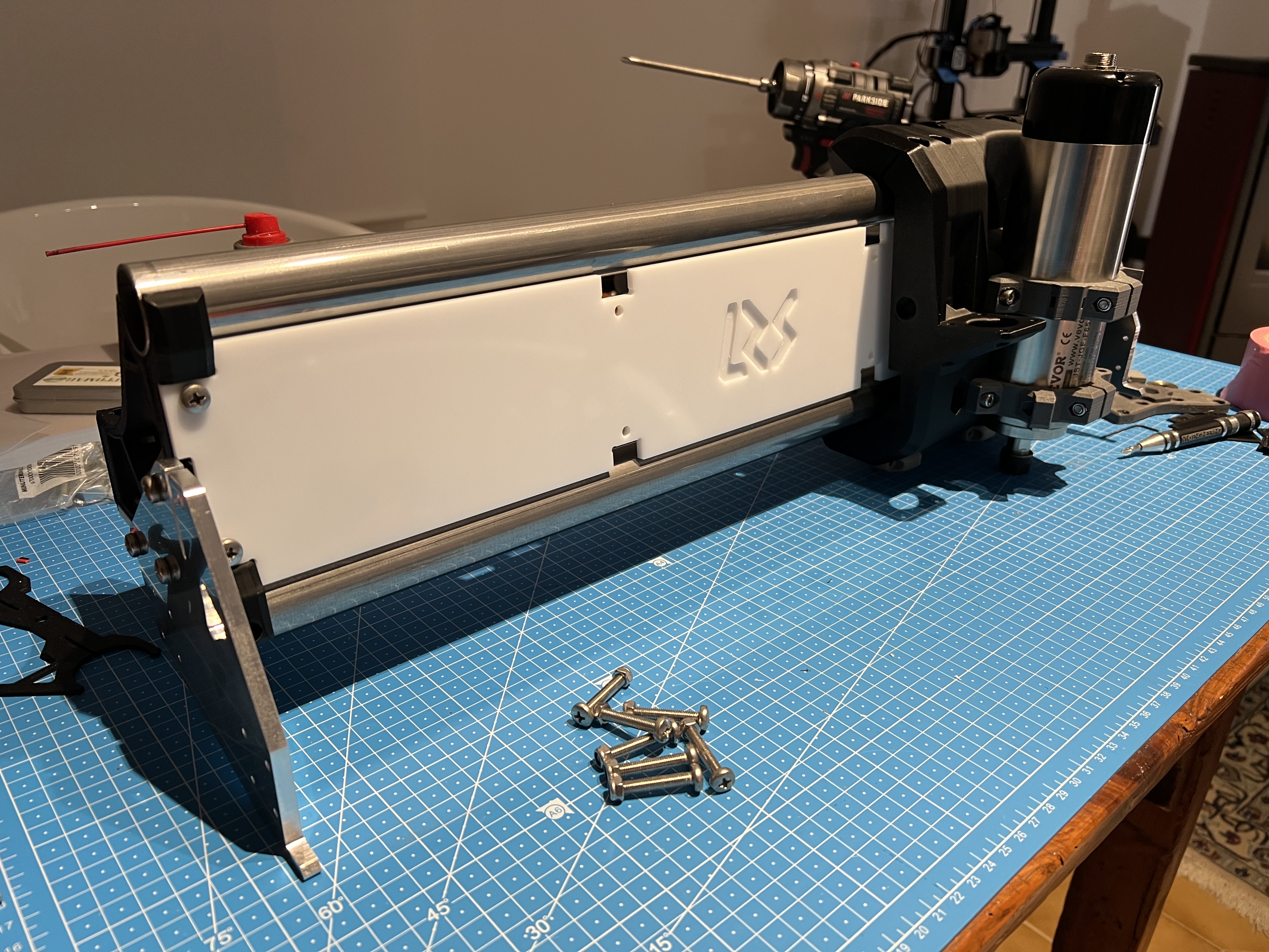

Ohh nice you have the Vevor spindle, do you need tools to change the bit?
Looks like it’s going to be a very capable machine!

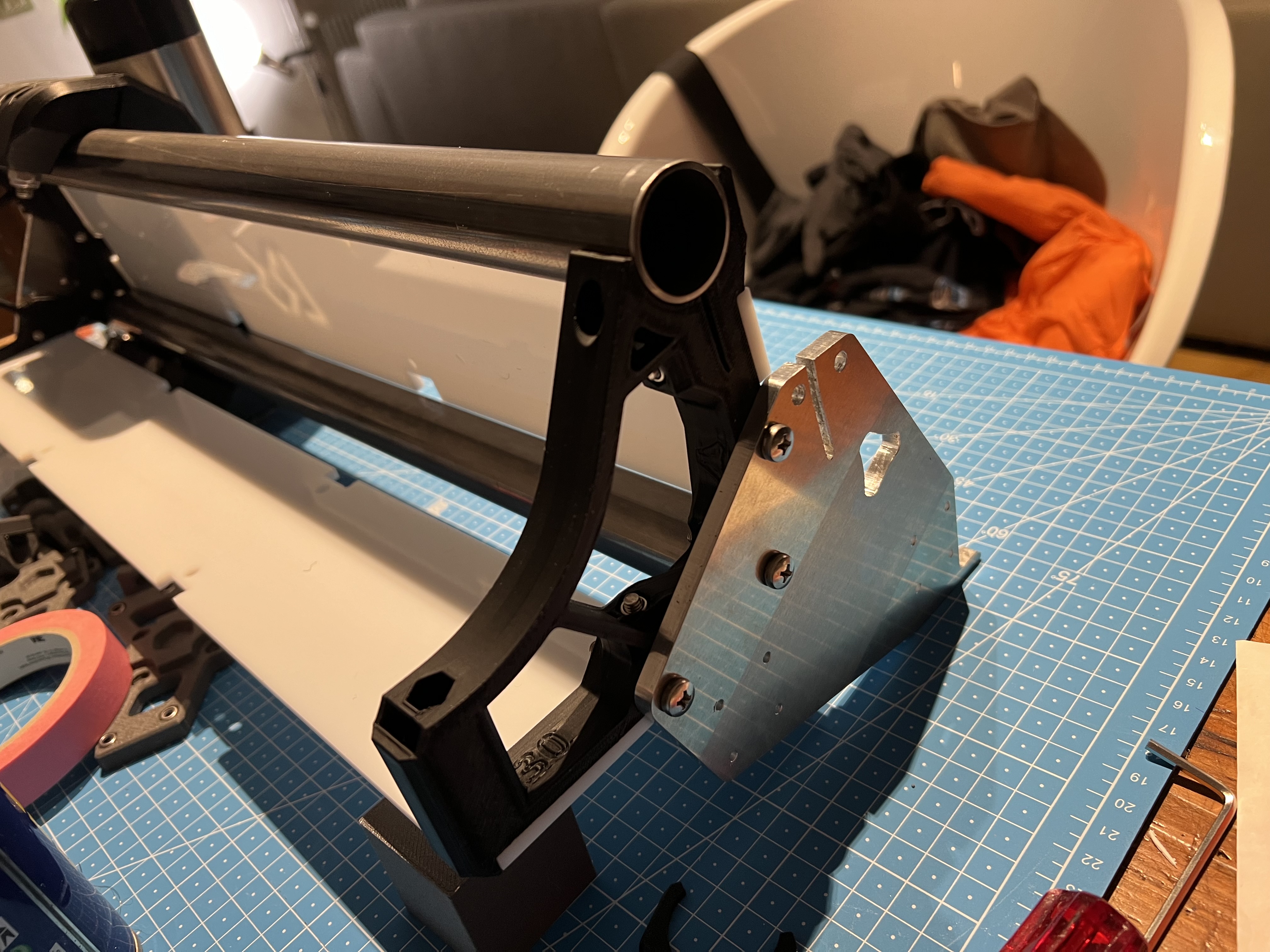

Sweet looking Strut, is that HDPE?
Consider mounting XZ to YZ, before mounting XZ to beam.
Looks great!

Yes, classic two wrenches style
Yeah, they where there only to verify the length of the bottom tube, if it’s too long XZ plates don’t fit square
Plexyglass, but probably they’ll be replaced with aluminum ones.

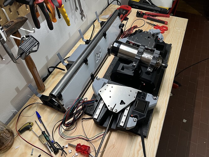

Ok, more parts have been printed, now I’m confident the 700x700mm bench will be fine. It’s time to design it!
Build is going on

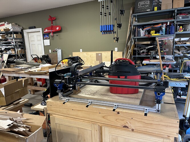

Am I wrong or are there airplane’s silouettes on that spoilboard? :grin:
Look at the red airplane in the upper left corner of that picture… Airplane silhouettes are very likely on that spoilboard…
@Rico_LRS you are 100% correct. :smile: That red plane in the upper left fuselage was cut on that Primo as were 100’s of others. @SupraGuy that and the box of 1/2” balsa lower left. Hahaha.
My hobby of building and flying control line airplanes (that dates me lol) has been replaced by drawing and cutting parts for obsolete planes of the 40s 50s and 60s. And I have Ryan and they rest of this forum to thank because Im that guy that Ryan can point to say, if Pete can do this (and he knows little to nothing about engineering) anyone can build and use this CNC machine.
