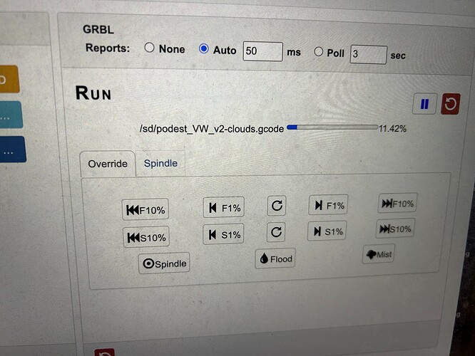

Hey,
I’ve come across a very annoying problem with my LR4. The problem occurs randomly, but usually during long cuts >30 min and in random places. I read everything about similar issues in this forum but unfortunately any advices didn’t help.
I’m aware about electritan noises, vacum ,crossed wires in jackpot but no… I turned off all tools which can potentially impact - no effect.
My LR uses Jackpot from official store, I connecting and making cuts by Fluid web page (AP mode).
No issues, are displayed in consol. At some point the commands are not processed (desktop command window) and it looks like the website and jackpot hang… No reaction to any command. To start CNC I have to restart fluid or turn off jackpot, unfortunately this means I always lose cuts
If you have some idea, what to check, let me know, currently, unfortunately I’m worry to use cnc today I spent almost all day to cut one easy platform , no success - 5 cuts - all failed.
and log from $SS command (when I refresh page) I can send command, and $SS works, but any command for machine no work - no reaction

On below photo LR stopped in the middle of its work, it cut some clouds and stopped.
The stepper drivers have a thermal cutoff, have you a way to check if they are getting too hot?
Yes, temperature was the first thing I checked, and stepper regulators are 27-32C, stepper (~17C), and esp32 - 36 - 38C, nothing special. My LR works in the garage, where it’s about 15C
More details please -
  • When it stops, does the router also stop turning?
  • Does the controller turn off (LEDs go dark)?
  • Does the controller turn back on again after starting?
  • Do the Z steppers lose power? (does the gantry drop down?)
Thanks, I will try answer.
No, a router normally turning, my router it is Makita RT0702,
No, all lights are green as during normal work, as in picture above.
No really sure, about what you asking. When I restart fluid or turn off/on jackpot I can send command but of course it lose previouse job.
No, behaviour is similar l like a pause, but not able to resume or send any command(I can send command by fluid, but no reaction from machine) . Only hard reset or turn off/on brings control back.
Thanks for the answers. They seem to eliminate the likelihood of an electrical issue. That leads to the possibility of a programming issue, where an error in the code is causing the controller to hang up.
You said that it stops randomly, but is it truly random? If you run the same program repeatedly, does it stop at different times, or does it stop at the same point in the code? (I suggest running the programs as “air cuts” to avoid repeat damaging of the stock)
Is totally random, without moving material I run multiple times the same program, and it is stopped in different places. In that way I’'ve cut the struts plates, after few attempts finally it finished.
I wrote that it stopping after ~30 min but sometimes is 15 or 40min.
I use estlcam, with simple cut and with finish path, Z-2mm , 15mm/s material - lightweight 12mm plywood. Very slowly and material with minimal density.
I think this is electronic issue, but not sure what i can test /measure.
I will try to cut in the air, with the spindle turned off, maybe the spindle affects the jackpot or something wrong with a charger, I don’t know … , maybe it lowers voltage.

Today I made some tests, and know less than yesterday, according to suggestion I had plan to cut air without spindle.
First cut (on air) : it stopped on 11%
Second cut (on air)- finished - no issues - wow
Third cut (in material) - almost finished but on final cuts, it lost steps on X (too little rpm, I set to 2,5 ) - grrrrrrrr but not related
Fourth cut (in material) - finished without issue (spindle set for 5)
How to understand these results, completly don’t know. Two things were diffrent than yesterday:
  1. Place of computer, today was on jackpot side, yesterday on spindle
  2. Today morning during the first cut I opened the door in garage and temperture goes down to 7C, and during the last cut was 12C. Yesterday inside was around 15C.
Summarize, after two days, around 10 cuts I have my platform, nice result :slight_smile: and know less than yesterday. Time to start weekend :smiley:
Next time I will try to use FluidTerm
Initially Fluid was configured to use option STA>AP , but i changed to AP, I thought that this was the reason, unfortunately not.
I haven’t any other devices connected like FluidDial and etc.
WebUI is still working but looks it lost connection. Machine don’t react for any commands. Only restart helps.
Today when it stopped I send command $SS, → result below
