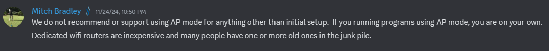

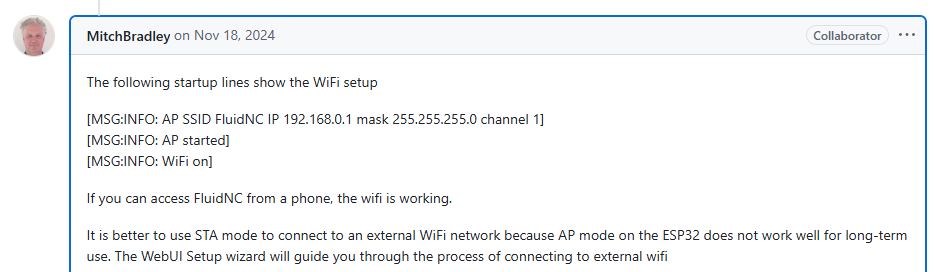

I just know the FluidNC developers recommend STA mode:
The only time i had “” issues"" with fluidnc was while using STA mode, everything felt with lag, you hit start, it took almost a minute, you hit pause or stop, good luck saving your part. AP mode with the raspberry pi/touchscreen i use to control the interface feels just like wired
I’ve had zero issues in STA mode. Although, I didn’t have issues in AP mode when using it either. STA mode is just way more convenient for me. If I recall correctly, you’re on a 3.7 version. A lot has happened since then.
I will note that AP mode is still the V1 recommendation, but I believe that’s only because it’s easier to configure, in that you don’t have to do anything. In STA mode, I have it configured in my router as a static IP. Of course, in STA mode, it depends on the signal strength of your network where your Jackpot is so there are other factors.

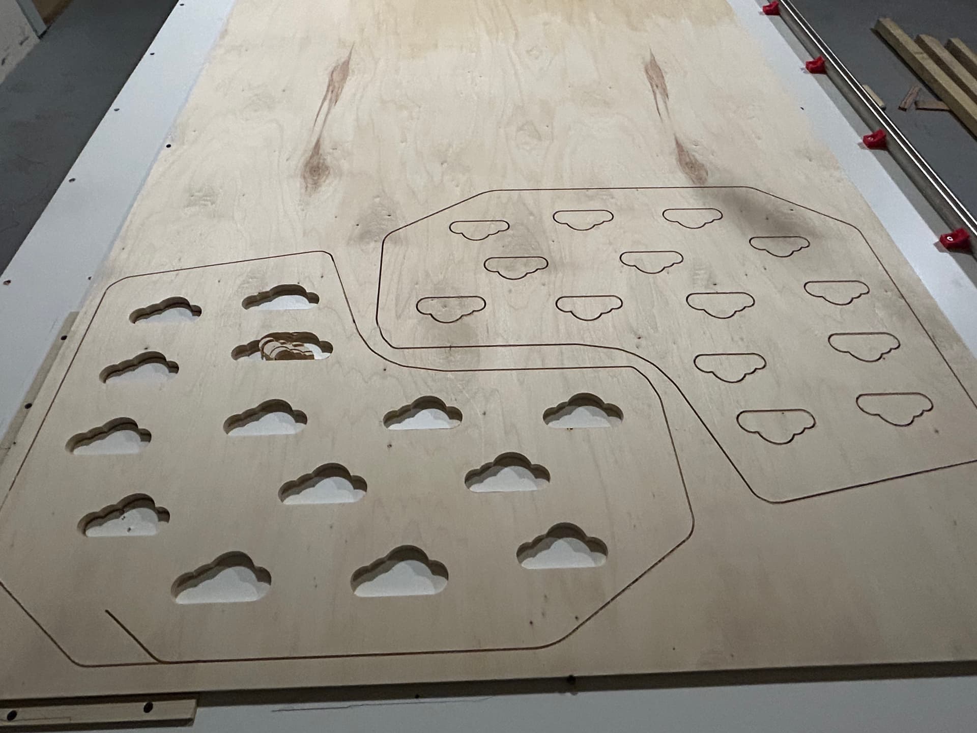

OK, issue with losing steps , always on axis X. Two materials:
  1. OSB -20 mm, 4mm DOT, speed 18mm/s, endmil 6mm , shape simlar to quoter of circle with radius ~ 400mm , after 3 (4) iterations it lost steps on axis X (usually nn circle part) . I suppose that maybe because some harder chunk. Finally finished by jig saw.Lost steps in different places but never in first loop.
  2. Light plywood 12mm, (400kg/m3) - speed 18mm/s, endmil 2,5mm, 3mm dot, lost steps after few iterations, e.g when I cut this platform , it lost steps on the preimeter and second/third attemps on the cloud (this one with chunk of wood) .

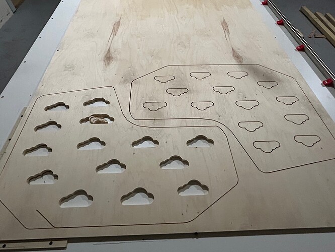

Same picture as above but haven’t nothing new.
When reduced speed to 12-15mm/s and DOT 2 mm is fine, but cuts take forever especially with finishing cuts.

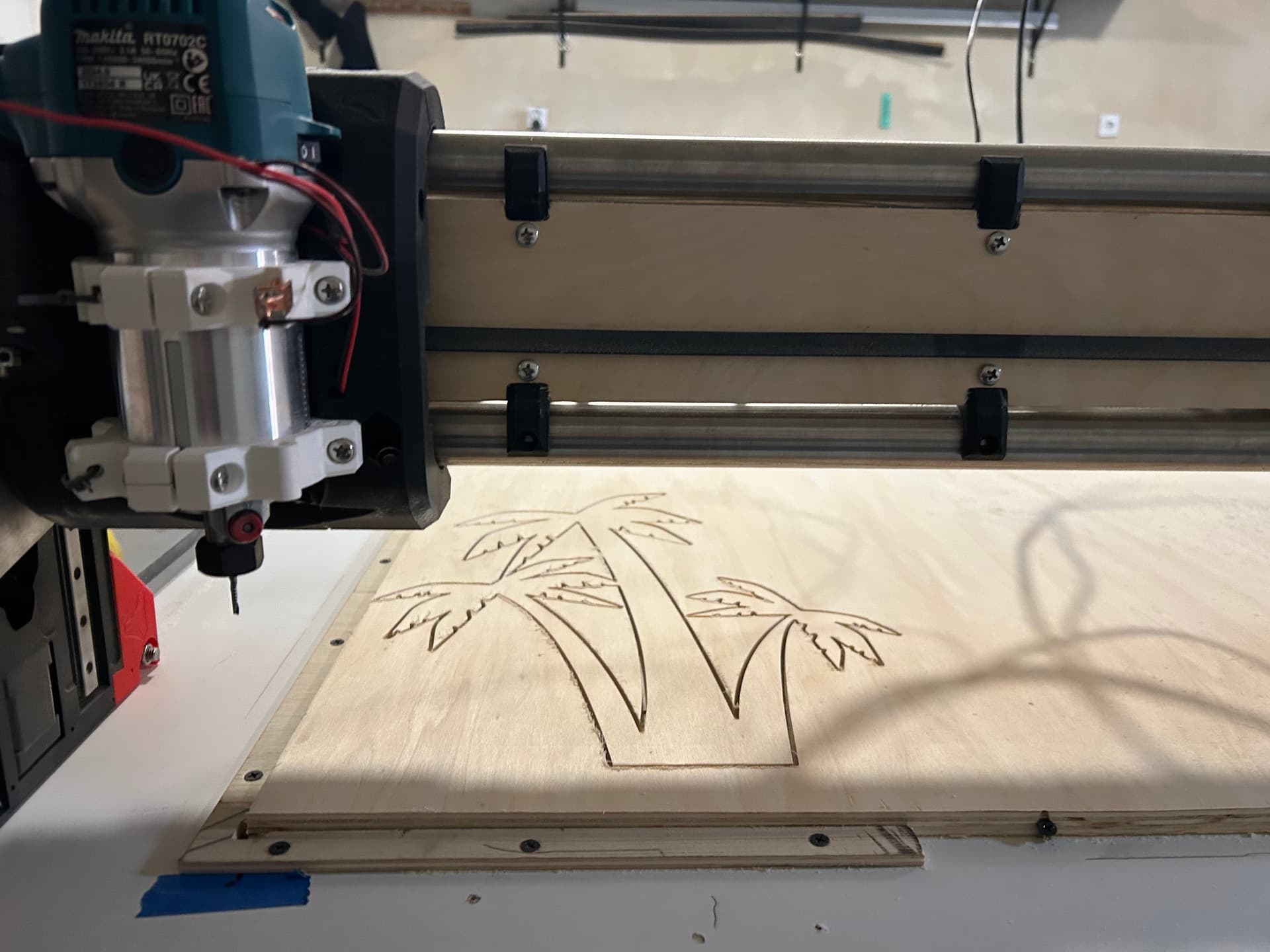

Palm tree, 12mm/s, dot 2mm, endmil 2,5mm, without finishing cuts - full success - no issue
