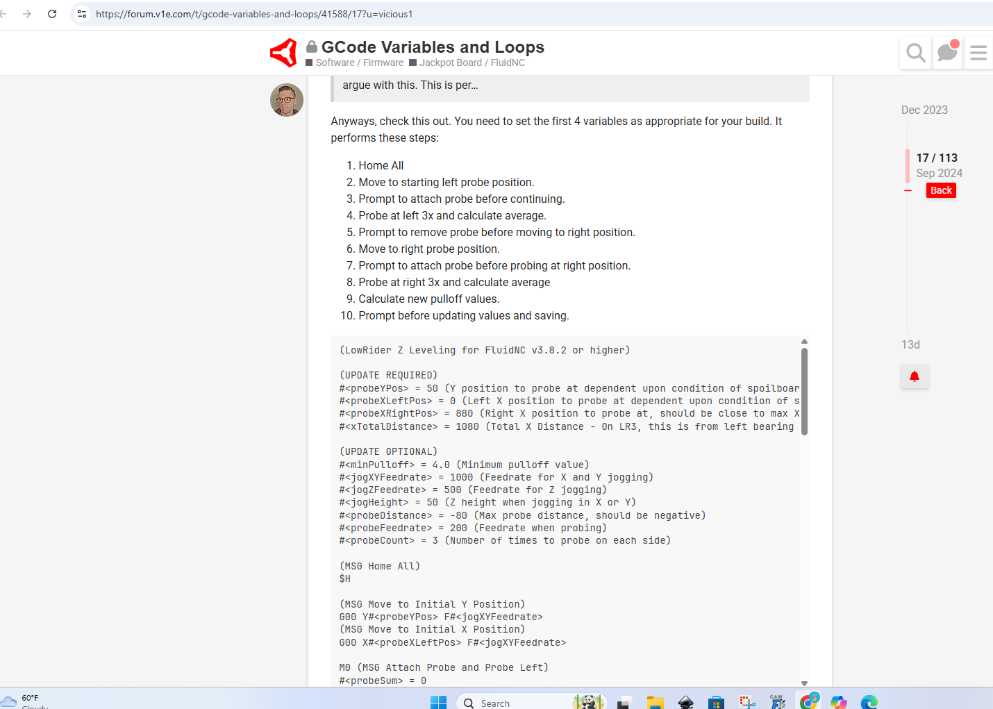

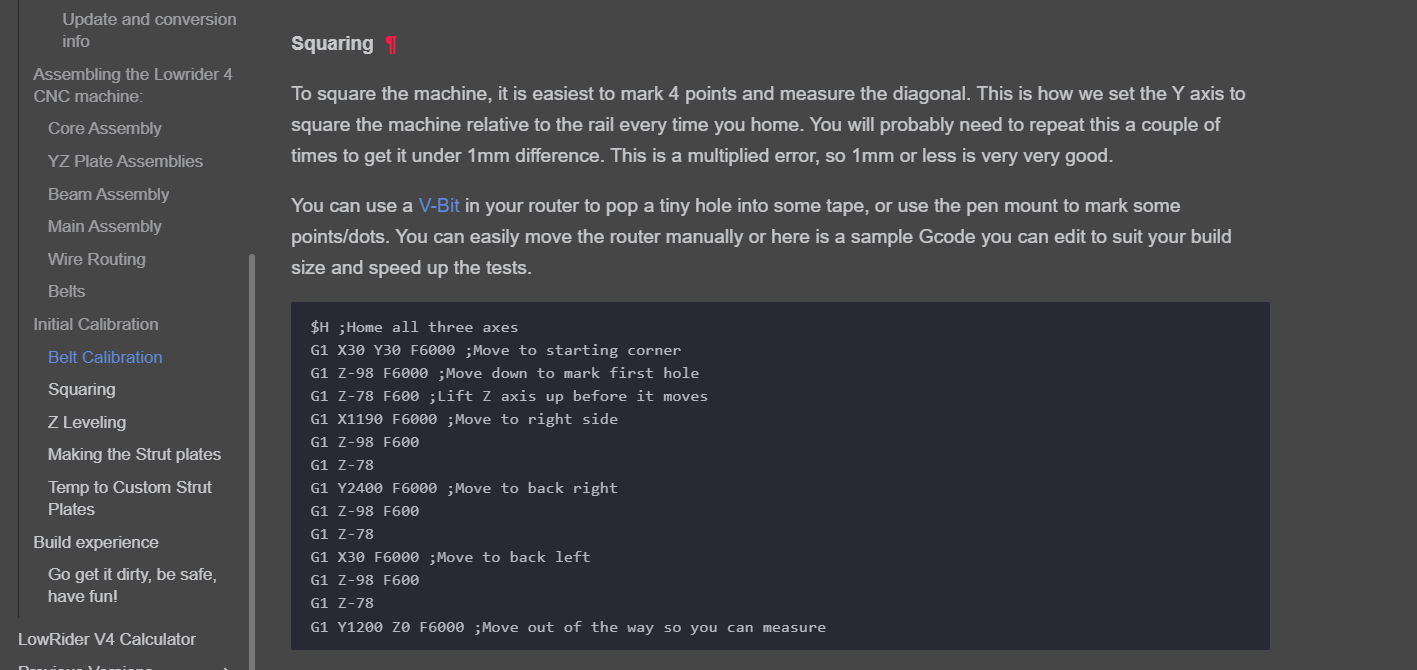

how do I get this G-code to the jackpot to run it. Not quite sure how to use it. I want to use it it to squar my machine.
also would like to know how to use the Z leveling from here as well. from Jason Yeagerjeyeager

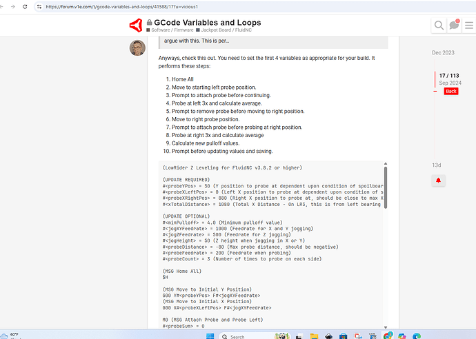

Unfortunately, there’s a bug in FluidNC that prevents that from working. I think it last worked in v3.9.4 and I think it’s fixed in a v4.0 version. I’d just do it manually for now.
Copy that thanks
This one still works, copy the text into a text editor like notepad or vscode, save it as a .gcode file and run it from your webui.
Be sure to edit the values to fit your machines size.
Got it thanks.Appreciate you guys.
