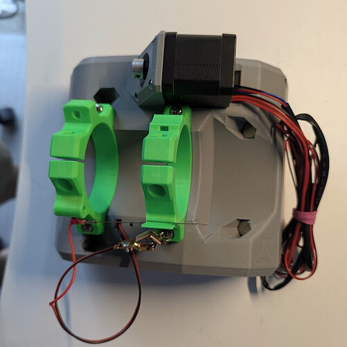

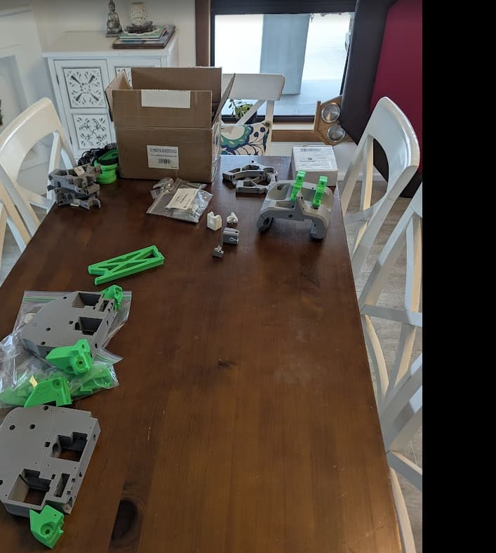

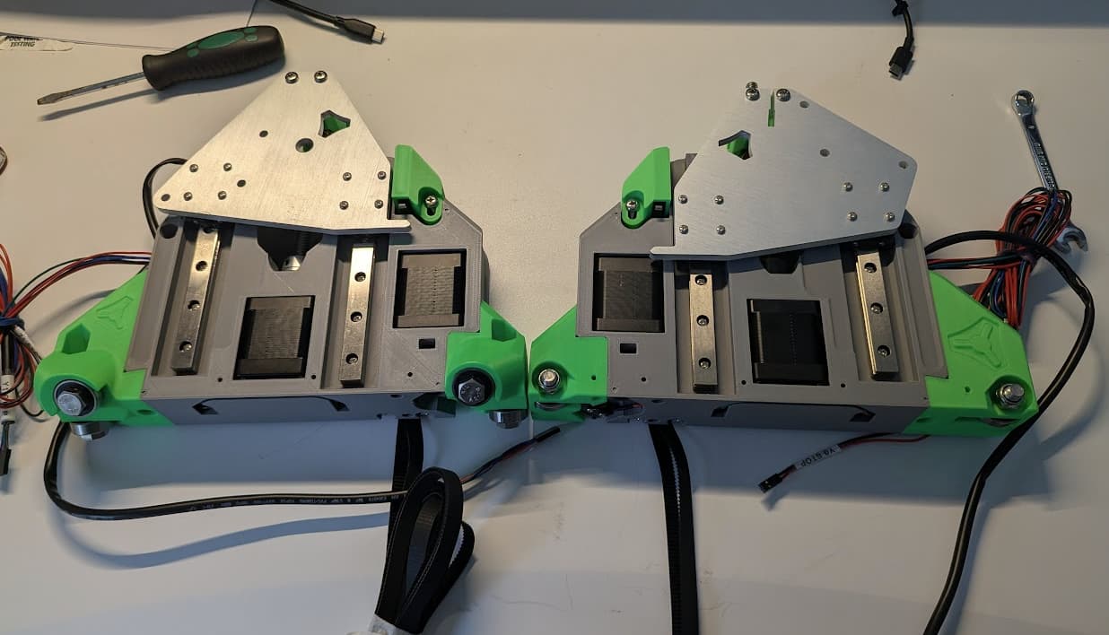

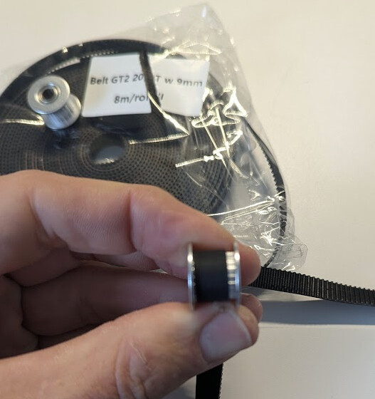

Started assembling this morning - had read through the instructions previously and was a little concerned as to how easy it would be to follow them, but once you’ve actually got the parts in front of you it’s pretty straight forward and found I was really enjoying myself. Only real query I have is in regards to the idlers & belt supplied - I suspect it’s a non-issue, but the idlers are 10mm toothed and the belt is 9mm wide. Any issue with a toothed surface on the back of the belt?

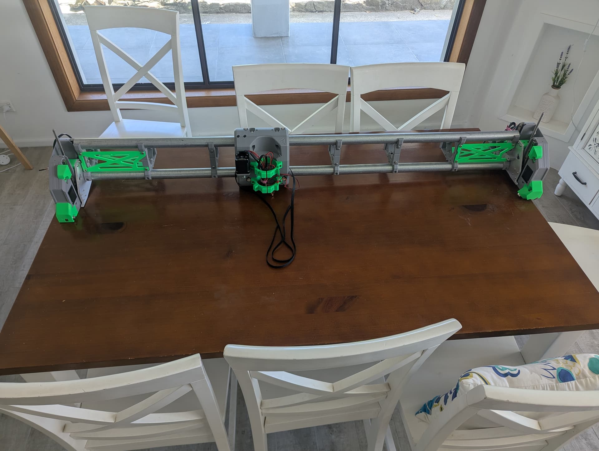

Anyway - this is where I got to - will start on the beam this week - Happy as a pig in sh*t!

To be fair - no real dramas with the stepper motors. Had to strip the outer sheath, but beyond that the only other item was a couple of heatshrinks that hadn’t been shrunk on the presoldered limit switches. Didn’t think it was all going to fit through tunnels in the YZ plates, but was proved wrong. Hate to think how many iterations that must have taken to get right!

It can cause slight positioning errors, where position alternates + and - from the target position. I would replace them with smooth idler rollers.
I mean that is true but what are we talking 0.001mm difference from the peak of the tooth to a valley? That only changes the tension, not the actual steps.
I don’t see any issues with it.
Hadn’t even considered that… more about increased wear on the belt. Easy enough to replace if needs be!

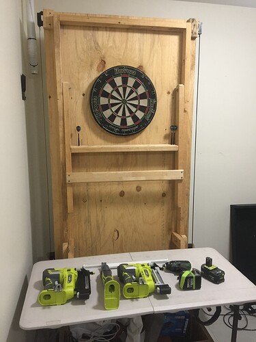

G-day…. I’m upgrading my LRv2 now. I’m based in Sydney.

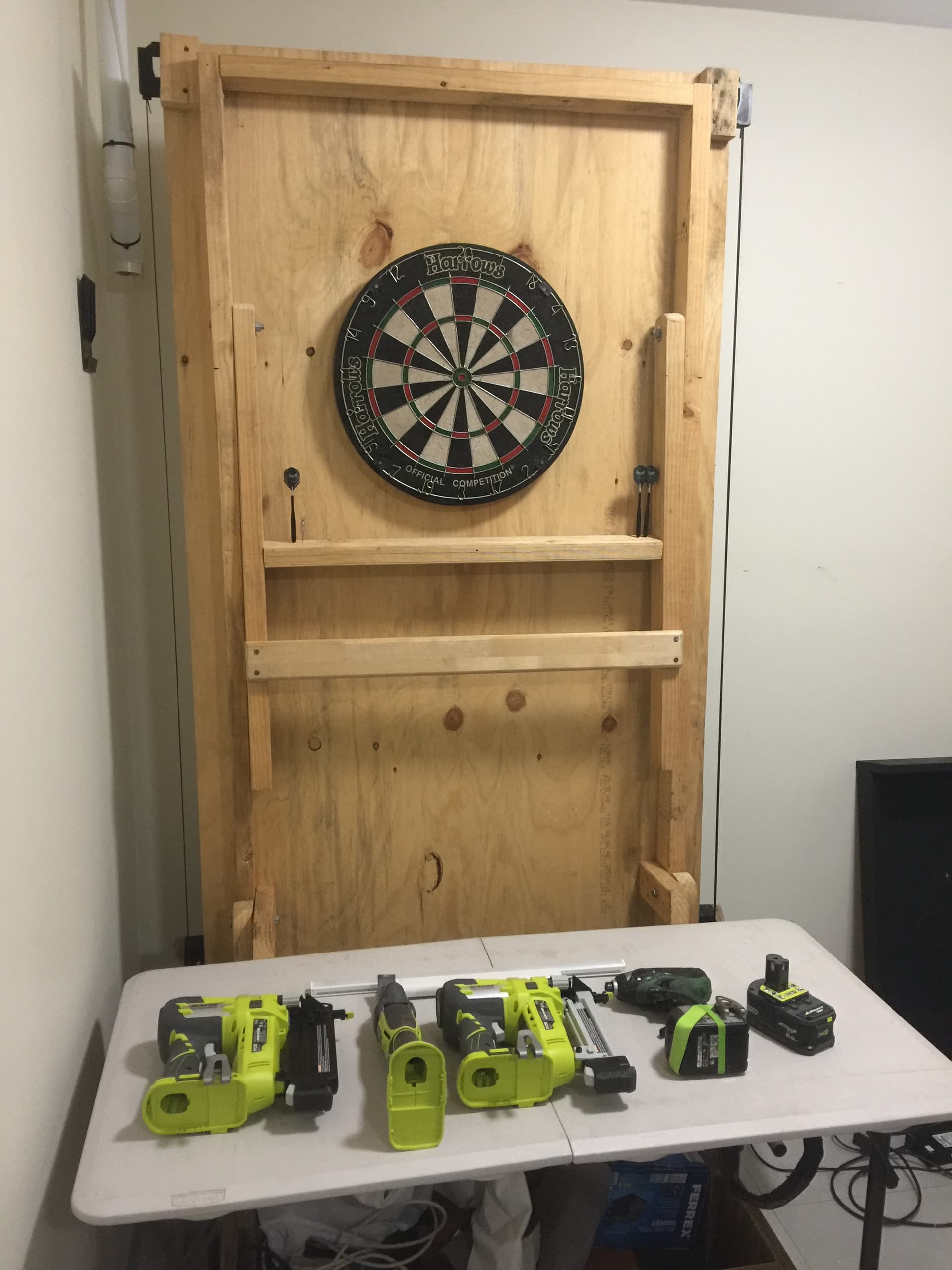

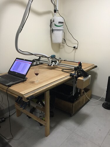

I built a table very similar to the vertical rotating table you have designed. (see pix. )
All parts are printed and have FluidNc installed. Now I’m off to Bunnings to source some tubing.

Initially went to the local Bunnings - closest they had were 1m long sections of curtain rail which I wasn’t overly impressed with. Ended up getting a couple of lengths of 32mm Gal Conduit from TLE on a visit to Wollongong. Not cheap ($60/ 4m length?) and worth calling ahead to make sure they have them in stock - seems to be the trade counters in an industrial area that carry it - others have to order it in.

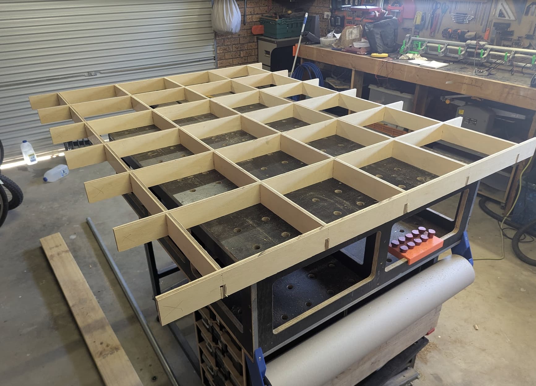

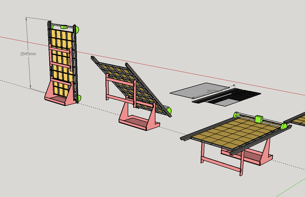

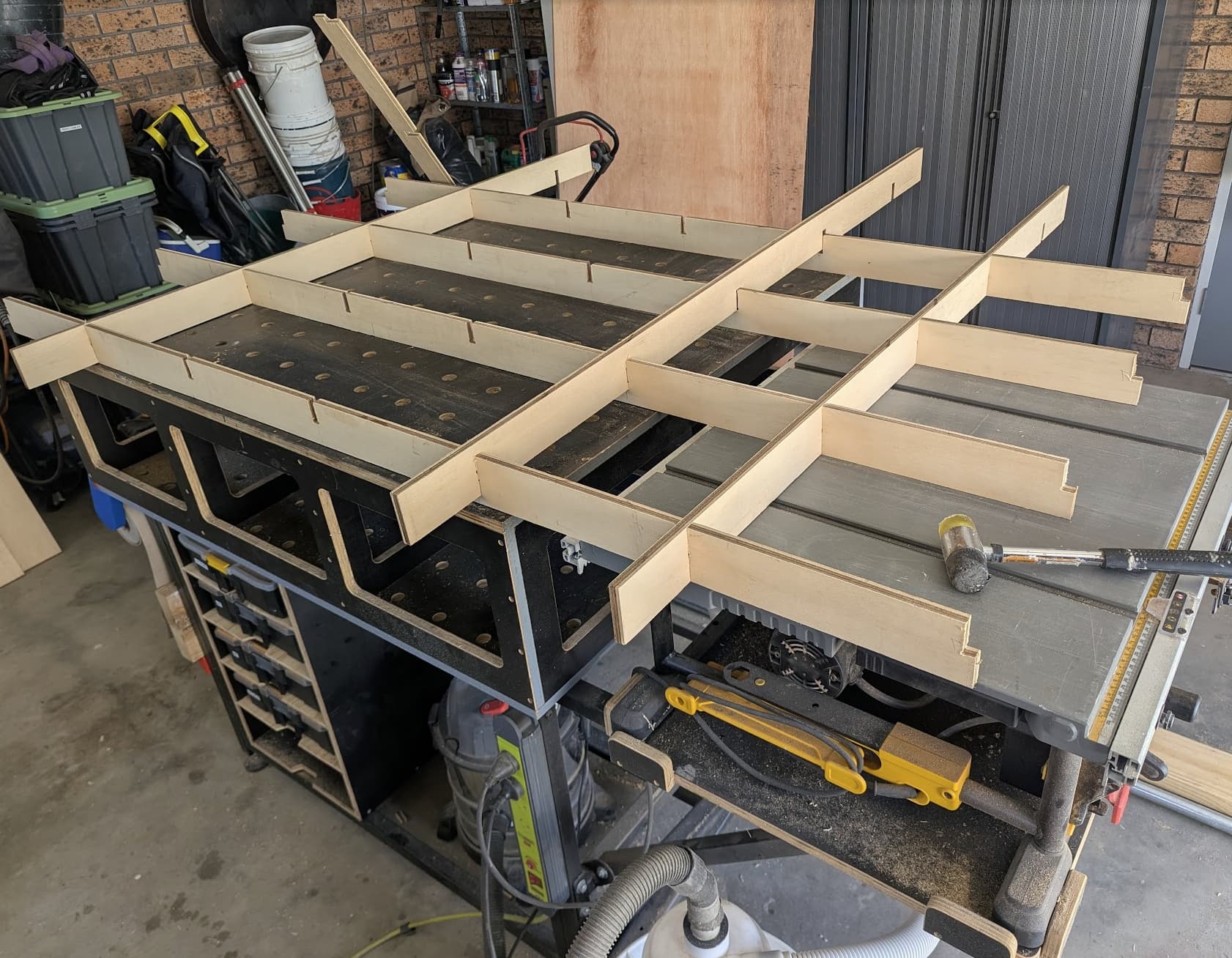

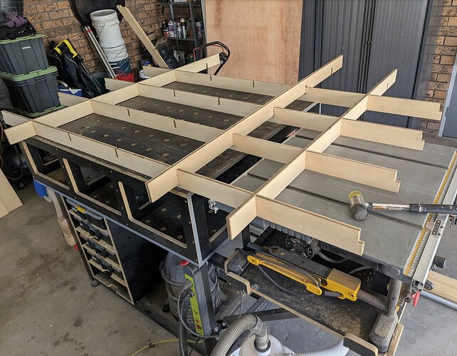

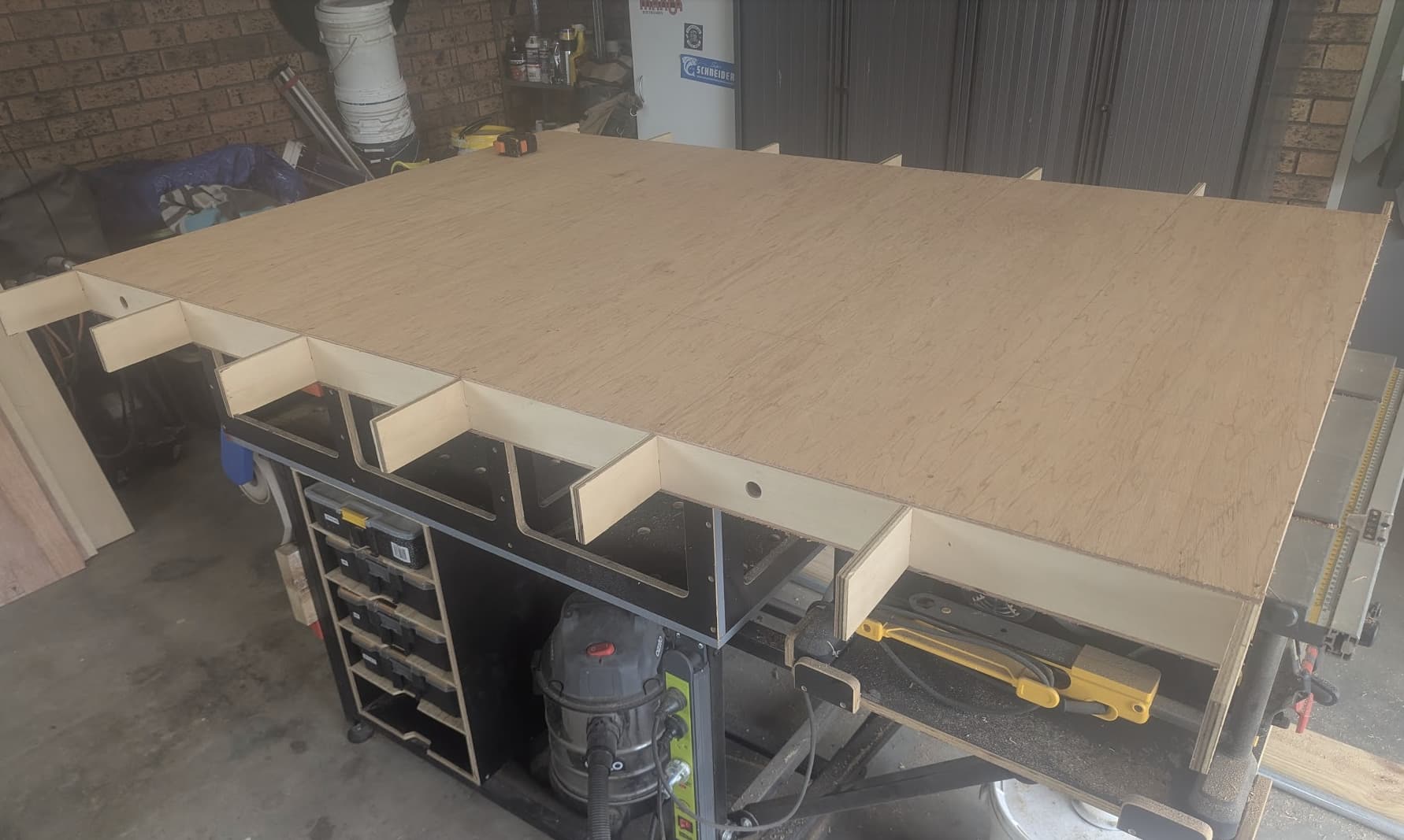

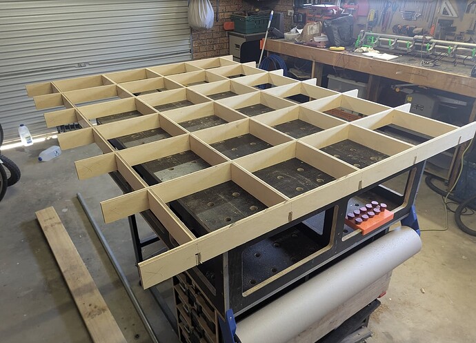

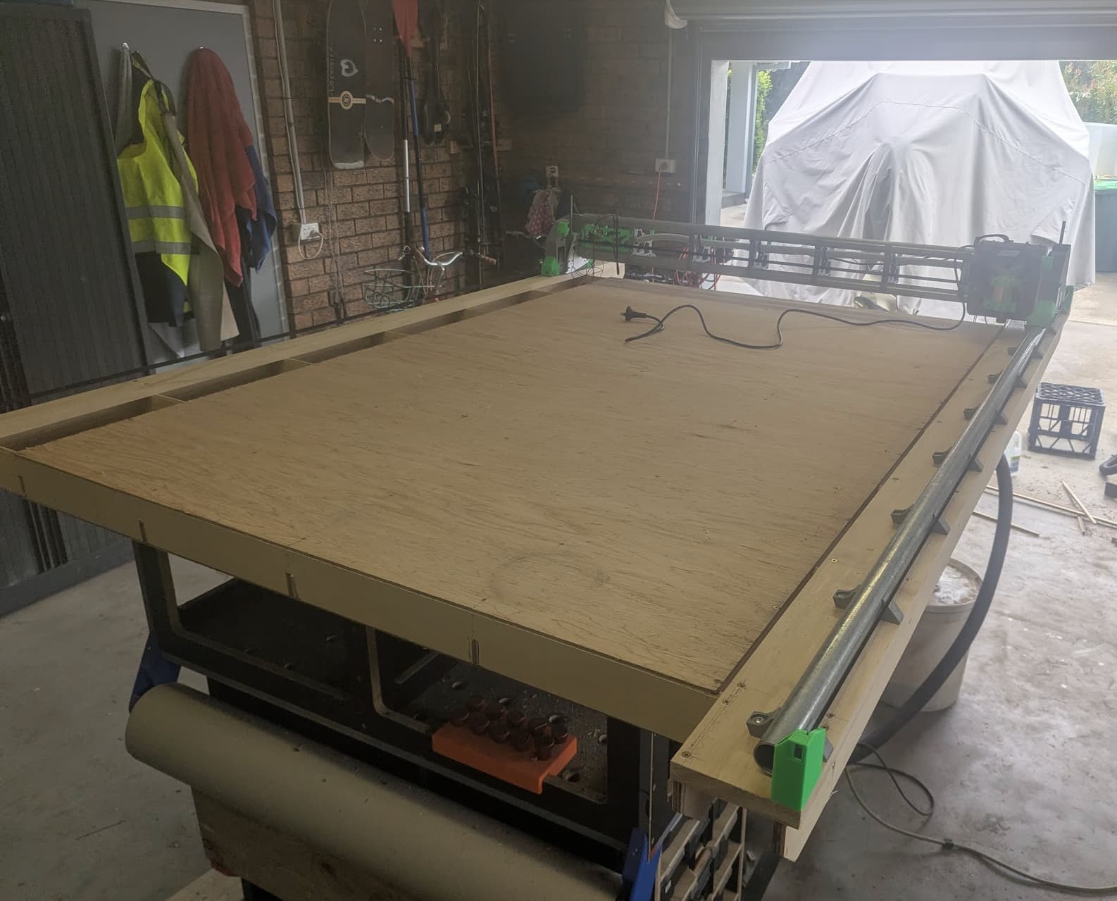

Progress has been made…. though not as quickly as I would like! Have ended up going for 1830x1220 working area on the table. Have made provisions for the folding design above, but figure the best way to do that is by using the LR4 itself! For the time being the torsion box can sit on the assembly table and light enough to move off to the side when I need to.
Using 4mm skins for the torsion box, and will put a sacrificial mdf sheet on top of that, but got caught out with these odd dimensions - normally in Oz sheet material is either 2400x1200 or 8x4 (2440x12220) - saw the 2440 and assumed I was sweet for my 1220 width…. Oh well - Each skin is in two pieces

Nice, it looks a lot lighter than mine.
Cheers - We’ll find out how rugged it is - but can’t see it getting knocked around too much

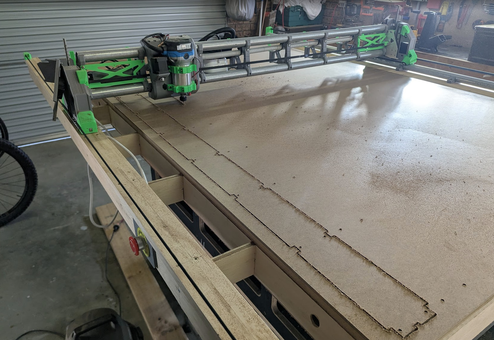

3 months since the last post? - time flies when life (and work :anguished_face: ) gets in the way! But happy to say we’ve finally made our first cut on the machine and it’s worked out really well with minimal frustration!
Was ok with the mechanical and wiring aspects - but wasn’t looking forward piecing together the controls side of it - found that a little intimidating, especially when you jump on the Fluidnc wiki - all goes straight over my head! But slowly reading………. and then rereading Ryan’s instructions and it slowly comes together! Have learnt a heap in the last push to get the machine operating, and realised that it’s only the tip of the iceberg.
The feeling that it all moves as it’s supposed to is pretty cool - time to install the strut plates and start playing with it properly!
