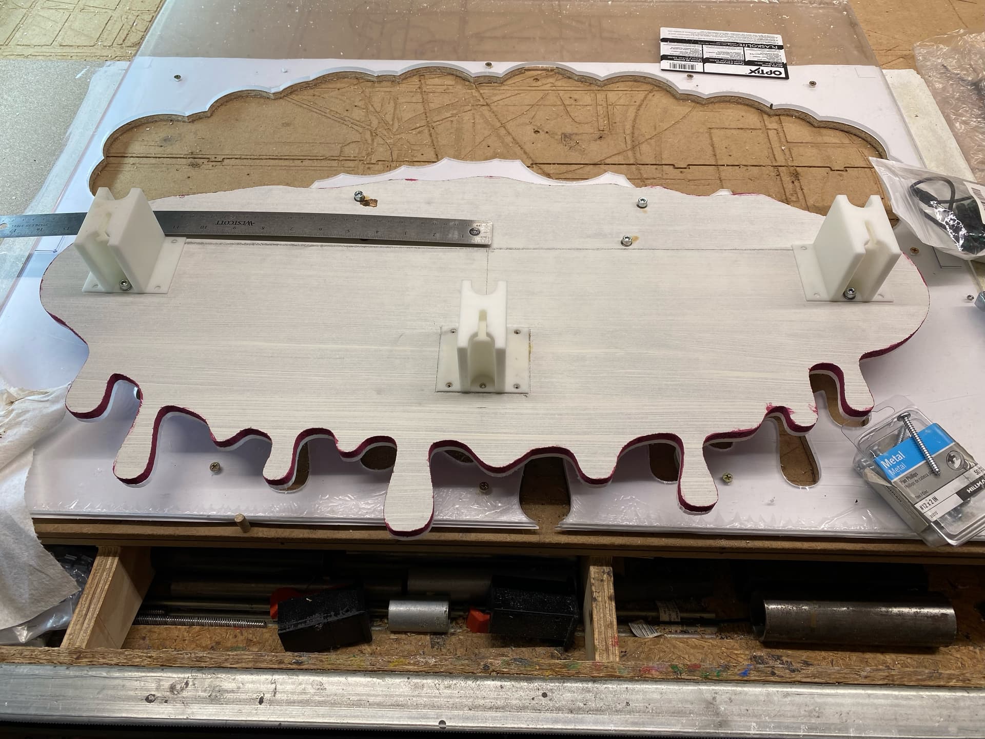

As for how long I’ve been cutting with LR4 — I was in on it early with the beta test group. I’ve done quite a few projects with it, several of which were documented either here or on YouTube.
See these:

Re. spoil board: I just use MDF, and for material hold-down, I screw things directly to the MDF. Works great, would not have it any other way.
