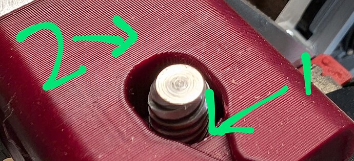

I’m going to sheepishly ask: How can you run the z, have it work, but not connected? Are you talking about not cranking down the grub to the motor shaft or to the lead screw?
The nut holder to the stub with the M5.
A.k.a. the two-part thingy that people are happy their 3D printer makes correctly. There’s a hole, through which you can connect them, if you’re feeling bold, which I am not.
My#1 arrow is a little off but you get the idea
Oh that one. That makes way more sense now. I am very familiar with that part fit.
