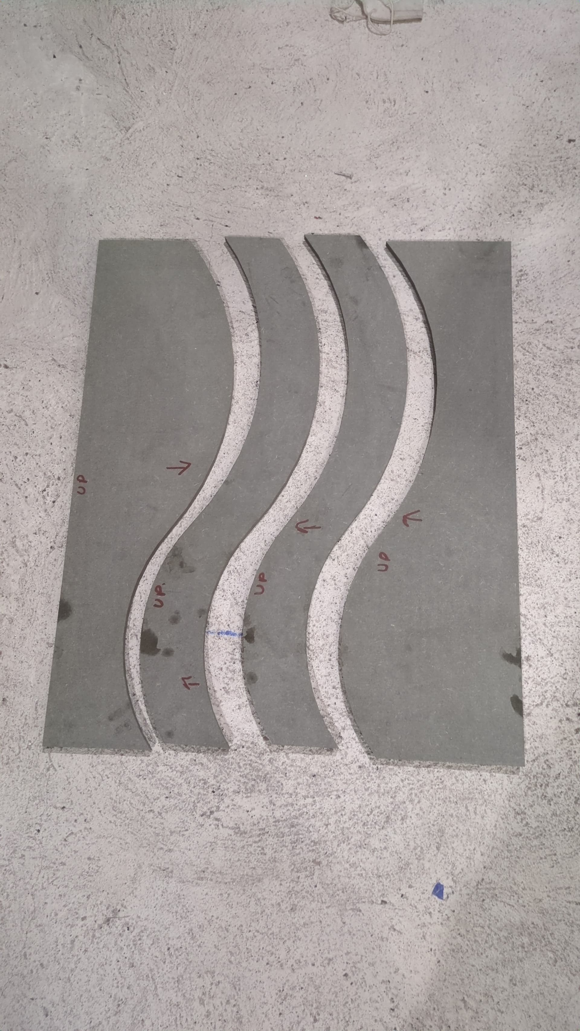

For example - the pieces I cut earlier at 8.3mm/s and 4-6mm doc slotting: to me this seems very slow, but I get I’m chasing zeros here. I previously cut some knife handles, a fairly simple 3d shape where I roughed using adaptive clear from fusion with a 1/4” single flute taking anywhere from 50% stepover and 10mm DOC to 1mm DOC in Walnut and Ironwood at 30mm/s, a bore operation for a 6mm hole using a 1/8” single flute and a finishing pass both at 30mm/s, and then finally a parallely pass with a 1/8” ballnose taking 0.25 mm passes at 60mm/s and these turned out fantastic. dimensionally almost perfect. But then I move over to plywood and it seems I can only run 8 or so mm/s reliably so I’m trying to make sense of it all.

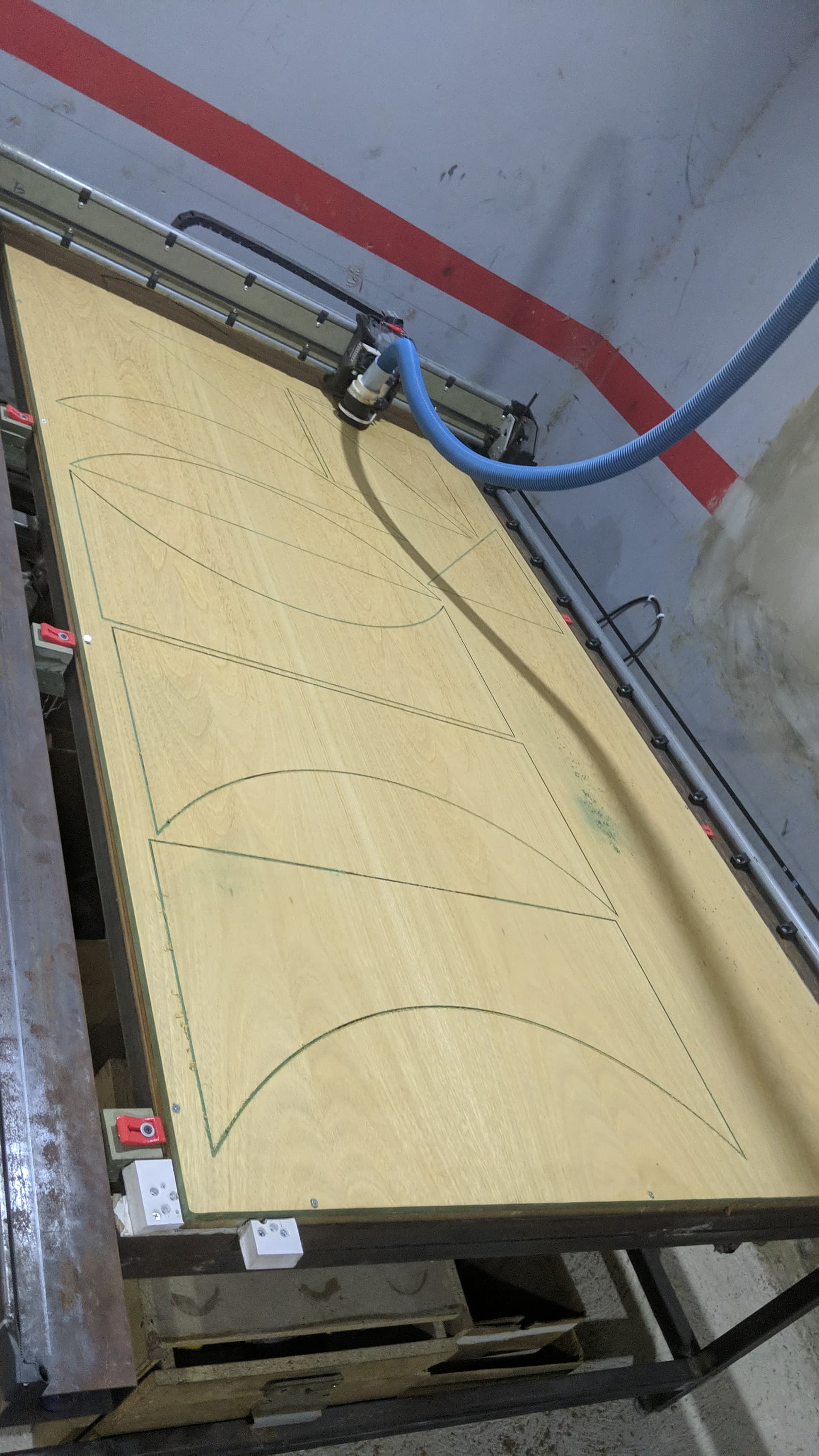

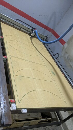

Crap plywood is full of Glue, good plywood has much less glue. Still you should be able to go much faster with a single flute upcut bit.

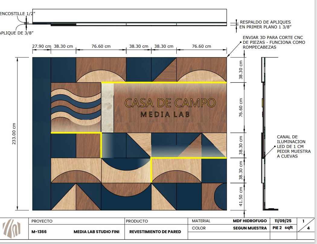

You are describing two totally different kind of cuts, the first fancy ones have two different finishing passes you are describing, then cutting plywood, I assume slotting, no roughing no .3mm stepover ball nose….who cares about sub mm accuracy in plywood.
If you want every single job to have sub mm accuracy, that is what it takes. Roughing and at least one finishing pass (some call it a spring pass).
