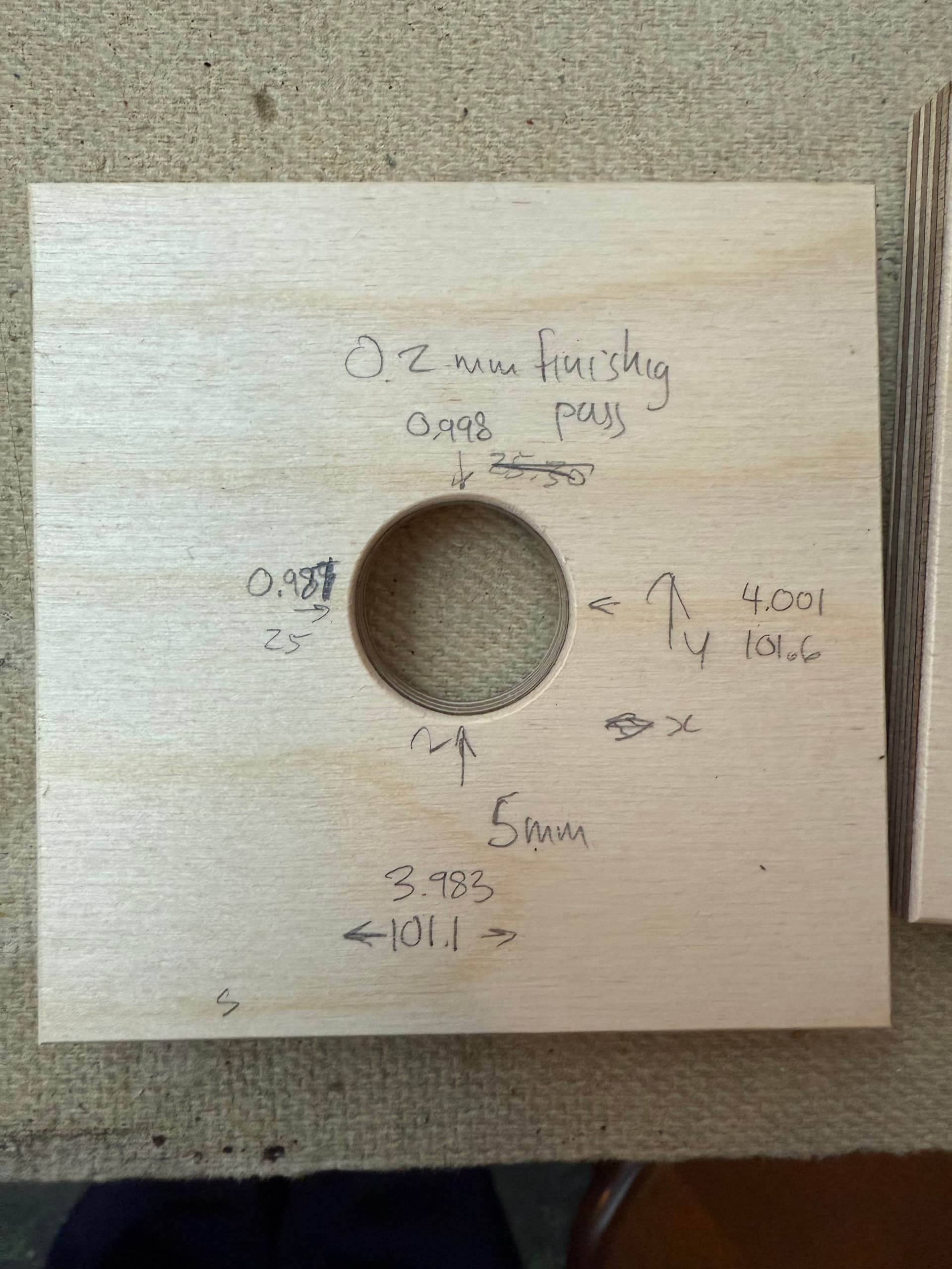

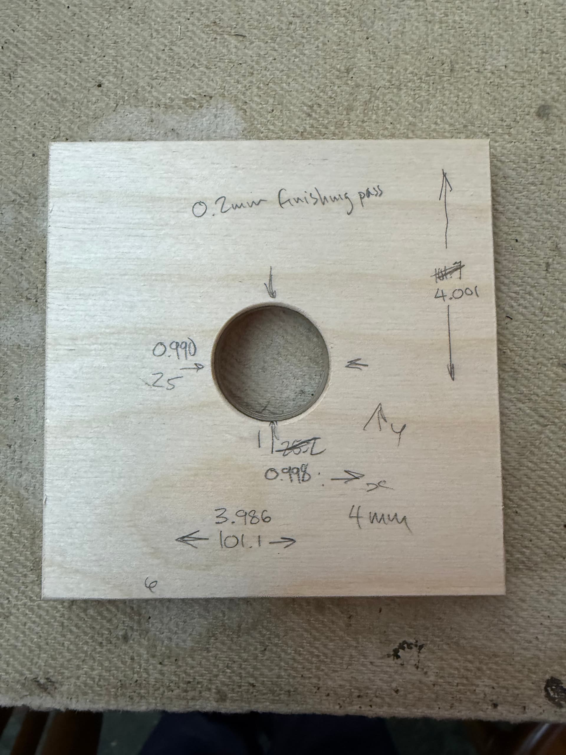

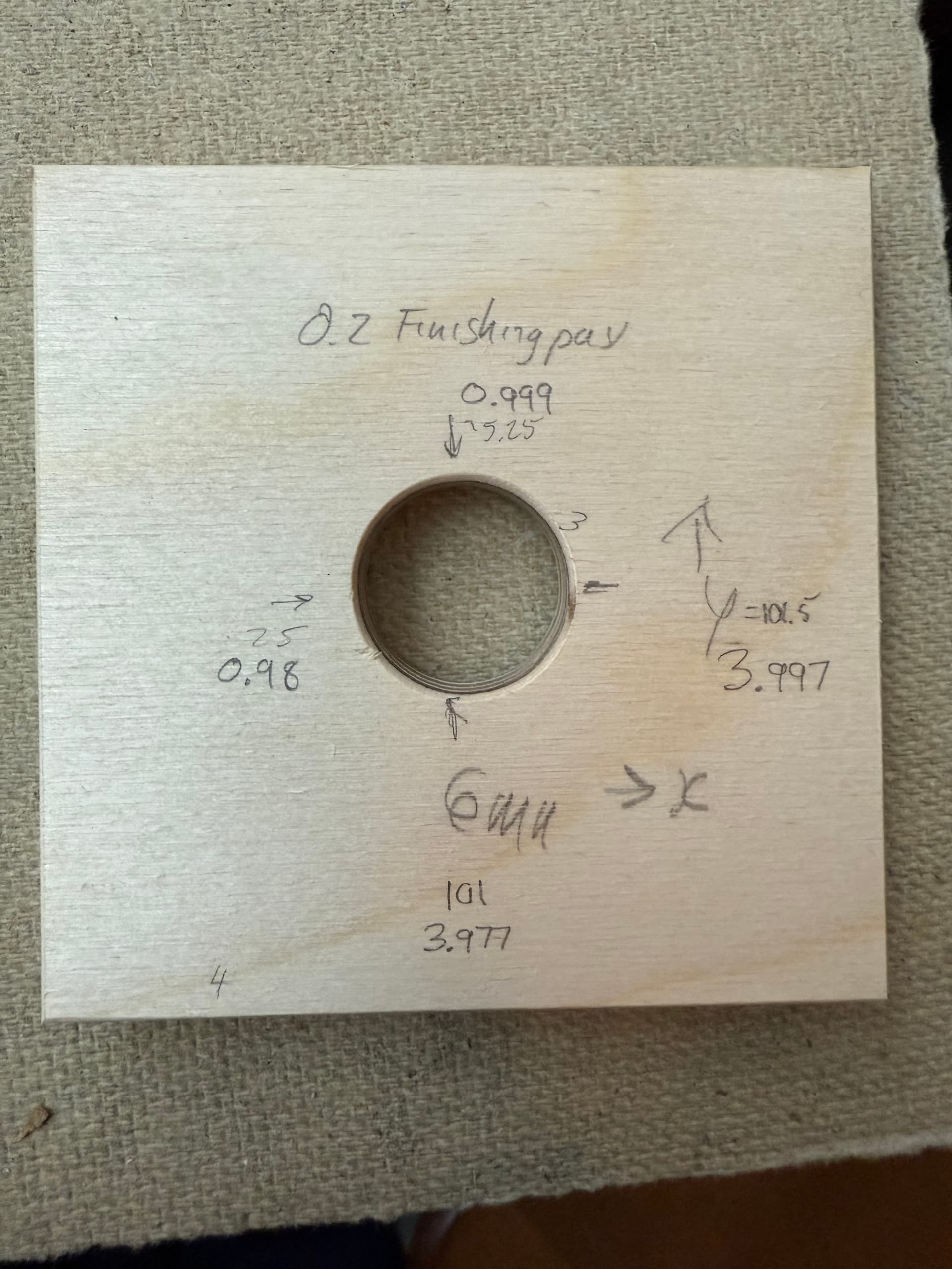

Alright, I may be more confused than before. The only changes I made to the machine last night were to level the Z pulloff from homing (pretty sure this is unrelated but still needed to be done) and changed the bit to a new 1/8 2 flute as I wait for single flutes to arrive. I cut 3 4”x4” squares with a 1” circle in the middle. The square was cut using a simple slot cut from ESTLcam at 4mm, 5mm, and 6mm DOC respectively. The circle hole in the middle was cut using the same DOC, but with a linear pocketing. I got the hold down tabs correct this time so each square and hole had a 0.2mm full depth finishing pass as well. Material is 12mm Baltic Birch. Feed speed was 500mm/min and Router RPM was lowest setting on the RT0701c which is ~10000rpm. I forgot to download the Gcode but will try to get that attached and uploaded later today when I get home. I have attached pictures of the pieces for reference
The order of operations was the 4mm doc hole was cut first, then the 5mm hole, then the 6mm hole, then the 6mm square, then the 5mm square, and finally the 4mm square.
Generally the cut sounded fine, there was some grinding that could have been missed steps on the cuts for the 5mm square but the dimensions came out fine so I don’t think it was an issue.
From these pieces it looks to me like I am within 0.003” (I am ridiculously happy with that) in the Y direction and 0.025” (less happy with that, but as Ryan has said, consistency is key here) in the X. These were consistent across all three pieces.
I guess in hindsight it makes sense that a dull bit would cause heavy deflection as the machine has to push it harder through the material - I just didn’t expect the bit to be worn out so quickly. It had maybe 5-6 hrs of cutting time on it, most of which was 12mm DOC trochoidal and 0.3mm full depth finishing pass. Perhaps I ruin it with my 1mm doc testing and have been chasing a ghost since then? What kind of life should I expect from a carbide tool, and is there some indication its going out other than pieces are dimensionally non functional?

Okay with much more ideal cutting conditions 5-6 hours is normal, but I would think 10 hours is pretty high. It varies greatly with each tool you use and what you expect out of it. You will be able to hear the difference eventually. A fresh endmill is quieter and leaves a better surface finish. As it starts to wear it gets louder and the edges are a bit more “torn” not cut.
If your cut recipe is good you leave a little on the table so if you are not on the raged edge of machine load, so as the end mill wears the load increased.
The “proper” way to do this is a roughing endmill, and a fresh one to do the finishing pass. If you want the ultimate in accuracy that any CNC can provide that is what you do. Most of us do not care enough to do that tool change to get that sort of accuracy.
