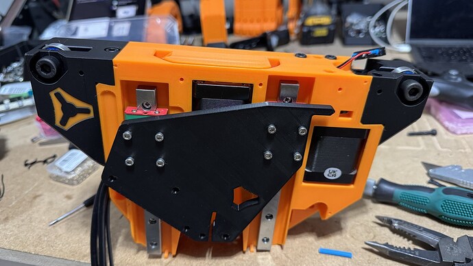

After version 4 of the LowRider CNC was released, I quickly reviewed it and began printing the parts. Yesterday, with some free time after work, I started disassembling my LR3 and moving the components over to the LR4.

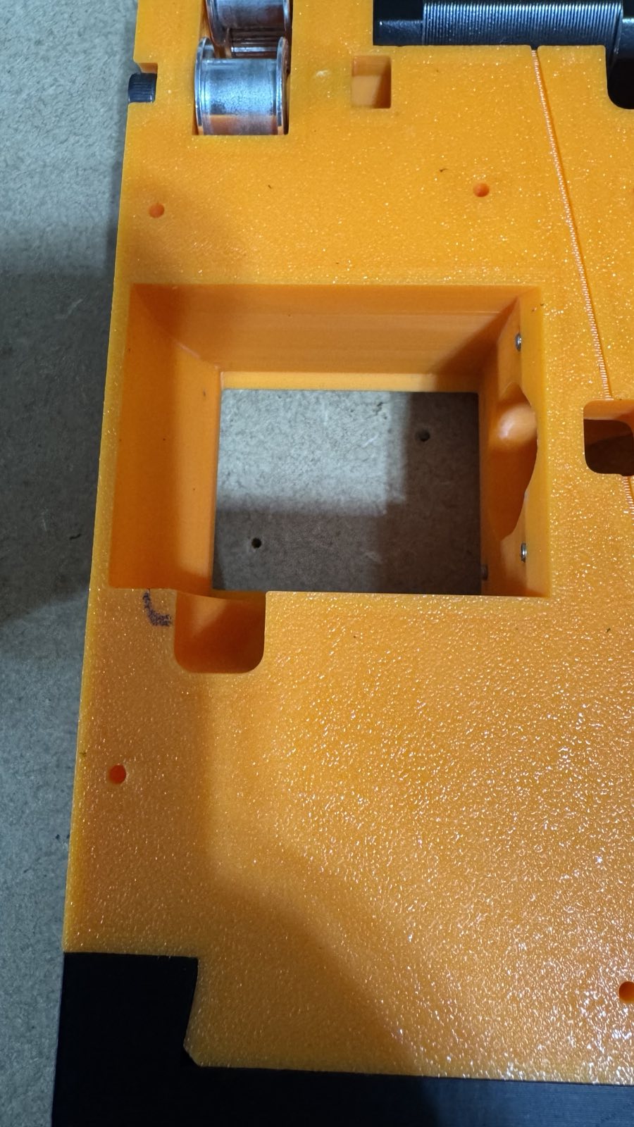

That’s when I discovered that the motors I used in my initial assembly don’t quite fit in the new design—probably because they’re from a newer model, but I’m not entirely sure.
As you’ll see in the pictures, I used motors with connectors on the body because I wanted a cleaner look without exposed cables. I also like building things that not only work well but look good, too.
Since I didn’t plan ahead for the space needed to fit the connectors properly, I had to make some adjustments. Using a soldering iron, I carefully melted and leveled the plastic to create enough room for the connectors and align the motors in place.
I’ve already shared this issue with Ryan, and he’s up to date on the situation. I sent him pictures, and he said he’d make some modifications that I’ll test. If everything works, he’ll release updated files with the new version.

Since I know Ryan is super busy, I took it upon myself to modify the XY blocks to address the issue I described in earlier posts regarding the lack of space for the motors. To do this, I converted both STL files (min and max) into solids using FreeCAD—it was the only software that could handle the conversion properly, as Fusion 360 kept throwing errors. Afterward, I made the necessary adjustments using SolidWorks. While my modifications aren’t perfect due to my limited experience, I think they turned out pretty well.

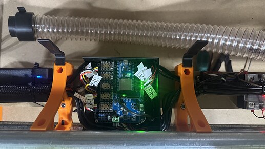

If you ever have problems with the connection to the Jackpot, remove the cables from the top of the ESP. I think it is recommended to route them under the board or around it. :slight_smile:
Glow-in-the-dark paint sounds like a fantastic idea—it could add such a unique touch to your build. If you try it out, I’d love to see how it turns out! :blush:
As for the connection to the Jackpot, that’s a great tip! Routing the cables under or around the board makes a lot of sense to avoid interference. I’ll definitely keep that in mind if I run into any connection issues. Thanks for sharing the advice!"
Finally, I returned to working on the CNC and completed the final assembly. I installed the kinematic tool, and both the laser and the pen holder fit perfectly on it. I also connected everything to the board and followed Philip’s suggestions to run the wiring underneath the board—something that’s also mentioned in the LowRider documentation.
Took additional steps to enhance the build, such as wiring the board neatly, installing a kinematic tool for quick tool changes, and preparing for both laser and router operations. Completing the build and seeing it come to life has been an incredibly rewarding experience.

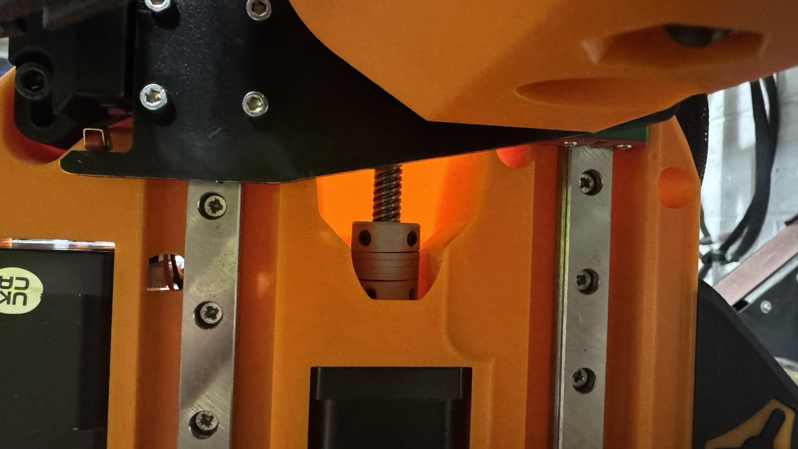

During the first start-up, I ran into a small issue with the Z-axis. The beam wouldn’t lift, and it seemed like something was preventing the motors from rotating. When I manually helped the motors rotate, everything worked fine. Thankfully, the forum members helped me troubleshoot the issue. It turned out that one of the screws was behaving strangely—it seemed to have a problem with the adapter connecting it to the motor.
I replaced it with a spring-loaded adapter, and at the same time, the forum members recommended lubricating the rails and screws.
After taking these steps, the problem was resolved, and I successfully drew my first crown!

Looks really neat. Word of caution though: Your steppers are missing the heatsink! Those little blue spikey things. :slight_smile:
Having the CNC run for the first time is really an awesome feeling! Congratulations. :smiley:
Oh yes, I need to fit them! I just have to find them first—there’s way too much stuff in my garage. :sweat_smile:
