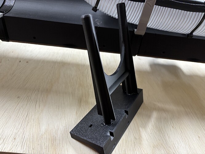

Also, I’m working on a bracket to position my dust collection hose and wires to my liking above the core on the gantry
Printing this now, we’ll see how it works
Essentially, the base is printed upside down and gets held onto the gantry with the two zip tie locations, and the goal posts slip into it from the top and it will likely be glued in
well, the design almost worked. Somehow, the slats for the second set of fins got eliminated somewhere in the conversion to an STL, but I’ll still make it work by snipping the fins back and then gluing everything in

Some pics of the hose mount test part. Still in dev.
