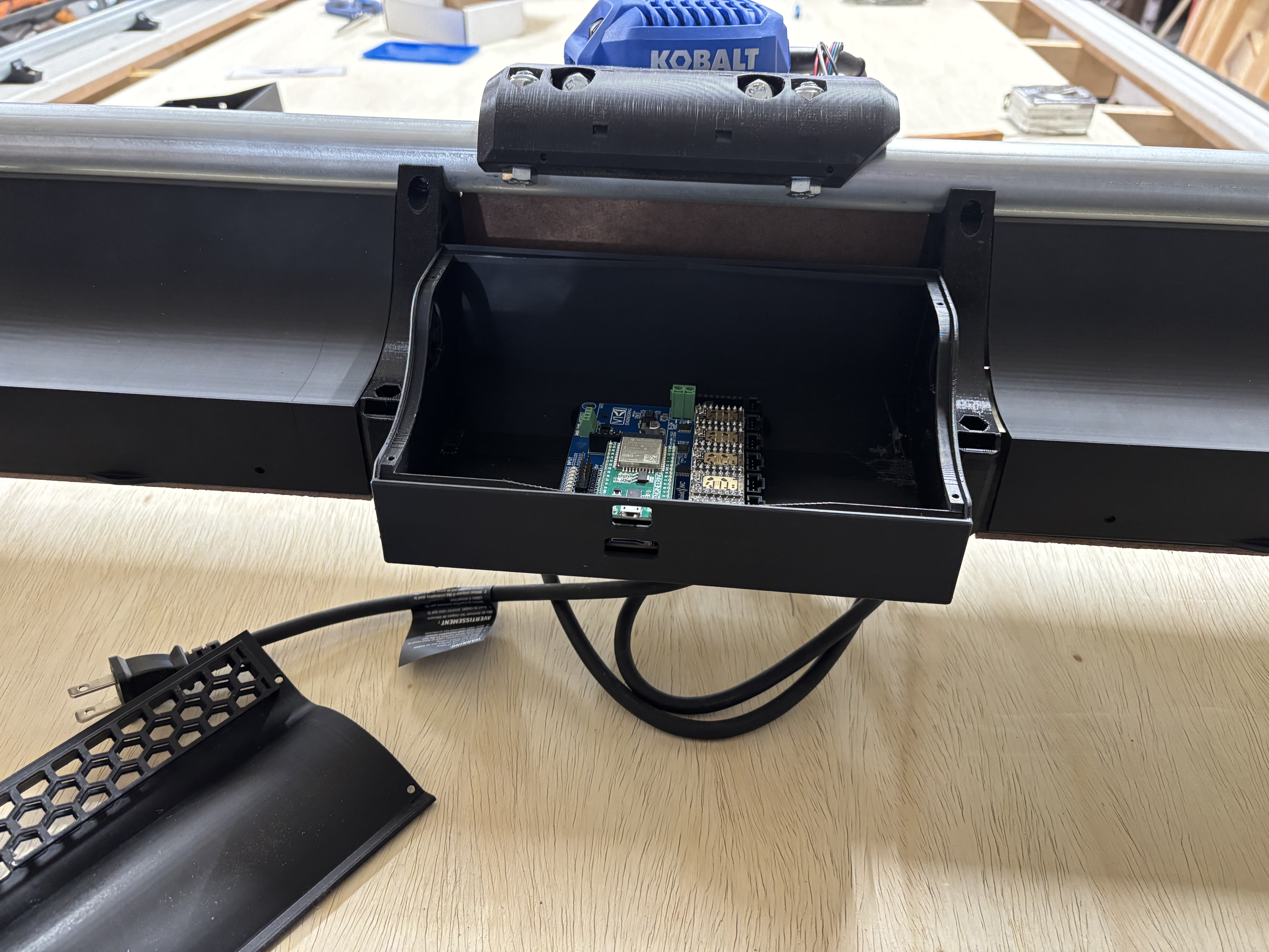

LR4 - If I can build it, anyone can build it - unless it turns out I can’t build it. LOL
That is awesome. I downloaded it and then I learned how to turn it into a solid using fusion 360 and then I learned how to slice the body and then I extruded the distance that I needed back to the middle part roughly the same on each side so it ended up being 209.55 mm wide, which is what I needed based on the Doug covers I printed.
I first tried to scale it along the X, but then realized it was changing the mount for the board so I knew at that point I had to cut both ends off and extrude them back. Save it as an STL and now I’m printing
One of these days I’m gonna learn how to make the settings right so a box like this without the lid doesn’t take over five hours lol. :joy:
Thank you again for chiming in, couldn’t of done this on my own
Cool!

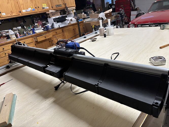

Got @DougJoseph covers installed
Wow. nice.
I did almost the same thing, only using 3D Builder (which I’m not sure you can get anymore) to edit the STL directly. Now I think about it I wonder if you could make all the modifications needed using plane cuts in prusaslicer…
I also had to drill a few extra holes to run my cables in (I’m using the 3 holes in each strut to run 4 core cable through) so it’s a bit butchered but the lid hides all my sins.
I think there’s just enough room in the box for my laser control board as well. That’s the next job once I get time to go back to it.
Finished lid
More of the nice!

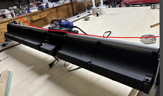

I really really like those covers, but please be certain there is lots of room to move on them. If they are a snug fit chances are very good chance they will bend your beam toward the front.
If they sat on top of the braces I would be less nervous. But that would cause them to need to be 30mm longer.
These are pretty loose but. I will go back and double check. The nubs that are inserted into the braces stick out just a tad, but the hole they seat in can be dug deeper so there is no pressure (did this by accident removing bottom layer as they are printed on end). One is so loose it won’t stand up open. :smile:

What does your board wiring look like?
Like a family of rainbow colored rats threw up in their nest. :slight_smile:
I just plug in according to the pic…
The general recommendation is not to cross the wires on top of the ESP32 so you don’t interfere with the antenna. The best way to do it is to pass things under the board and bring them up just enough to hook them over into the connector.
Also, if you’re running jobs from the SD card, you won’t need WiFi during the job itself. Although it will be super inconvenient if you just want to pause the job instead of hitting the E-stop. However, if you have reasonable WiFi signal at the machine, and you avoid wires over the top, I’d bet it drops less.
Here’s your disconnect problem…
As the docs recommend…
:bulb: goes off
I knew those rats were a foot. Thanks
So excited to test movement that I completely overlooked the wires. LOL
Last night after “reading” the destructions again, I see where it clearly says KEEP THE WIRES AWAY FROM THE ANTENNA :laughing:
After rerouting the wires away from the top of the board, it stayed connected. I hope that is that on that.
