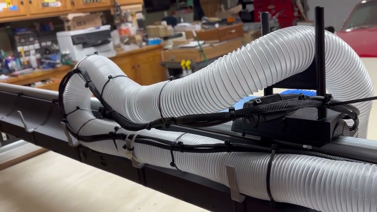

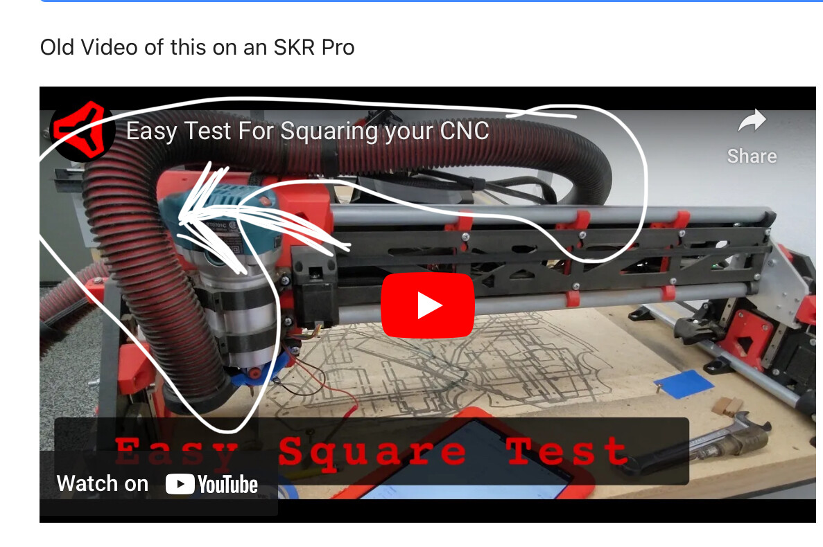

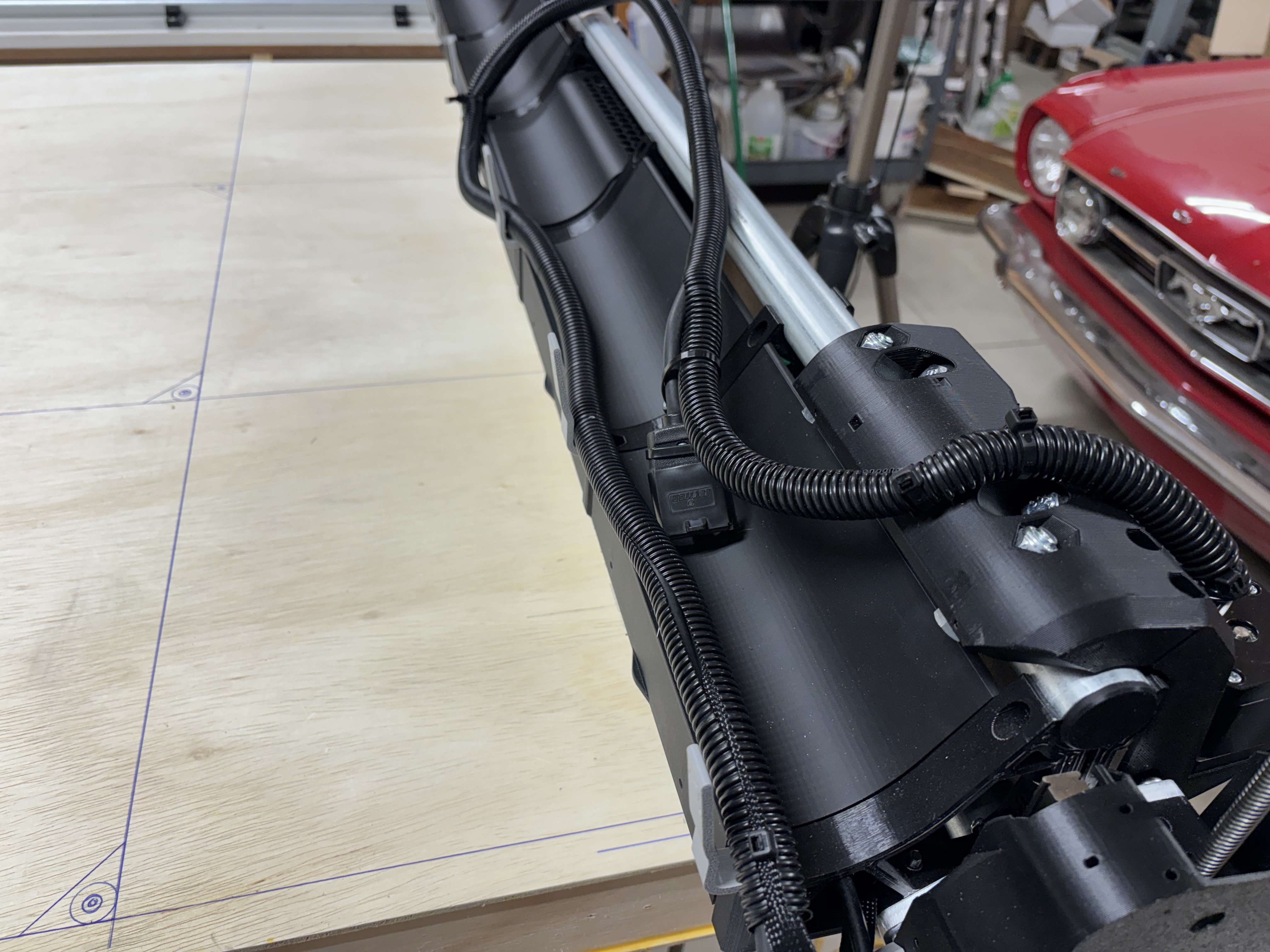

LR4 - If I can build it, anyone can build it - unless it turns out I can’t build it. LOL
@vicious1 Ryan, I would like to know the brand of your dust collection hose in this vid if possible. The one I got from amazon will not hold enough shape to coil and uncoil as it should… flops all over the gantry…
Much obliged
the funny thing is I had seen this work successfully several time, and the time I go to video to show off the holder i made it does this LMAO
That is the LR3 one, it is smaller, but it will still work with a small spacer. It should be linked in the LR3 instructions. The LR4 version that is linked is bigger, it takes a try or two to get the twist right but the floppy ones will stay. I zip tie it at the half way and the top of the core when you get the twist right.
ok… I’ll keep trying lol or I’ll set it on fire :slight_smile:
Make a video either way!
Ohhhh, take the wires off the hose. Get the hose right first, then get the wires right separately. They move different. I attach them at the very same point but they move different.
The wires should be super easy. That is why you do them second. The hose do it first. Try a half twist, either way. When you get it, it always works.
Not sure if your kickstand is helping or hindering. You want it to fold back on itself, you have it kinda up in the air.
Worst case you might use the tape measure trick to keep it inline.
Sorry the video was not there the first time I saw your comment, always add it as a new comment so I get notified, I do not get notified of edits.
Funny, I am just seeing your replies this morning… coincidentally, late last night (about midnight) I did think to separate the wires from the hose. I actually ran the wires and the power cord in a split wire loom and it now flows fine on its own as you said. I put the pen tool in place of the router so I have not monkeyed with the dust hose yet… I won’t give up until it works :slight_smile:

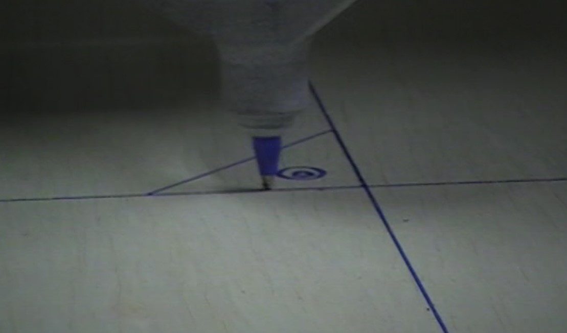

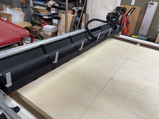

On a good note (at least it would seem), I was able to verify square and then draw a grid, and the hole markings that will be used to put the threaded inserts in so I can fasten the spoil board down using counter-sunk M8 nylon bolts.
Oh, and I drew the crown too.
If you had a CNC machine, you could have it do all that work for you… :rofl:
If only……
Actually, I did exactly that LOL
I mean drill the holes and make the pockets, why bother with the lines?
Because I can draw with the pen. LOL. And it was midnight AND i was just messin with the DXF files… I will DEFINITELY be using the router to drill out the holes… so they will be in the same place once I lay the 3/4 spoil on there. LMAO.
And because I like to be difficult, and I am older….
Get off my lawn…… :slight_smile: I think I will watch ‘Grand Torino” tonight.
LOL. Thanks for the laugh!

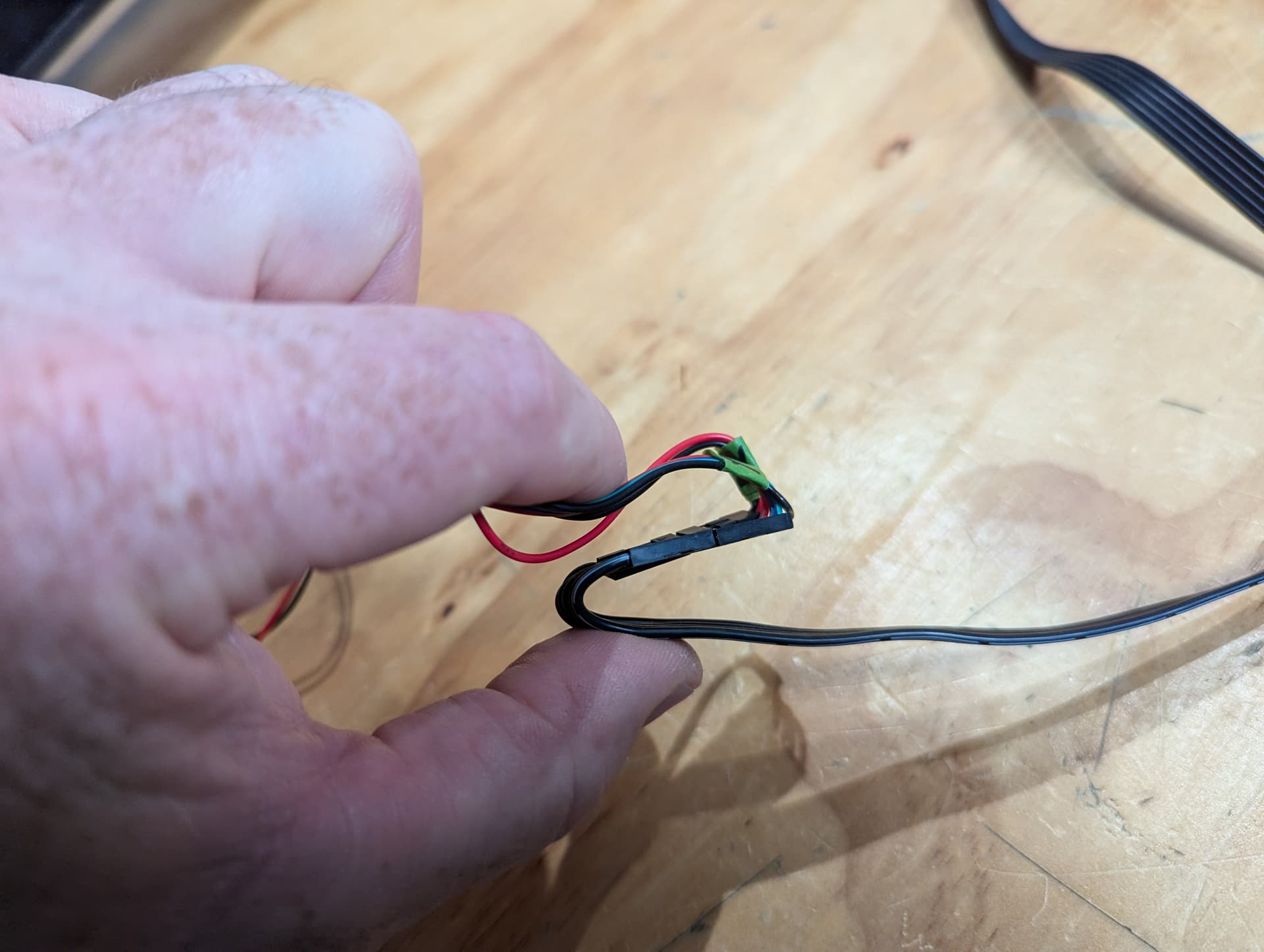

today I was all set to drill and carve the mounting pockets/holes for my full-size spoil board… it started out just fine as it did with the 24x48 one two days ago… then an odd thing happened. the rail side after drilling out hole 5 decided not to raise back up after drilling out hole #6 and drug the bit across the spoil board to start hole #7. not sure what caused this nor was I able to repeat the problem on that rail side. However, the Z dropped on the non-rail side when I attempted to re-home and re-run the job (less the first 7 holes of course) and would not come back up… very weird indeed. after that I re-homed again and ran the job… cut all 22 other holes and pockets w/o issue. nuts isn’t it?
if you care to watch… maybe you have insight… :slight_smile:
At risk of having a pan thrown at my head, are your grub screws tight? LOL
Check your wiring. That sounds like a loose connection to that stepper motor. If its on an extension cable did you loop and tape it like Ryan shows in the docs?
https://docs.v1e.com/lowrider/#wire-routing
I can only answer that if I double check. Lol
