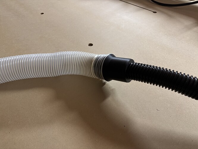

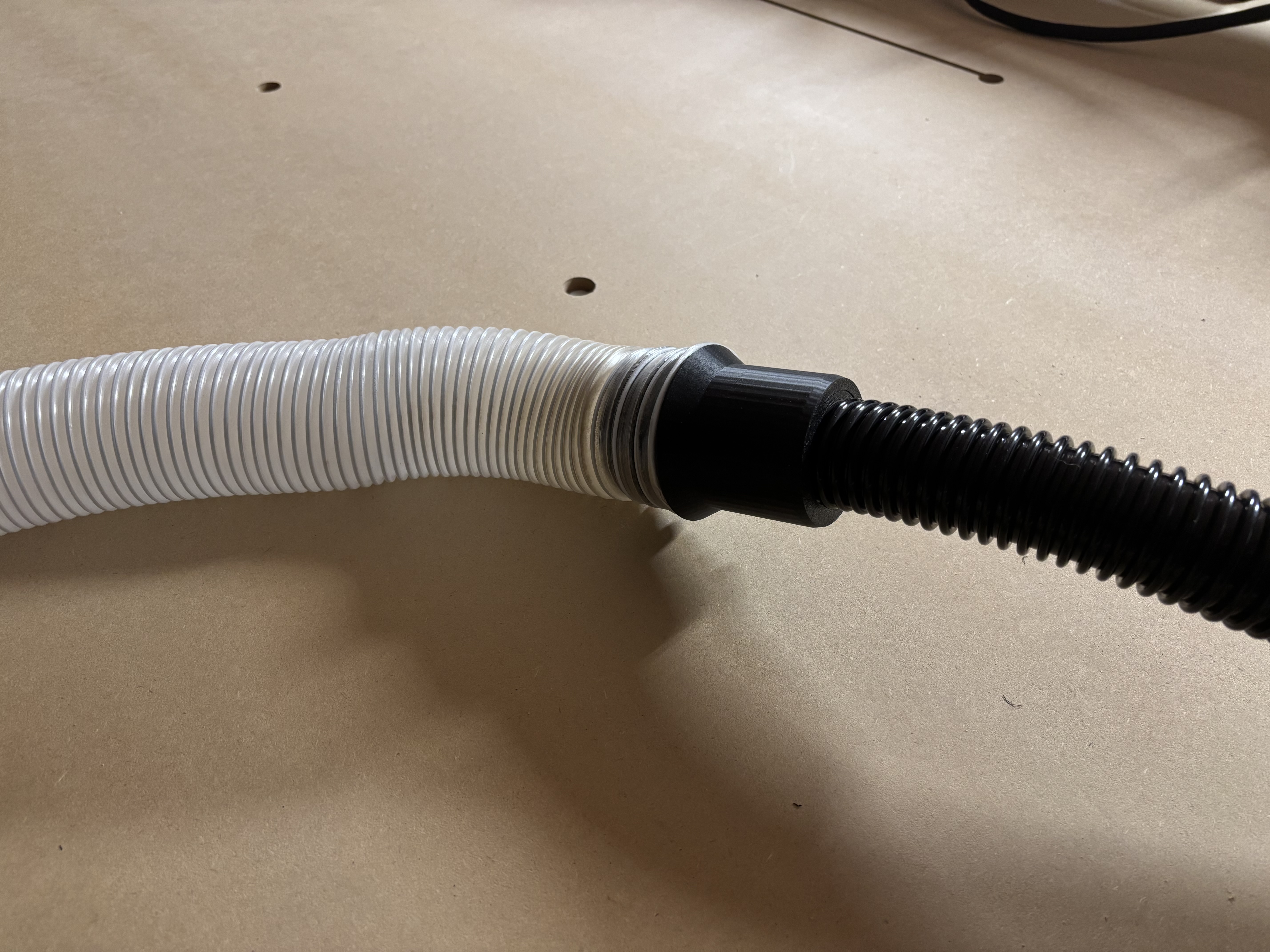

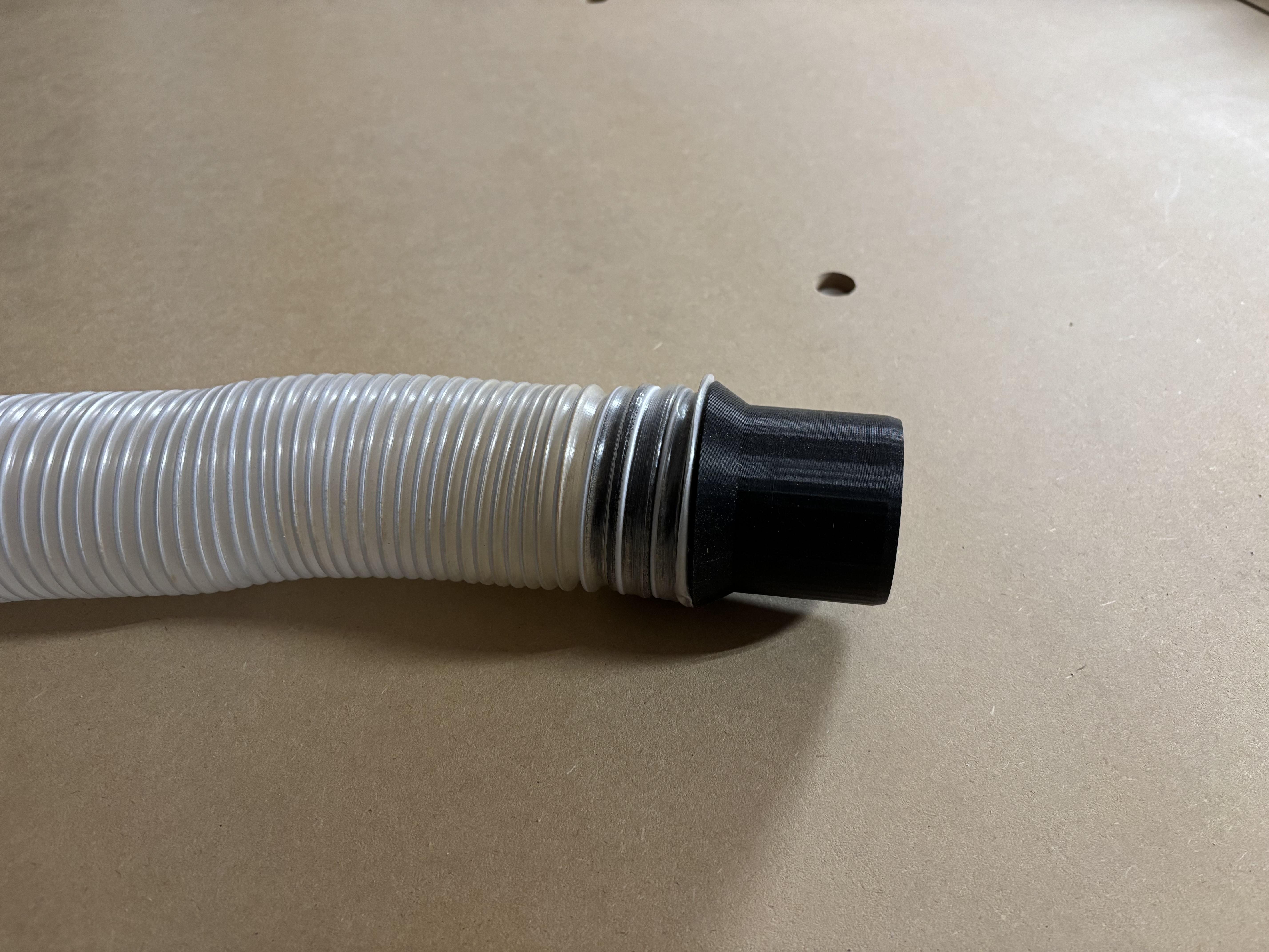

Well… I didn’t get to cutting anything today. However, I did manage to create a reverse-threaded coupling (using parts from other works) and printed out the following part. It allows me to attach the 2.5" dust collection hose to the Harbor Freight Hercules Dust Extractor which has a 1.625" hose (approx). it all fit snug and tight and plenty of extraction.
If anyone wants or needs, happy to share

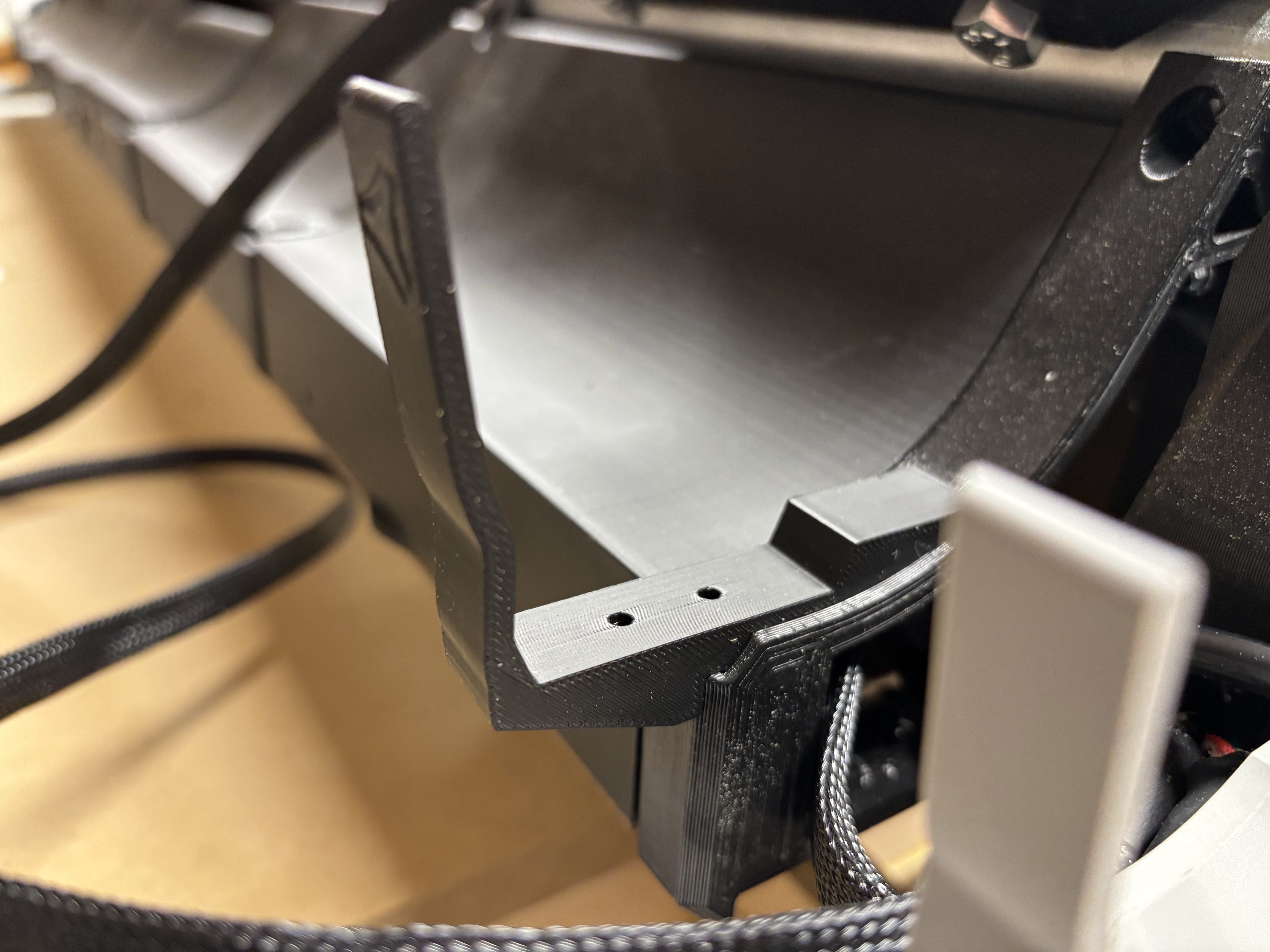

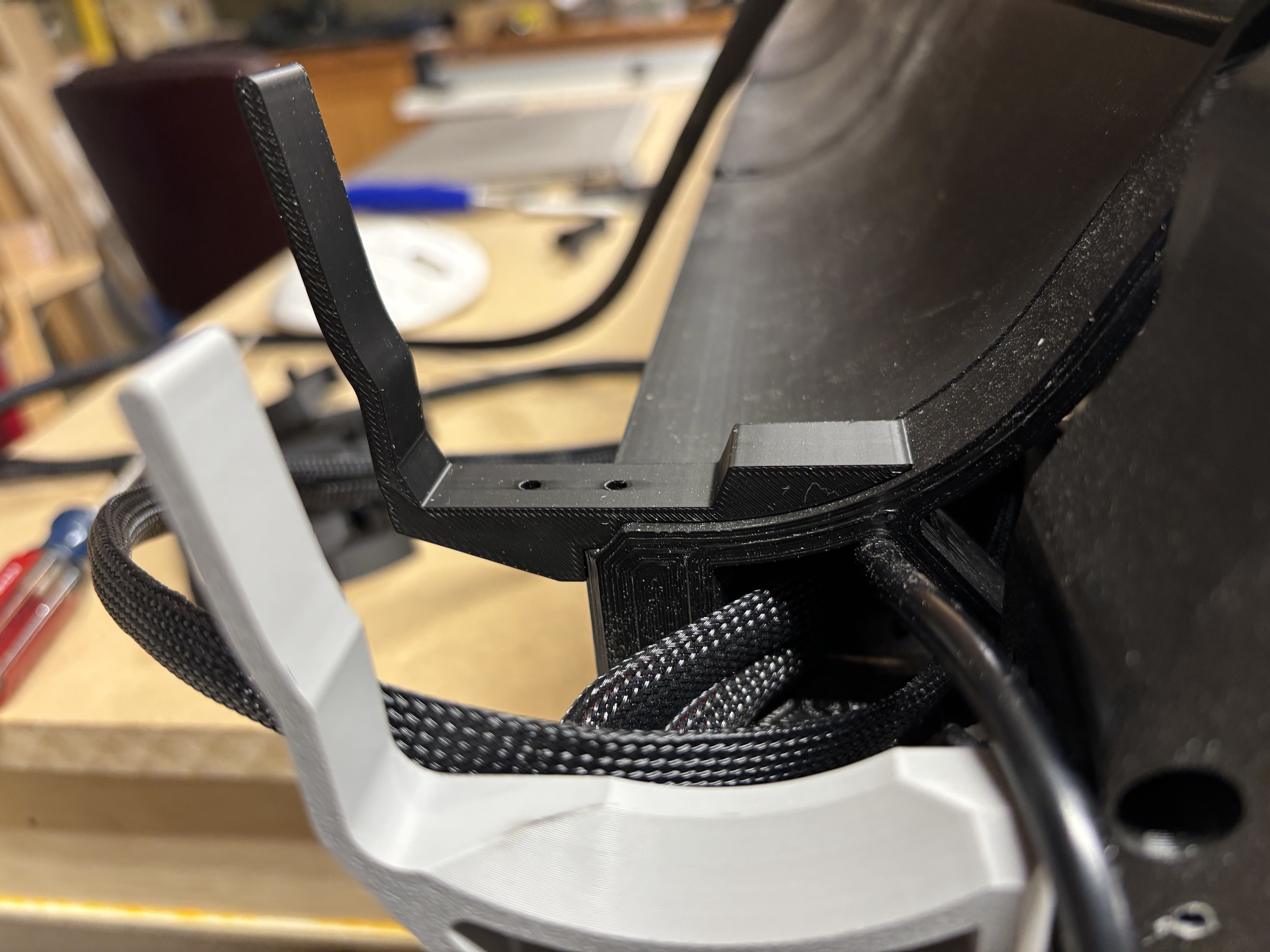

Working on a few odds and ends…. Recreated those little brackets that set into the gantry supports that included an area for a 15x30 drag chain.
I then installed drag chain for wires along gantry and recreated a mount on the core for that drag chain so that it sits higher than the dust collection hose that also shares the same space along the gantry. If this does not work, then I will likely make a boom arm for the dust hose from 3/4” electrical conduit.
That is looking great! Are you using a 2-1/2” dust hose?
Yes… the 2-1/2” hose referenced in docs (amazon)

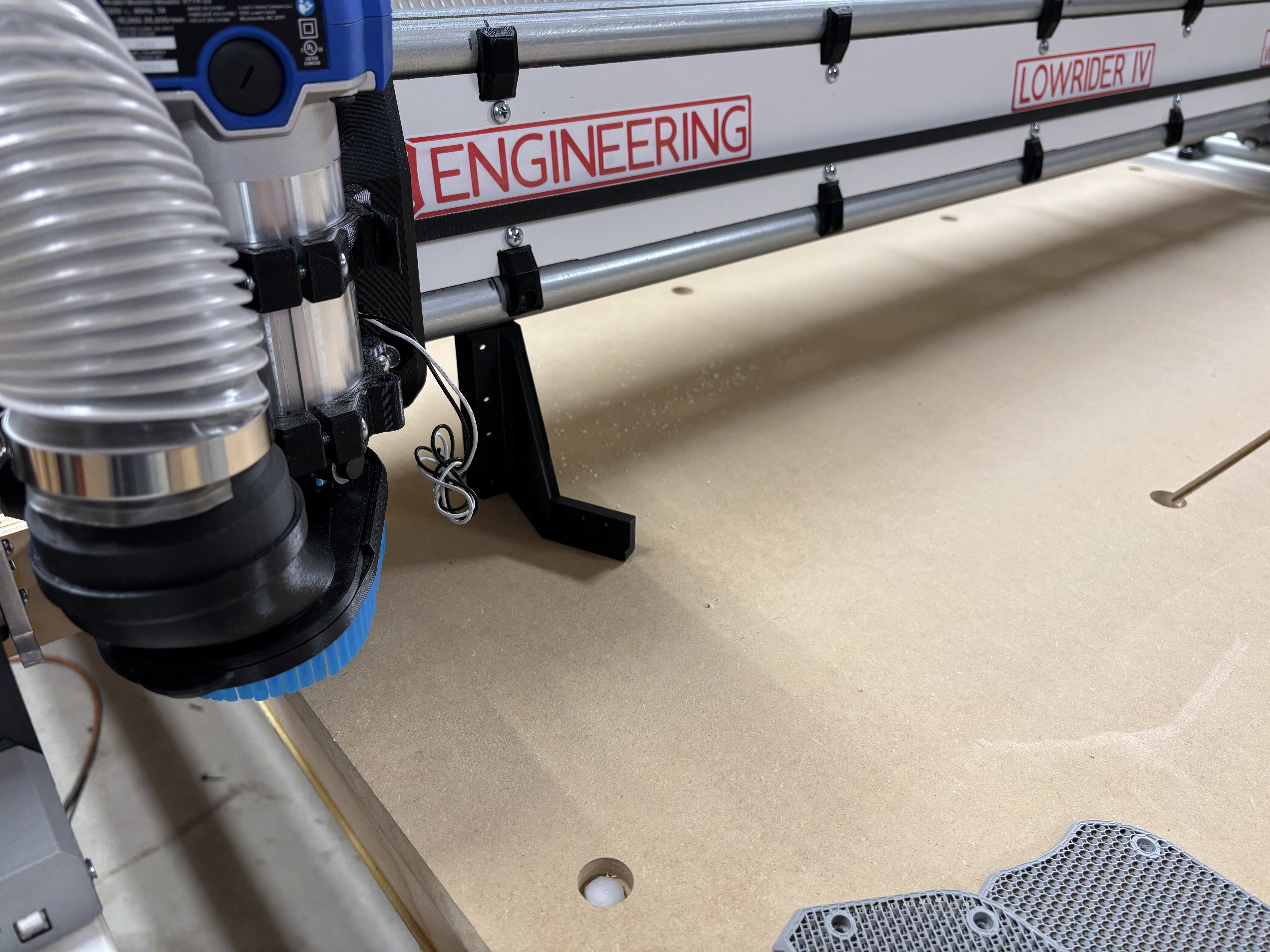

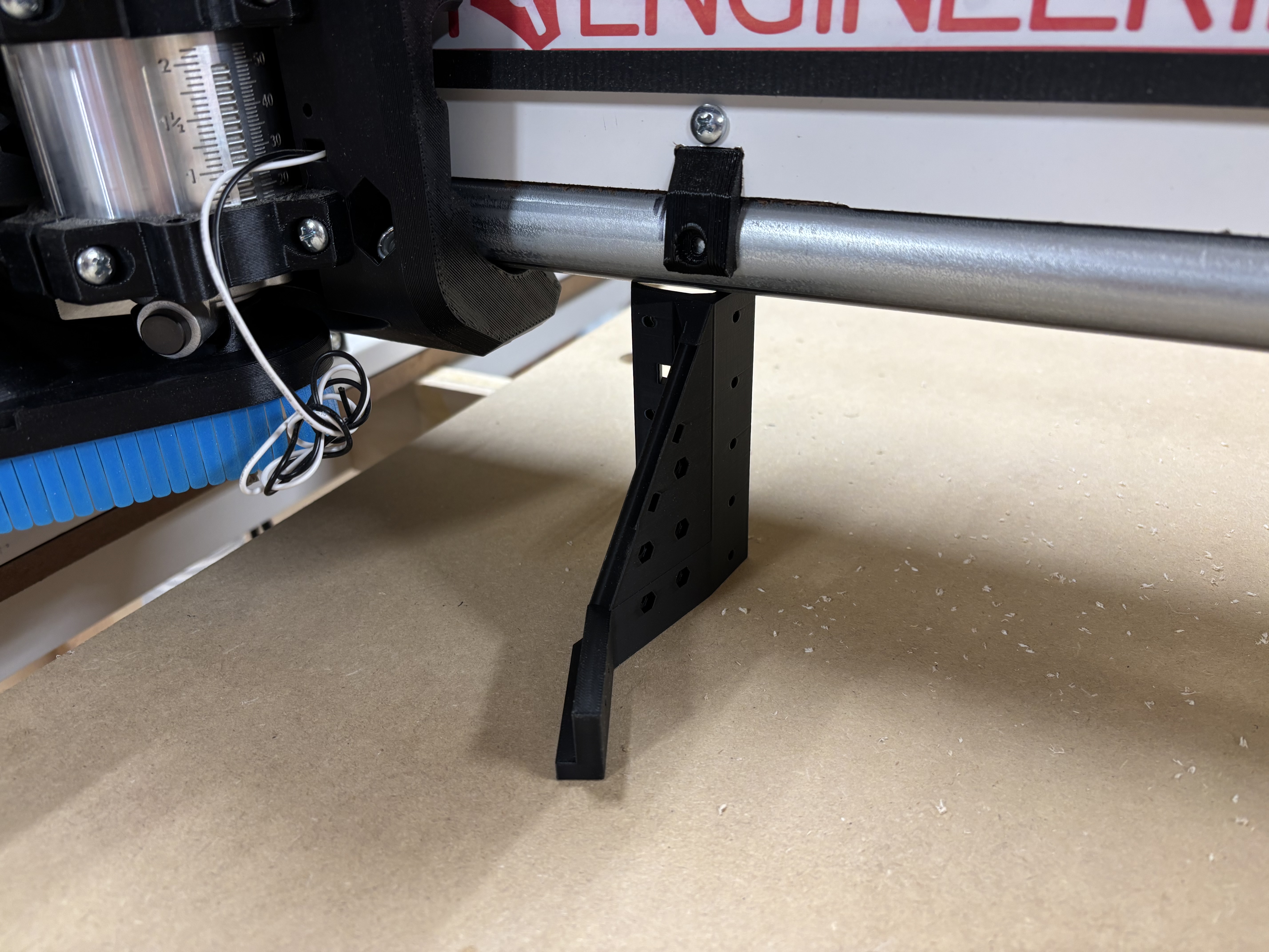

Found a good use for the drag chain bracket that I will not be using
Makes the perfect kickstand when I power down

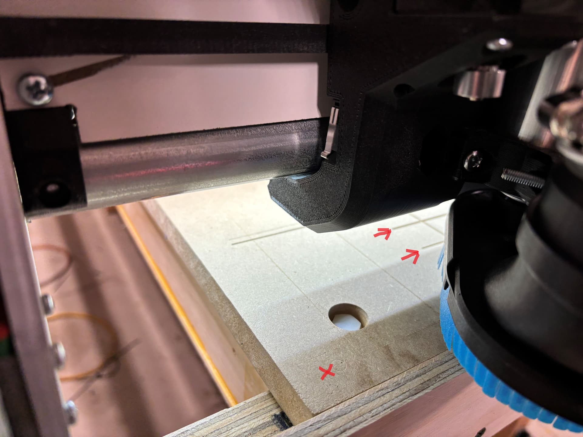

Well today I attempted to “draw” the grid on the spoil board using 60* Vbit at .5mm deep and I learned that my machine will not go the entire 48" without hitting the rail side plate. I believe my strut plates that I cut on the MPCNC were off just enough to cause the space between X0 and X1 plates to be short. I tried 47.75" and it still hit. I was able to carve 47.5" along the X. I think I will rebuild the entire gantry (unless y’all talk me out of it) and this time make it to handle 49x97 MDF which I wish I had done in the beginning. :slight_smile:
I did notice that when I home X, it pulls off and I assume that is ZERO… but it seems that when the job starts, it is a bit further off that pull off distance… this is where not knowing what one’s looking at comes into play LOL
How long are your gantry rails?
Whats the x motor pulloff you have in the firmware?
That pulloff should be 3-4mm. That accounts for the endstop travel so you can squeeze out every mm if you really want.
Ran a quick single line carve test 1" up from the bottom and 24" wide. the machine is starting the job well beyond that 4mm pull off point. not sure why it thinks x0y0 is so far off end stop in the X direction.

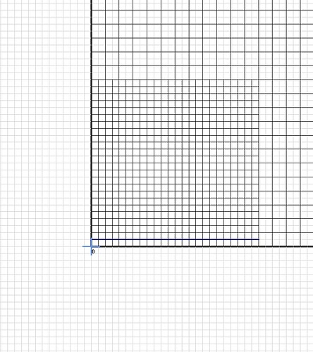

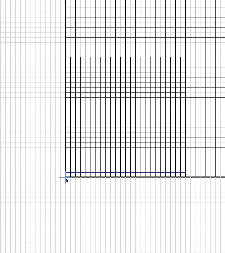

so this is the pic of the grid in Estlcam… I attempted to just carve one line along the X axis 1" from the Y min edge. I homed and it homed X and Y about where the red X is on the image.
and the work space is 1200 x 2438.40mm) and don’t have a problem with the Y as it is about 1/2" from either end of the 97" MDF.
then when I ran the job (which the 0,0 was the corner of the grid) it started the job where the arrow shows… way off the 0,0 actually 4-3/4" off what otherwise would be the edge of the min side.
and now I think that is why the core is hitting the max plate when trying to run 48" across as it is starting from a point other than 0,0 even though I home X,Y and Z before Z probe and job run.
@CesarH the distance between each of the aluminum plates is 54 3/4", the pulloff is whatever was default… verified it is set to 4mm

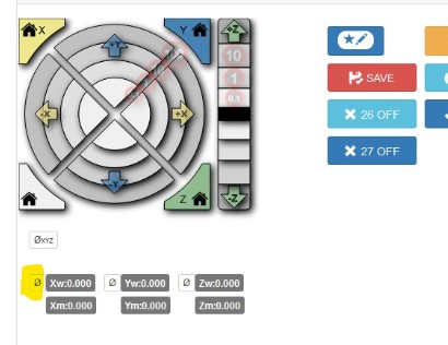

am I wrong thinking that the X0,Y0 is the origin and jobs should start from that point?
What is showing up un the x coordinate after you home the axis?
According to your estlcam origin it should start at x0
B I N G O
when I checked I noticed it was -100 when it homed… not sure how that happened, and I merely guessed at how to reset it. I had no idea that was even a button or what it would do but WTH, I clicked on it regardless. Then I saw it changed from -100 to 0, and once I did
zeroed out X
it carved the line in the correct location. LMAO. live and learn is the fun part of this for sure. but not knowing the right question to ask… as you did which prompted me to figure out what was out of whack.

now to test a 48" line and see if it still slams against the max side plate fingers crossed!!!
Just ran the full 48" carve along the X… it fit fine.
