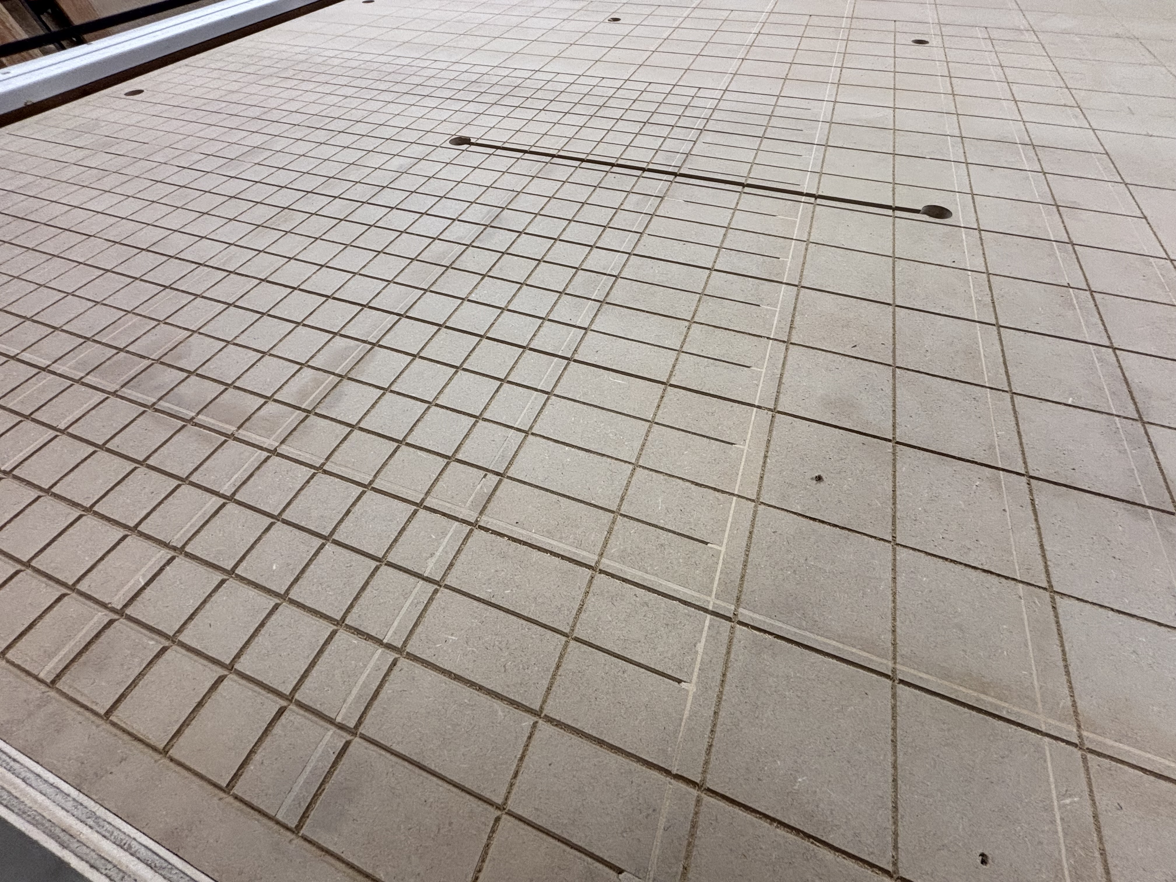

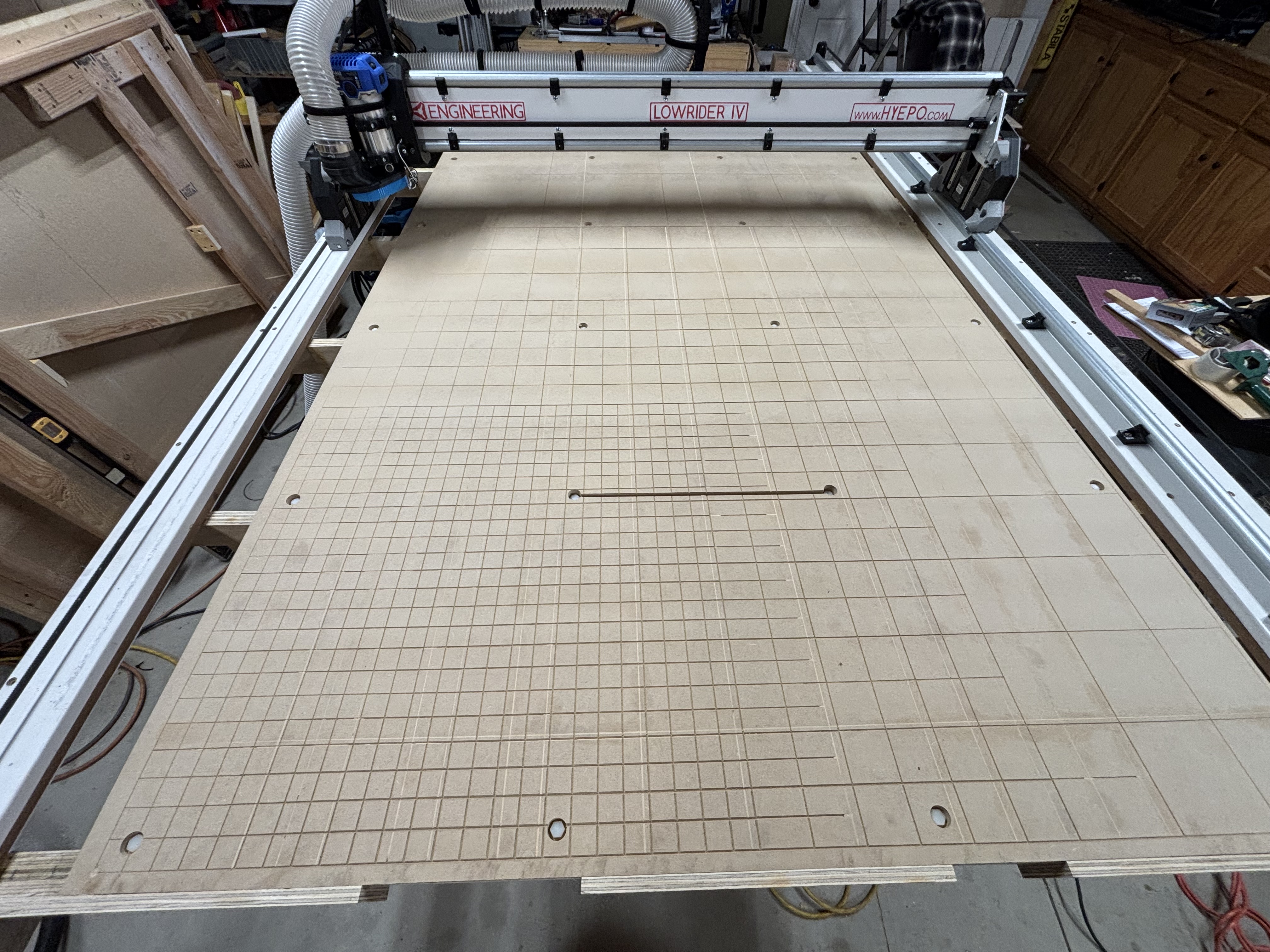

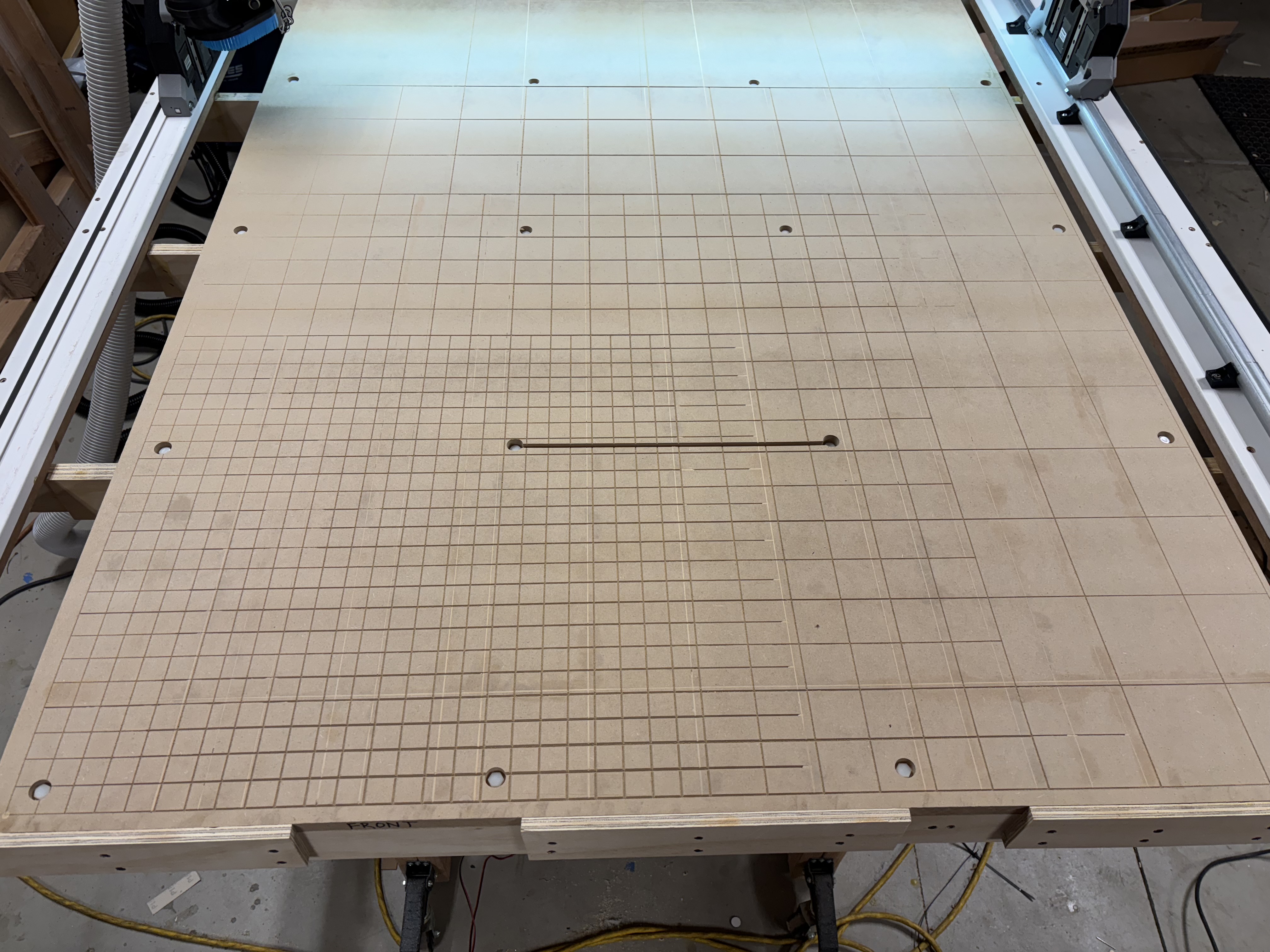

Tonight was a success
I actually filled in the incorrect lines from previous attempts, well mostly. Some of the 1” square grids lines went beyond the 24 inches but no harm there.
Took roughly 20 minutes to carve the whole grid
I have a 24 Inches square of 1 inch grid, 36 in.² of 2 inch grid and 48 in.² of the 4 inch grid, back half or just 12 inch squares.
Pretty much the way I have it will cut out cabinets, & any other 2D items. But I think I will at some point try to flatten the spoil board to the table and try my hand at some 3-D carving just for the hell of it.

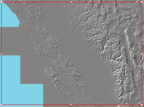

Nothing new to report. Did some odds and ends and ordered some 1/4” bits. I created a height map of the Central Valley of California. I will be attempting a 2.5D cutting of that file… I created the stl off gov map thing, and will likely view and adjust in a 3D print slicer and resave as stl. Then to decide on what to use to create the tool paths. Vcarve looks to be the most desirable but is quite pricey. Easel has stl import but limited on file size of 100mb eliminates most of my ideas. LOL.
Input? I know I can do 2D carving with no issues (based on the primo and LR4 tests) but I thought I’d jump right in on some 3 axis wood chopping……
ESTLcam can open STL files and do 2.5D carving based on them.
Yup but limited to 100mb stl and does not control the LR4 with the FluidNC. I suppose I can export to gcode and use the WebUI, but would rather just do it all in Easley or Vcarve…
Hard to justify purchasing either (and the cabinetmaker) when we can’t utilize full functions.
Still will give it a go and see what happens. Just waiting on bits to arrive. :slight_smile:
What exactly are you trying to control about the machines with that program? If anything seems to be missing we might be able to add it.
It is very odd to do anything other than drive to a starting position and hit go. If you stream commands from a program you have an extremely likely chance of error, I highly recommend against it at all costs. Running directly from a memory card is the only way I would do 30+min plus jobs.
I did not know about the 100mb limit, that is new to me but if it is valid did you see what the difference in triangles was on your file? 300million down to like 100million is not ever going to be noticeable. That GIS map could very well have nearly fractal levels of details that will just bog things down for no good reason. If your maps contain data in 1’ increments and your ball end is equivalently carving a 1Mile detail there is no reason to use it. I would argue your exported Map data was exported to high.
I understand all of this seems like things you need, but I am going to argue against it. Being able to pump in a enormous file is convenient but simplifying it is done with one or two clicks in most any slicer these days.

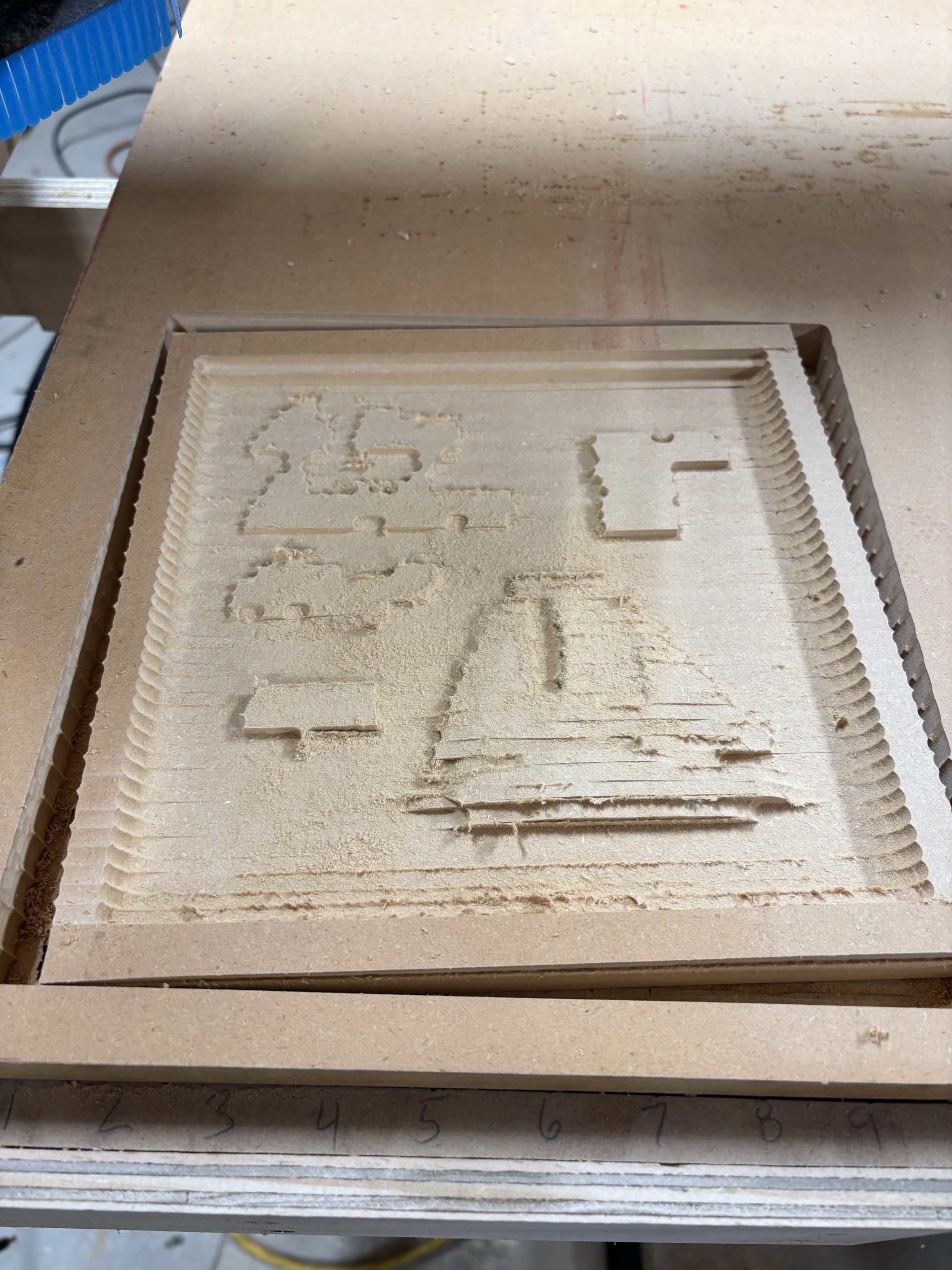

That being said, I did my very first carve attempt last night. The first carve was 50% successful and that was due to my own error of not placing tabs in the project. I learned by doing, and that’s okay, that tabs can be added during tool selection in Estlcam if one knows where to look (and now I believe do).

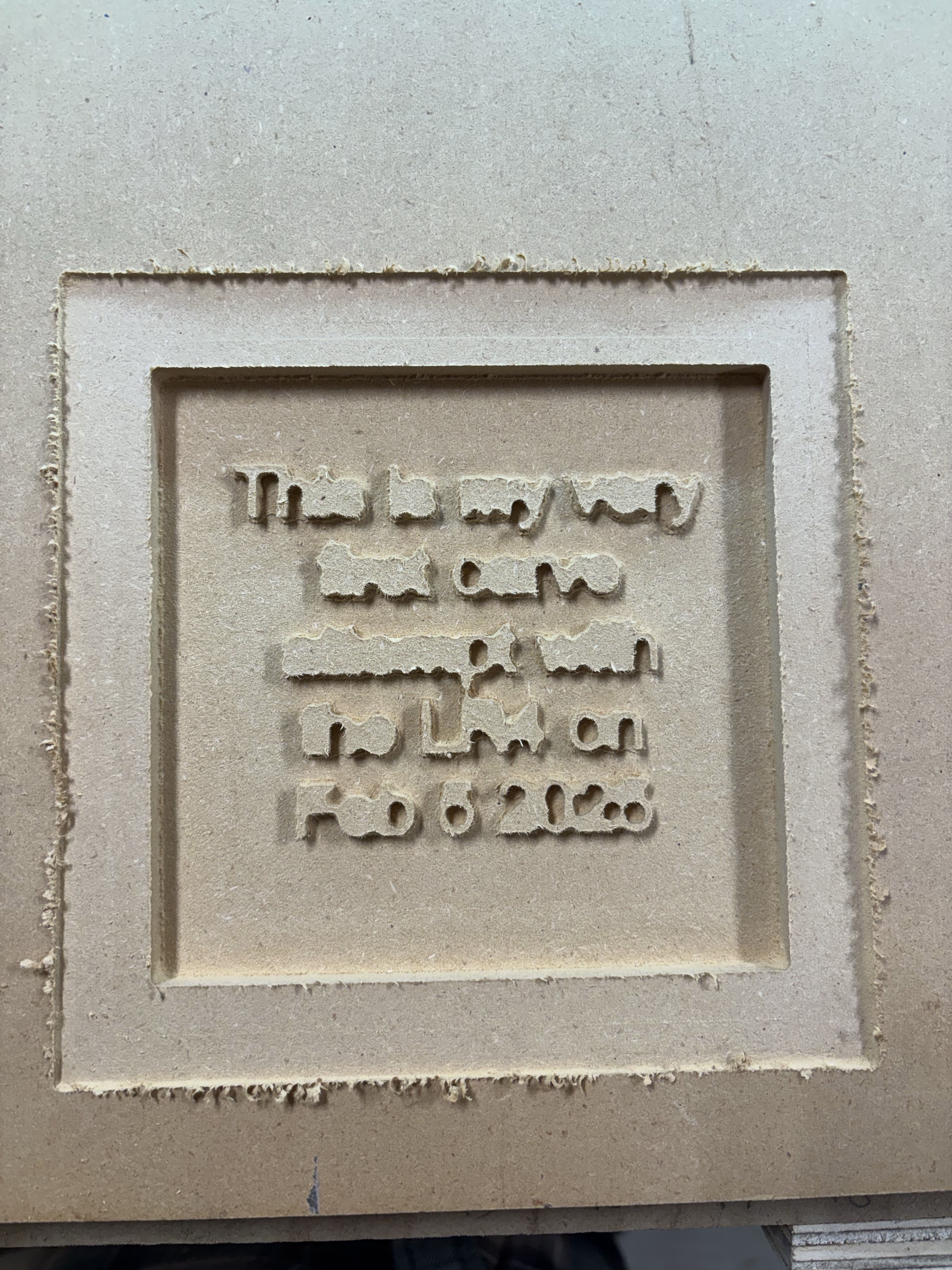

The second attempt came out as expected and again, learning by doing, on the finish pass I either needed larger letters or smaller bit (i used 1/8” where a 1/16 may have been advised).
All in all, it seems to work just fine and I am grateful for all the help. Now it is a matter of learning by experience…
Both jobs were made in fusion 360 and imported into Estlcam as STL files
Lost this one on the finish pass because I didn’t put the tabs in - what you don’t know that you don’t know… right? :slight_smile:
This was the first successful complete job. A bit small because it was getting late but it did exactly what was expected… will need to either make it bigger next time or use a smaller bit to carve such small letters. It was to say “This is my very first carve attempt with the LR4 on Feb 5 2025”
Although not perfect (but it was carved perfectly as programmed), it is still worthy of a coat of varnish and will be hung on the wall in my shop. :slight_smile: :grin:
