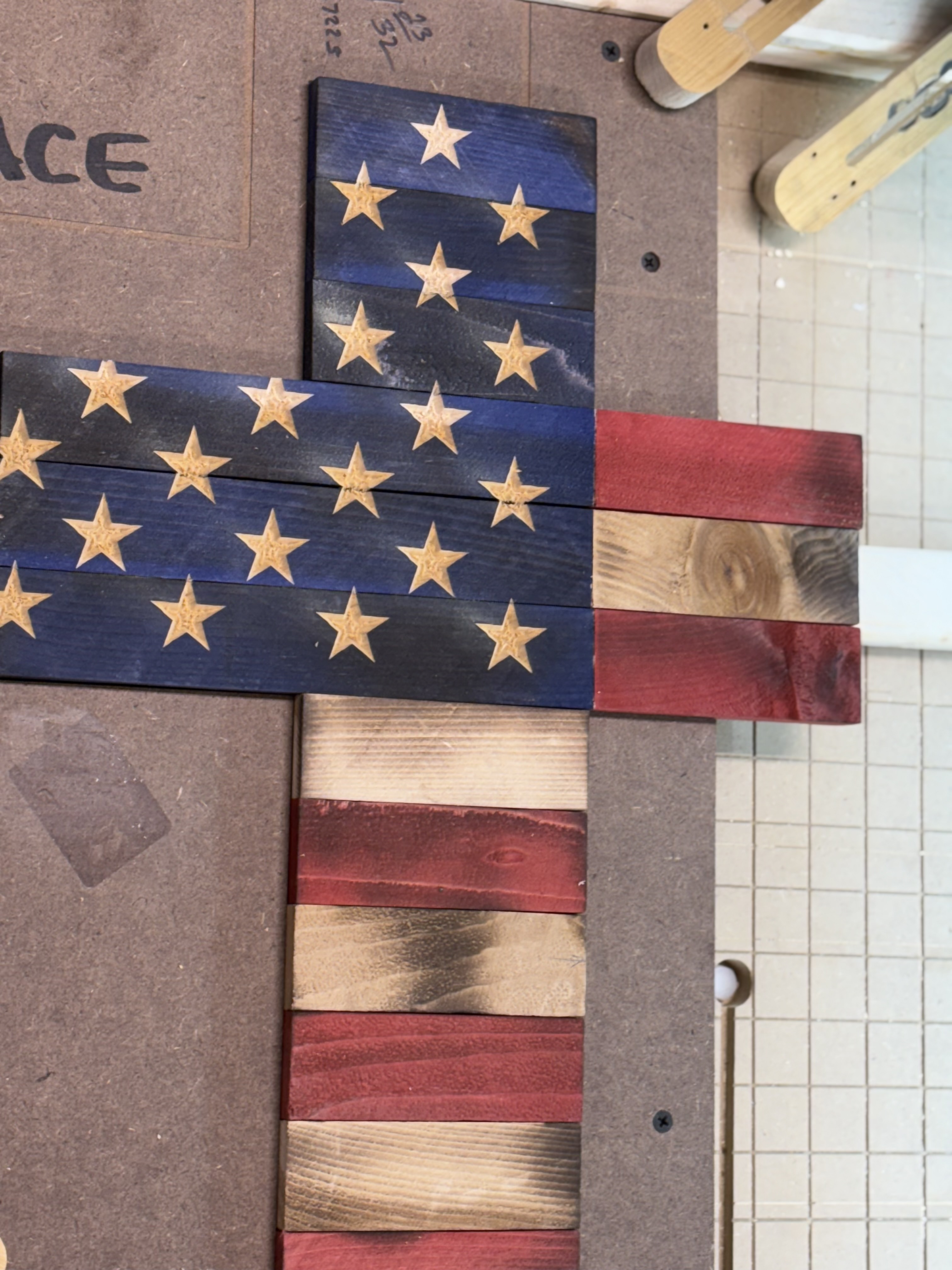

Finally, absolute success with the stars on the flags. Rather than carving one and wearing out my hands holding rotary tool (surprised how the hands hurt after hours of hand-carving) I can now crank these out in 20 minutes and finish up with hand rotary doing several per day.

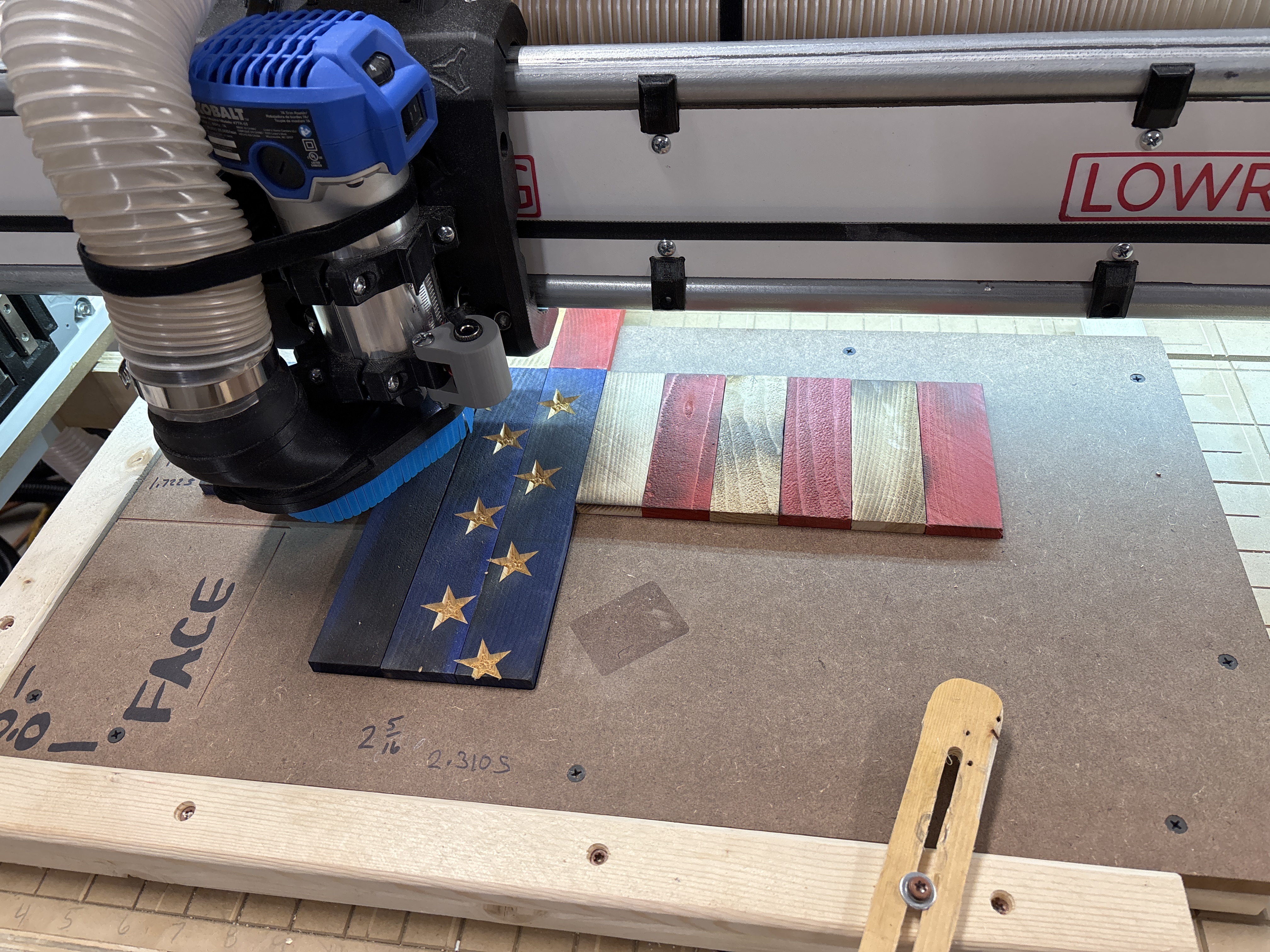

Today I’m carving stars
@vicious1, you’re correct, watching the axis move All 3 at the same time is quite entertaining.

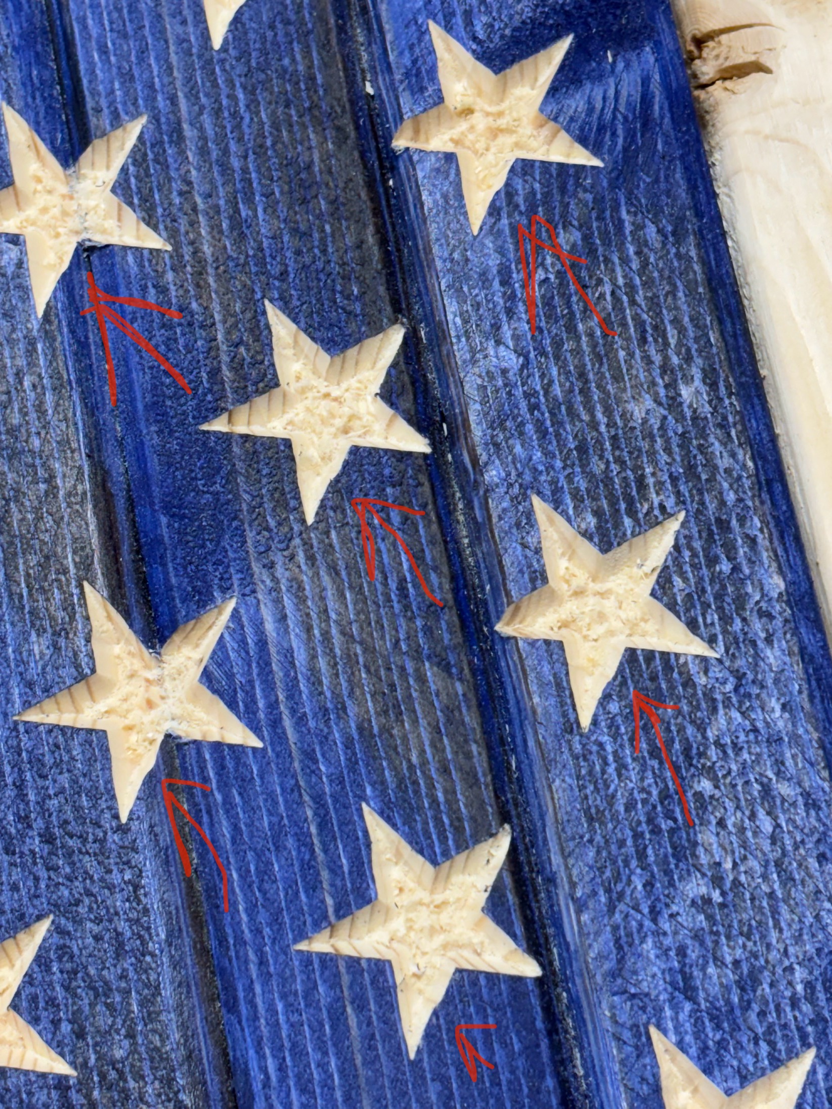

Noticed on the stars. Just a bit of a consistent nudge on the same edge of each star. Who gotta idea?
I’ve had this happen before when I was making flags, and had 2 different issues. 1 I was using what I thought was a good SVG, but it wasn’t. 2nd time I noticed I had 1 star layed over another. I believe I was using Vcarve at the time.
Well, I will look at my dfx file. I drew the stars myself using lightburn so pretty sure they are not drawn that way, however I would not bet my thumb on it. LOL.
I am using Etslcam to create the v-bit tool paths. Might be the star since it is consistently doing that …. Thanks for the tip. Hope its my star and not the machine. :slight_smile:
I just looked at the cross and the stars are the same. I used the full flag layout to make the cross. Bet you are correct.
It stumped me for quite some time, then I noticed a couple of my stars were just ever so slightly darker, so I started selecting each one and deleting until all were gone, then I used the undo button to put the last one back in. Lol
Star drawing are perfect and no wobbly lines. But the carve has on in exact place each time.
Might try again by rotating a few b/4 cutting and see if is drawing. .
