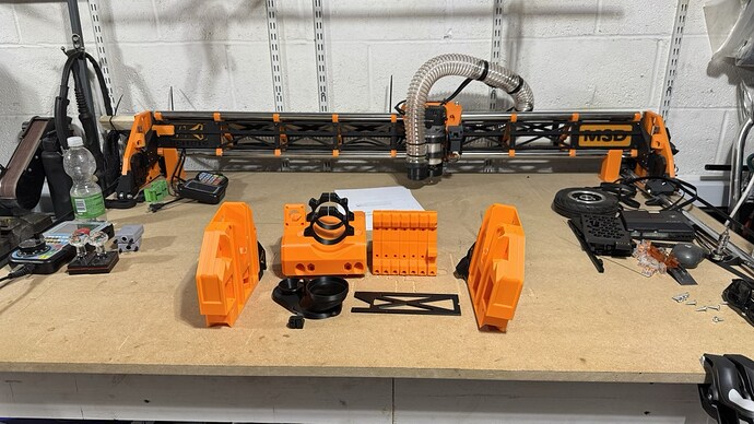

Started yesterday morning, a few more hours and the printed parts will be ready, the core took 22.3 hours, can’t wait for the rest of the parts to arrive from the US.
