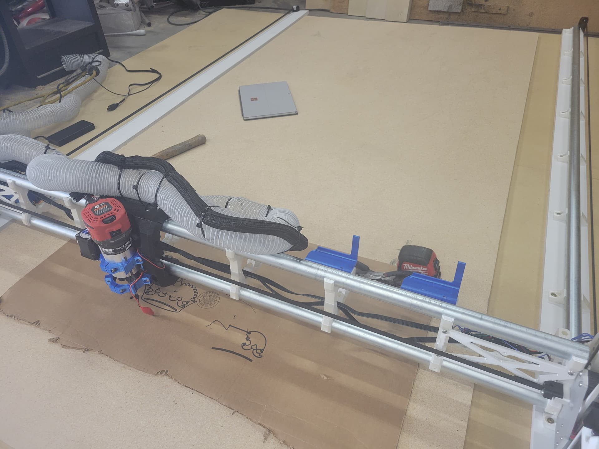

Proud papa couldn’t wait to share the progress on my interim LR4 build. I’ve got it set up in the full size “bootstrap” configuration so I can mill the permanent braces and spars/struts for a torsion box I plan to suspend from my shop ceiling with a hoist. As you can see from the picture I attempted to print the crown pic, which would have worked better if the cardboard was flat. I’ve got a few tweaks to make before I start flinging chips, but overall pretty happy with the progress so far, especially considering I started printing the parts on Oct 22, which took an entire week on my old Monoprice MP10 printer. Props to Ryan for some pretty clever engineering.
I love it! Welcome in, thank you for sharing.
I would love to follow along with the progress, start a fresh thread in “Your Builds” and we can more easily follow along with your entire build.
