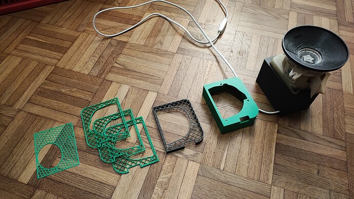

I am in the process of building a small grain mill for my wife to take with us on holidays. I am using the coffe grinder of my broken down coffee machine.
Prototypes in PLA:
MK4S overhangs anybody? :sweat_smile: Needs a bit of tuning though
Wooden version:
I am pretty excited about it. :sweat_smile:

Cutting those 5mm, flimsy wood things at 3000mm/min and 4.5mm DOC with a 6mm 2-flute endmill. Would have taken me 4x as long with a 3.175
