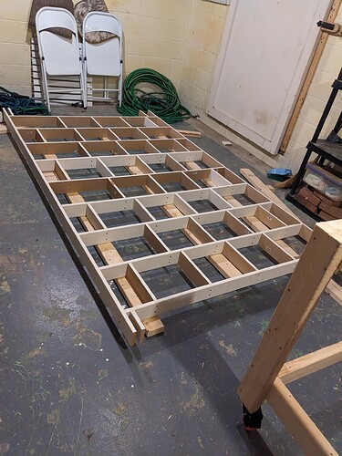

Anyways, super excited to join the community. I’ve had little exposure to CNCing and am excited to experiment with the LR4. Over the past week, I’ve 3d printed all the parts, built the bottom frame, and a MDF table top. The assembly of the LR4 components are super detailed and I’m very impressed with all of the engineering and thought that has gone into this. At this point, I have the the XZ assemblies together and a portion of the core. Waiting on the touch probe before I finish the core. As for the table, still have to glue the final MDF top and the guide rails for the XZ plates and then it’s finished. Hoping to start actually assembling the CNC on the table top on Sunday!
Regarding spoil boards, I was going to put a second MDF sheet on top of the table top. I don’t know if that is redundant, but I’m putting a good bit of effort into getting the table as flat as possible and assumed having to frequently (I guess frequently?) remove the table top, it may me with the squareness. I could be wrong, I’m a total noob here.
Apologize for the long winded post. I suppose I’m excited to have a project with a community. It’s been a dry and boring couple months.
Side note, I do not enjoy working with MDF as a material for construction. I had a handful of issues with my MDF boards splitting, but the wood glue+screws should still be good enough. Yes, I did pilot holes. Must be a skill issue on my part.

Using the MDF trim for a torsion box is clever!! Looking great so far!
I wish it felt clever! lol. I had a horrible time with the MDF trim splitting. Someone recommended using brad nails - wish I would have thought of that earlier! I’ll be using brad nails to attach the top (and glue).
