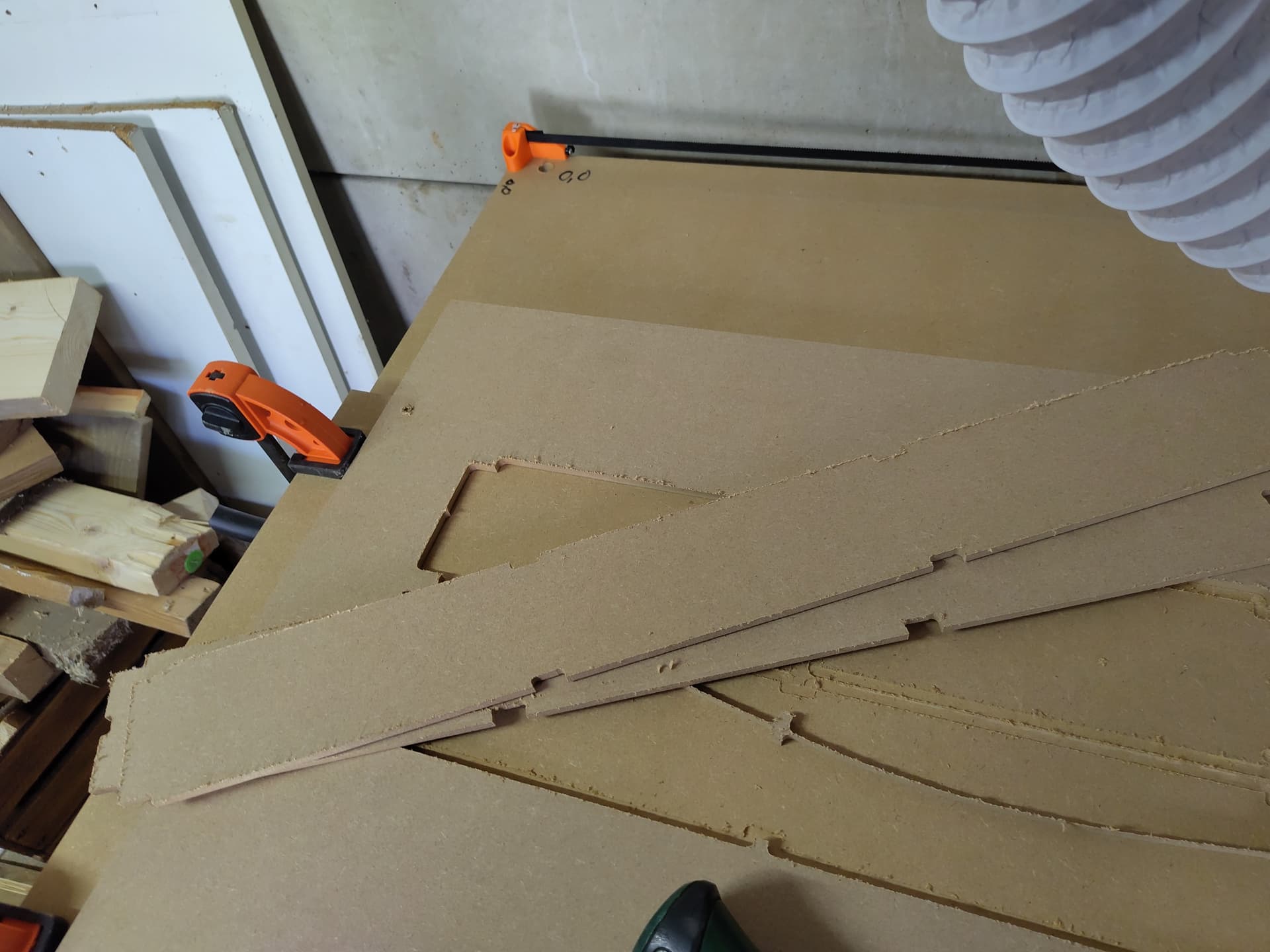

Okay, and now I need some help. Let me update you. Yesterday my jackpot board finally arrived. So I wired it in this morning, did the initial squaring, and then cut out my permanent strut plates once I was confident everything seemed fine.
Then I installed those strut plates, which turned out to be a really complicated task for me that required dissasembling the entire gantry - I got worried the board would get damaged as I dealt with all this, so I unplugged all the cables from it and put it safely aside.

In the meantime, here’s a shot from.yesterday after cutting the struts.
I have a nice big slab of MDF set aside for a spoilboard, so once I have resquared and checked the tram I’ll install that, flatten it and then the build is finished.

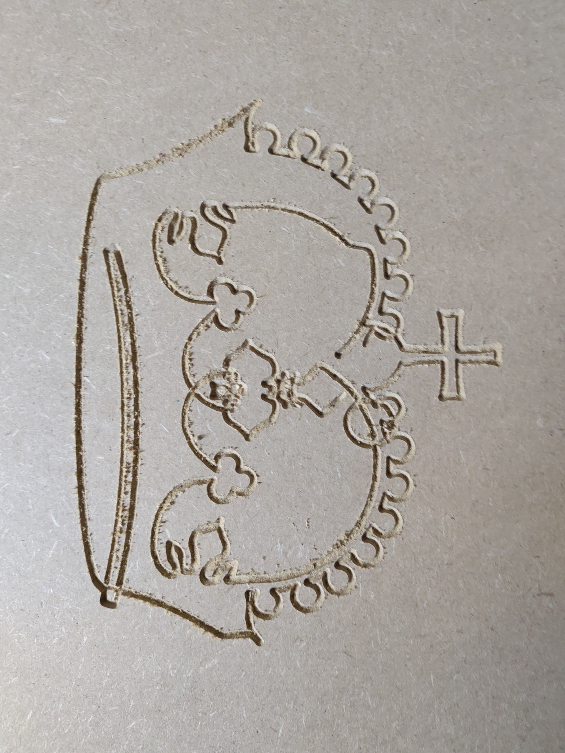

Okay, spoilboard went mostly fine, but when I was cutting the holes for the threaded inserts, at one point it seemed to skip to the left, and instead of cutting the existing holes deeper it started cutting new ones beside them.
I thought this was probably an issue in my gcode, until I did my crown test. Twice. Both times the different components were not offset correctly from each other.
In both situations its on the X axis that things are misaligned.
When manually moving on the X axis there is a rattly feel as it goes over the braces: my best guess right now is that although it LOOKS like it moves perfectly smooth between positions and in fact does so perfectly accurately at jogging and cutting speeds, during rapid moves that bit of extra resistance sometimes cause it to skip steps on the X travel leading to the next plunge not being in the right place. This stiffness only started after I installed the permanent struts.
I guess something needs adjustment, though all the tension points are pretty loose (per the assembly guide) I think. Any suggestions?

I think I know the root cause. I did just manage to create a perfect crown but only after dropping the Max speeds to just 500mm/min in both X and Y.
But afterwards I noticed that the bottom rail is touching the plates, which it should not. And I know why.
I ordered a 1/8" collet from Ryan because I could not find one anywhere in Europe. But that hasn’t arrived yet. I also bought a number of new 6mm bits to be my primary work horses since I can’t use my tiny bit collection yet.
But my set of smaller endmills hasn’t arrived yet.
So I cut my permanent strut plates with my 6mm endmill, at the time the only useable bit I had. This had two problems: the gaps for the brackets were very tight because they were cut with two wide a radius: and it didn’t cut screw holes because they were smaller than the bit. So I drilled those manually
And I think this is the root of all my problems. I think those holes were drilled just a bit too close together, pushing the rails onto the plates, with all the issues the manual predicts that would cause.
That also gives me a way forward. If one I don’t like at all.
Once either my collet or my other bit set finally arrives, I need to cut new strut plates using a more suitable bit, with this 500mm/min limit so it can actually cut them, and replace these strut plates.
Its a big job to fix, but I think it will resolve the underlying issue.
