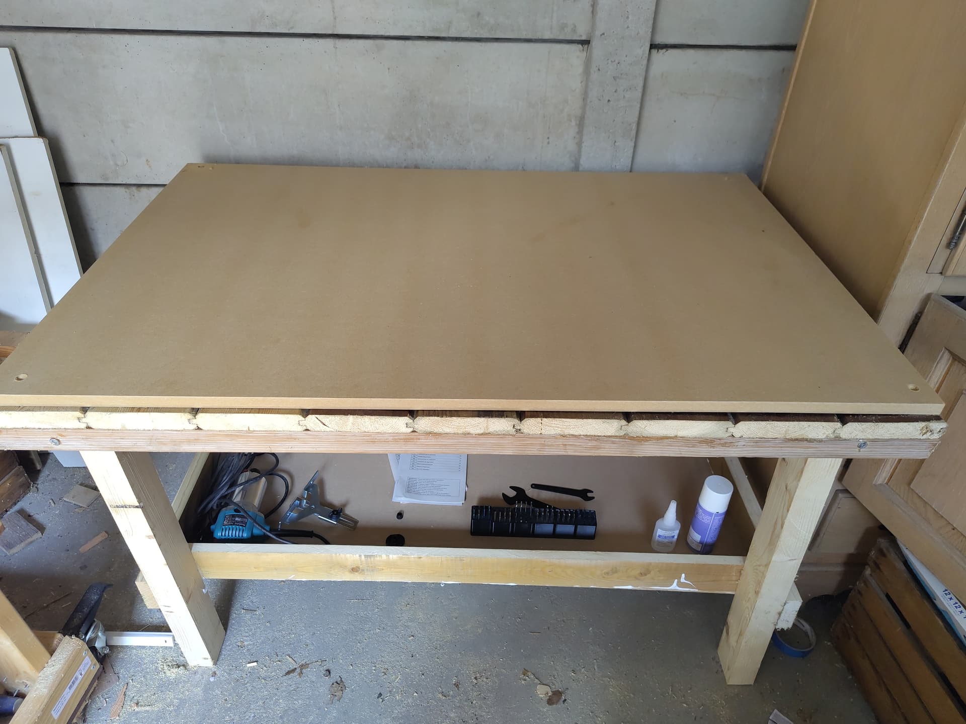

So first update - the tool holder and dust shoe prints are completed. I also received the MDF boards I ordered, And I requested the offcuts be included.
As I said before, one slab of 18mm MDF forms a second table top, this one cut exactly to the measurements from the calculator.
I also ordered 6mm MDF to cut strut plates, and the offcuts from that I attached below the leg stabilisers to make a handy storage shelf for all the CnC accessories.
Ultimately I intend to fill that entirely with gridfinity baseplates to organise all the CnC small parts, but also all the other sundry small parts from the workshop that don’t fit well on a wall or rack. One thing small Dutch houses have taught me is to use space efficiently so recovering the space under the CNC for storage is very useful.

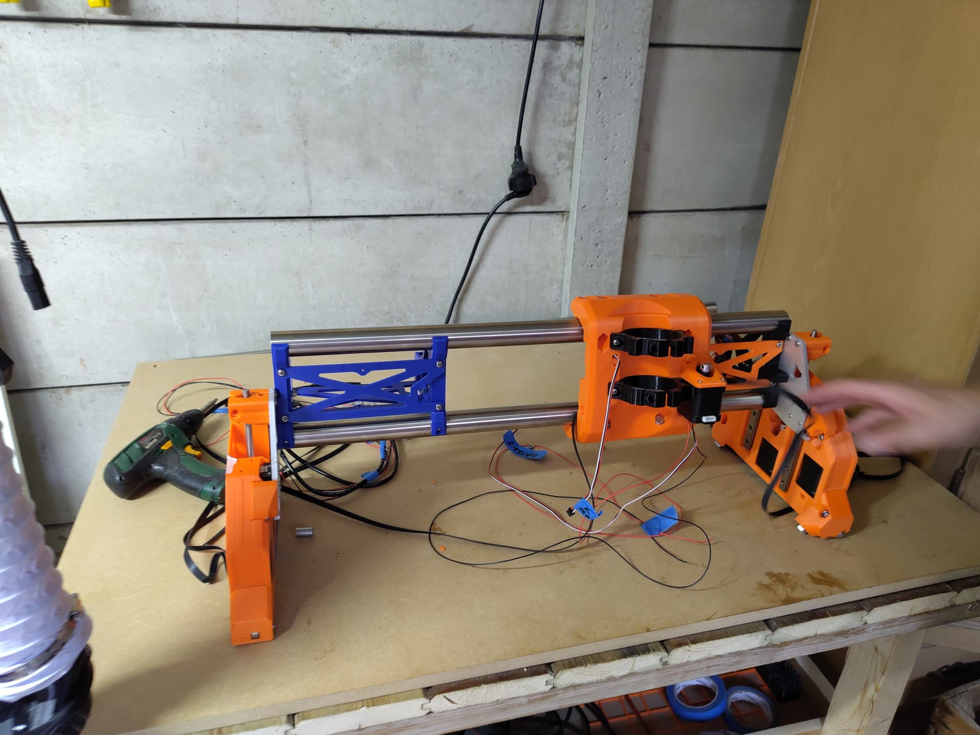

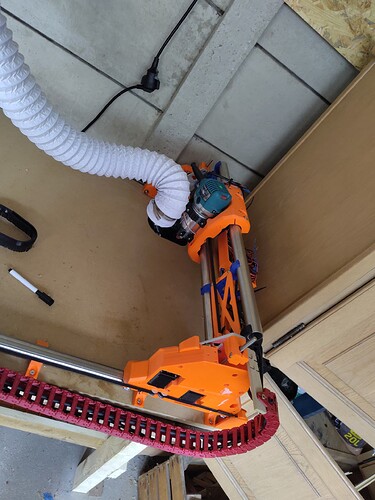

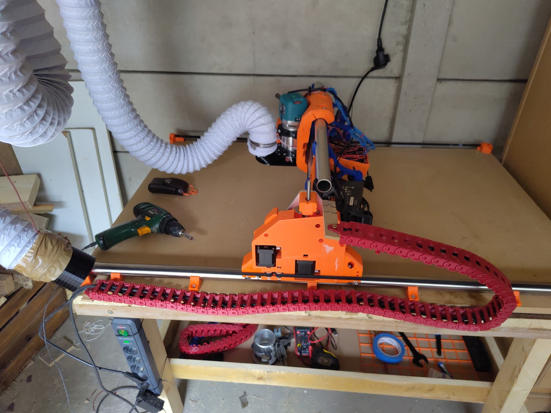

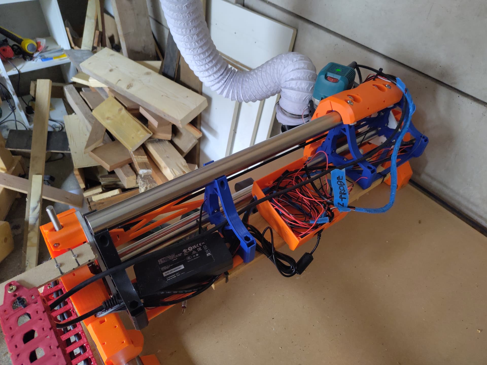

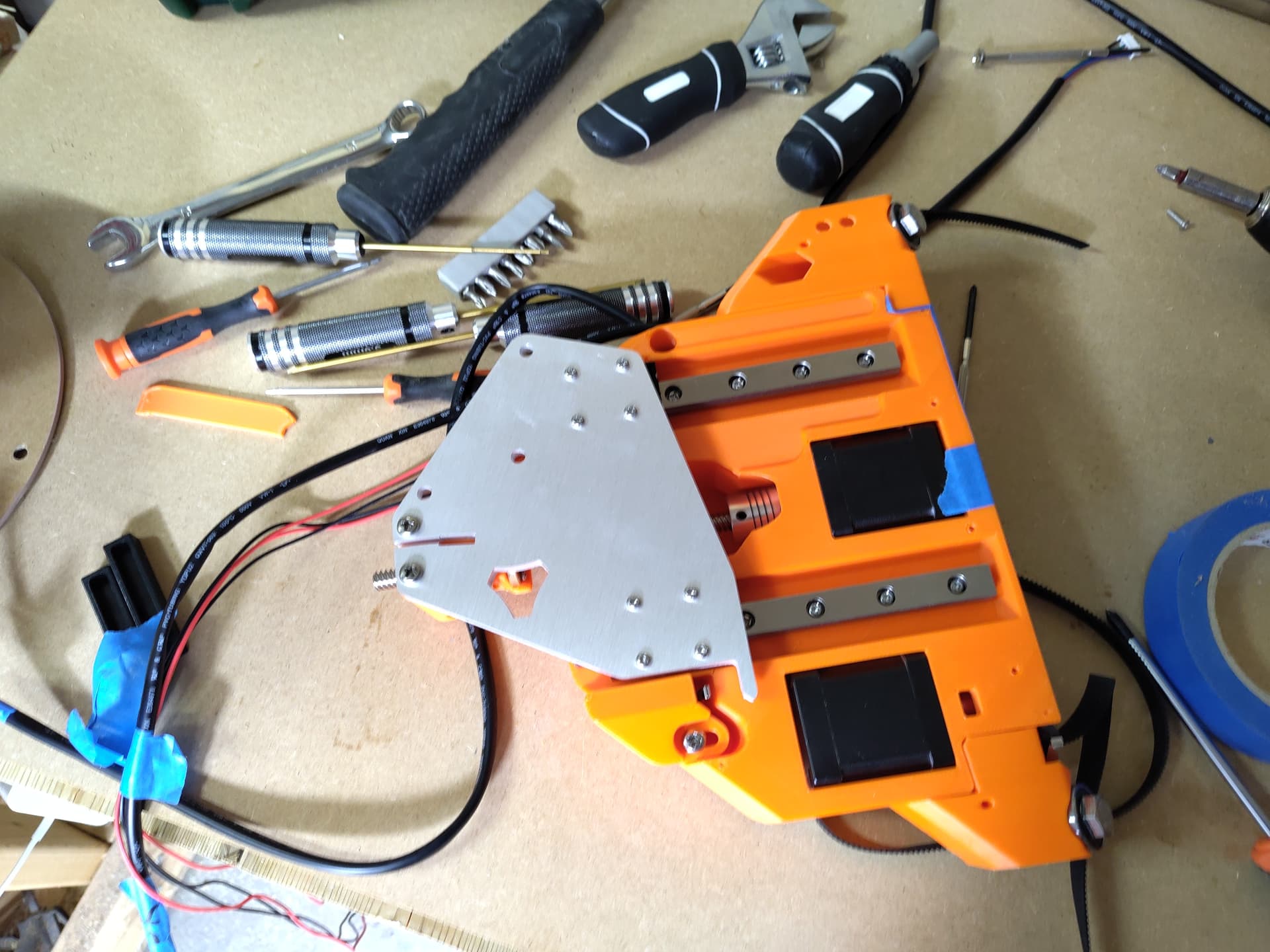

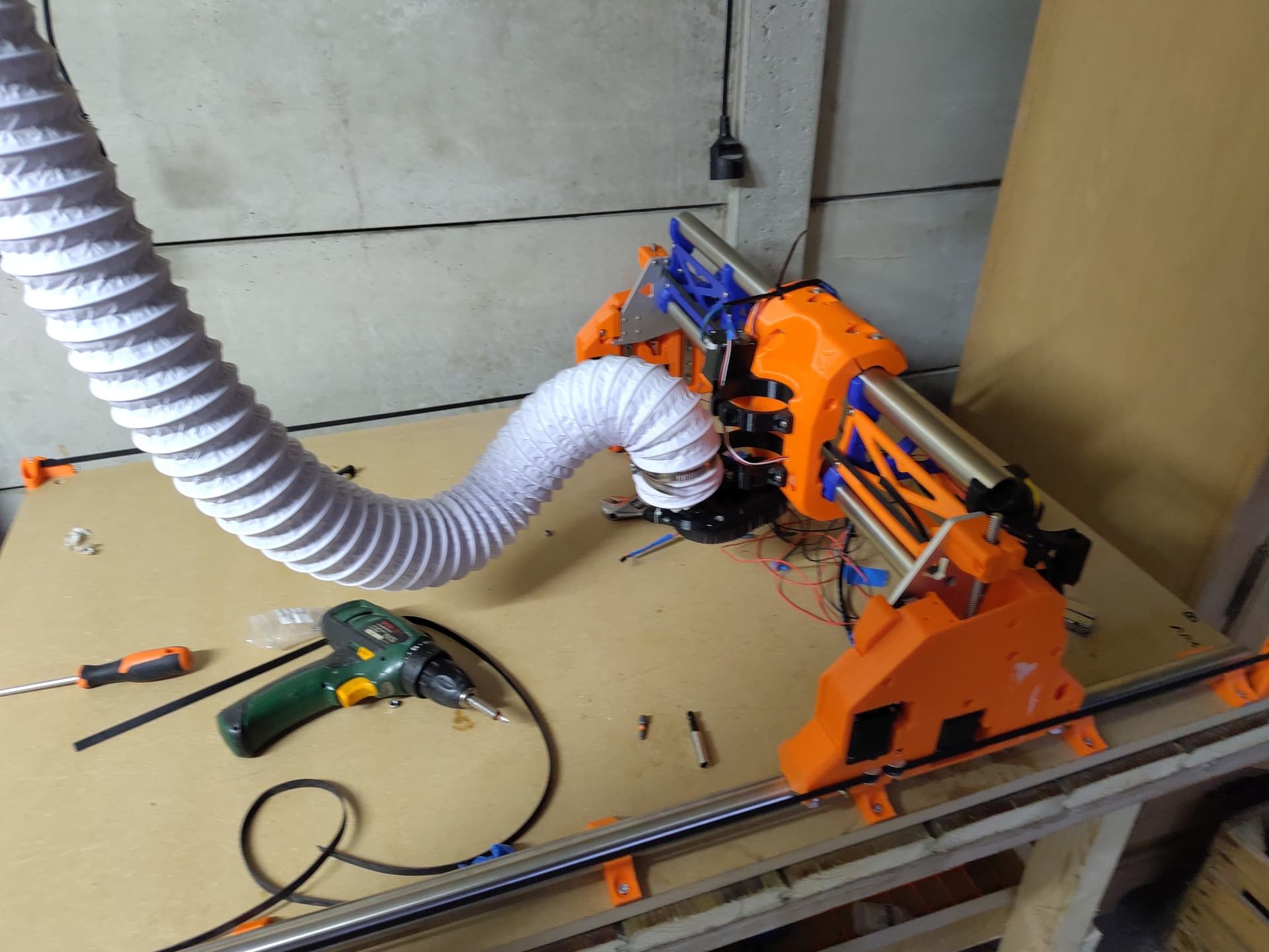

Right - latest update: I’m busy printing all the printed parts. I’ve finished the three large ones (core, yz-min and yz-max) and am currently printing the brace_30_max. I expect to finish prints in the next day or two.

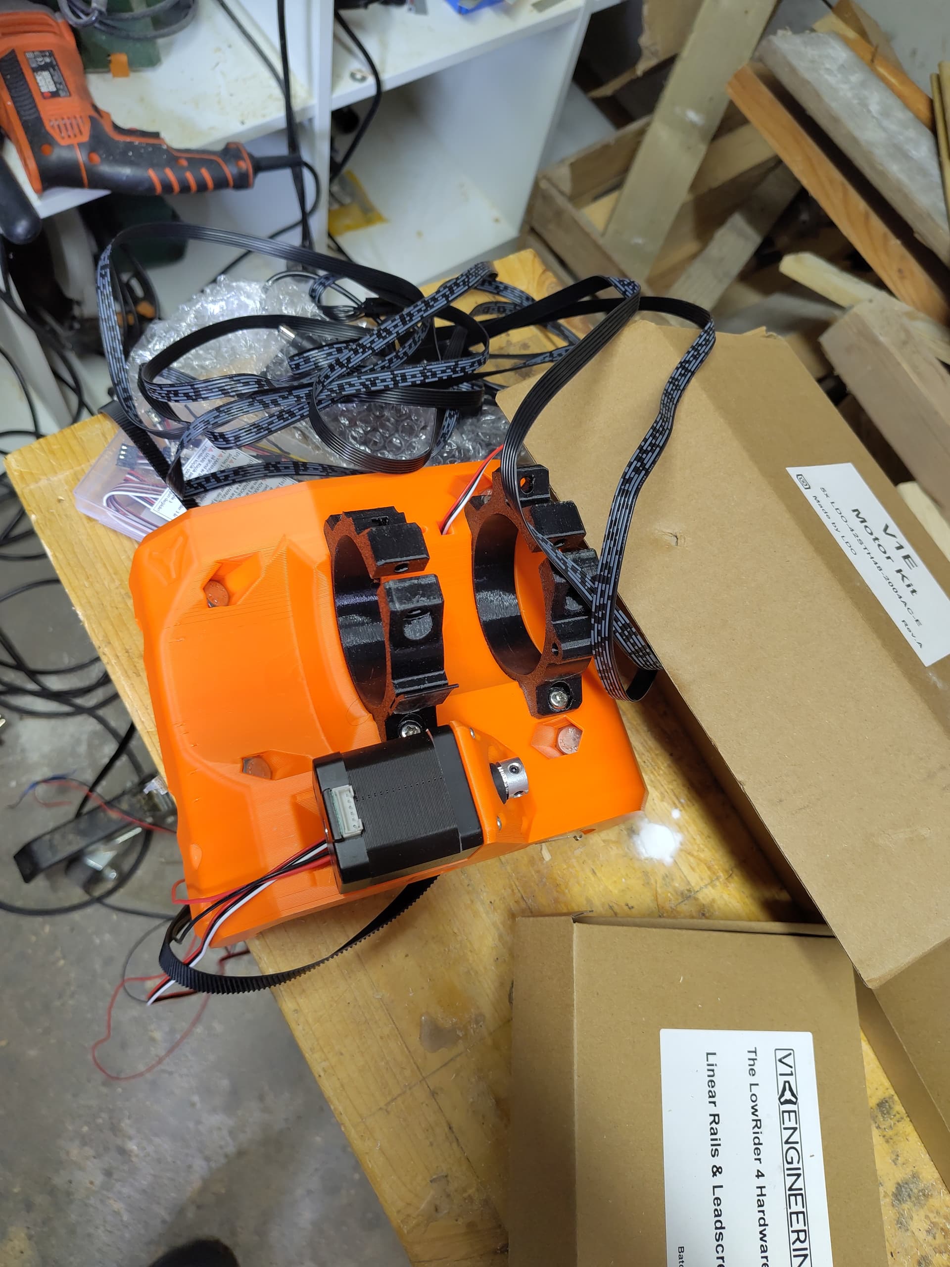

UPS has informed me that my hardware kit is out for delivery so should arrive here in the next few hours.
Unfortunately it seems my jackpot board will take longer, and probably not get here this week. Regardless this weekend I’ll be doing assembly - if the board is here I’ll try complete it, otherwise I’ll do everything short of plugging it in, and complete the rest when it arrives (particularly cutting and replacing the strut plates).
