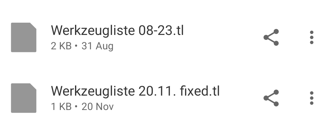

The tool list should have the ending tl.
Yes they do have a .tl extension. But when I use “Tools>Open” menu option and find the mytoolsv11.tl file seems to do nothing but blow away what is already there yet import nothing. I had 3 “New tool” tools in v12 before Open (I just had clicked add a couple times) and only 1 tool in my tool list after Open. Nothing new in the dropdown of lists either. Just “default”. It looks like it blew it all away.
Tools>import only accepts “CSV Lists” in the dropdown for type so you can’;t even try to import a .ti file. I think this is unique to v12.
The .dat files was an attempt to work around the above limitations and sync the files where the data is stored internally by the application. (Link to v1 forum thread in my original post). That doesn’t seem to work either. Even when I changed to (what I believe are) the correct names… Yes I restarted the application after changing the .dat files with no resulting effect.
