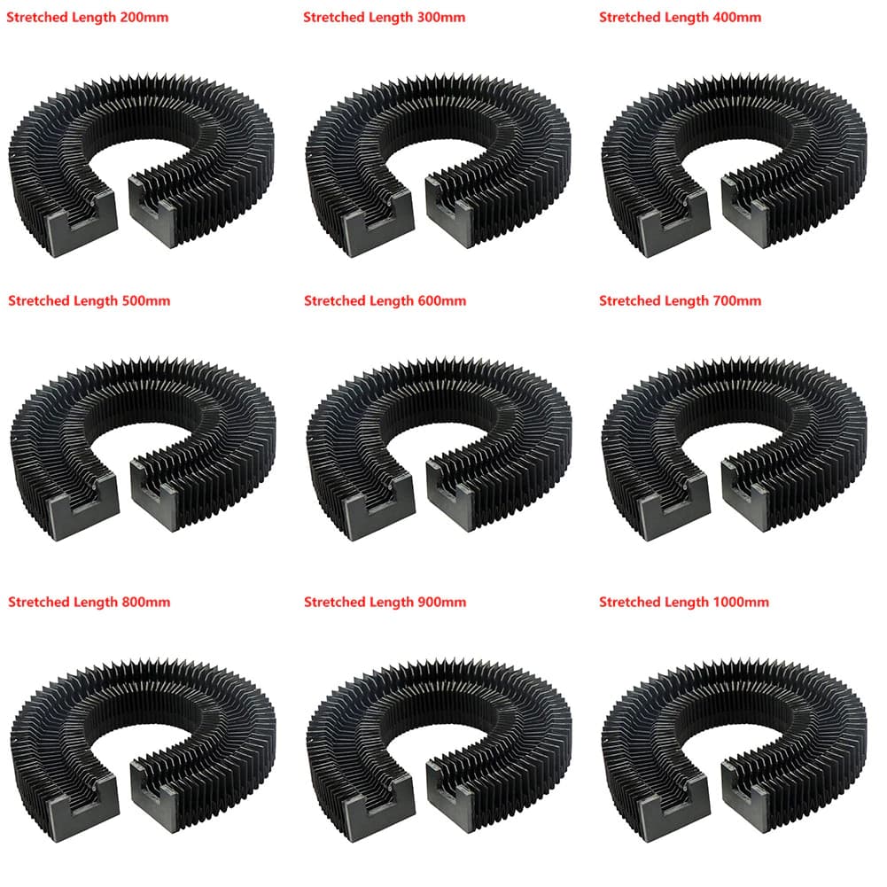

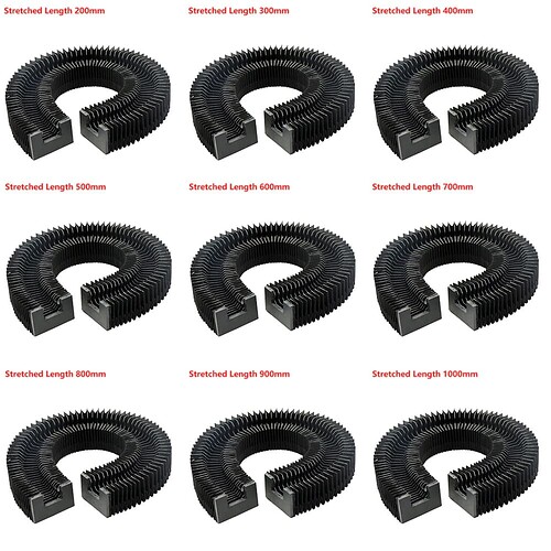

Got some random ads for linear rail bellows (to protect from dust and such). Could these be a thing for the LR?
