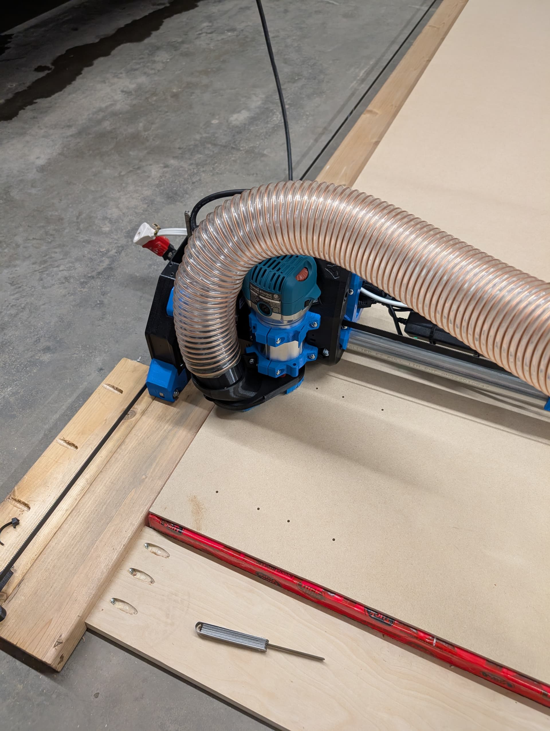

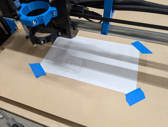

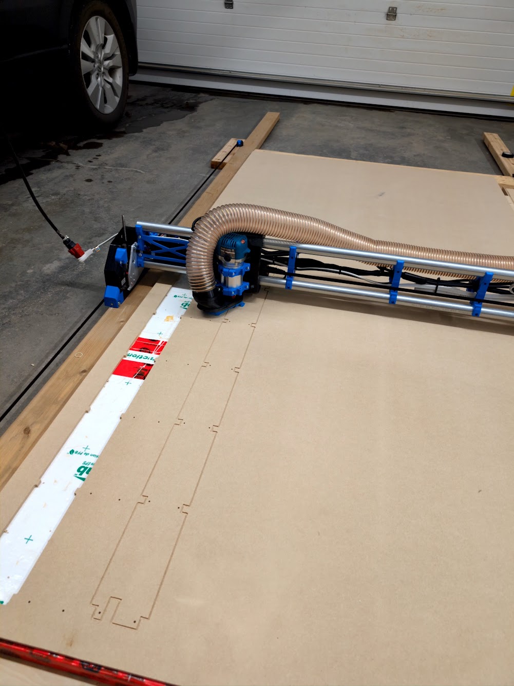

Ok quick update. Well we got a bit of winter show up which definitely slowed me down the last few days, but i did learn a bit about estlcam and got my LR4 to draw me a picture.

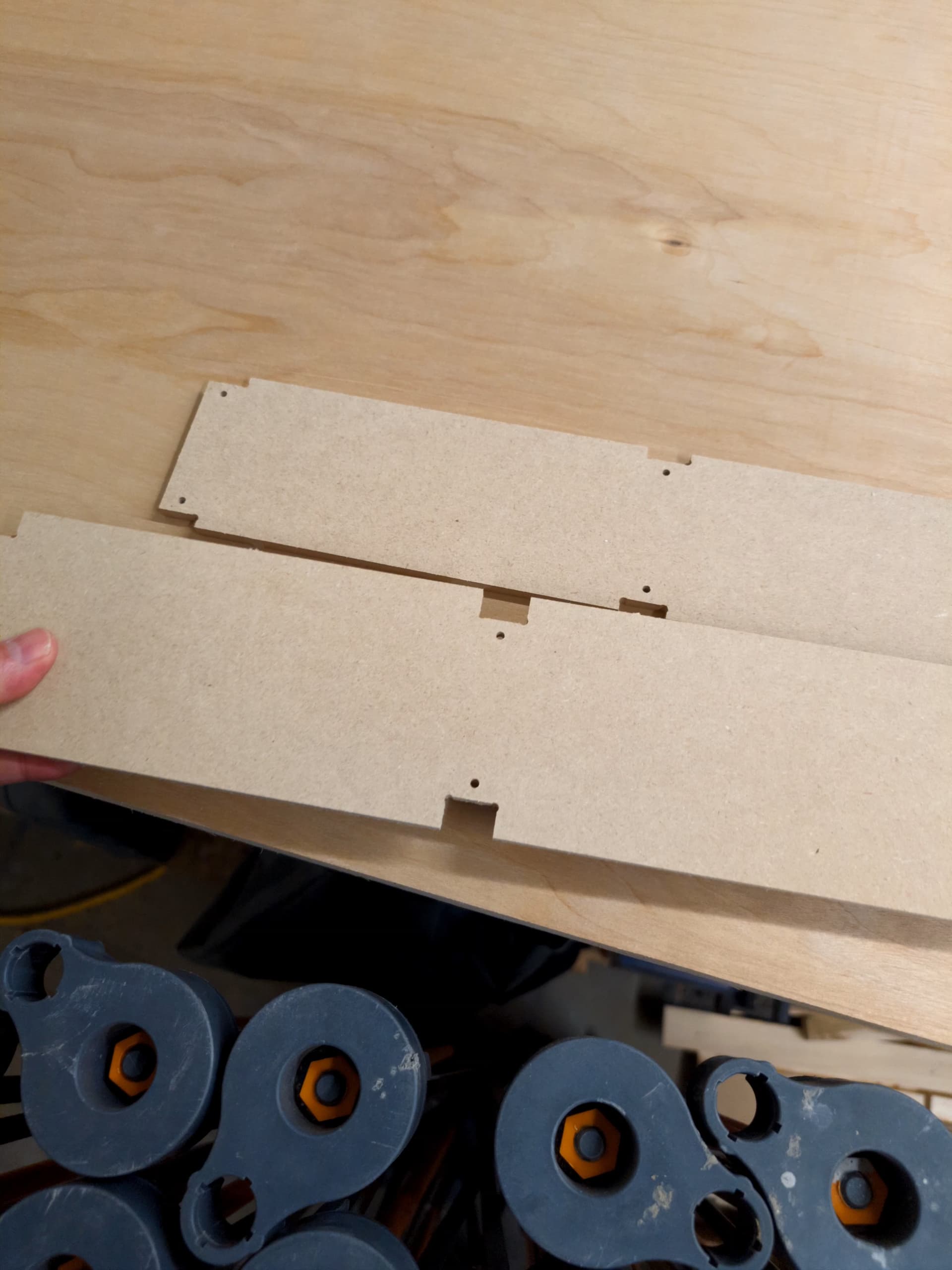

I then went on a several hour read and youtube video watch to learn how to use estlcam a bit better to do cutting and started the struts. The biggest thing i learned, my garage floor is definitely NOT as flat as i thought and I should have had the clearance set higher as my first attempt dragged the endmill when drilling holes on the second strut. I’m also wondering if things have shifted a bit since i originally put it down on the garage floor when it was +15C outside to now -10C outside…and oh so much snow). But we learn from our mistakes right?! :slight_smile: .
so then i recut just the front strut, setting up the cam file again. Ooof, this did not go well! Not sure what happened here but none of the hold downs came through in the print, the chip kept stopping the print and giving me warnings of low memory and with all that… it didn’t cut deep enough. So I will try again tomorrow (after more research!).
But she looks pretty!!
Also still need to learn how to set the depth of material too, i stupidly didn’t buy the touch plate originally but have it on order now too. But a good little project to start and learn with!
Also!!! All was not lost! When i came in from the shop, a little surprise showed up for me:
Looks like it might have been an issue with estlcam possibly as a new version was released that printed absolutely perfect last night. Couldnt be happier! So pumped I decided to attempt this. Will be on vacation for the next week so these will sit as is until I’m back. Then I begin the table build to get this off the floor.
I was thinking the garage floor was a pretty clever way to boot strap the process. Though the flatness problem is understandable. I think if a guy was in need of an emergency 4x8 on a budget the concept is sound. I think my version Would be 2 sheets of OSB, rails of something flat and straight. for the cut area maybe 1/2" (might have to go thicker depending on how flat the floor is) blue foam taped down to the OSB. with a facing bit you should be able to get it flat enough.
I don’t see it lasting long but it should be enough for the table build

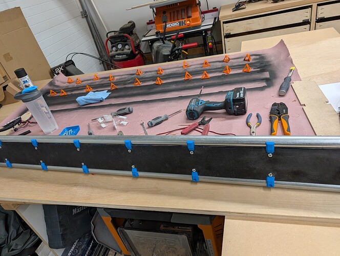

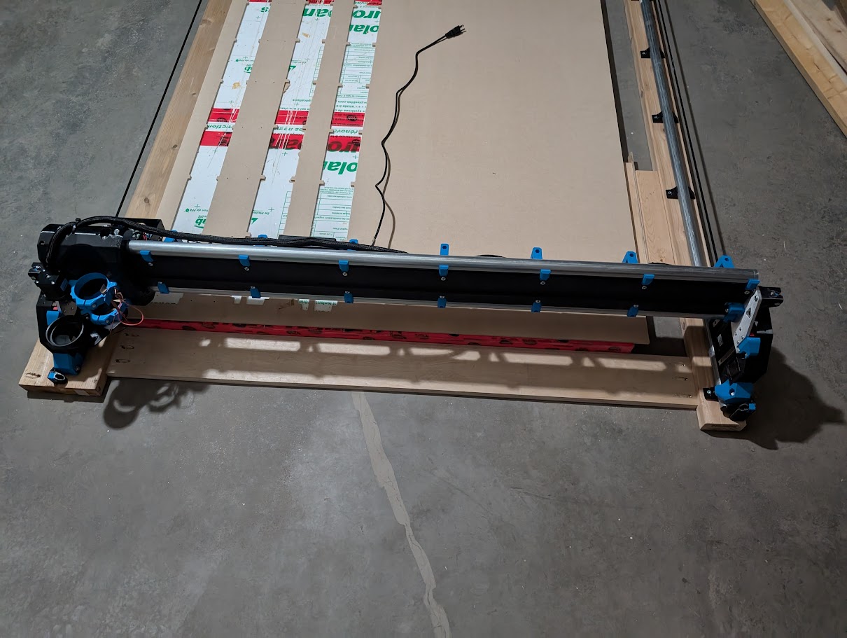

But I’m finally back at looking at my LR4. Last we left off i got the strut plates cut. So I got those lightly sanded and painted. Gantry completely stripped down, rebuilt with new struts, completely re-wired to allow for some future modding and the core now has a touchplate.
Its now re-installed onto my garage floor, and running again. I seriously need to get the table together and get my parking spot in the garage back. I’m tired of scraping frost off my windshield every morning!

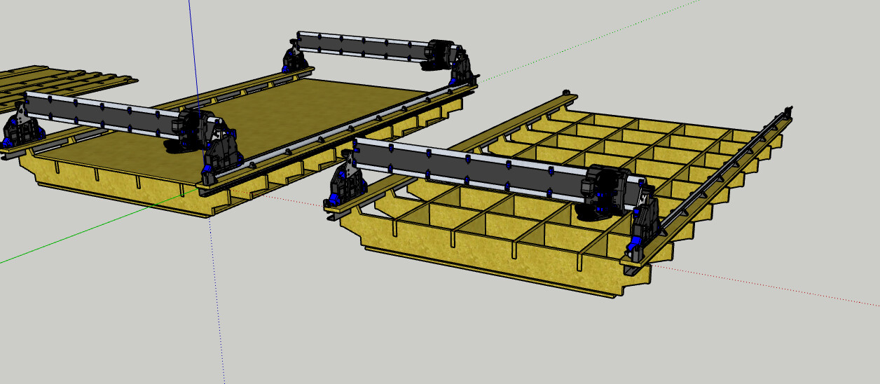

Current draft rendering plans for drop table (thanks Doug for some great ideas along the way)
Open for any feedback anyone has to offer. I think its overkill right now and might take it down to 3 Y-rails and drop 2 or 3 of the X-rails.

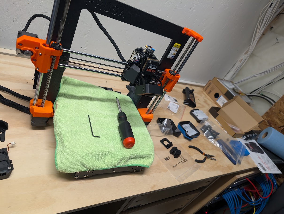

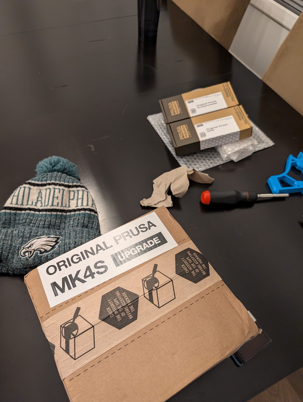

And for the fanboys, while I was sick, I got this upgrade completed! And will likely get the MMU3 reinstalled over the Christmas break too. NOTE: MK4S upgrade LCD kit is NOT compatible with the prusa enclousre. Working on solutions there to find or design a drop plate to allow the doors to close.

Phillip am i miss understanding the concept of drop? i have almost a 2" drop from the spoil board to the top of the Y rails?
Was planning to put final touches to the drafting today and start the cutting tomorrow. If i have completely missed the mark please let me know!
A drop table is usually a table where you can lower the spoilboard, the other option is to stack several boards and then remove them if you need the height. Yours looks like the second kind? This might not be too accurate though if you don’t plane the lowest level before stacking the boards.
The way it is now the collet is not going to reach the spoilboard if it’s on the lowest level, so cutting with 3.175mm endmills is not really possible (if you want cut something through that is).
Was that understandable? I kind of feel I am not explaining myself well. :sweat_smile:
Very much! Thank you. Definitely was planned for the second option. Will play some more and delay my plans! Thanks Phillip.
That could work if you put one board at the lowest level, take a long endmill and plane it. Then stack the other boards, they should match the lowest board now and you can just take them off if needed. This option needs a lot of stacked boards though. For a full scale LowRider I don’t have a better idea regrettably. :frowning:
Or you can get very long endmills to reach the lowest board if you want to cut through (if you want to engrave a 4’’ piece of wood it would not matter), sacrificing rigidity then though.
It’s really a tough call.
The plan was to start with a couple sheets but you have definitely given me a great ah ha moment. I think I’ll change my plan for now and do something more straight forward then modify/build something new in the future.
I’d just leave the “riser” for now. You can always add strips of wood later to make it heigher. :slight_smile:

Anyway I upgraded to mk4s and found these mounts were the simplest to deal with lcd blocking the enclosure doors.
Thanks Travis. Ive got a mount now that drops it. I actually printed the exact ones you linked there first but couldn’t get the square nut into the part (tolerances are too tight or the designer has narrower nuts) and I didn’t feel like tinkering so ended up printing this one:
Haven’t installed it as I still have to take apart everything again to get the mmu3 back working with the upgrade. But it dry fits and seems to work and allow enough clearance for the doors to close.
Might just leave the LCD attached to the printer inside the enclosure since prusa connect has gotten so much better. Save some space in the inside office and not catch myself on the LCD case all the time.
I guess my nuts are narrow, they fit nicely.
I actually use Prusa Link for most prints - it works really seamlessly, but I find it easier to remove the USB stick occasionally to batch delete stuff. My LCD has been in the enclosure since the Mk3 but I rarely print with it at high temps (more than 40 degrees).
