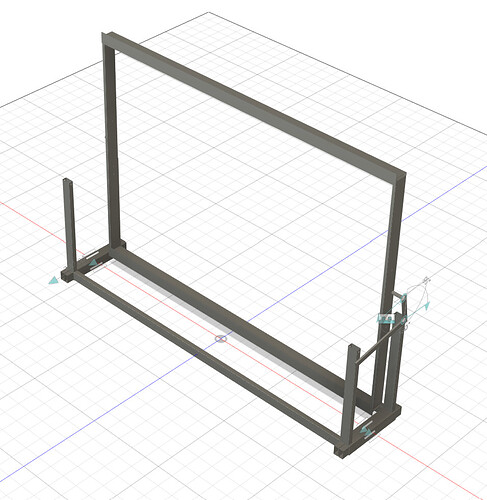

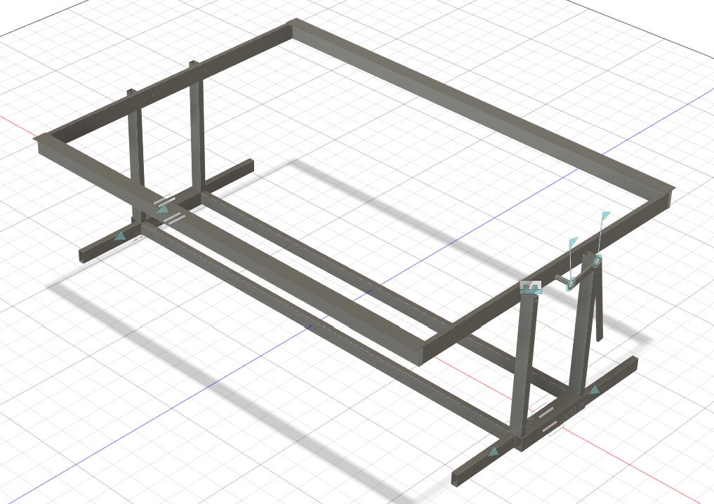

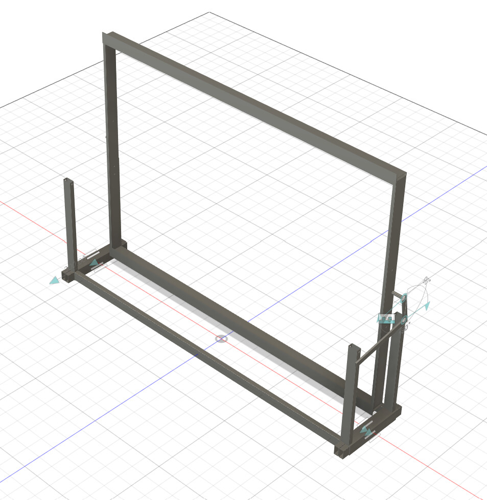

I’m planning on building this tipping design to save space in storage with the LR4 being removed/secured before tipping of course.
Design has cross braces - omitted for clarity.
I thought about a tipping design as well. My biggest concern was what to do with the machine when the table was tilted. Are you going to weld together metal?
The LR4 could be strapped to the rails to prevent falling or removed and stowed in the base.
The design shown is 2/3 sheet size - so a table size of approx 1500 x 2100mm.
In use it will occupy 1500 x 2250mm (x approx 1000mm high)
Stowed 500mm x 2250mm (x approx 1650 high).
Yes welded construction using 2 & 3mm wall rectangular tubing and sheet steel. Castors will also be added.
