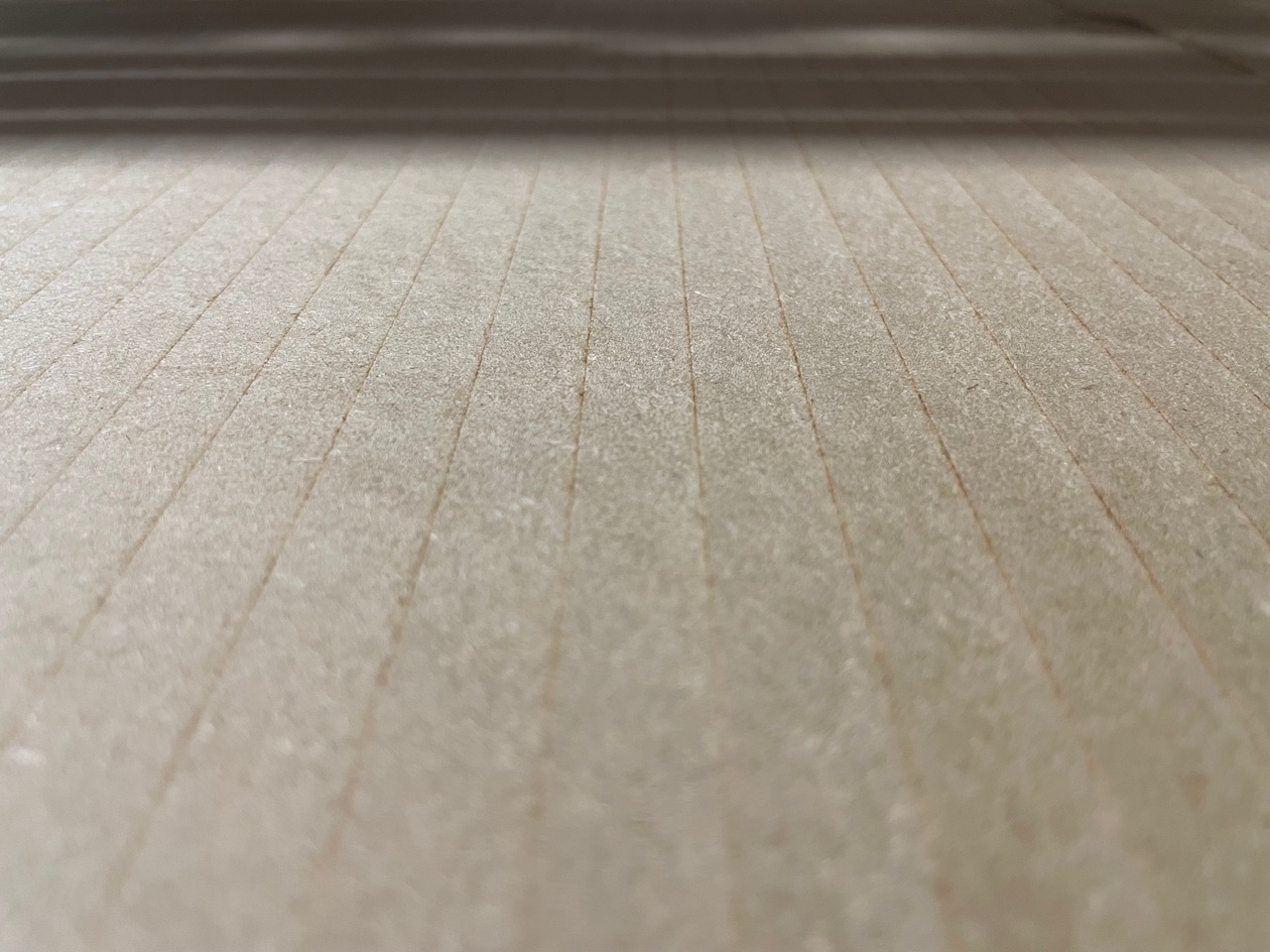

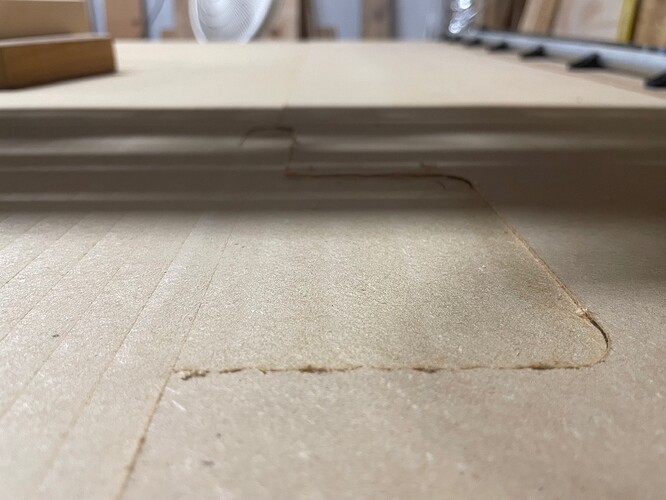

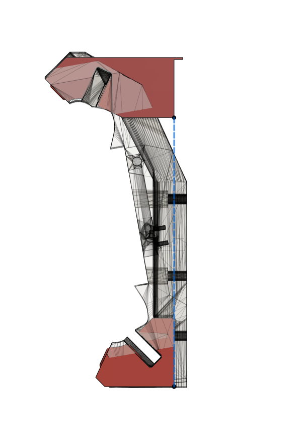

I had a very similar issue in the tramming department.
I tried adjusting all the nuts I could but could not get the lean out of my bit.

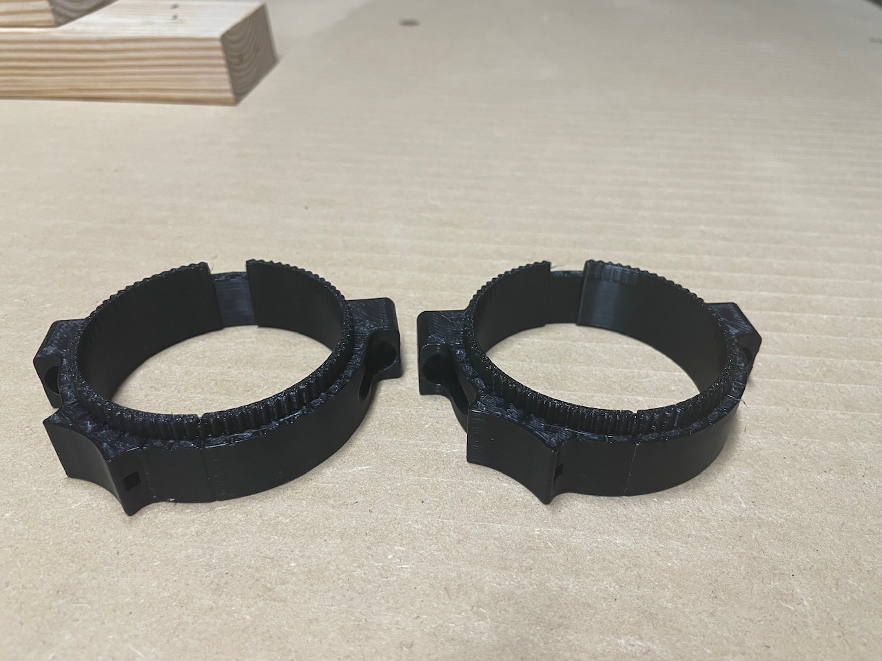

Since I was going to have to take the core and mount off anyway to try to see what was the issue, I went ahead and modeled me a version of the cam tool mount as discussed above.
I still need to make some CAD revisions to make it a little easier to deal with, but the idea is sound.

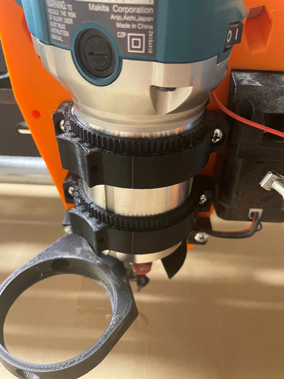

After installing the mounts
I was able to make the adjustment and get the tool perpendicular. Not sure if it comes through very well in the picture, but the spot I manually surfaced has no detectable ridge in it anymore
Brilliant !

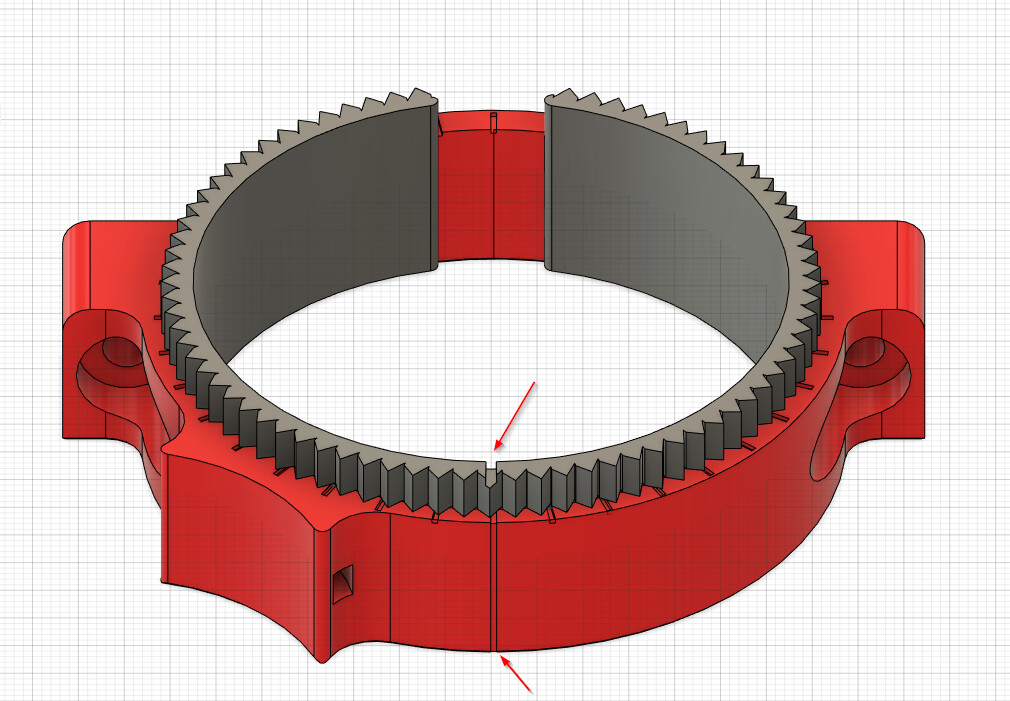

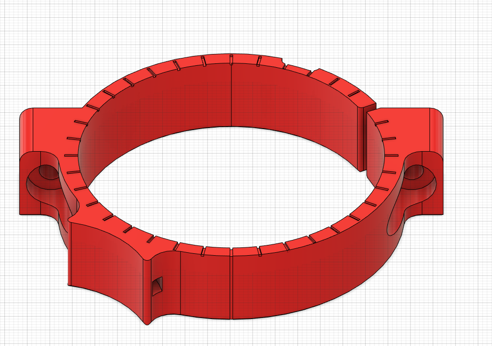

I wasn’t too fancy with a custom wrench or anything, but I made marks on the top at every 10º increment so precise adjustments can be made.
There’s also a notch in the Cam Ring and Mount. When those 2 notches line up, then the mount is in the exact same vertical position on center as the original mount.
The tool will remain completely vertical as long as both cam ring notches are at the exact same offset. Moving them in opposite directions 90º will give the max tilt.
The version I printed for mine has a max tilt of about 1º-1.5º, but the cams can be adjusted to have more tilt by up to 5-6º I believe, but at that point, you probably have bigger issues to worry about.
My versions fit a little too tight so it needs a little more clearance, and the CAD is a mess from all the different things I was doing, but if there is interest, I will publish the files after I redo it.

@Mike, that’s exactly how my original concept was envisaged - the notches @ 10° increments are brilliant - I have got as far as drawing little serrations in the top of the mount to match with the ring flange to ensure there’s no movement but hadn’t thought of that kind of mark.
Now that you’ve actually used it, do you think the serrations will make it a bit too hard to use?
I think once it’s clamped the chance of it moving is pretty small. There’s a lot of friction going.
Even with it unscrewed a bit it was difficult to move by hand.
The notches came about because I was looking at my design and couldn’t work out how I would ever tell how to get it where I want it.
Originally I was going to attempt to actually mark it with some numbers on how much of an adjustment it was, but by the time I got to the end I realized it wouldn’t work, and instead will likely make multiple cam rings with “degrees per notch” on each ring.

I was concerned about movement when removing the router, but of course that would require tramming again anyway. Out of curiosity, what is the thickness of the “thinnest” part of the cam ring?
I wonder if there’s a trade - off between accuracy and durability and overall mount thickness? I had my (unprinted) prototype down to 1.2mm (three perimeters @ .4, but thought it might be better to make it 1.5 so that Arachne would do it’s magic on the taper and it might give a slightly neater print.
I’m thinking now about repeatability for those who aren’t as finicky as some (I’m looking at you @Fabien :smiley: ) with print quality - a bump in the perimeter might just make it all fall in a heap!
I think a wrench that slips over your serrations would work marvellously - a small lever will give a little more control over the micro adjustment - but from what you have shown, maybe it’s not necessary after all.
It would, but I would think once you have it trammed, marking where the final cam ring slots are in relation to the mount ring slots I added would let you pretty easily get it back in the same relative spot, and only minor adjustments may be necessary.
The cam ring I’m using has a 0.5mm offset, so I believe the thick side is 2mm, and 1mm on the thin side. I also tested the extreme of a 3mm thick side tapering down to nothing. This gave the extreme of up to 6mm tilt adjustment.
Since the cam ring is just filler being squeezed for positioning, it doesn’t feel to me like it really matters. Just print them solid and there should be no give in it. The mount ring gets pretty tight, but it doesn’t take an excessive amount of force, so I don’t think cam ring compression is any more of a problem than it is with the regular mount.
I thought about doing it. That’s why I went with 80 teeth, so it would have a little more grab. If I have time I’ll try to make one to go with it. I also considered just putting some holes in the top to be able to grab on.
When it was tough to slide, I just grabbed a small flathead and tapped on the handle. Not much force and was able to get it to move without a problem.

I’m starting over right now blank from the Makita step file you published and will be careful to keep the CAD clean.
I’ll either include multiple cam rings, or keep it parametric so you can choose the offset.
When I’m done (hopefully tonight, maybe tomorrow(fingers crossed) ) and happy with it, I’ll publish the models and the Fusion 360 file.

In the end, I only made the 1 cam ring. This ring allows for up to 1-1.5º adjustment I believe. It kinda feels to me like if it’s more out of tram than that, you might have bigger issues to solve instead of hiding it behind this, but this it great for getting from “pretty close” to “nearly perfect”.
