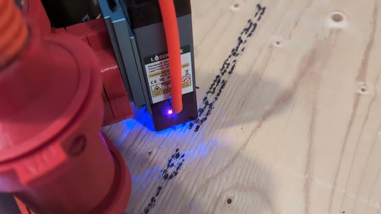

My issue is that controller (SKR Pro v1.2 Marlin) pauses the motion while it processes the M03 and M05 commands. I expected the machine to move through the full range of motion at a constant speed, with the laser turning on and off as it passed the edges.
Machine is a 10W Laser Tree laser module mounted to a Lowrider 3 with SKR Pro V1.2 controller (Marlin). The machine has a lot of mass to accelerate (doubles as a CNC Router), so I bumped up the Overscanning settings in Lightburn (LB) to 10%.
I’m doing a LB Material Test with Fill to test engraving settings on plywood. I’m using a matrix of 10-50% for Power, and 500-5000mm/min for speed.
After bumping up the Overscanning settings, I’m still getting burning on the edges of each line.
During a single line of motion, the machine will:
  • move to a distance away from the edge (overscan distance, varies with speed),
  • accelerate to full speed until it reaches the edge,
  • slow down or stop at the edge while it turns the laser on,
  • accelerate again and move to the far edge while the laser runs,
  • slow down/stop again at the far edge while it turns the laser off
  • accelerate and move to the overscan distance from the far edge.
The gcode looks ok:

Looking at the Marlin Docs, that behaviour may be normal in Standard Mode.
" In Standard Mode the M3/M4/M5 commands wait synchronize the planner (causing a momentary stop) before changing the power"
I’m not too familiar with Synchronous Mode in Marlin ( LASER_SYNCHRONOUS_M106_M107). Can I use the same Output Pin (PC9) that is currently defined for laser in my Marlin configuration, or do I need to configure one of the Fan outputs instead?

I did a bit of reading through the Marlin docs, and it seems that Inline Mode may be the answer. I set LB output to Inline (from M3/M5), and the laser no longer turns on, so I’m guessing that there are some changes that may need to be made in the Configuration.h and Configuration_adv.h files
Because you want to use Dynamic Inline Mode, which is enabled by M4.
Constant inline mode, M3, won’t adjust laser output power for actual speed vs. target speed.
Either is better than standard mode which, as you’ve quoted from the docs above (and witnessed), stops motion to turn the laser on and off.
Yes, thanks for pointing that out. I later found that in the Marlin Laser Configuration Guide (2.0.9) after I read your post.
What was confusing to me is how you would implement this in LB. It occurred to me that you might have to manually edit the Gcode and replace M03 with M04? Which led me to …
So it turns out that LB Inline mode doesn’t use any M03 I (or M04 I) commands in its gcode output. It puts an Xnnn Ynnn I Snnn string as part of any G0/G1/G2/G3 commands, but it never actually turns the laser on or sets it to Inline Mode.
I added an M03 I start code (and an M05 I end code), and now the laser turns on and off when it is supposed to (more or less - there’s still something odd going on where it seems to turn off briefly mid-pass).
