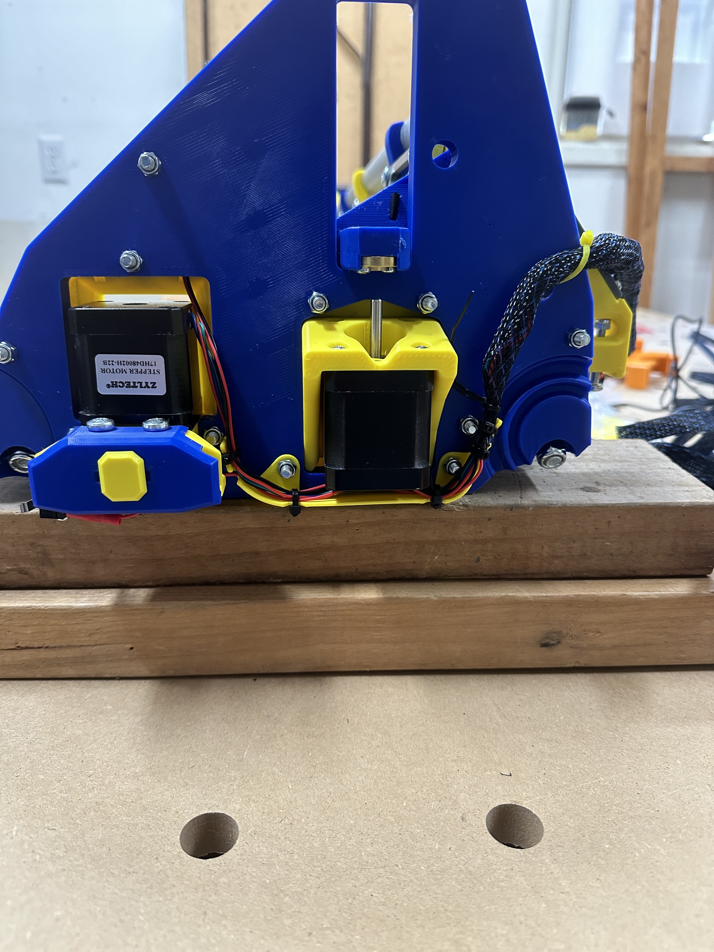

Today was a productive day. After letting the heaters run for a couple of hours the temp in the garage got up to bearable and I started working on my wiring.
Only one trip to the hardware store for shorter zip ties. @bitingmidge cable tidys work fabulously. I put that look stuff around bunches of wires. Everything looks neat now. So I finished up the Z screws.
Fired up the Jackpot and was greeted with all the stop lights! There’s @DougJoseph cable minder in action.
Then tested that the steppers fired. Only had one of the Z drivers reversed. So that was all easy-peasy.
So I guess it’s ready to go. Just need to affix the pipe and belts and give it a try. Oh and there are some @azab2c hose hangers too. I can’t recall where I found the stop blocks for the Z screws. I suspect they should be connected with a string and a ‘Remove Before Flight’ tag. :wink:
I’m thinking I might temporarily use these two boards to mount the pipe and belts and try a crown while I contemplate what my table will actually be.
Clamped to this Bora table that should be stable enough for a pen test, don’t ya think?

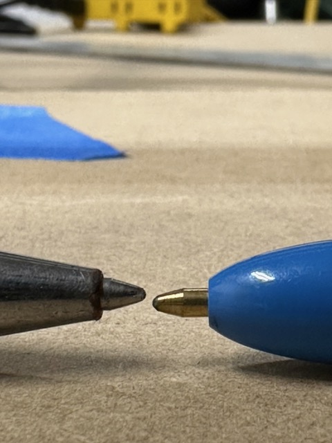

There are two because I ran it twice. I had to switch pens mid first pass - ran out of ink - and the pens as you can see in the second picture sit different distances from the mount. The end of the second attempt overwrote the end of the first exactly so good for that.
