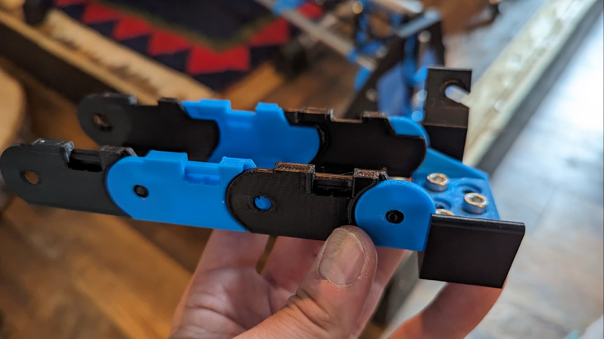

This cable chain is gonna be sweet.
Hmm…I considered alternating colors but I don’t have enough of my other colors left…
Now I need to think long and hard about whether I need to order more…
I’m only 18 links in…so there’s still time :slight_smile:

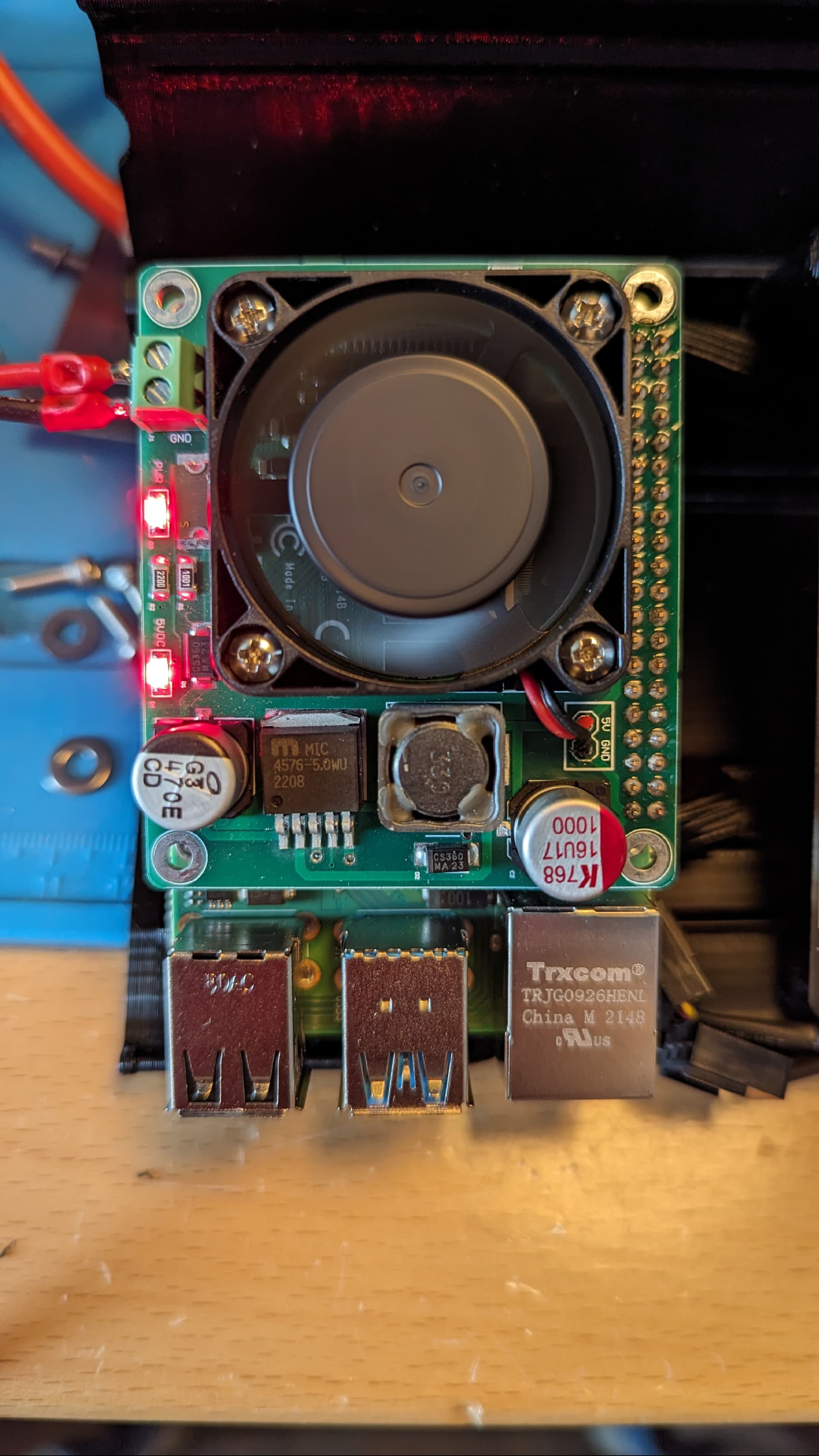

A power and fan Pi HAT came today. I got the connector for the GPIO pins soldered on, and powered up the Pi with my bench top PSU at 12V. After a minute to boot, logging in to V1Pi (previously configured) went without a hitch. Perfect!

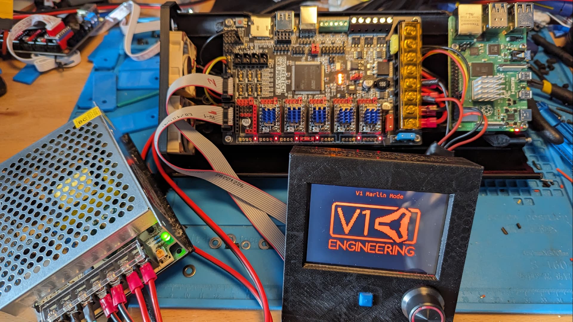

It’s alive… I think?

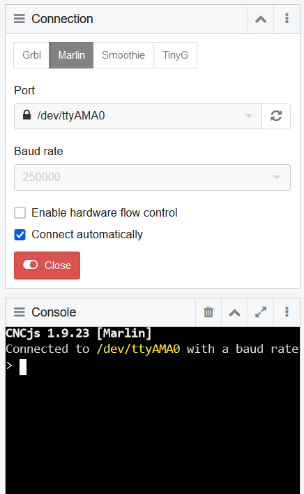

I want the option to possibly use the touch function of the TFT 35 at some point (unless I go totally headless), so I wired the Pi’s UART to UART 3 on the SKR. Because of the HAT, I soldered the wires to the appropriate GPIO pins (6, 8, and 10). There are UART pins on the board, near the bottom right; Rx to Tx and vice versa, and a ground connection. (I do not want to connect the boards via USB.)
Configuration changes I made on the Pi:
  • I SSHed in and wrote dtoverlay=disable-bt to the end of /boot/config.txt.
  • Running sudo raspi-config, I changed the serial settings to turn off console via serial, and to turn on the serial hardware (option 3, option 6, no, yes, finish) and then rebooted.
After the reboot, I opened CNCjs and used port /dev/ttyAMA0 with a baud rate of 250000 and it seems as though I might be connected to the SKR. I’m not sure how to test this, though. Nothing I enter into the Console window in CNCjs seems to do anything, so it’s possible I’m not connected after all?
Nothing is wired to the SKR yet (motors or endstops), as this is a preliminary bench test. If anyone has done this before and has suggestions, I’m all ears. Meanwhile, the Googling continues…

For the time being, I have changed which UART the Pi uses on the SKR because I can’t get it to communicate on UART 3. I strongly suspect this is a firmware setting, but I’ve got other fish to fry right now. I connected the Pi to the TFT touchscreen UART and was able to get CNCjs to make a stepper motor (left over from another project) spin on the bench! I’m ok not having touchscreen capability for the time being; the more reading I do, the safer Marlin mode & CNCjs seem, in terms of sending good signals for machine control.

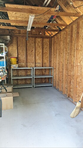

The shed is almost clear (pics soon); once it is, I can get the bootstrapping setup put together, put the gantry on its rail, and have it make its own motor noises. Woohoo!

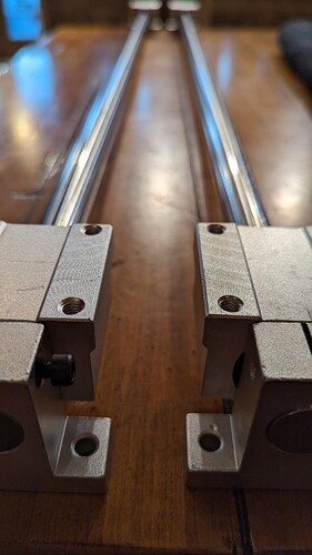

(Also, those linear rails are not for the LowRider itself, but ARE related… :wink: )

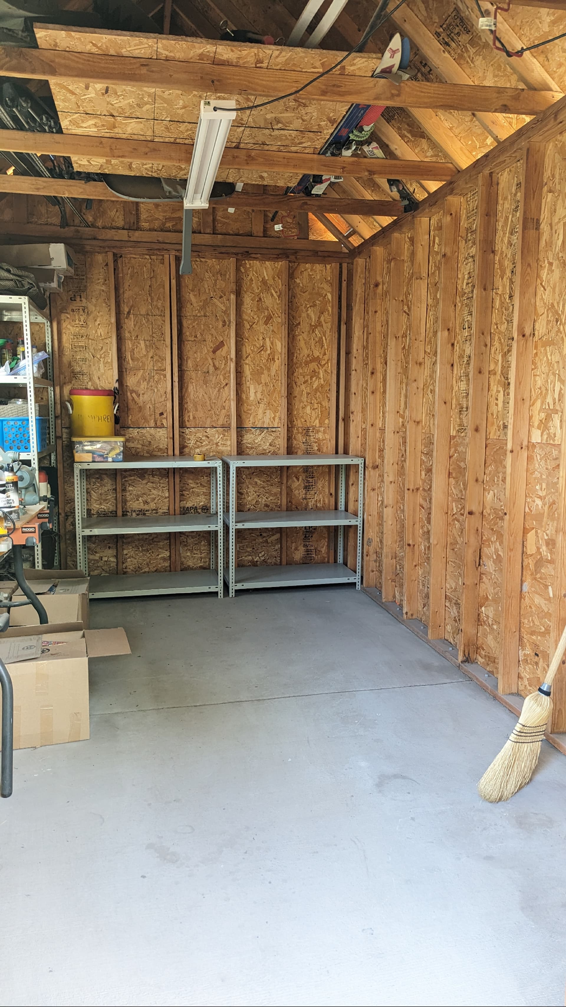

The shed, soon to be home to all the blood, sweat, and tears…
Oh what I wouldn’t give for a clean, open spot in my garage…
Lol. I hear that, but apparently “what I wouldn’t give” is the time to clean it up and paying the junk haulers to remove the crapstuff that is occupying the space

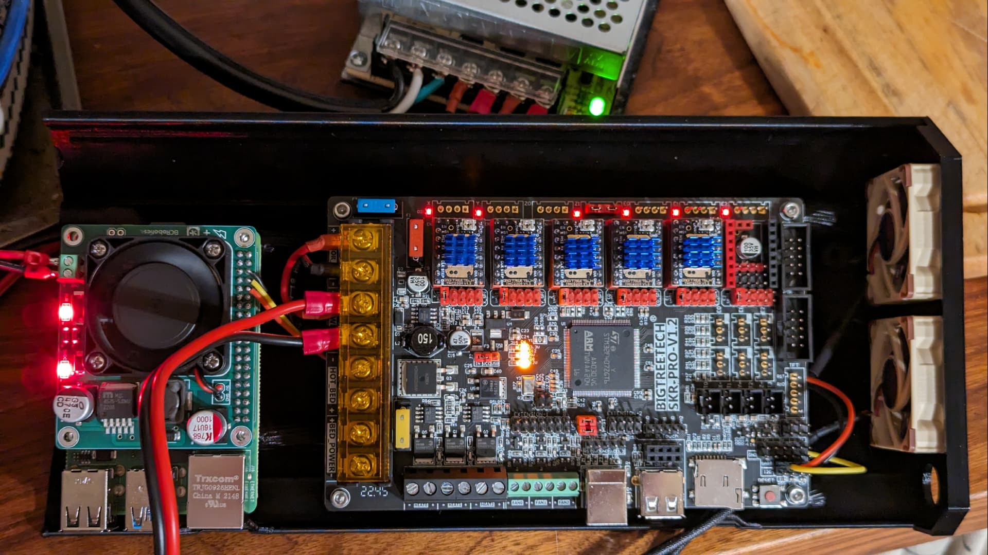

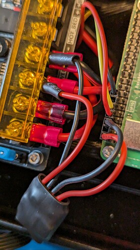

I was rewiring the control box so that the power wires exited through one of the outboard holes. In the process of doing so, I pulled a really rookie move and reversed the 12V lines going into the Pi HAT. Power on… Pi HAT dead.
Fortunately, the Pi was perfectly fine. For a little while, I was tempted to throw my hands up and just power the Pi with it’s USB power adapter… but then hobbybrain kicked back in and said “nah.” The search was on for a solution.
A Google search revealed that the Pi can be powered via GPIO pins 2 (5V) and 6 (GND). How to get 5V power to that pin? Turns out I had a spare BEC from a failed experiment on one of my drones that steps 6-60V down to 5, 9, or 12. Bingo! Some careful soldering, lots of Dupont connector crimping, and plenty of incremental testing later, and my solution was proven.
I also installed some 12V 40mm Noctua fans in the case. Their wires juuuuust barely reach to the terminals on the SKR, so their spade connectors share the motor power terminals with one of the power lines running to the switching power supply. The BEC shares the board power terminals with the other power supply line. I also made longer UART cables to connect the Pi with the board.
It’s alive! And all the things talk to each other, too!
