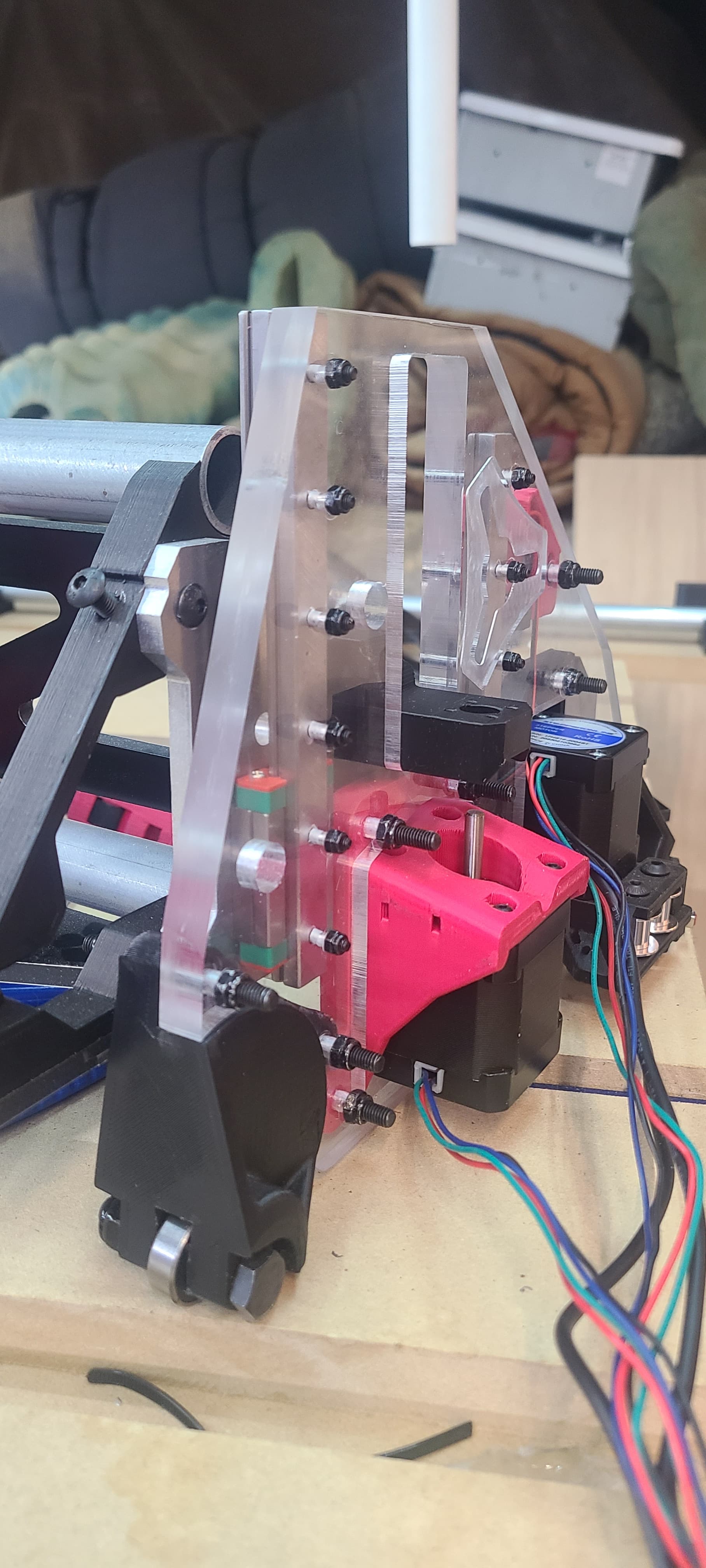

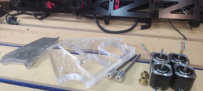

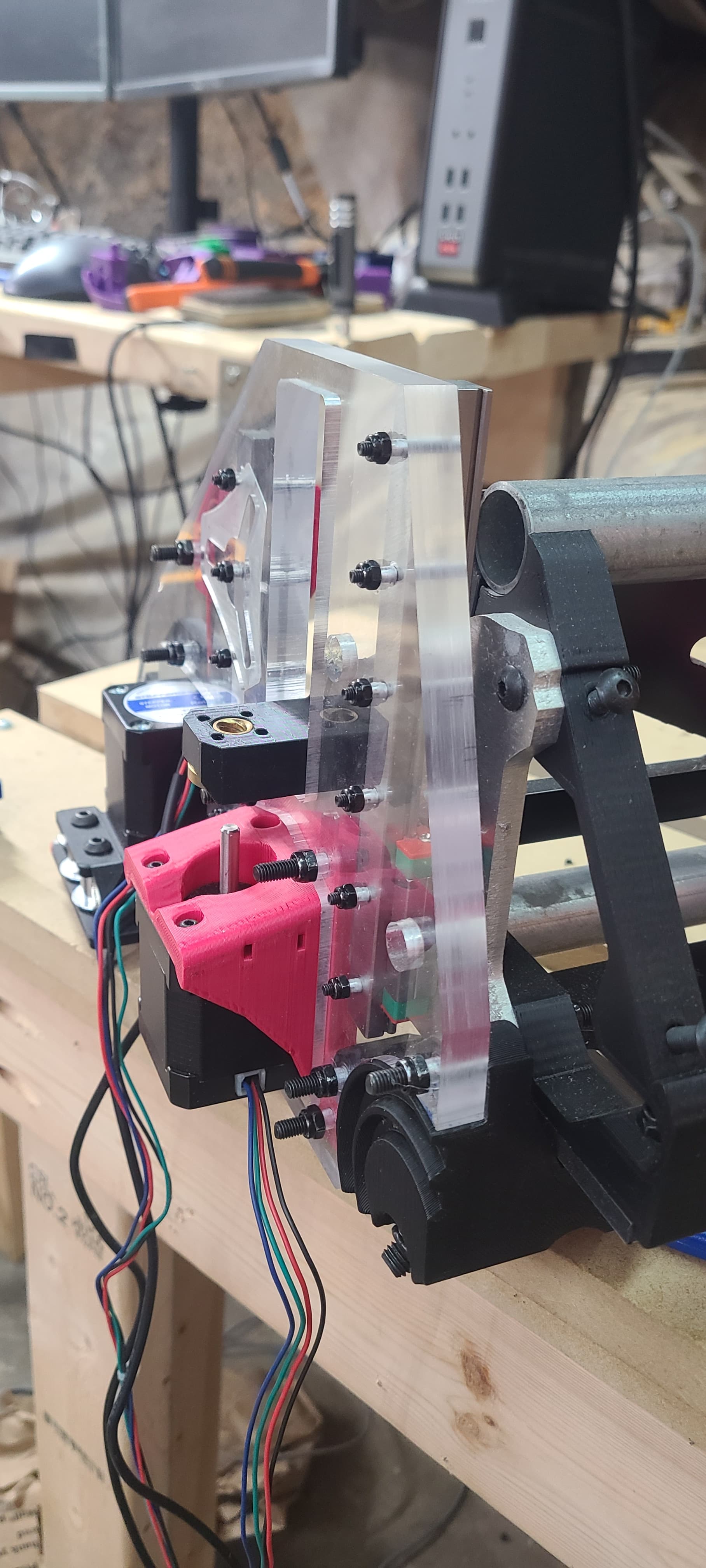

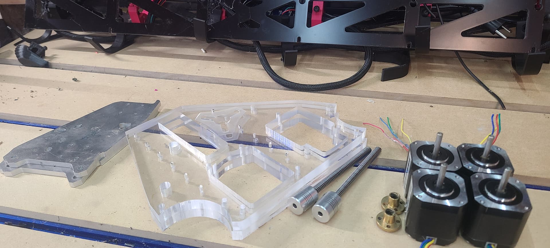

Thanks to @Jonathjon i have some renewed vigor on my LR3 project. What was supposed to be just plates turned into quite the early birthday present (monday)!
Now on to swapping parts! And seeing if i have any of that pink left to print the stubs! I might have used some for some other things…
Glad to see the parts will live on! Cant wait to see it up and running!
I see a hoffman!
One side reassembled!
Wow, that’s impressive.
Nice!
Side 2 done!

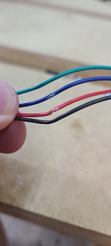

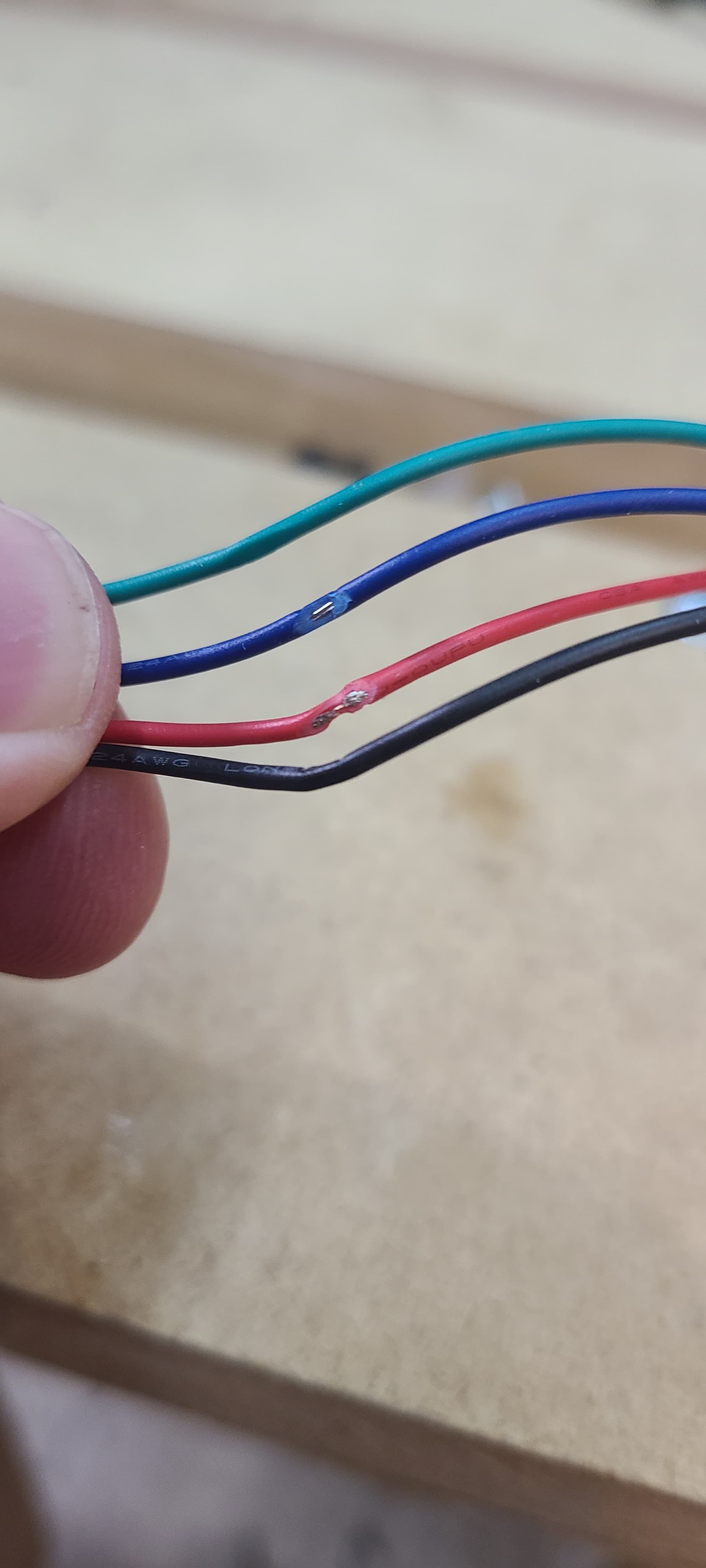

Next up is fixing the broken wires that the vendor snapped with too tight wire ties.
Looking good!!!
That sucks!
Clarification. NOT RYAN!

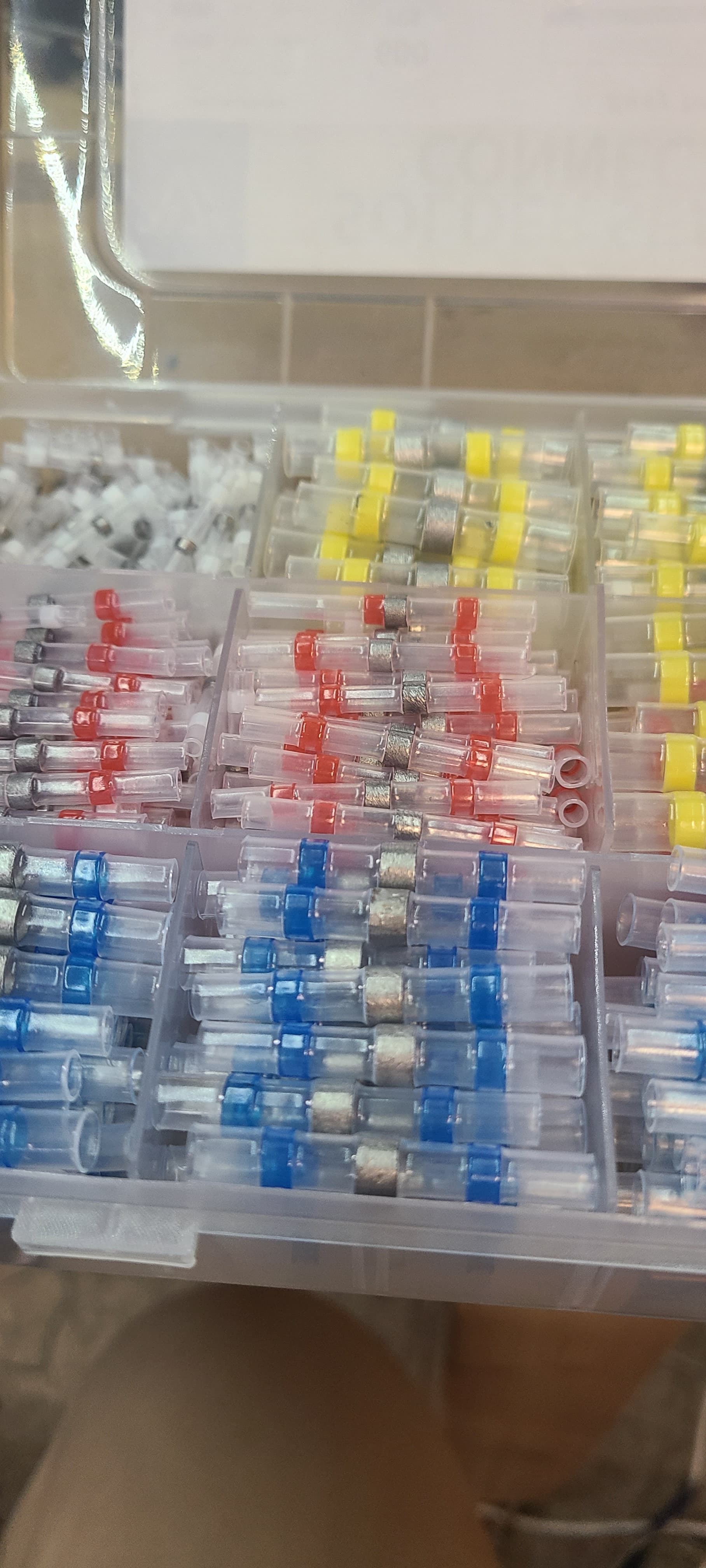

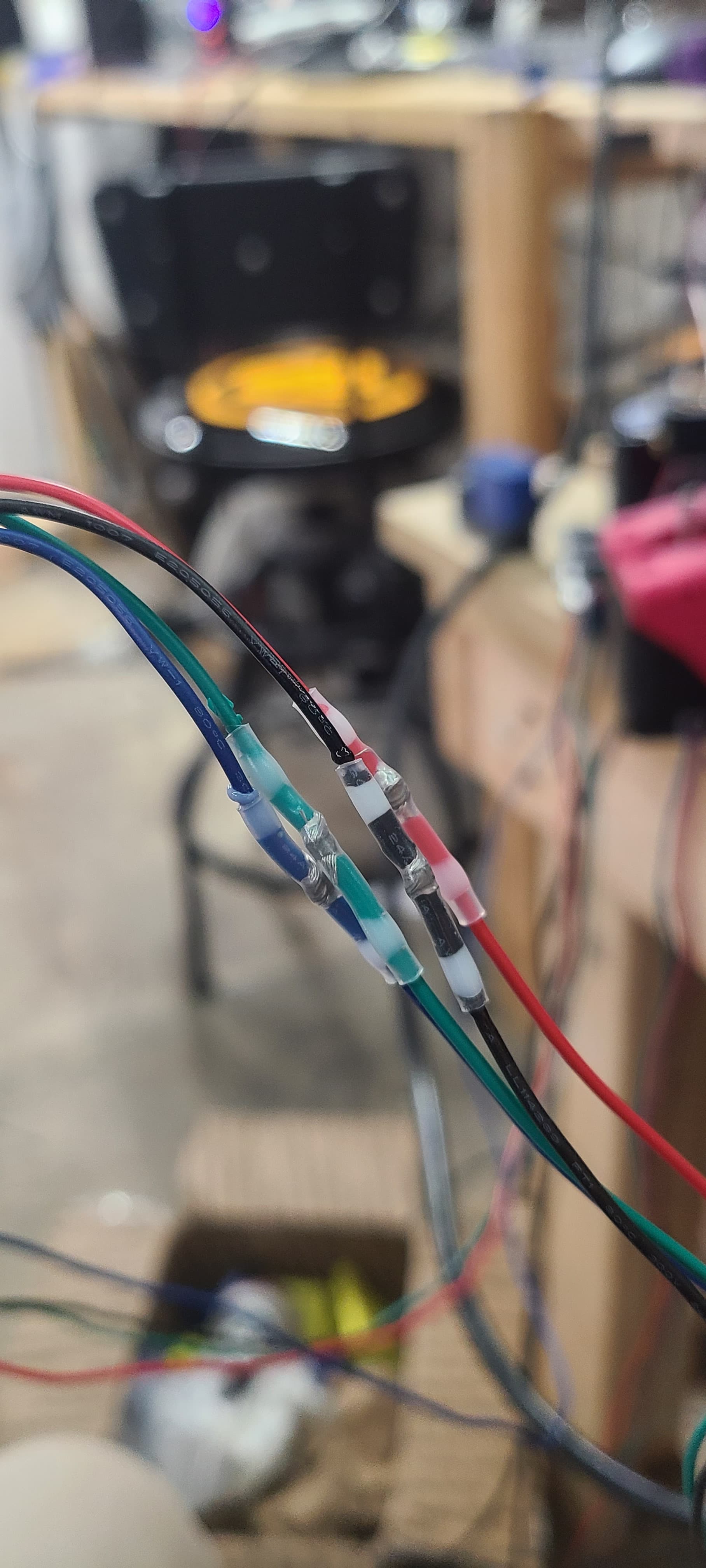

Okay. These might be the coolest and most useful things i have ever used.
First off. I CAN solder. But why?
I love them!!! I even bought some from the neighbors. I am pretty happy to use them, even with the soldering iron 5 feet away.
@probrwr
Way to go!
Really interesting, I need it too. Can you share the seller’s link? Thanks
https://a.co/d/i91zPc7
These are the one I got. They show as unavailable but there are lots of alternatives.
As long as you just need the smaller ones, Ryan sells those.
Thank you very much, I live in Italy and on Amazon I didn’t find the same article as yours, but a very similar one. They will be delivered to me tomorrow.
Your instructions were helpful to me.
Have a good day
