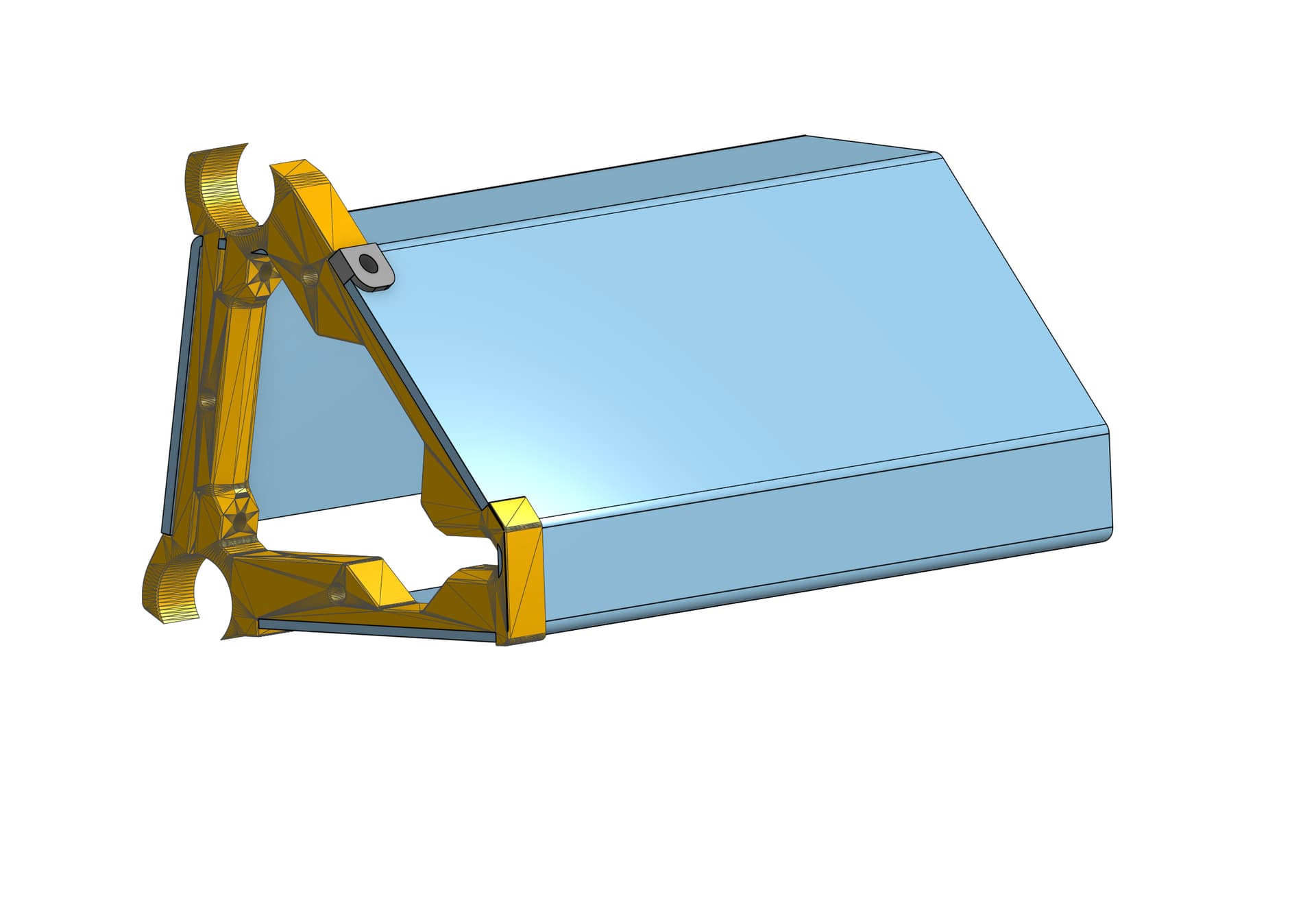

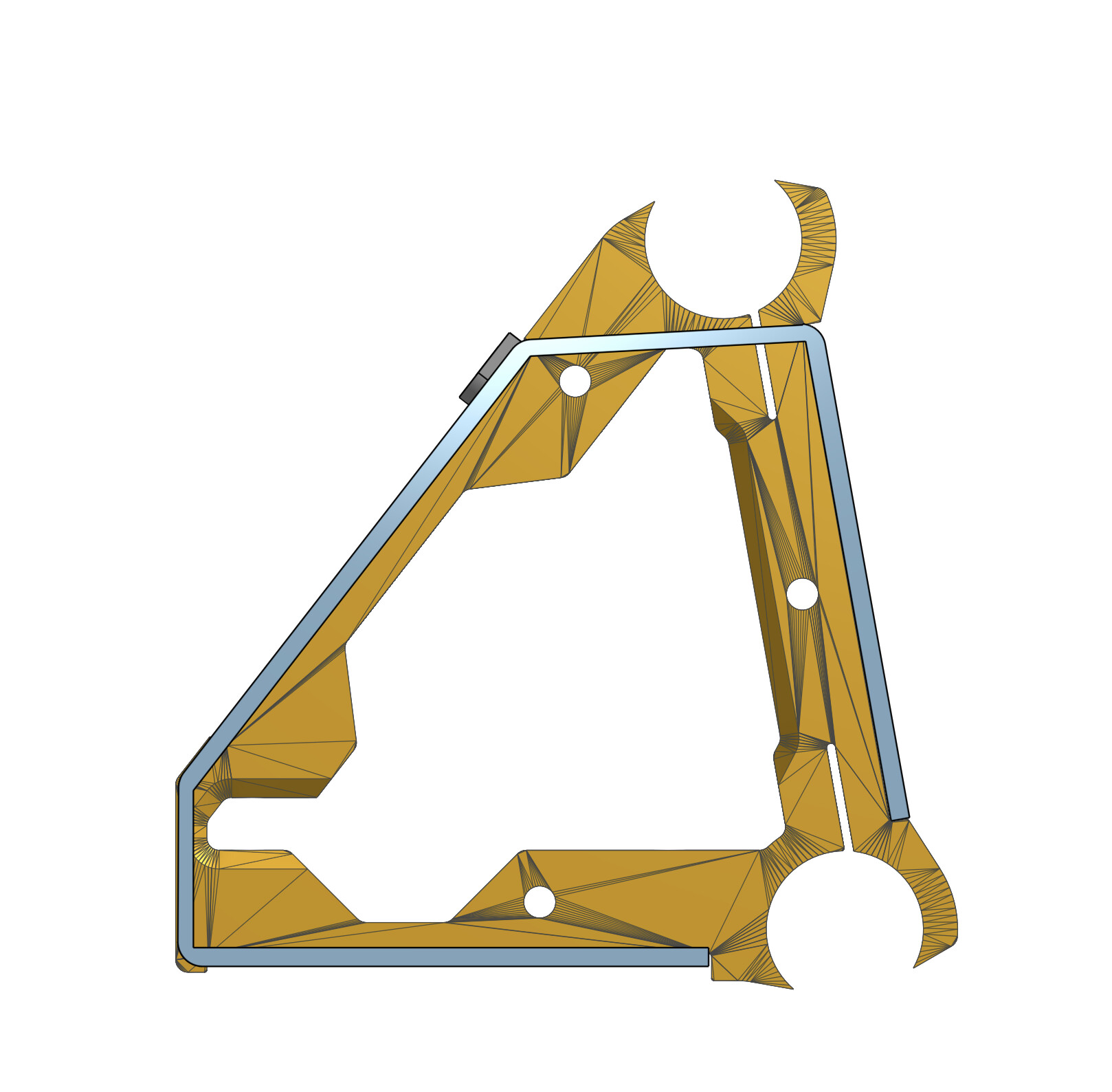

I’m probably going to cut some (temporary?) struts today, but I keep getting distracted with a thought I had a while ago which involved making the entire beam from 3mm folded Composite.
I’m not going to do this in my initial build - but I’ll just leave these sketches here in the hope that by the time I get round to actually thinking more about it someone will have a working prototype! :smiley:
It doesn’t quite work at the moment, but perhaps it’s not a big step to a super rigid lightweight structure with the “dogbones” for tube support bolted on?
interesting, so you would only use the 2 end braces?
Doing it that way you can make them integrated, print that whole section as one, and just bolt them together at each section. That was my original idea but there is no way to ship that many brace pieces. Mostly Printed LR
I was thinking maybe a bolt-on set of intermediates to add stiffness to the tubes.
@vicious, I know this is waaaay off track - but who knows what might come of it - how about a printed section with live hinges that could be shipped flat? (forget it - as soon as I typed I realised it would need a humungous print bed).
As I said - it’s just something I’ll continue to mull over for a very long time, because I can.

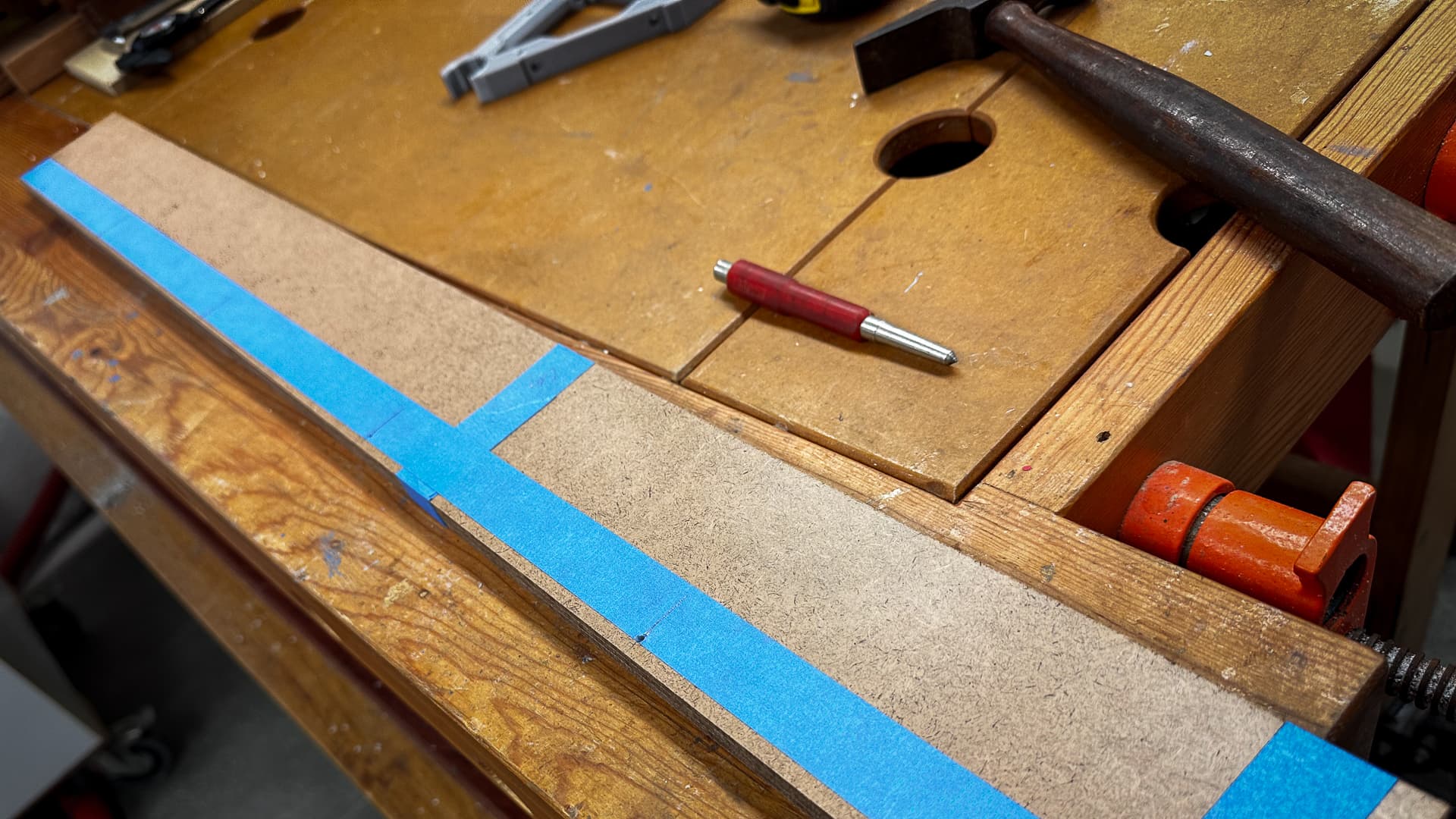

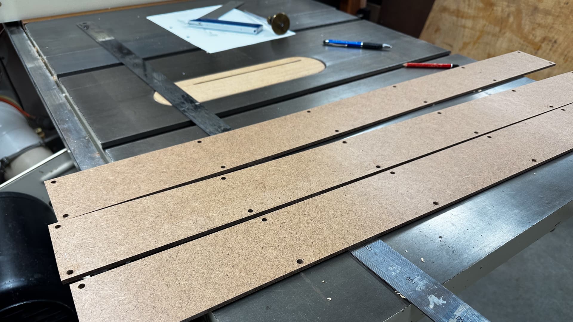

My intention has always been to attempt the final ones out of Composite, so rather than waste any energy fiddling with the LR2, I thought I’d try a different strategy for the temporary struts. I’ll sort the final versions after the LR3 is finally tuned. It helps that I have a shed full of tools that haven’t been fired up in a while and need a bit of routine maintenance.
This is probably a viable way of making struts for anyone who owns basic woodworking machinery and if you have a little experience, it takes about the same time as generating the g-code to cut the parts on the CNC (and yes it is quieter and just as much fun!).
It’s not difficult to cut a very accurate rectangle with even a basic table saw. I like to tape parts like this together to make sure they are cut to identical length, and of course it makes for one third of the drilling.
I usually mark wooden parts out on a bit of masking tape so if I make a mistake there’s no mucking around with multiple marks, just replace the bit of tape and get on with it.
I have a pillar drill too, so drilling clean square holes after centre punching isn’t much of a challenge either, just use the first row as a template for the rest.
Of course if I change my mind I can always cut the truss in later.
