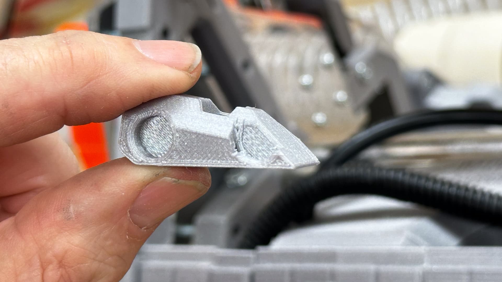

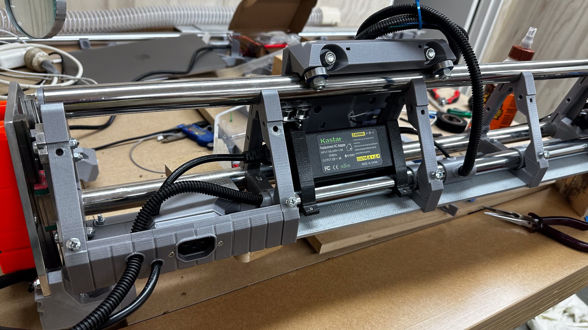

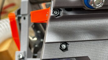

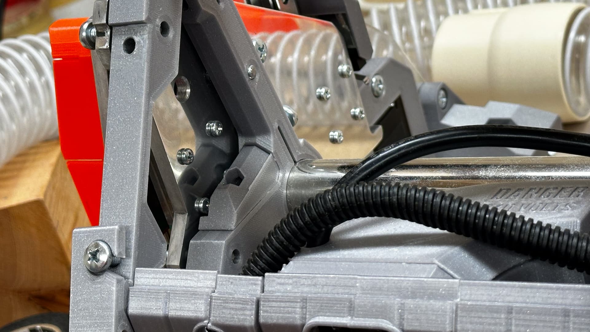

The bottom front “encapsulator” probably doesn’t need to be glued in place, as long as one of the two bolts have nuts on them they will stay happily in place, but I will eventually use a tiny drop of superglue just to stick it there, and perhaps a small drizzle of epoxy on the bottom nut.
Sadly the cutout I put in place to allow for the screws missed by about half a millimetre. I’ll have that amended and uploaded later tonight.
In the meantime a tiny slice with a sharp knife will fix.
Since the router and vac mounts are likely to be in line for quite a bit of modification down the track, I’ve added a little epoxy to hold the nuts in place. This photo is really just to demonstrate how little - a tiny smear in one or two of the corners is more than enough. It’s not there to actually do any work, just to hold the nuts in place long enough to undo and replace bolts as necessary.

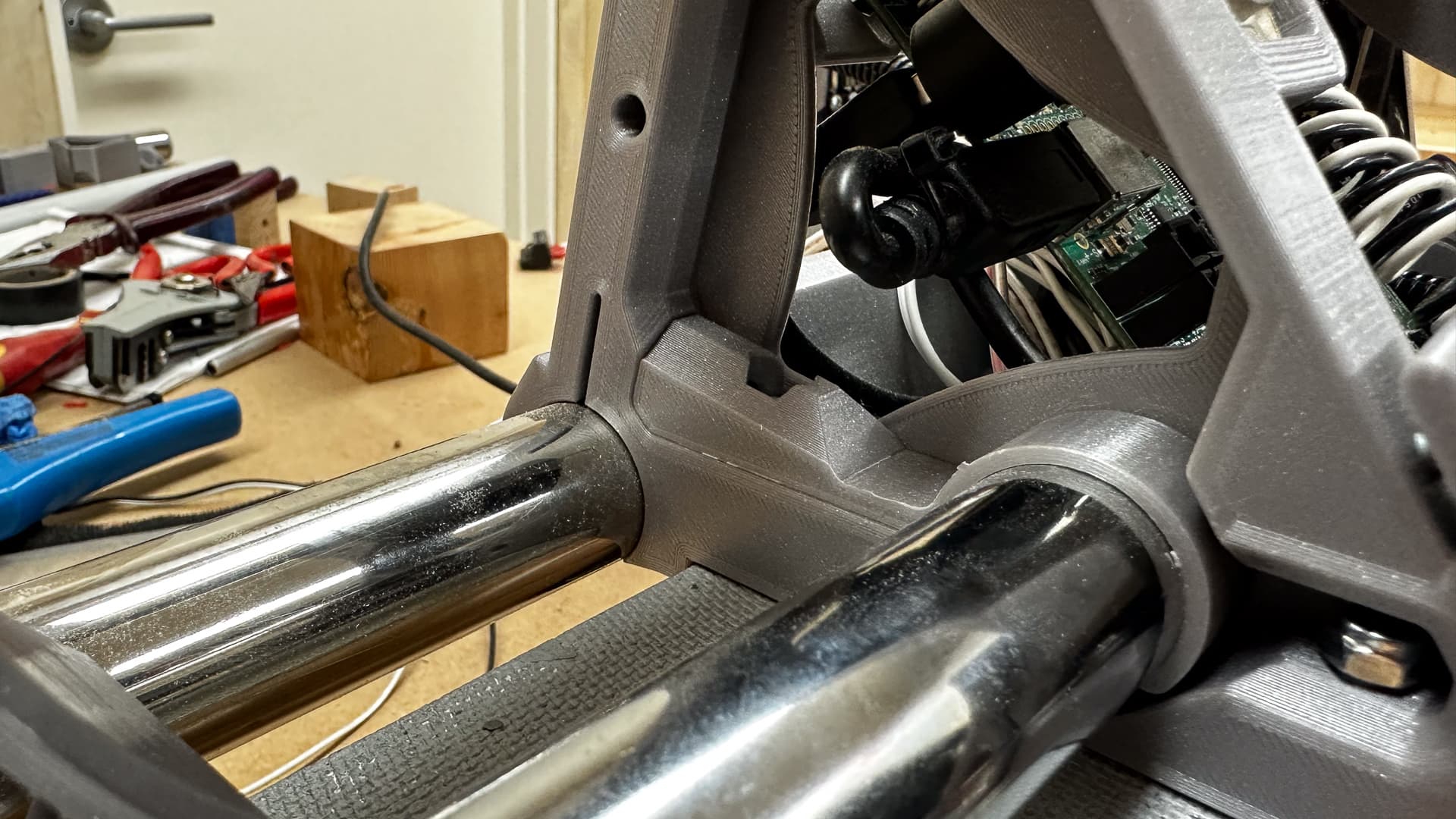

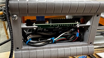

It started out as a good idea - fit the board into the strut, what could be hard about that?
Pretty much everything as it turns out.

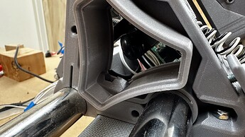

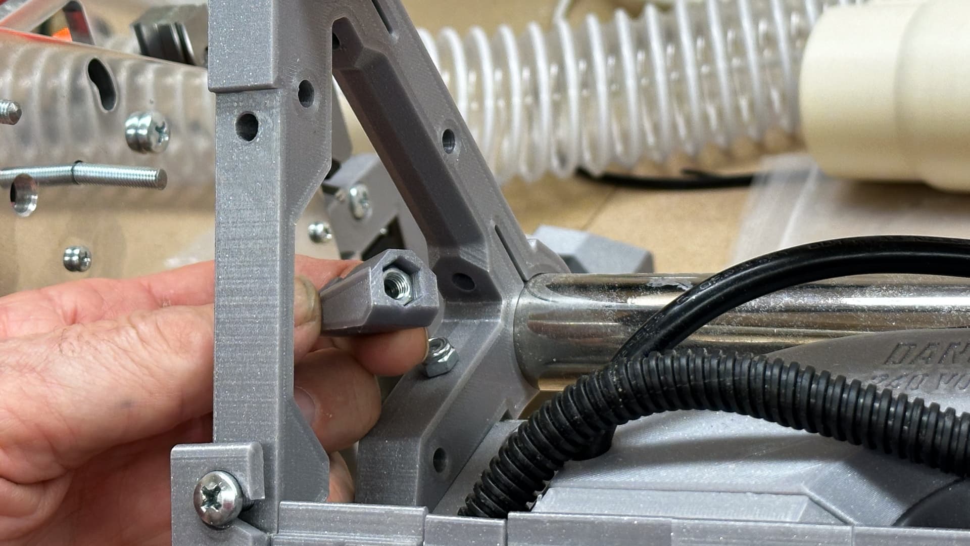

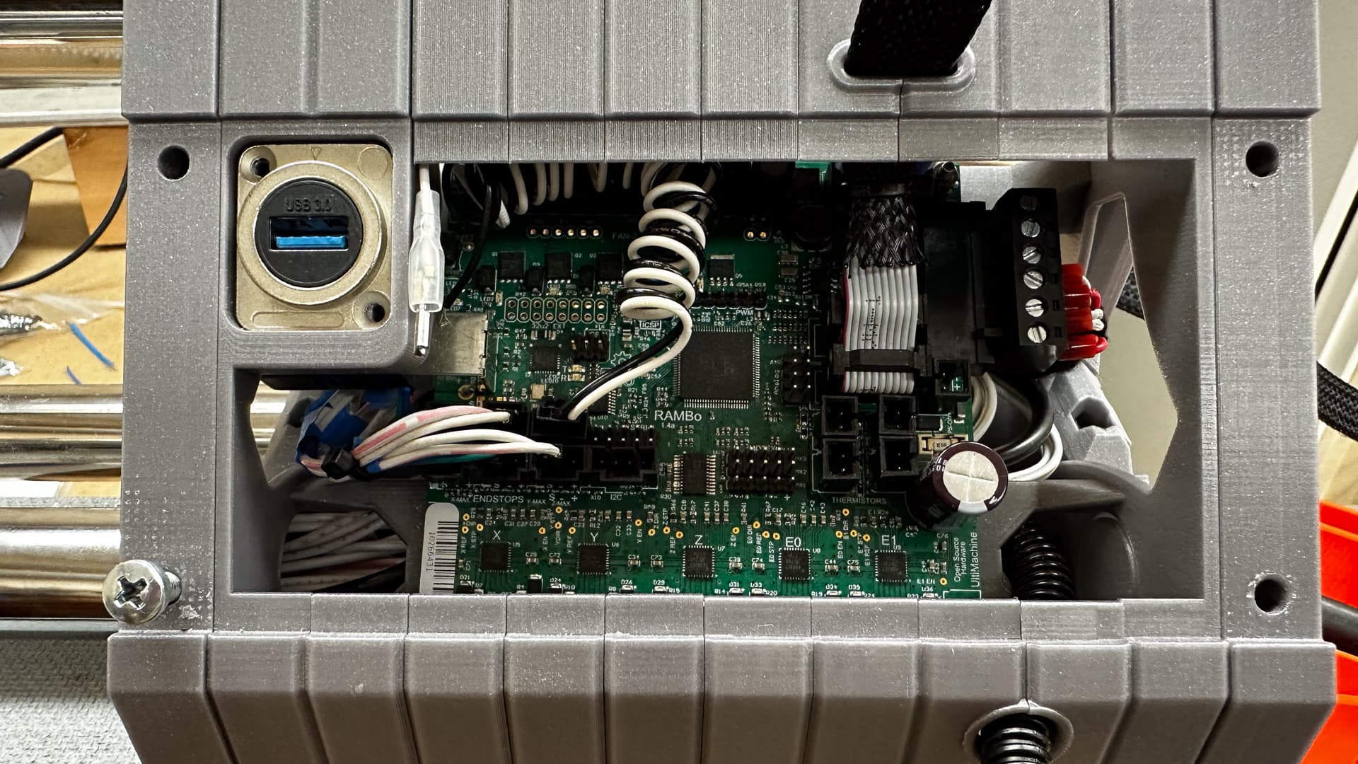

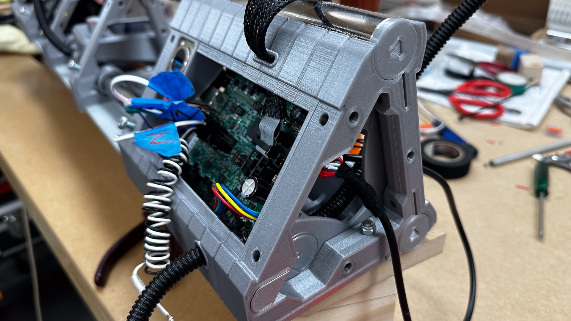

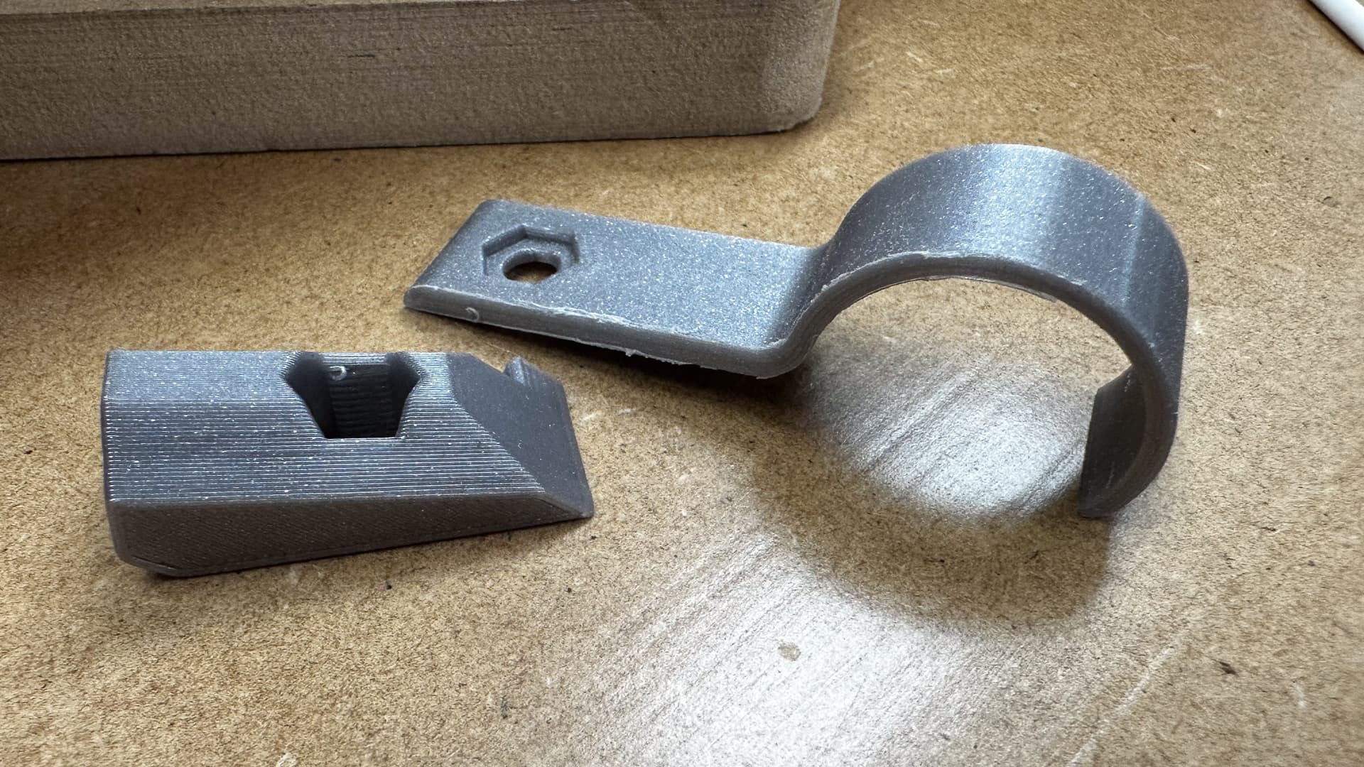

The end plates with the the board mounting brackets worked out well, but they made it impossible to access nuts after assembly. The space was just a little too squeezy to fit the USB cable so I made a vent hole and then had to extend it to cover the cable.
So I made some “encapsulators”, and while I was at it a clamp to hold my completely unnecessary but very shiny conduit in place.

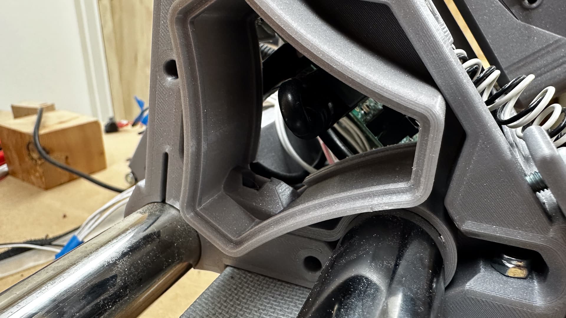

Except that the two didn’t talk to each other so I had to combine them into yet another bespoke part which looks completely at one with the structure.
Except that they encroached on that little vent hole extension, but in the end it all fits like a glove, albeit one designed by a madman. Perhaps I could have made that vent a little smaller, but I’m hoping not to need a fan. No, the V1 logo wasn’t really an accident - it’s a very purposeful way of avoiding the conduit!

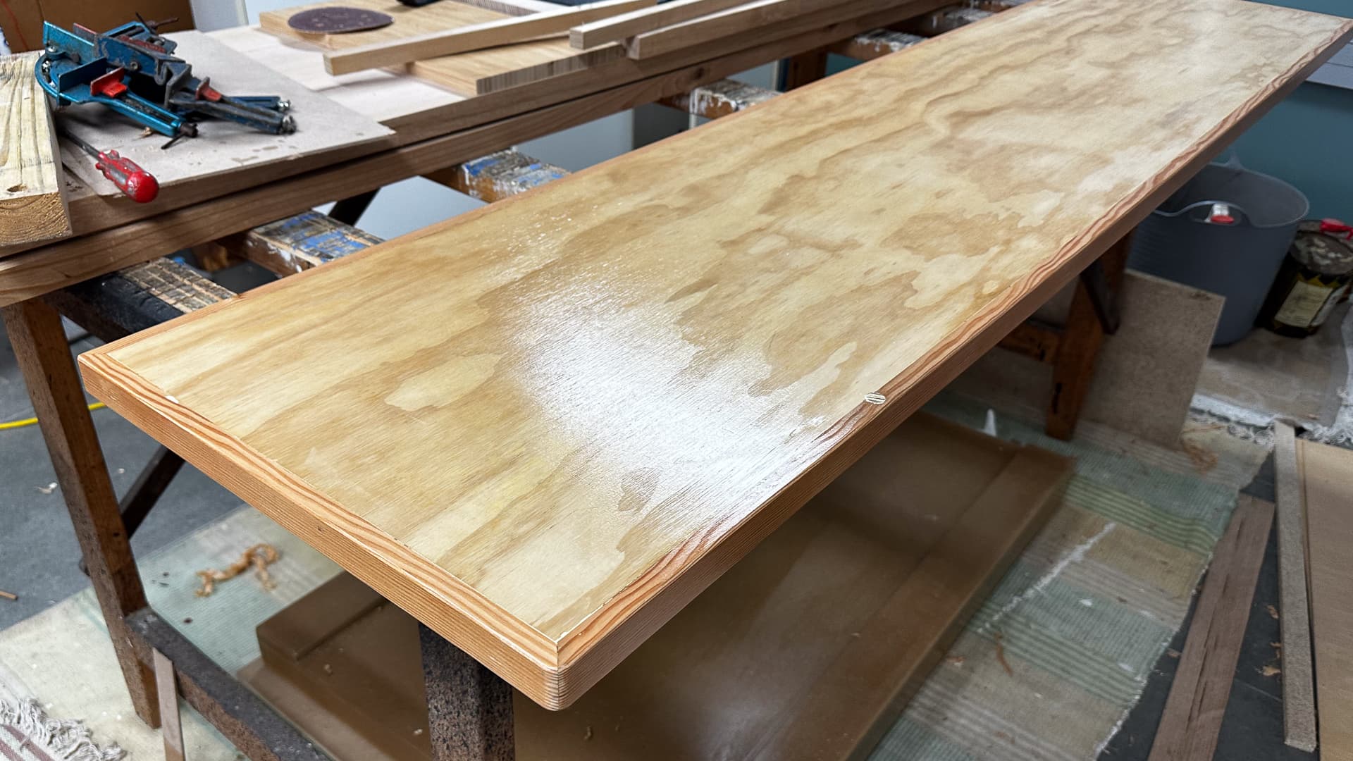

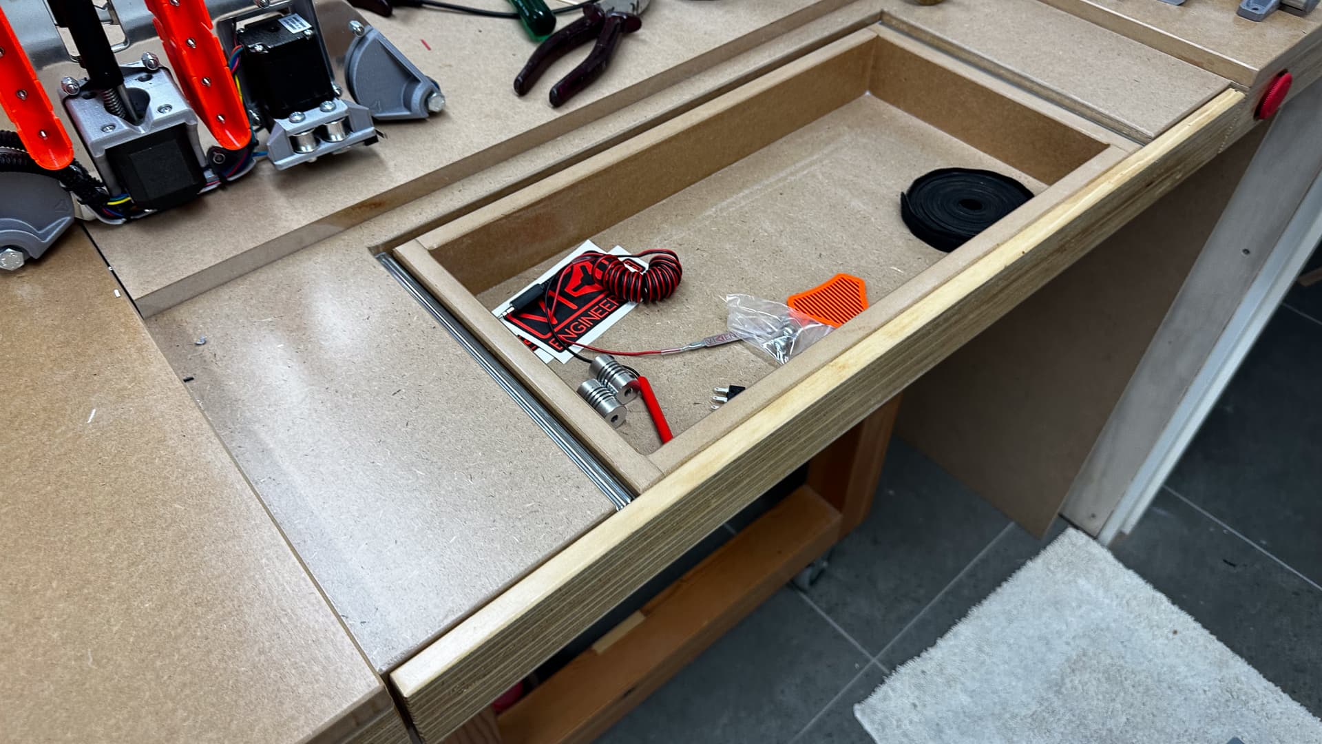

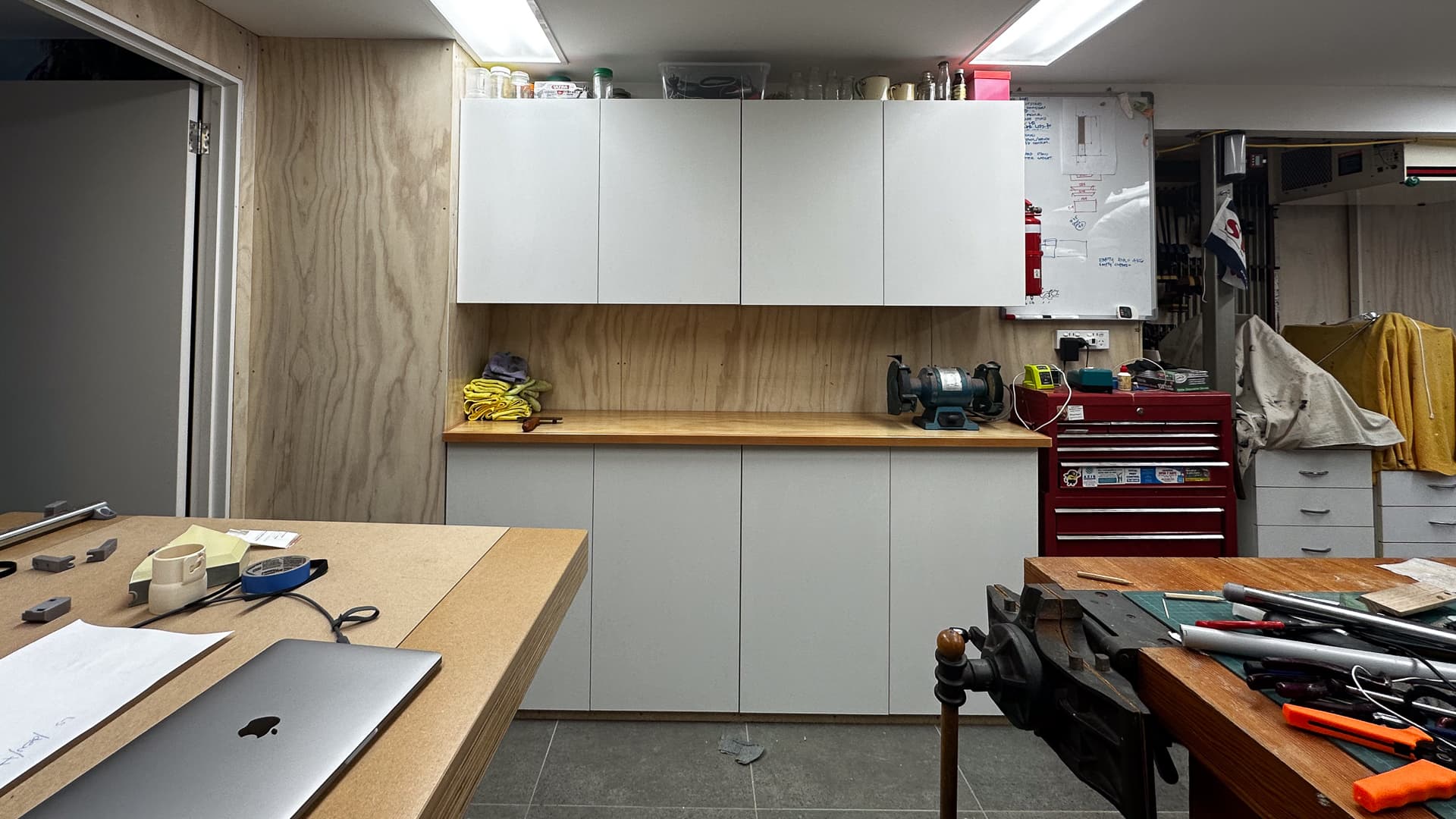

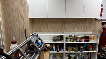

A bit of cabinet work to begin.

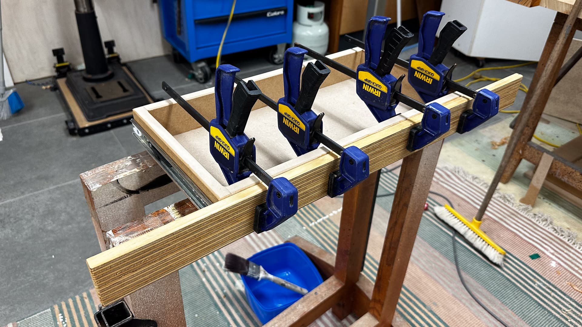

I rebuilt the drawer for the table - the first one was strangely out of square and it just seemed easier than trying to repair it. Glued the face on and it I’ll do the final adjustments tomorrow.
In the meantime, I’ve finished the benchtop for the other cupboard, got the doors on the tool one, and still have to empty the paint one to level it a little better before fitting the top.

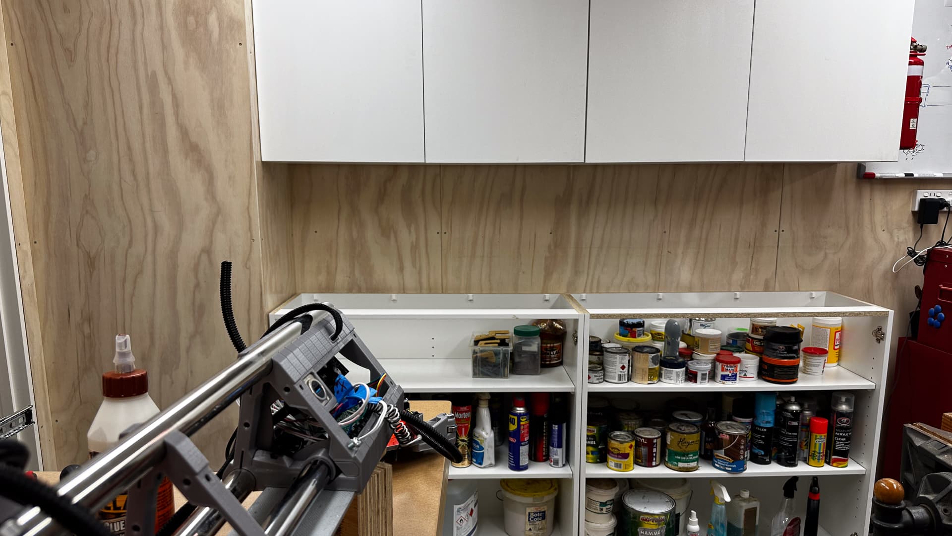

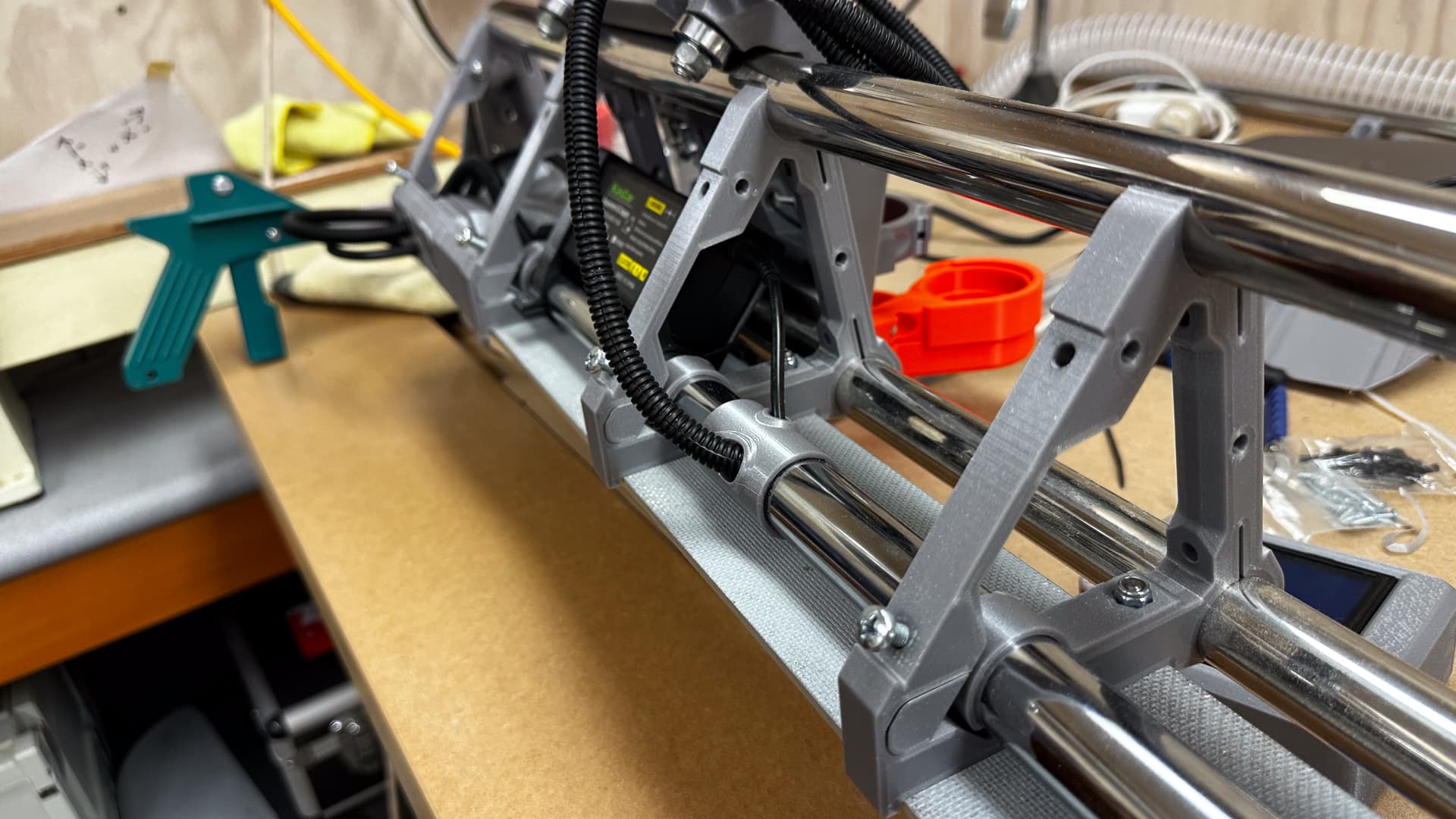

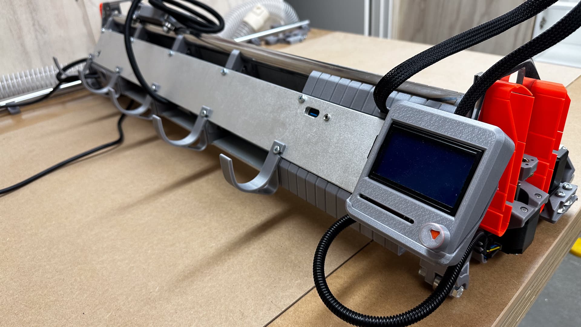

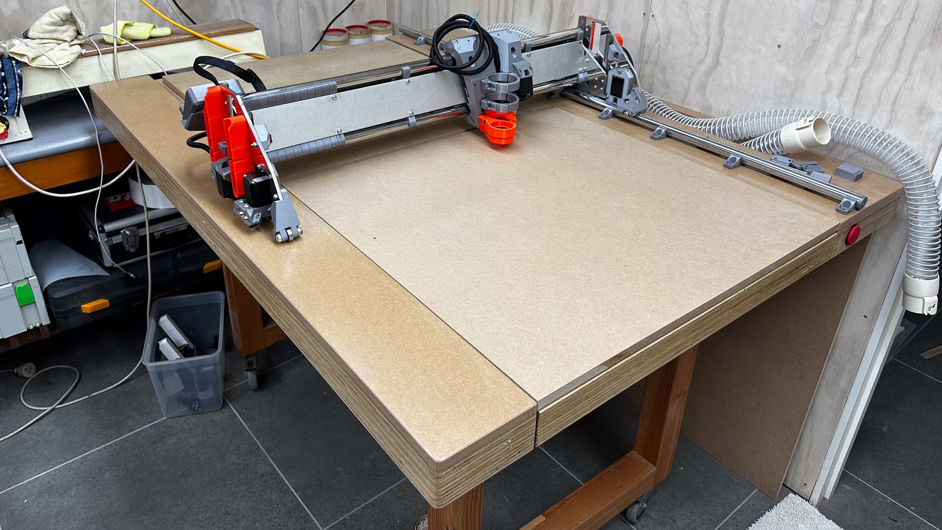

While all that was going on the final assembly is now in an advanced state. Everything is fettled, squared as far as can be at this stage and all the little finishing details are in place and at least the 240volt end of town is ready for the temporary struts. I probably don’t have to say that am very pleased with how clean and simple it all looks in real life.

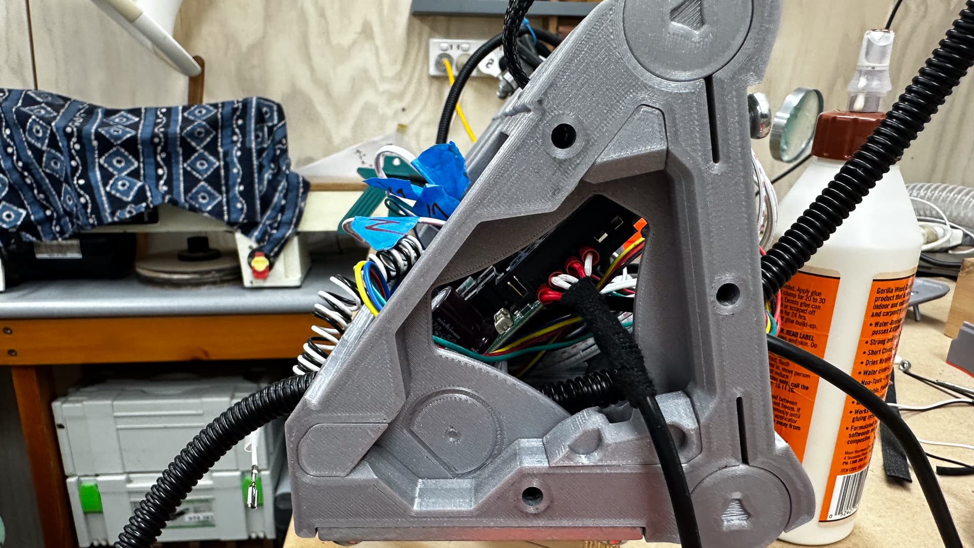

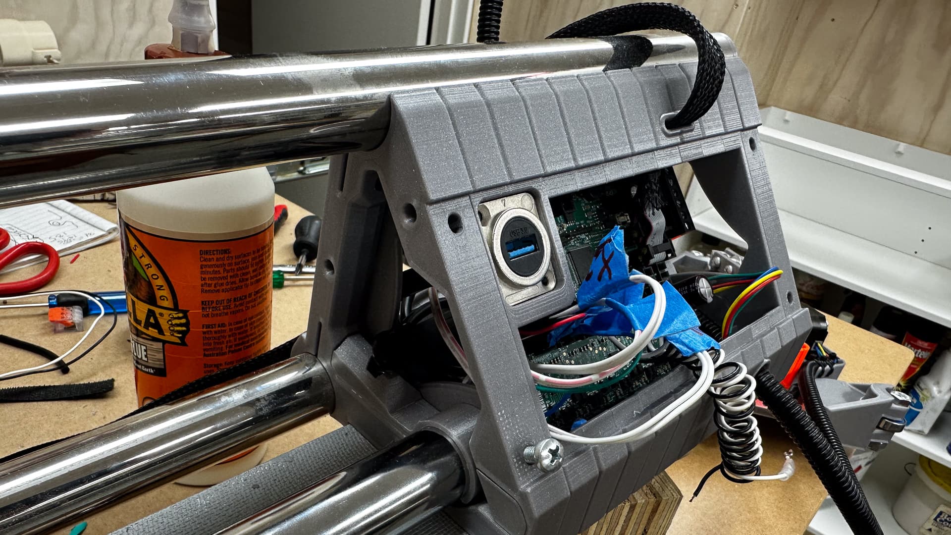

Meanwhile at the other end of town, making those connections in spaces far too small for an xxl sized set of hands required patience by the bucketload, and I am still to tidy them up!
I fired up everything using “table power” and all the steppers are working and travelling in the correct direction. Tomorrow I’ll double check, because I really don’t want to have to undo it all just to flip a connection, and then test the ends stops and the USB connections.
Then after a little bit of tucking and poking of stray wires, we should be ready for belts and a piece of track!

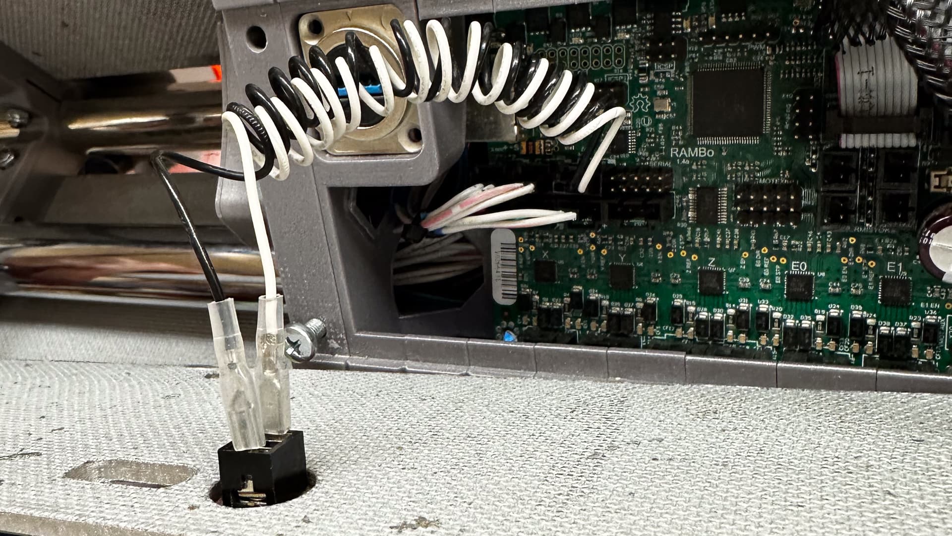

The curly wires are for the touch plate plug which initially will be mounted in the strut. I’ve run a spare pair to the core in case that doesn’t work out for me, and have thoughts of adding a plug on top of the core but at this stage, I just want to get on with it!
I’d say with just a bit of buttoning up and testing, we might even get a crown out of this baby in the coming week!!
I’m not sure why I haven’t found this morning stressful. It’s taken a very long time to plug in ten or so plugs and tidy up the associated wiring.
I suspect there’s a time bomb looming on some of those early crimps, but for now everything except the touch plate and USB connection have been tested, so we might bolt on some struts later in the day.
The USB connection of course now has the pass-through in the middle of it, just one more thing to go wrong, so wish me luck.
It’s bolted in and satisfyingly tidy.

Here’s the back of the touch plate plug ready for the strut to be mounted.
…and with the strut in place, it’s the little dot this side of the USB port.

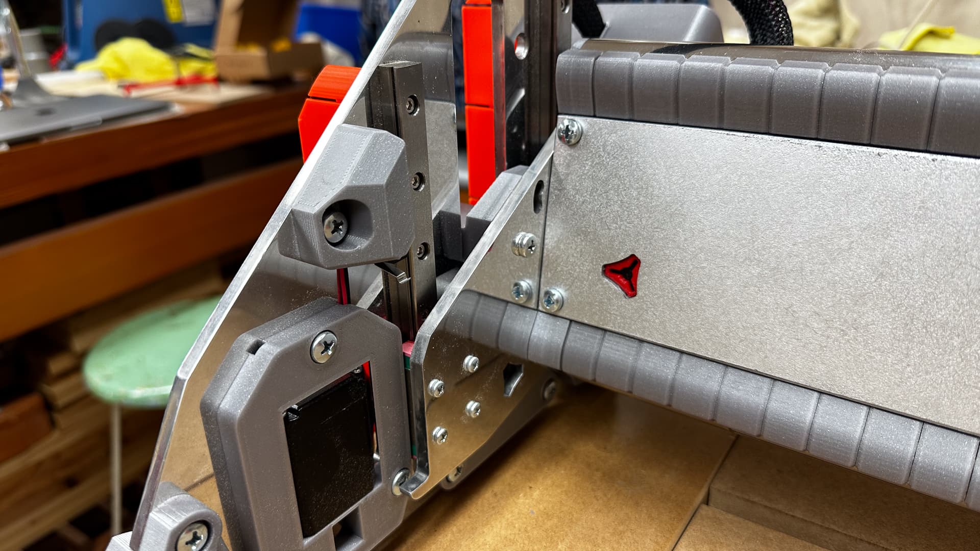

The final iteration of the strut is planned to be in mirror finish either ACM or aluminium, with a simplified strut, and I have to say it’s hanging out for a window into the board - do I print one or make it properly clear? It will need a blue light of course to match the controller.

It looks as though we are getting somewhere now.

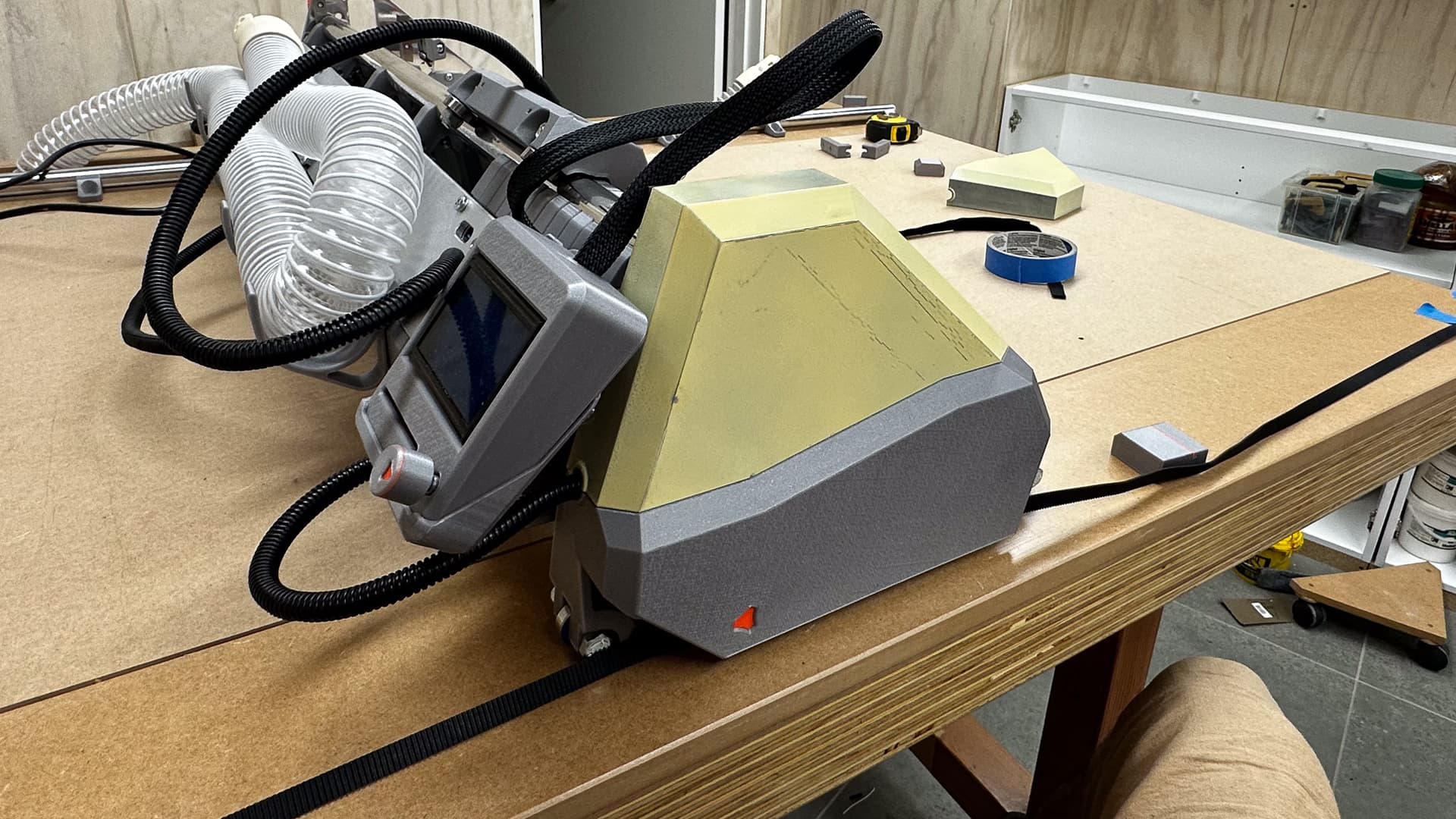

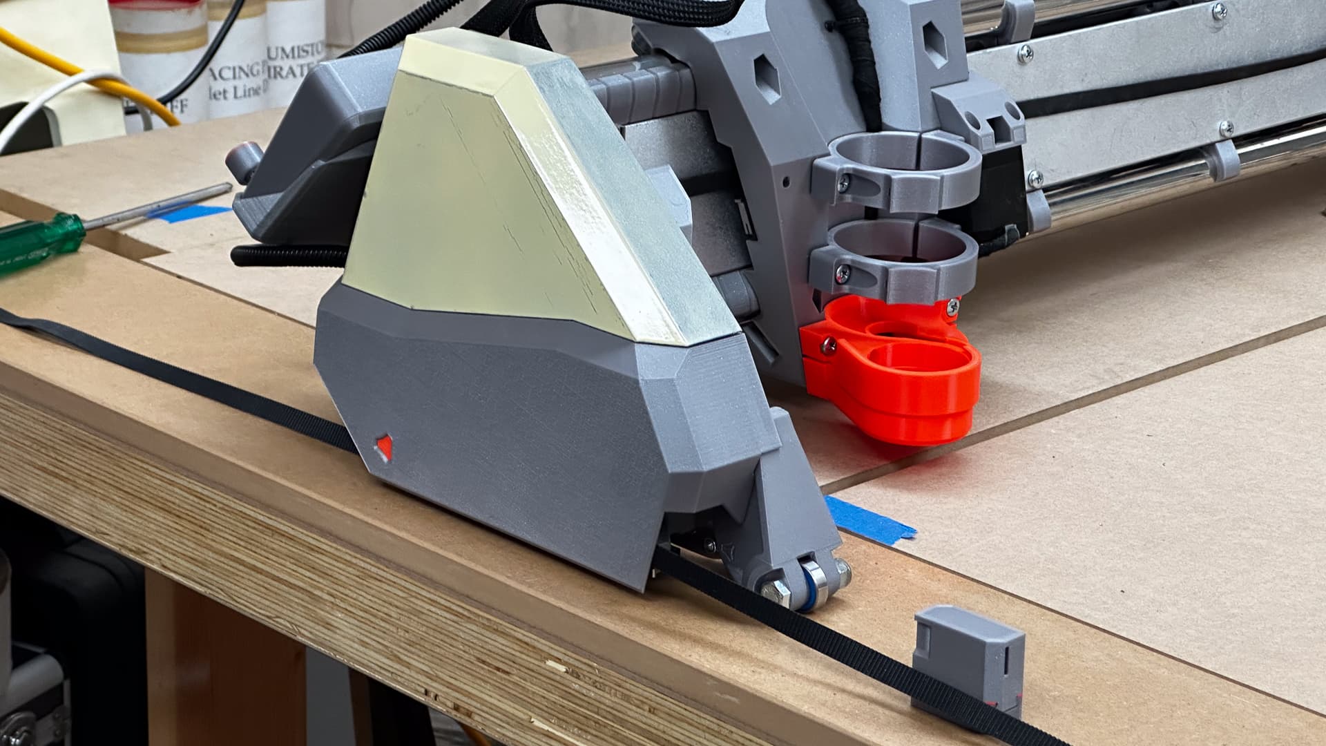

In case any of you were wondering about the outcome of those painted covers, let’s just say they were a complete disaster. I gave 'em a quick squirt of random cream today just to cover up the biggest part of the mess, but that didn’t work.
I will be reprinting them in a vanilla colour, but I think after the impact of the orange and white, nothing will compare!
They do fit beautifully - I just have to make sure that they don’t foul on the stop-blocks before I share the files.

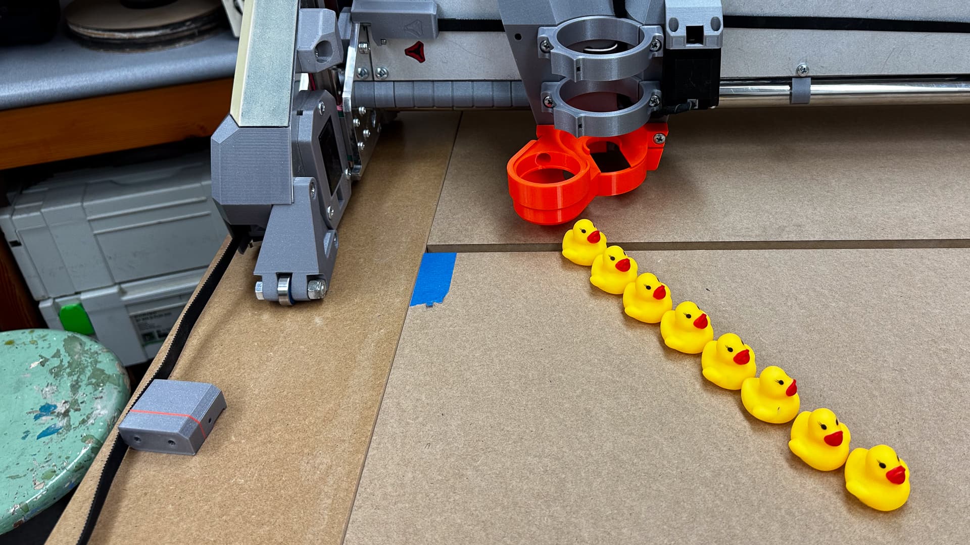

After today I’m going to call that eight ducks in a row - or about half way I reckon!

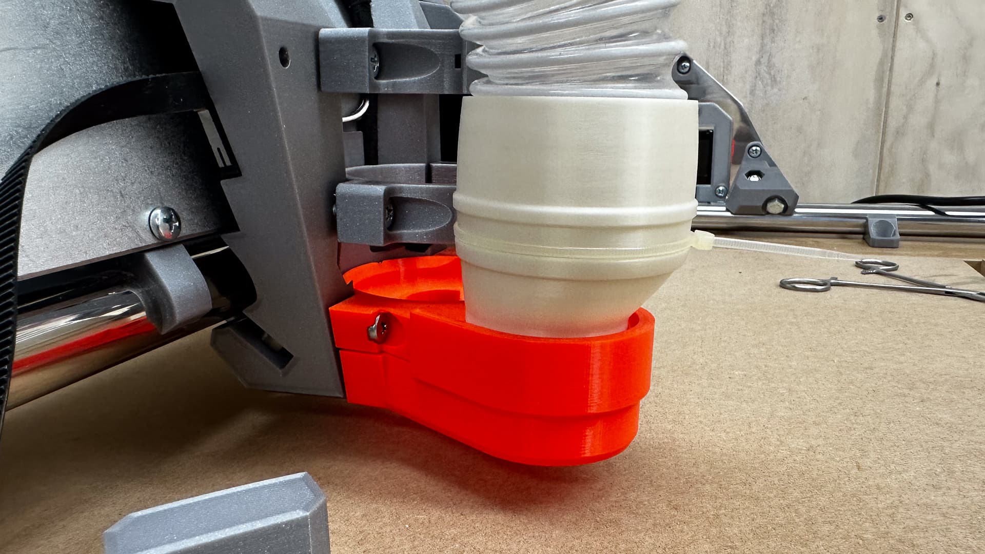

Not the need to make a vac adapter for the 2" hose to do me until the revised versions get done. (I quite like the two little ribs to stop the zip ties slipping off).
