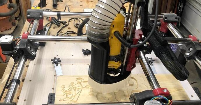

How did you do dust collection with your previous MPCNC?

My hose came down from the ceiling of the box. This made it much easier for me to manage the hose.
