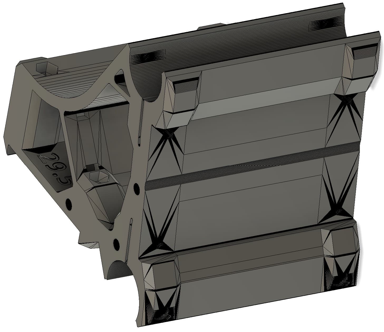

I thought of 2 options. The first: separate the Strut Plates into 2 parts and make a joint in the middle. By merging two braces together, like this:
We could fix the two pieces and end up with a comparable structure. But would making the Strut Plates in two parts weaken the machine?

Or just cut it in 2 pieces and then glue it together, you’ll be nice and solid.
