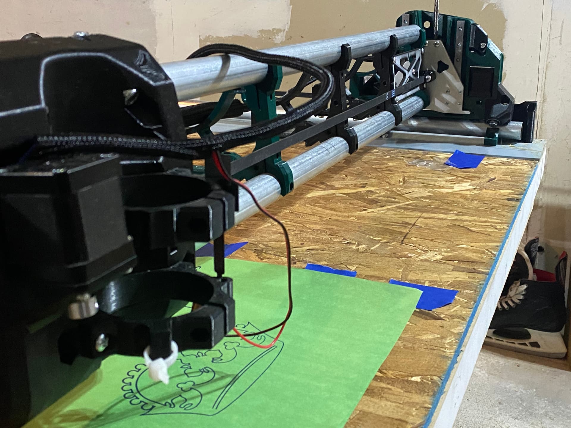

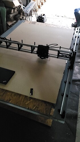

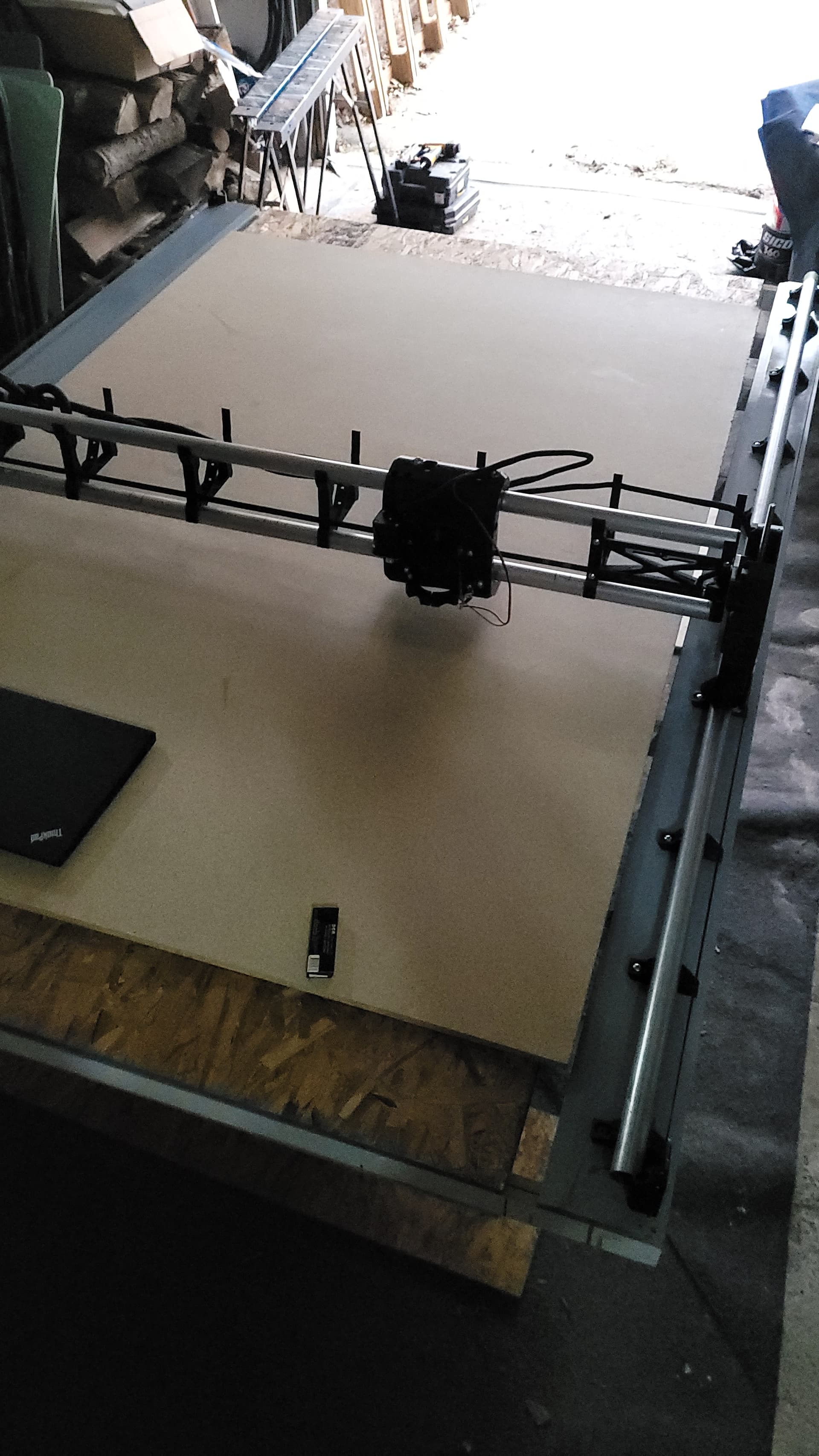

Lowrider4 build in Canada
Lowrider build along with the table build found in this forum! (~ $200 Full sized Lowrider table, Non-CNC Build)
This has been an adventure and scanning through the forum to find solutions to the issues I had definitely helped.
I am a bit confused on one topic which is grounded vacuum hoses. I currently have a cen-tec dust separator attached to a shop vac and figuring out the vacuum hose is beating me up. Coiled hoses, ground wire passing through a regular hose, wire exposed, note exposed… I’m lost :smile:
Any simple advice on how to proceed?
I understand that it’s optional but I would like to have one attached to the LR so I can also attach the core cables + touch plate cables all together.
Thanks!
