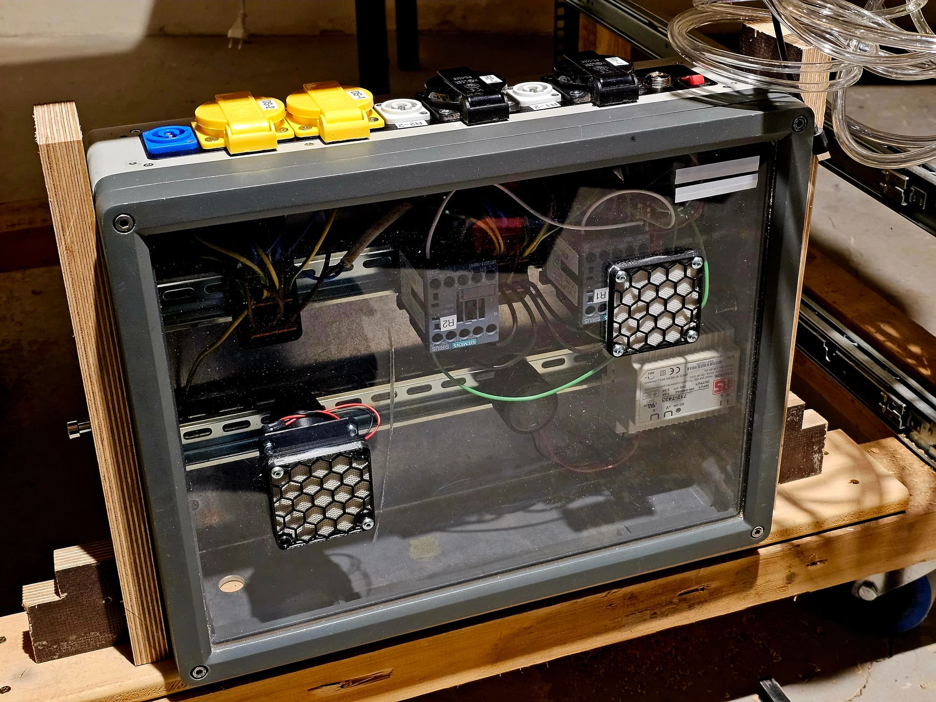

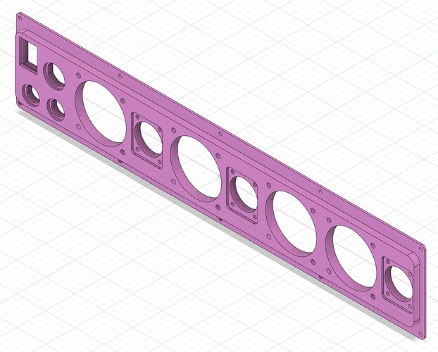

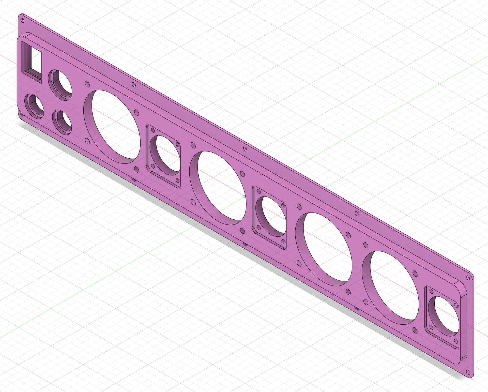

I’m currently designing the power distribution system for two Lowriders. The front panel will include power outlets, Powercon, GX16, and GX12 connectors. Inside the enclosure, there will be both 230V and 24V distribution. Some of the outlets will be switched via relays from an external control panel, while others—such as those for the PC and monitor—will have permanent power.

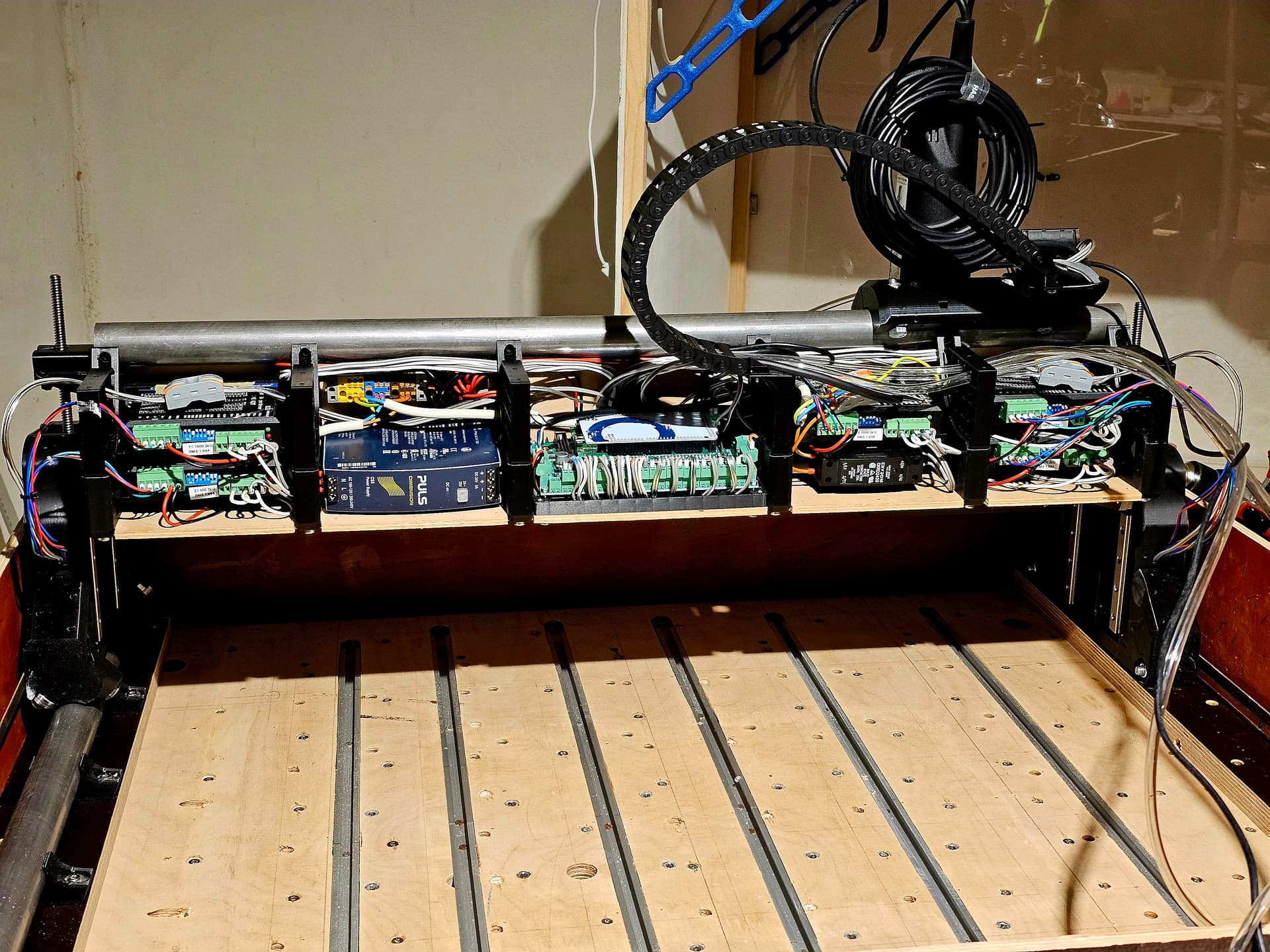

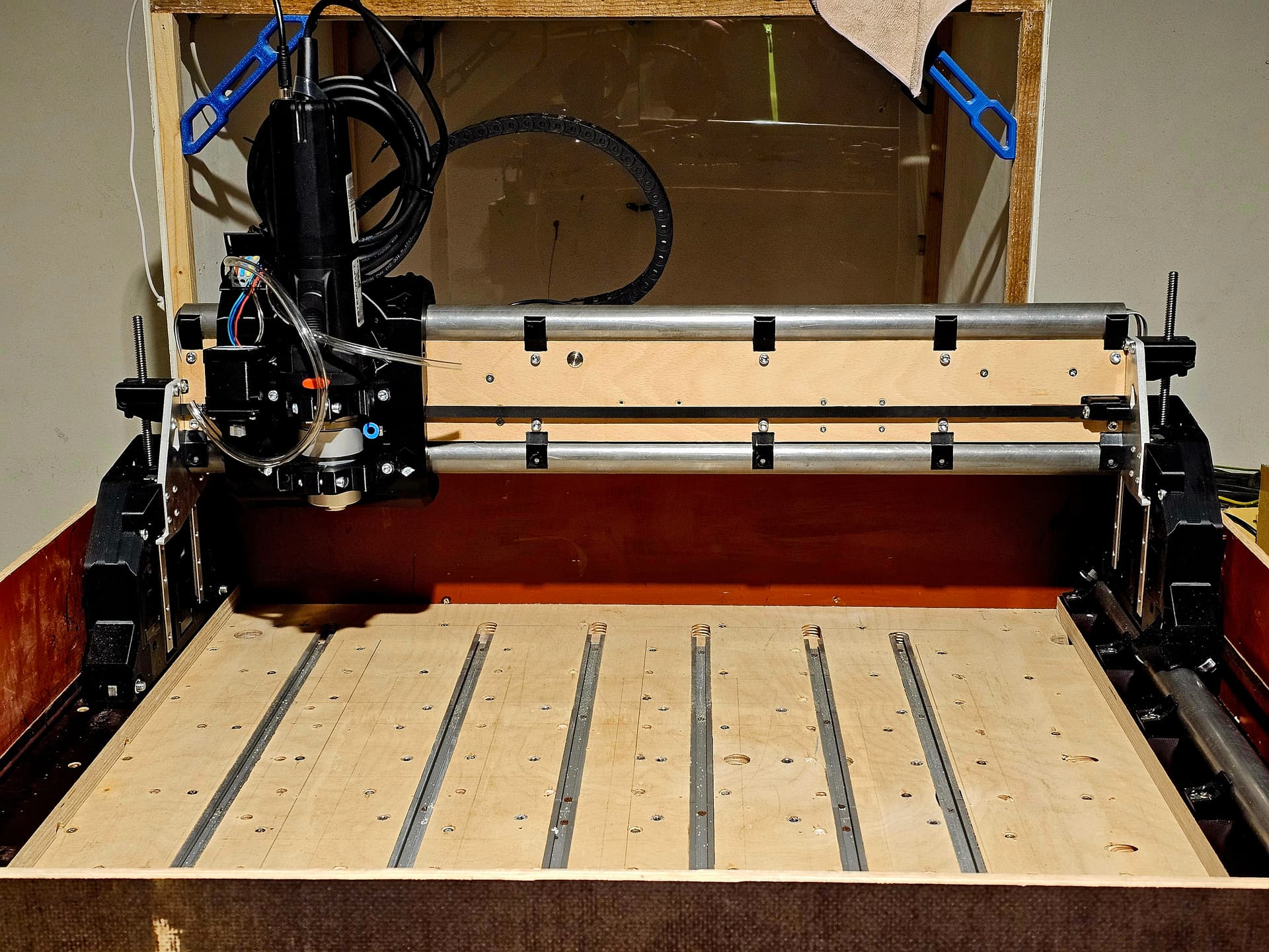

Tonight I started the assembly on the table. On both the left and right sides there’s about 2–3 mm clearance, exactly as planned. I now have a milling area of X61.0 × Y49.5 cm on a 90.0 × 80.0 cm table.
Wholly Cow, that’s a lot of electronics stuffed in there!
